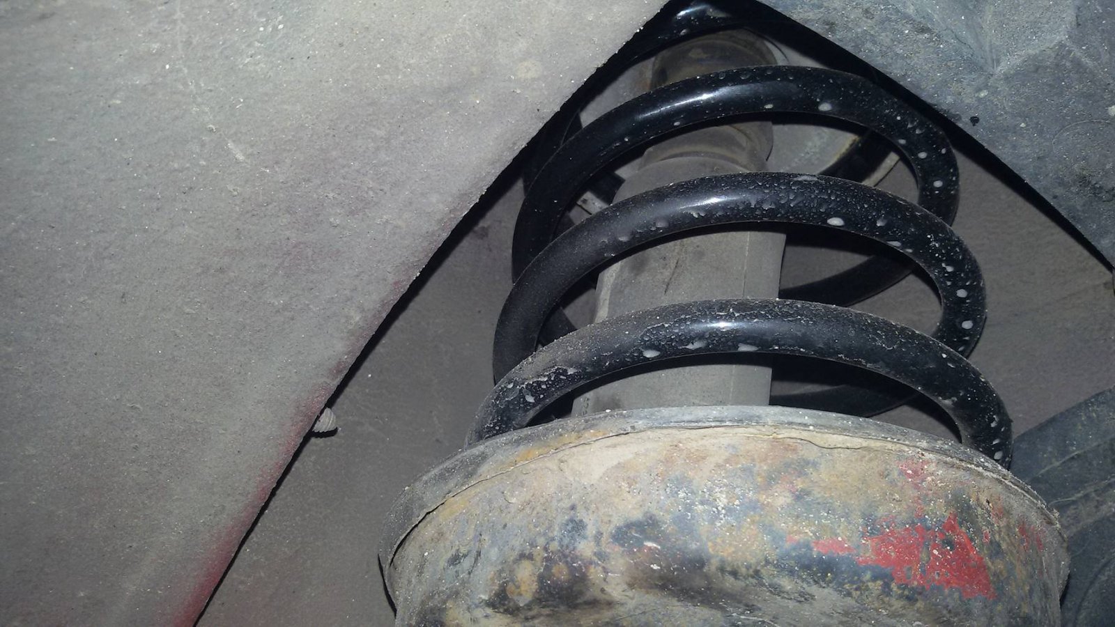

Have u tried the steering with the car on jacks? Mabe the springs are catching on the shock towers?

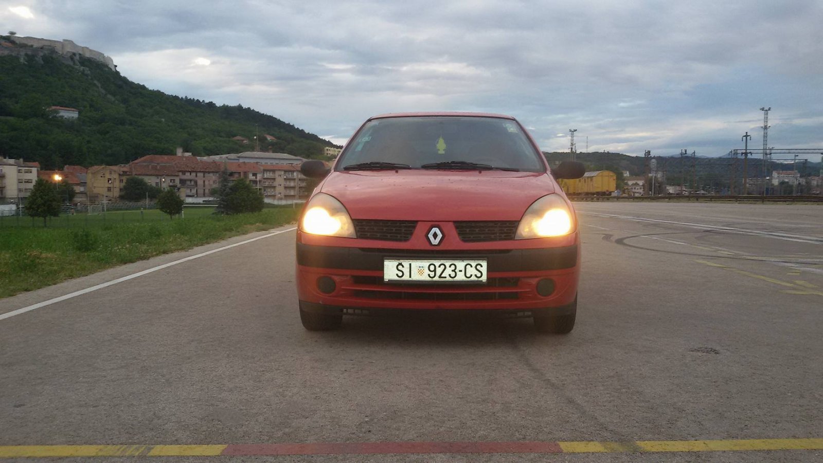

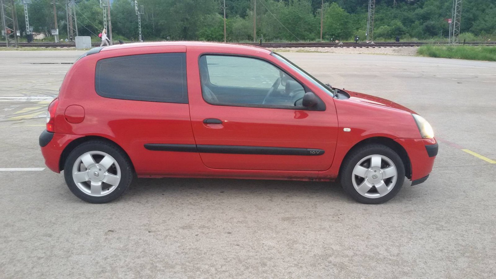

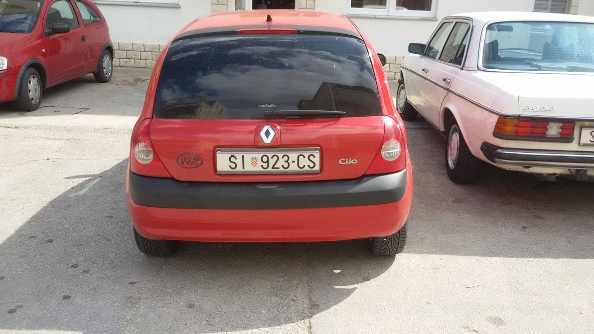

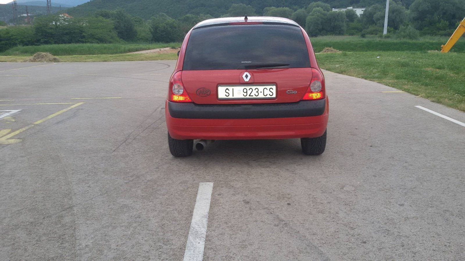

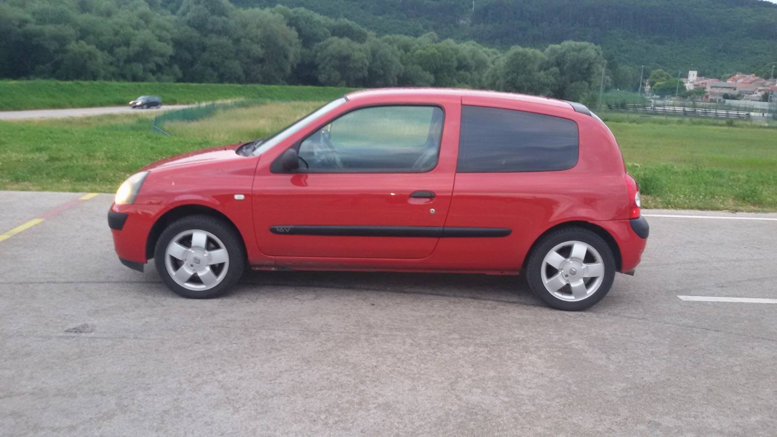

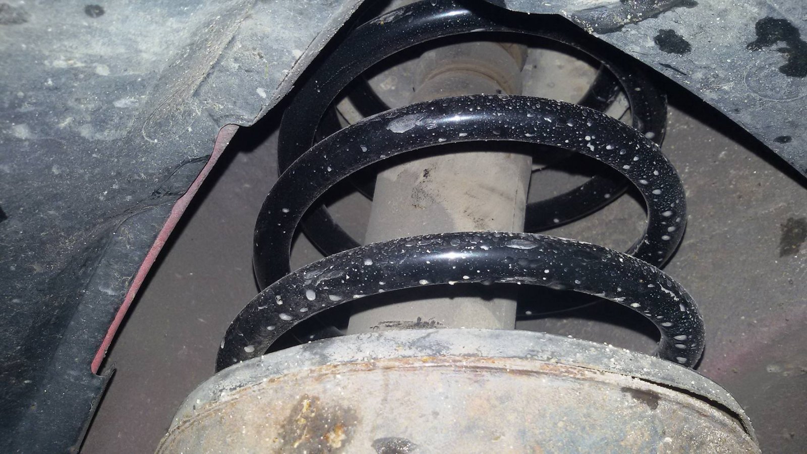

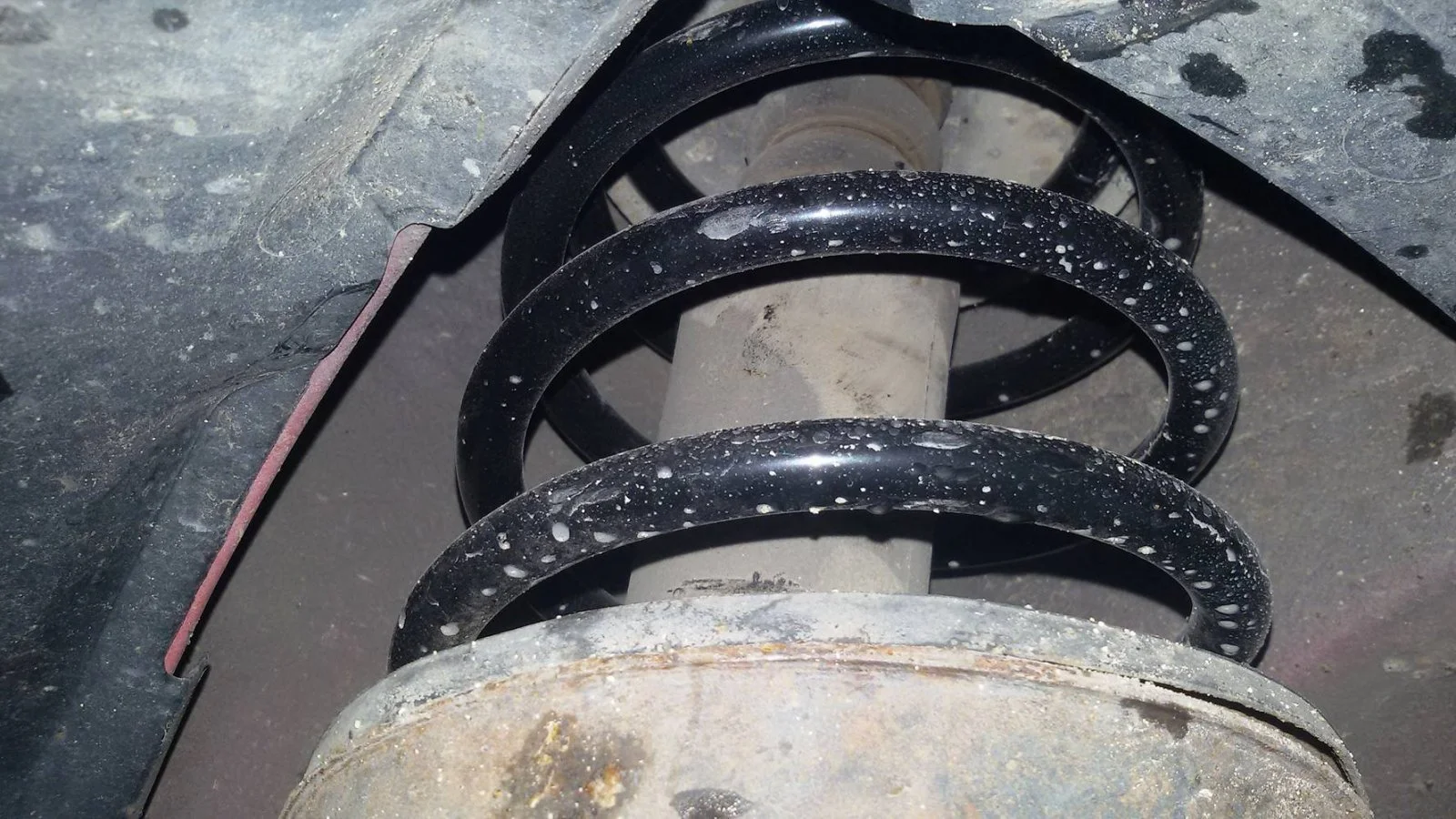

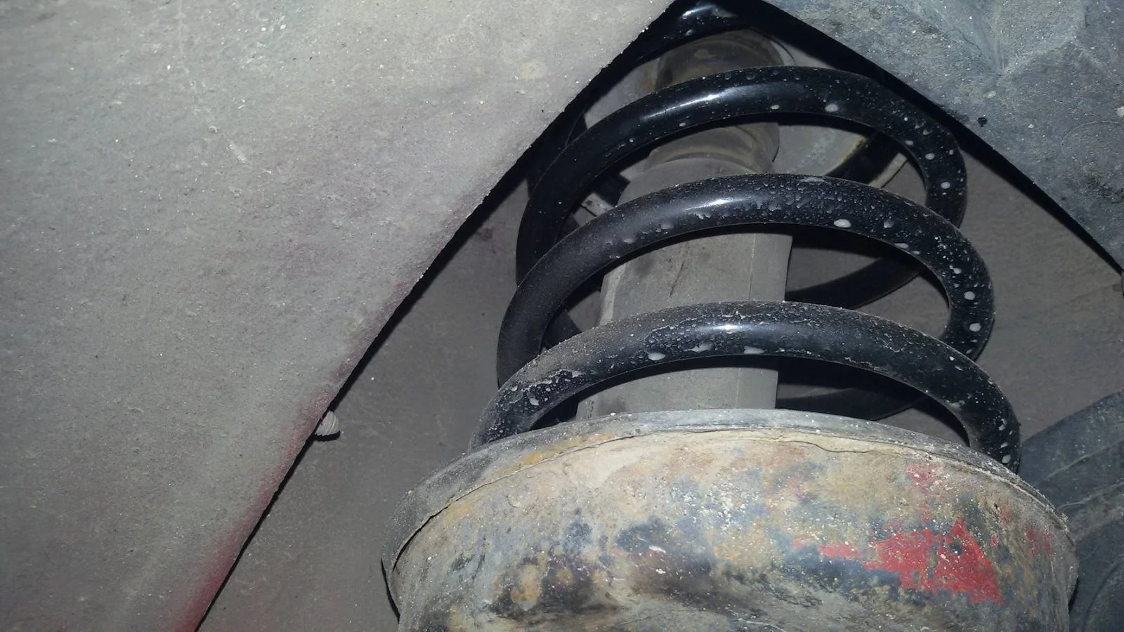

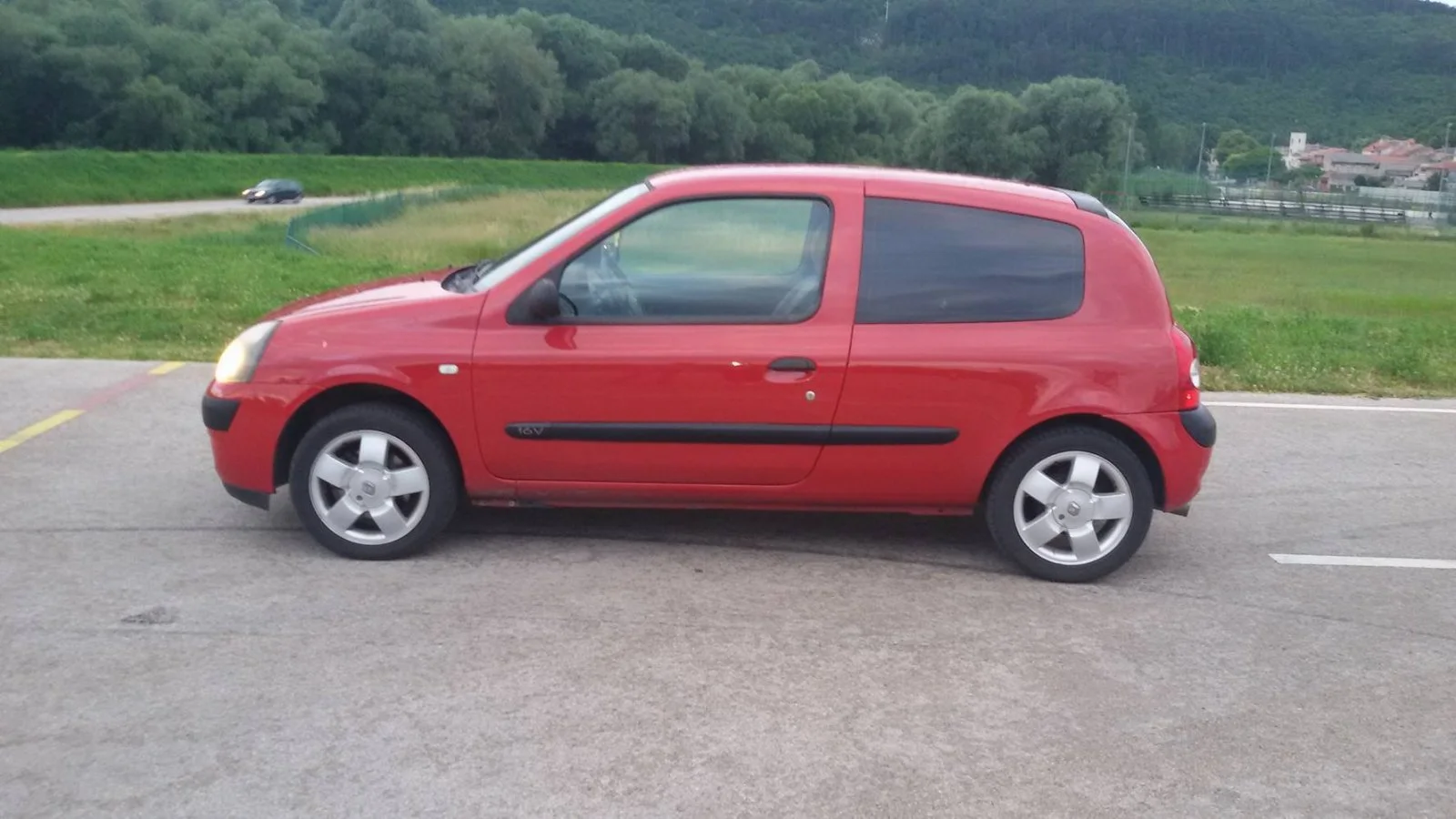

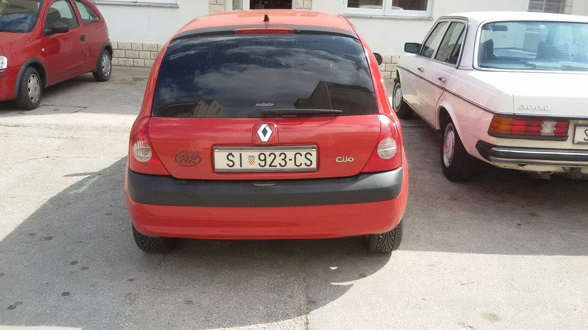

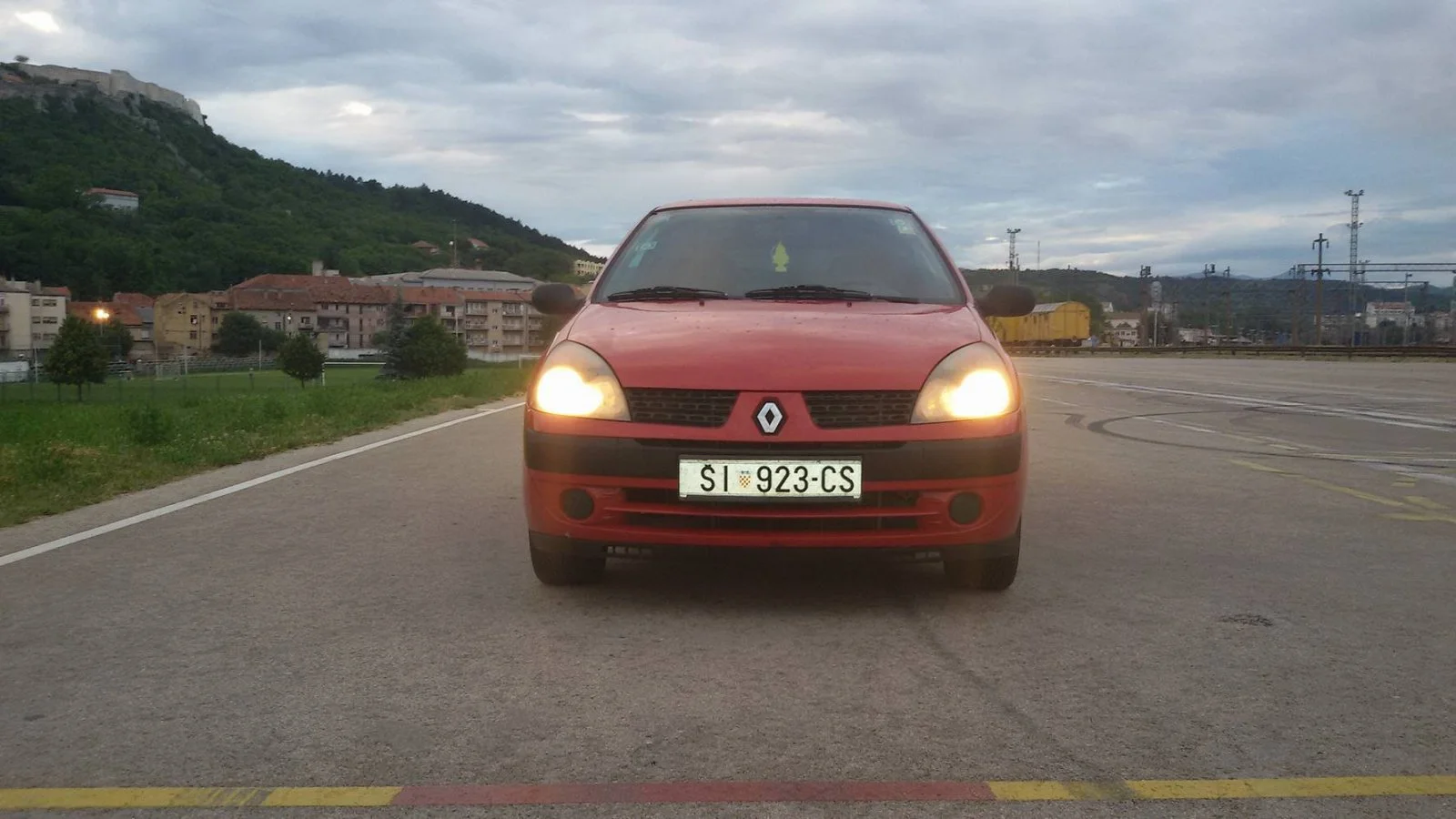

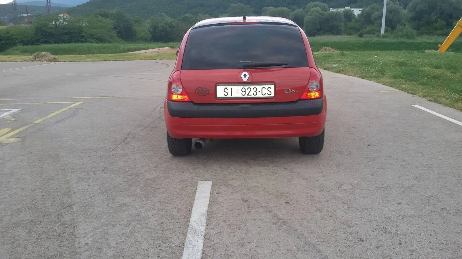

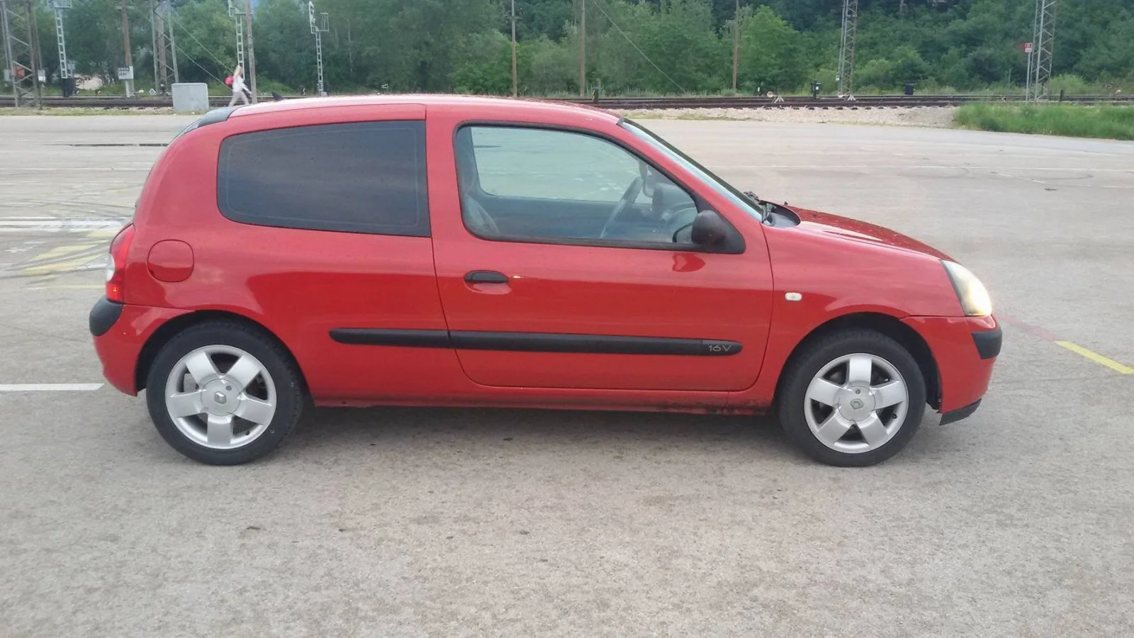

I havent tried it, i think that springs are placed as they should be i will upload you few pictures, Ive noticed that front end is higher than the back end could that be a problem?
Again leaning on drivers side. And it was much lower on front end then now.
This picture was taken month ago when my exhaust fell off

It seems highly likely that the wrong springs are fitted. If you could measure the thickness of the coil, you could compare it to the specs of the standard Renault springs.
