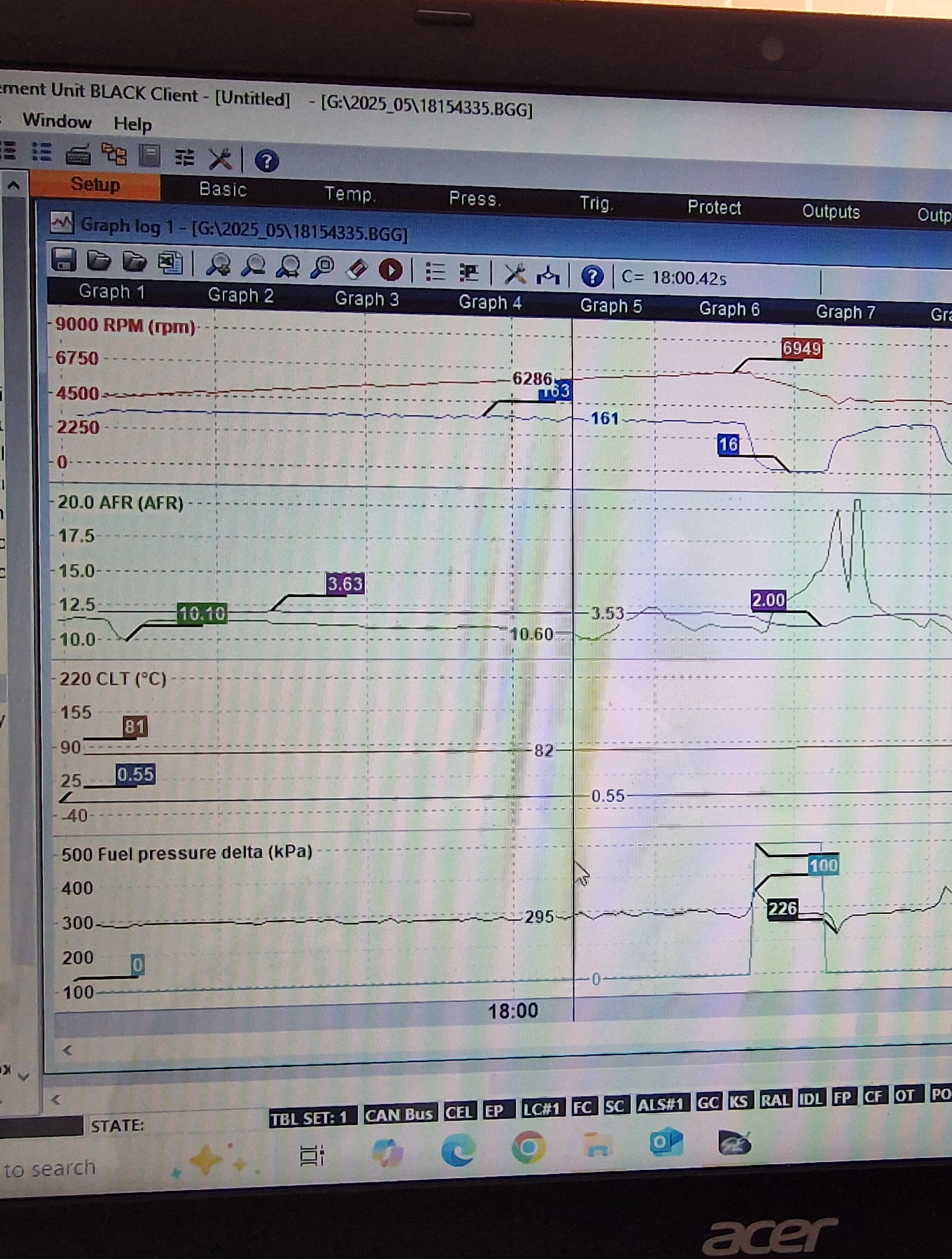

Checking out datalogs on return home ive managed to replicate its fuelling pulsation issues and its a bit lean up top so no more sends. Ill look at fitting the fuel damper and possibly the aem 400lph pump i have in stock. Then book into efi for mapping.

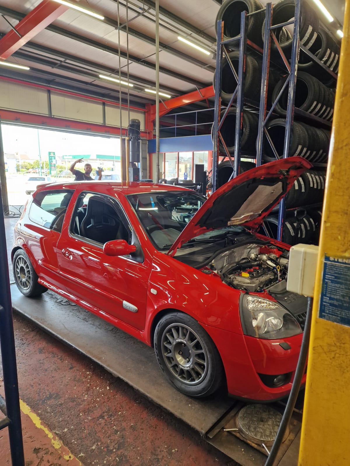

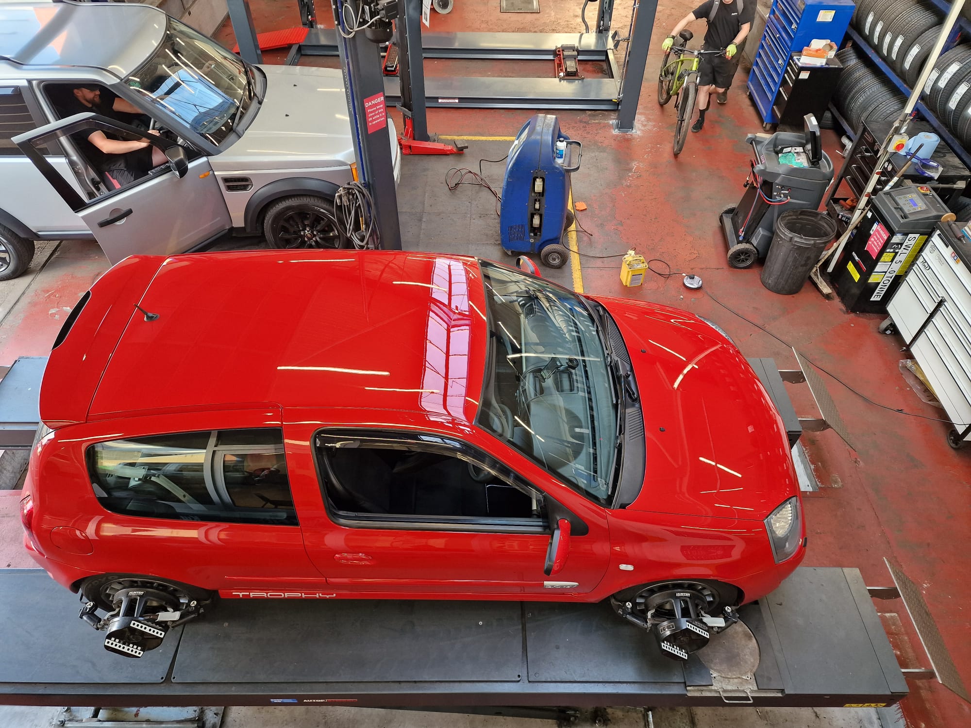

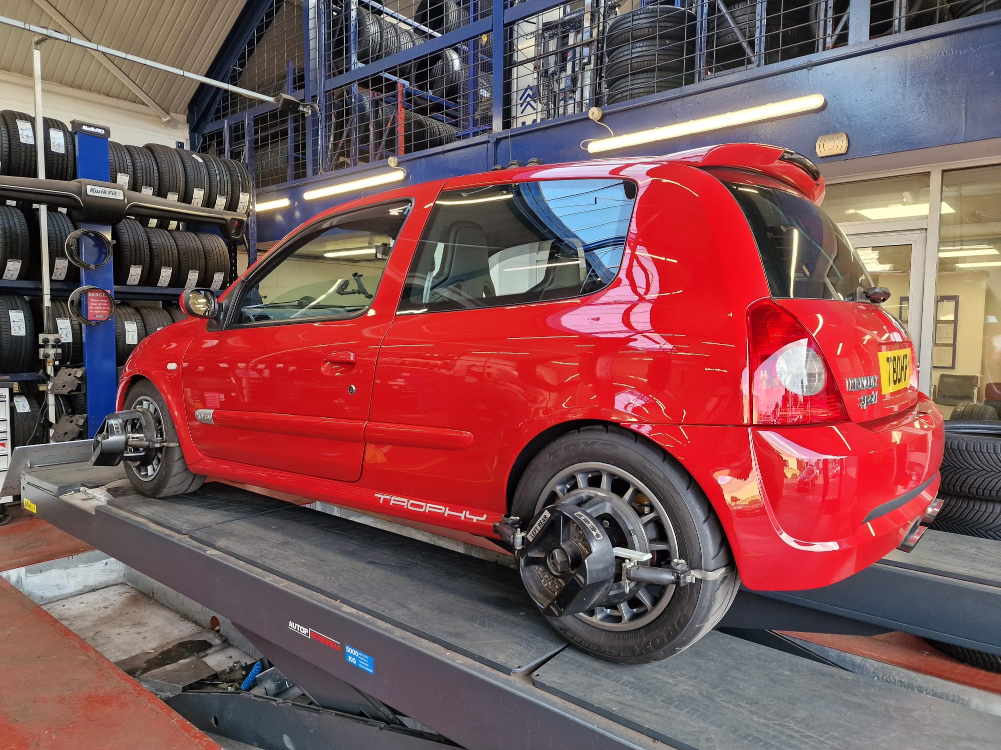

Weather outstanding today so took it out. First stop was to my mates garage for alignment as was a mile out due to new steering rack.
On geo lift.

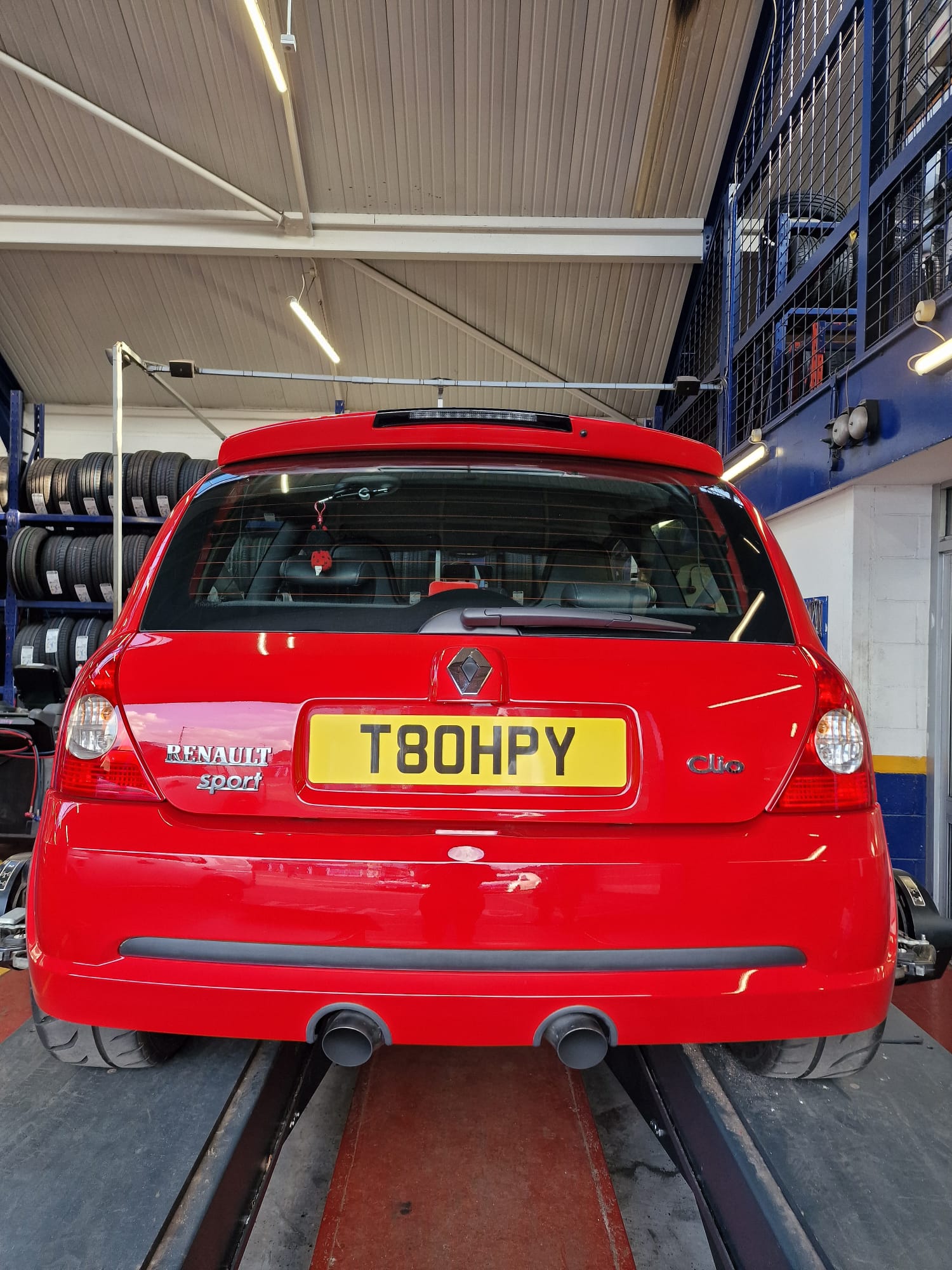

Set toe to usual ten mins of toe out overall. Camber still set at -2.5. Steering feels great now with dci rack, no play or nothing. Turn in is mega especially with the gripper lsd.
Steering wheel straight again. Meta view pic.

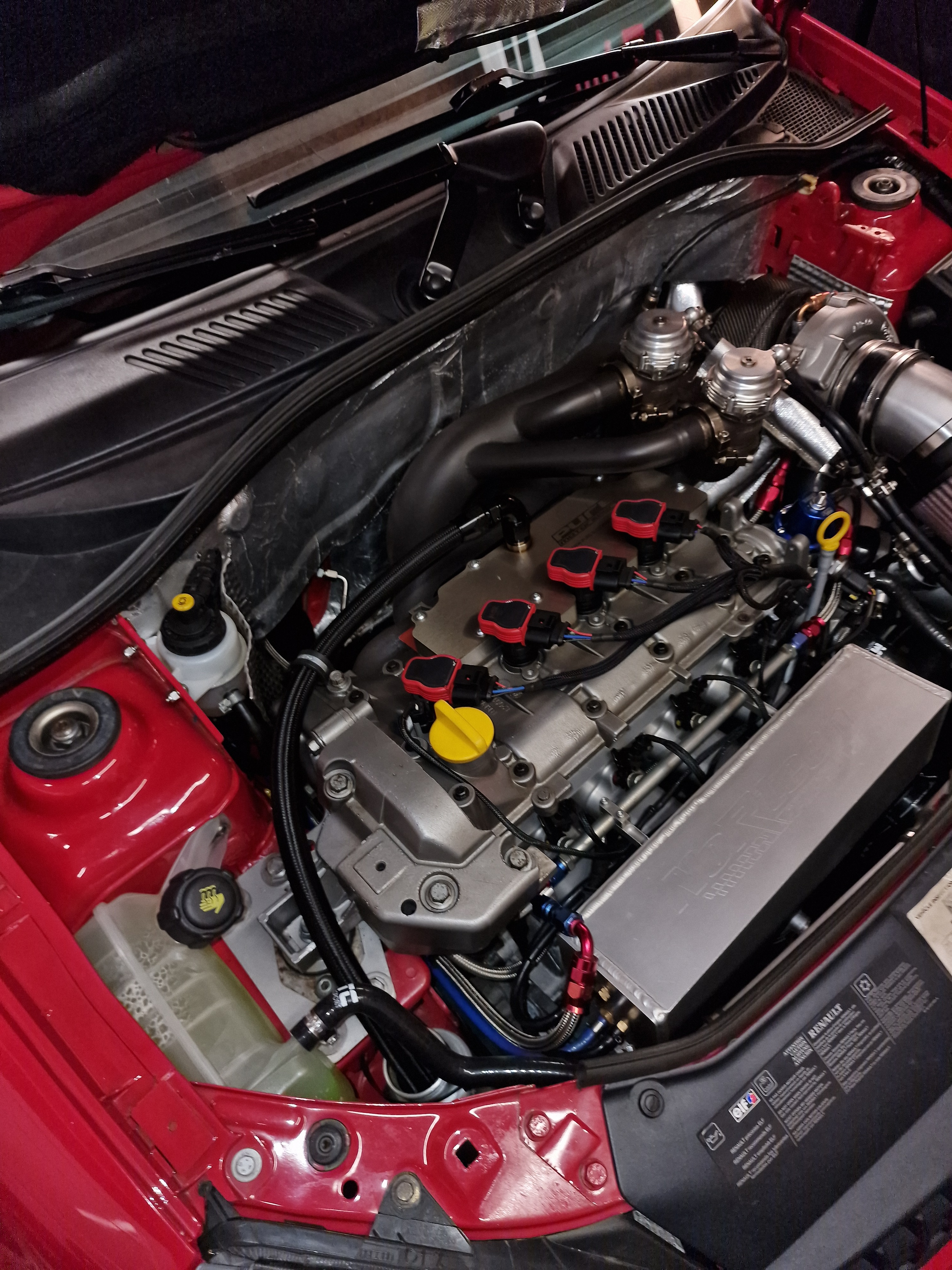

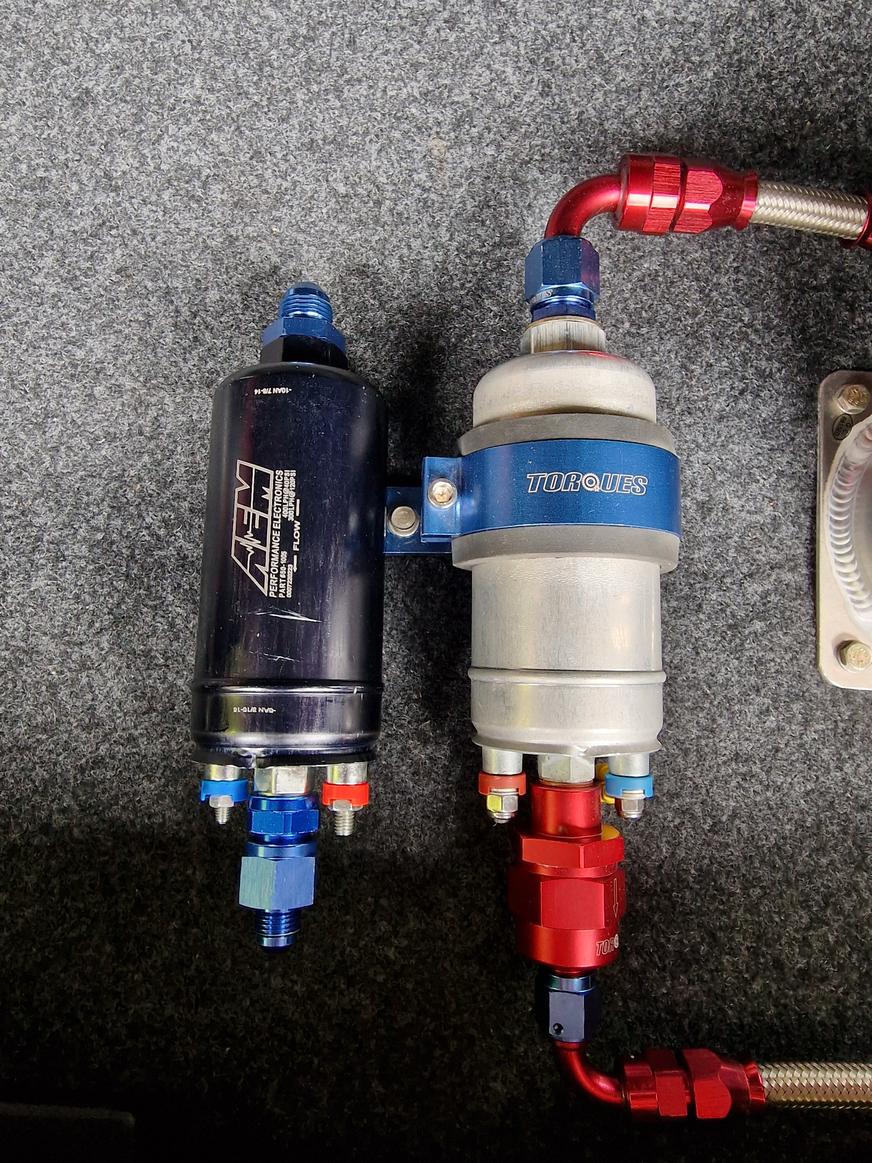

With snagging done after clutch swap, i have started looking at the fuel system issues.
To recap - had this tuned June 2022 and had issues with the fuel system going lean due to fuel pulsation/resonance around 6200rpm for a split second on wastegate pressure, lean enough to misfire. This was impossible to tune out on the dyno, Chris done loads of runs and was noted that even though it got better with higher boost pressure, it was not right. We ran out of time so had to take it away with 350hp and a safe ish map being careful at higher rpm.
I was gutted as i was expecting to max out the turbo and see good figures but it was not to be. I done a load of research on the matter including watching injector dynamics webinars and there appears to be a lot of suggestions why it happens and how to rectify.
The issue - fuel system is ptfe braided pipe with no give and large injectors causing an injector hammer effect, causing untuneable areas of the fuel map. (Quite common on some oem by all accounts.
I actually found the issue hard to replicate on the street with old clutch and fly and afr was mostly ok but it seems more prominent on new lighter fly setup for whatever reason as found on a quick datalog.
4x solutions below that apparently will work towards making it right.
1. Fuel pulse damper. Oem run them i.e. subaru and the like for similar issues. This might work but might not.
2. Fit larger fuel pump. Ive read that sticking a larger pump on can sort this out by essentially overpumping it. Just got to be careful of fuel heating causing other issues with the tune.
3. Fit a section of rubber hose in the fuel system to effectively damp the pulses.
4. Fuel regulator reference pipe length. The length and location can make a difference but reluctant to start drilling my Nortech inlet to test.

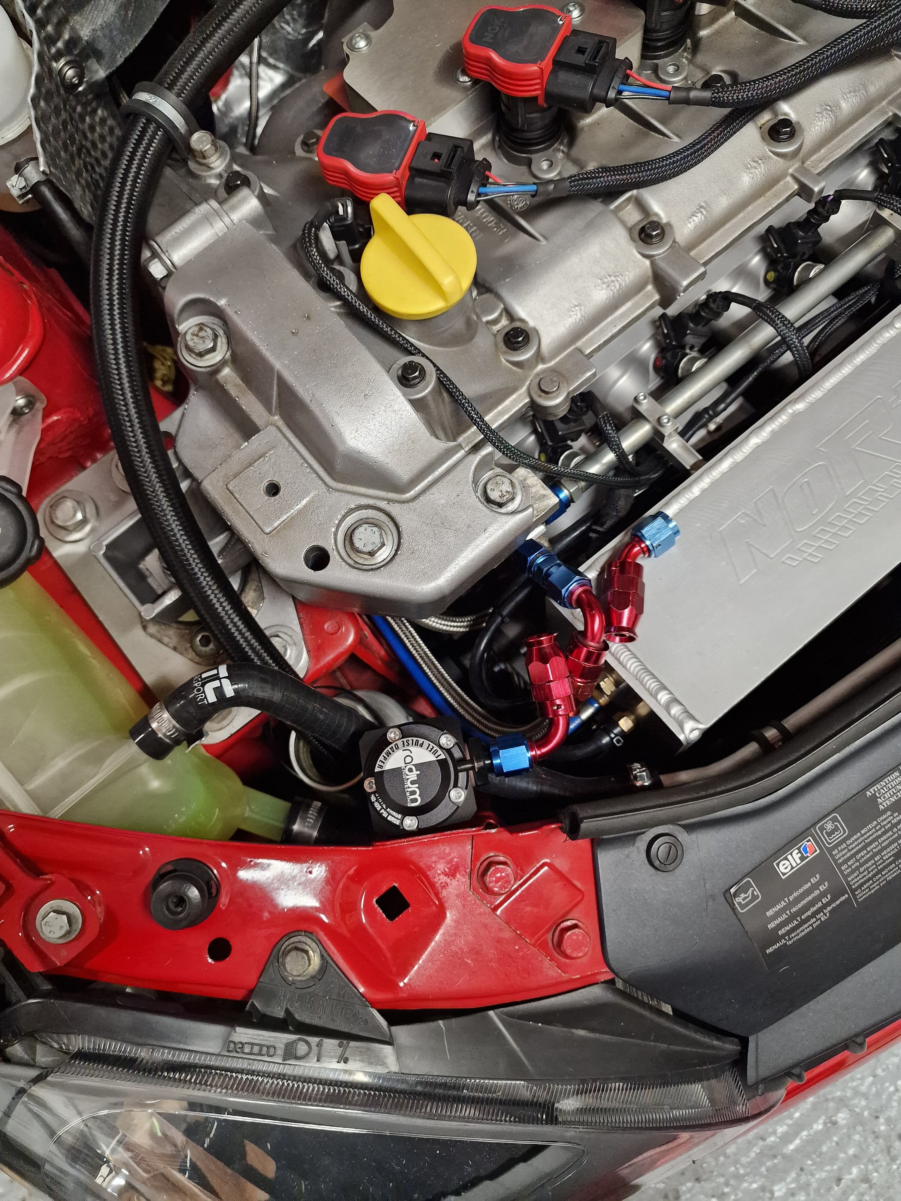

With this in mind i bought a radium pulse damper, but was advised might not do what i want.
I have also got a Aem 400lph pump to replace the bosch 044 which is 300lph iirc.
Im unsure what the best solution is but im heading towards fitting the 400lph pump. Overpump it and see what happens. Maybe chuck the pulse damper on for belt and braces.
If all else fails ill pull a section of the fuel hose off the end of the reg and go rubber to change the frequencies whilst at the dyno. I dont really want to do this as modern rubber hose seems to last 5 mins before deteriorating.
Any experiences/thoughts welcome.
Anyway with that in mind i offered up the pulse damper. Space is tight pre fuel rail, if i bin the catch tank for another area its doable.
Pump is a direct replacement.
Decisions decisions.

Could you add a loop in the system somewhere or even an extra inline filter to dampen the vibration/pulse.
I might just stick this pulse damper in as i have it, it should be easy to add in and can be removed if no good. A lot of tuners swear by them including the hp tuners lot and say it cures it, but when talking to Chris he said they are s**t :LOL:
Im trying to avoid any rubber that might go into the car on the main pump side, as rubber gives off horrendous fuel fumes in car. It had a bit of rubber bodged into the lift pump/low pressure side when i got it and the fumes were horrendous.

Decided to fit the aem 400lph pump today as had it stock and easy enough to change.
Aem 400lph straight swap for 044.

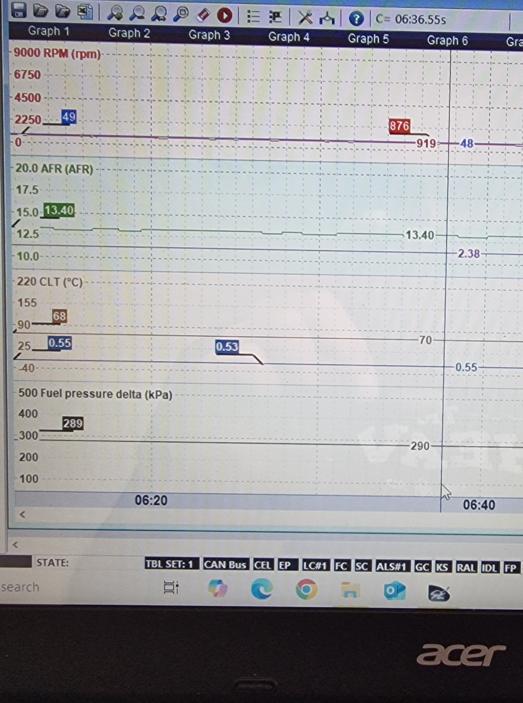

Ran both pumps to refill the swirl pot as had to drain it into a container. Noted the aem pump sounded much quieter than the old bosch 044.
Started it up and ran up to temp, noted the injectors did not sound as noisy with engine running in the garage, they used to sound horriffic before with bonnet open like a worn lifter. It appeared to idle slightly smoother than usual even though its really good considering the cam choices are pretty wild. I checked fuel pressure out of interest on tunerview via bluetooth and no real increase as expected.

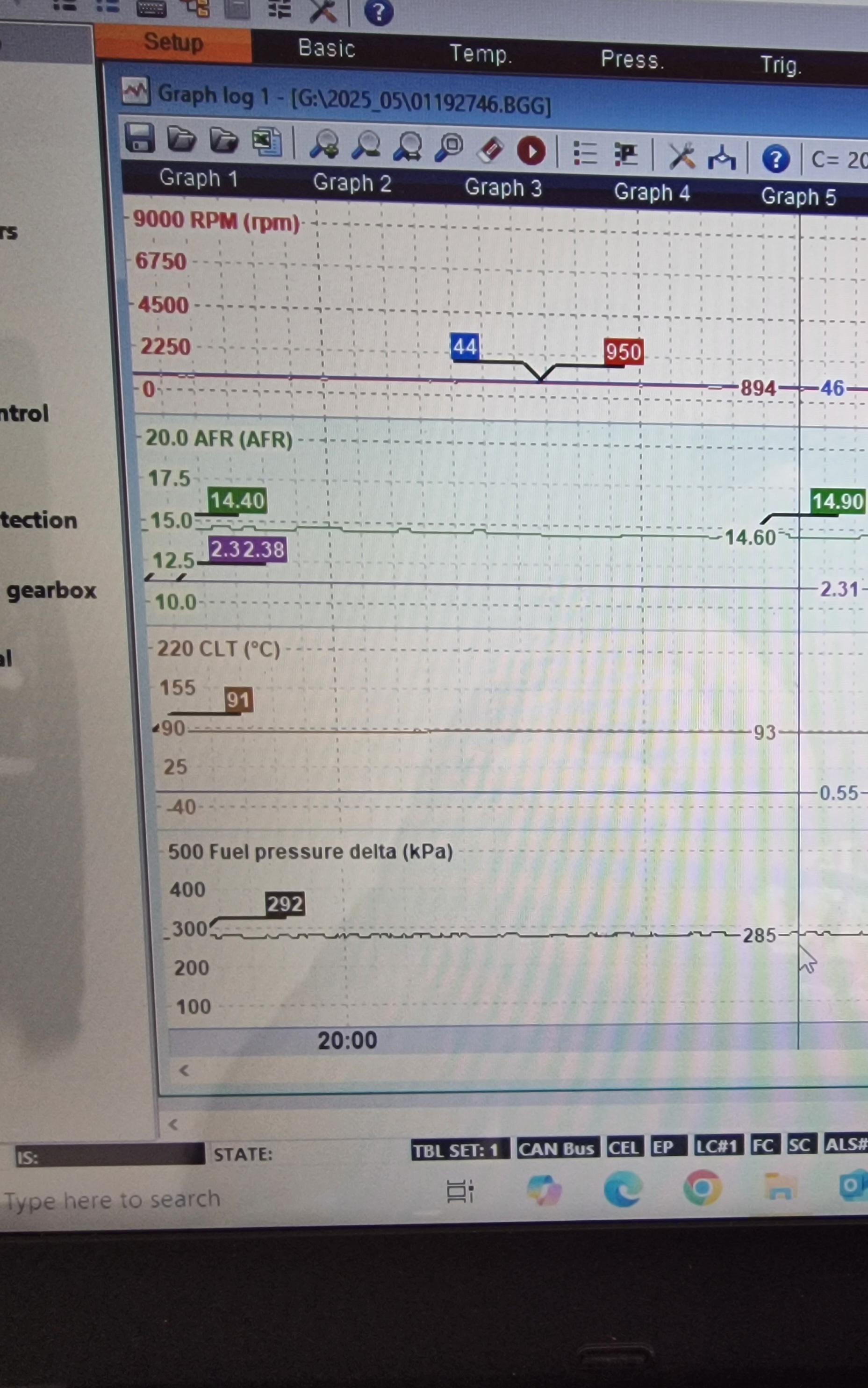

Checked the datalogs against an old one, ive been looking at the delta fuel pressure which is the raw, unfiltered data that shows every peak and trough instead of smoothed data. With the 044 pump, fuel pressure looked a bit choppy but not bad, and noted fuel pressure dropped a little in places but again not crazy.
Idle data with 044 pump, choppy.
The data with the aem pump on is another story..fuel pressure looks rock solid on the raw data.
Idle data with aem400lph.
This might or could be the solution to the issues. I know idle data is not much to go by, but with the quieter injectors and smoother data, i assume the fuel system is much happier with less "injector hammer" in the fuel rail.
Some testing in mexico required👀

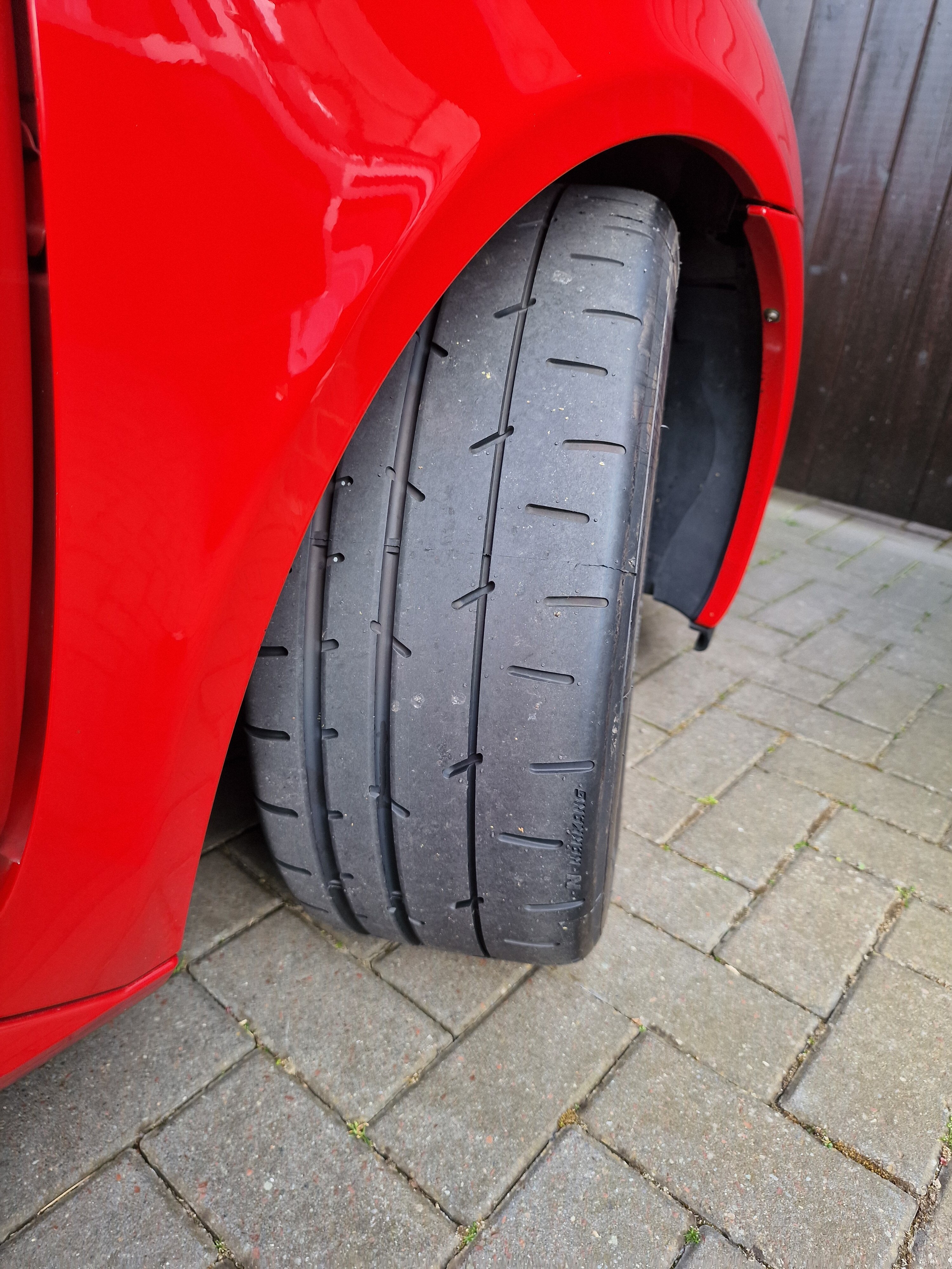

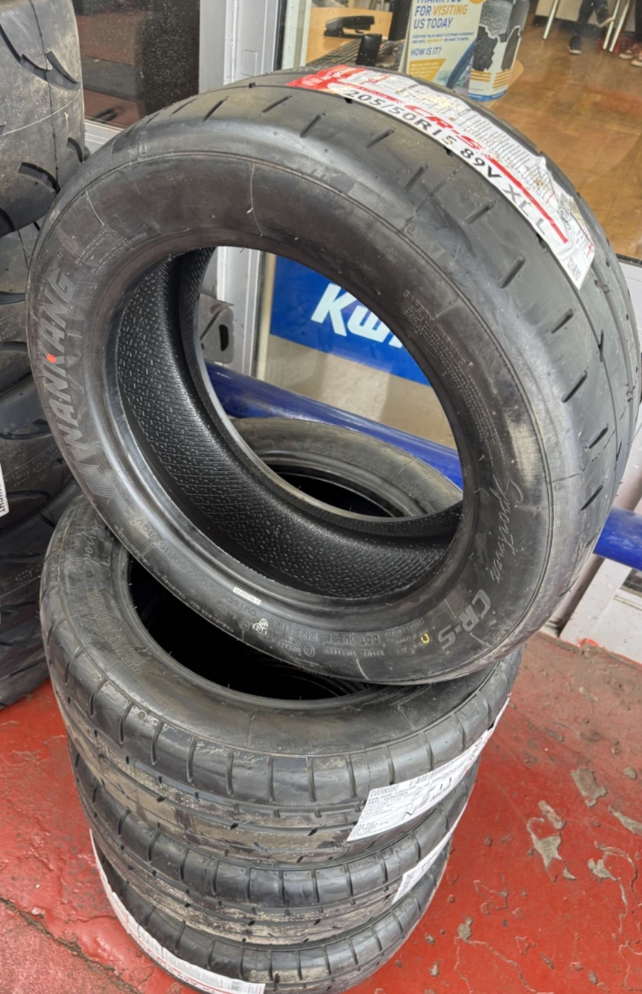

New 205 50 15 Nankang crs fitted yesterday. The profile is slightly wider than the old 205 r888r but fits without issue on et43 speedlines.
Nankang crs look sexy
Sidewall feels stiffer and turn in even more precise. There is less tyre noise than the old r888r too.
I also give it a couple of quick pulls (in mexico obvs) and the fuelling is richer on boost by around half a point and its not going horribly lean anymore at the top. Fuel pressure is not wondering all over the place but unsure if the issue is fixed enough to tune, as thinking about it as its been a few years, Chris was concerned about the peak needed in the ve map around 6500, not sure if its due to inlet design etc though. I have a couple of ideas on what i can do to furthur confirm if its fuel system related or not.

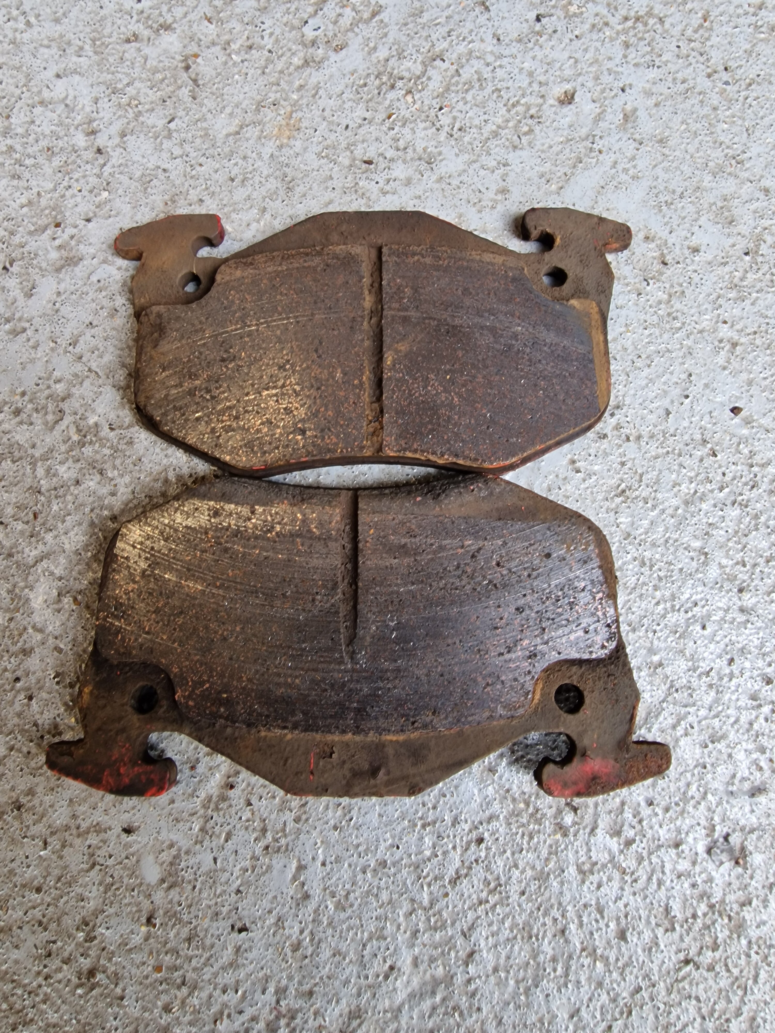

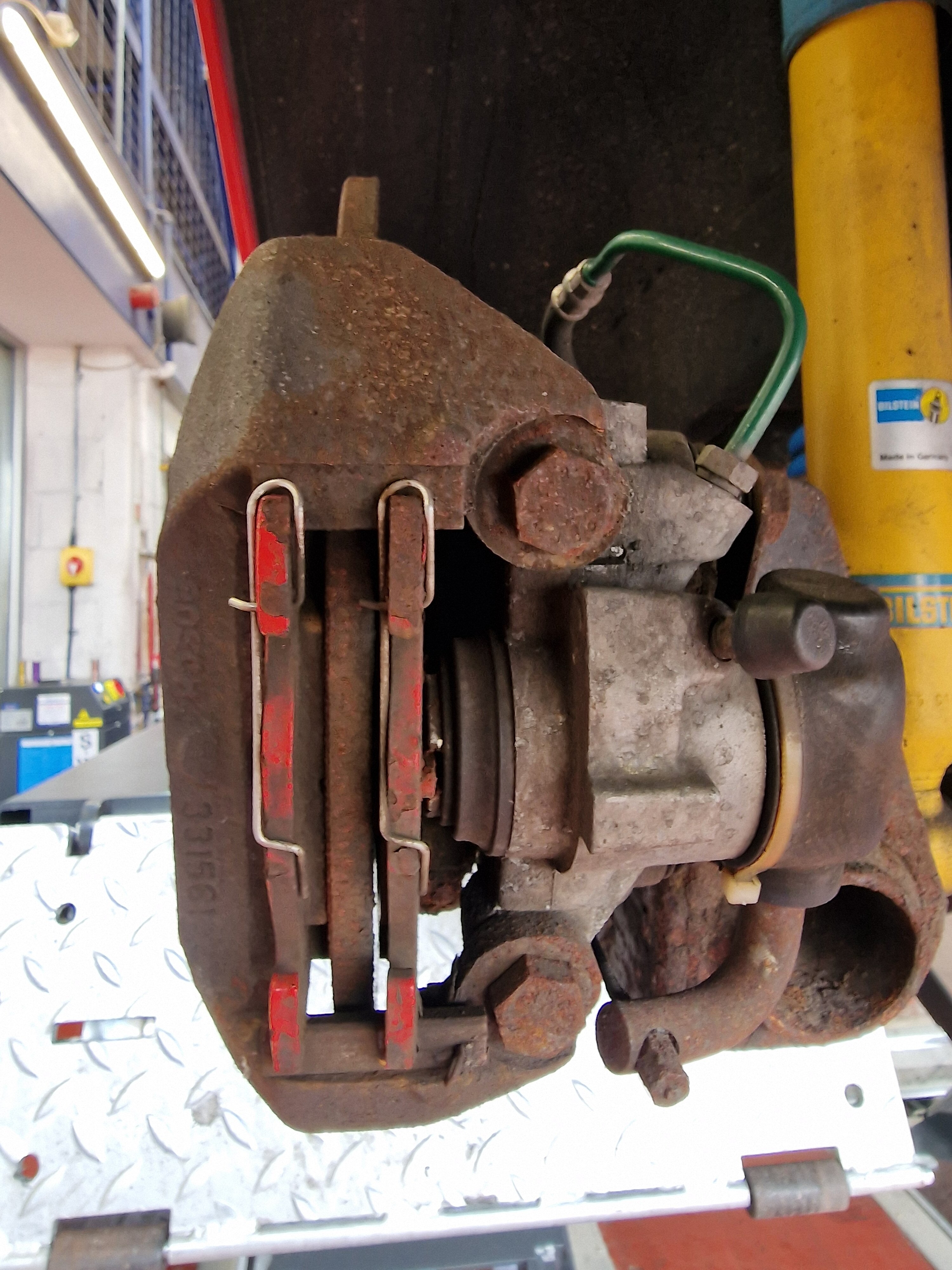

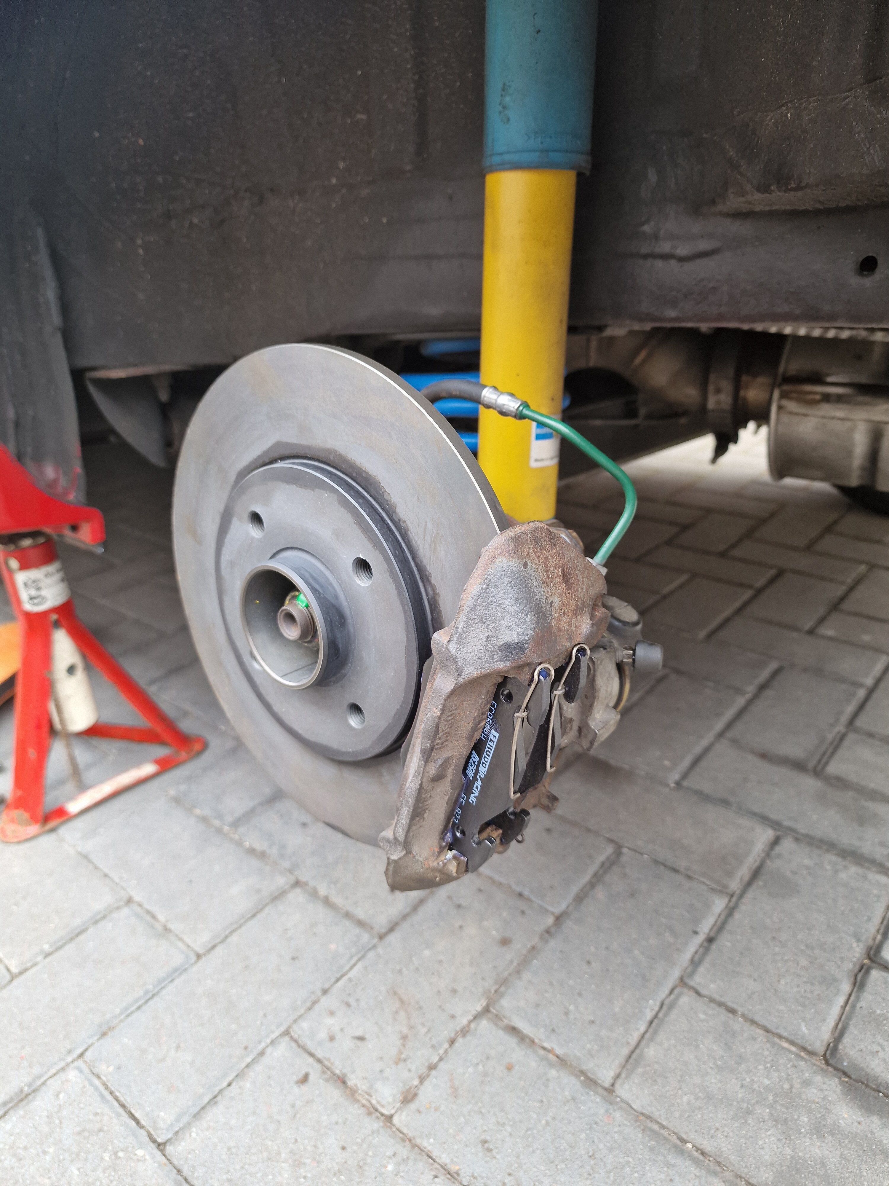

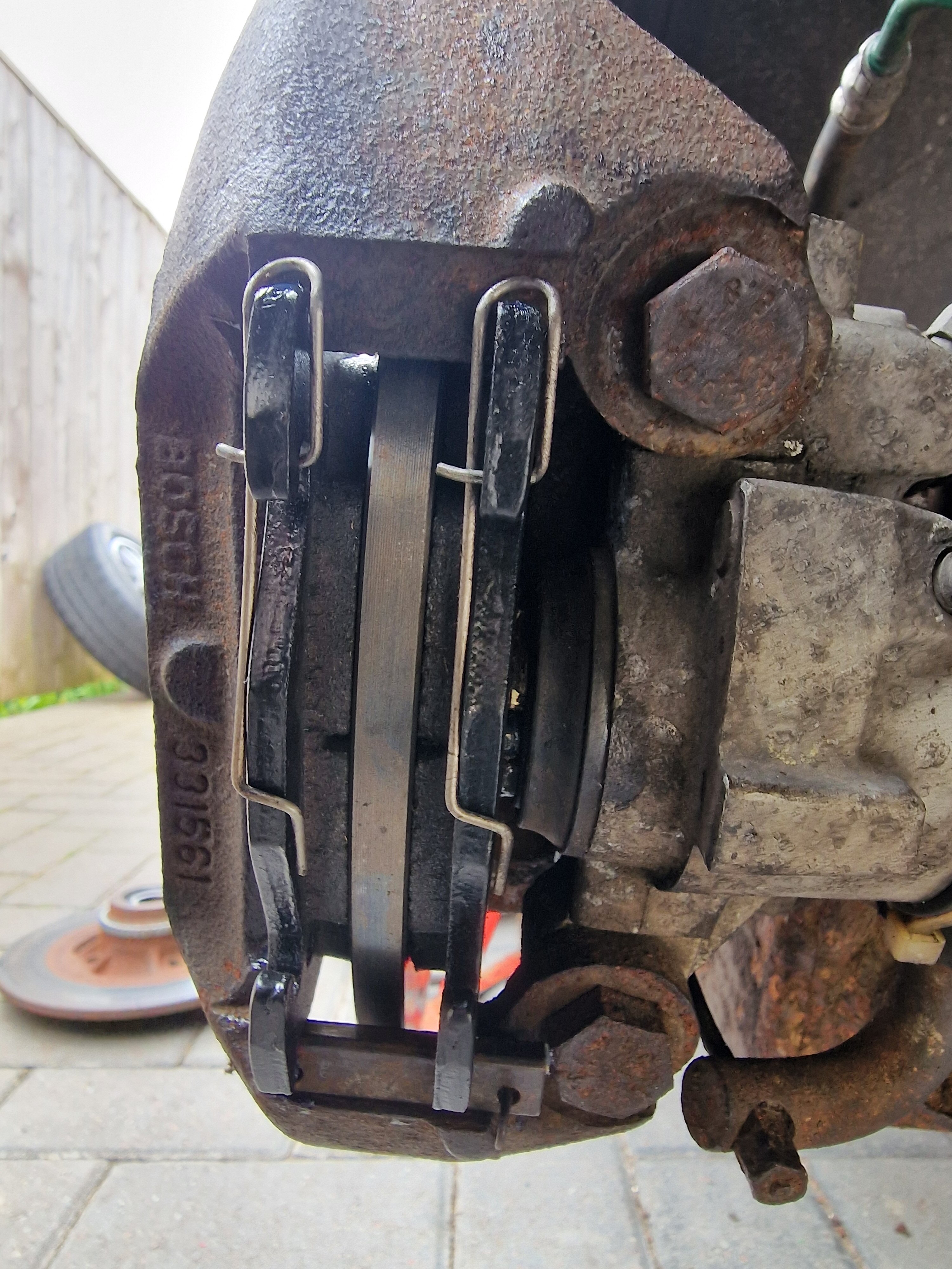

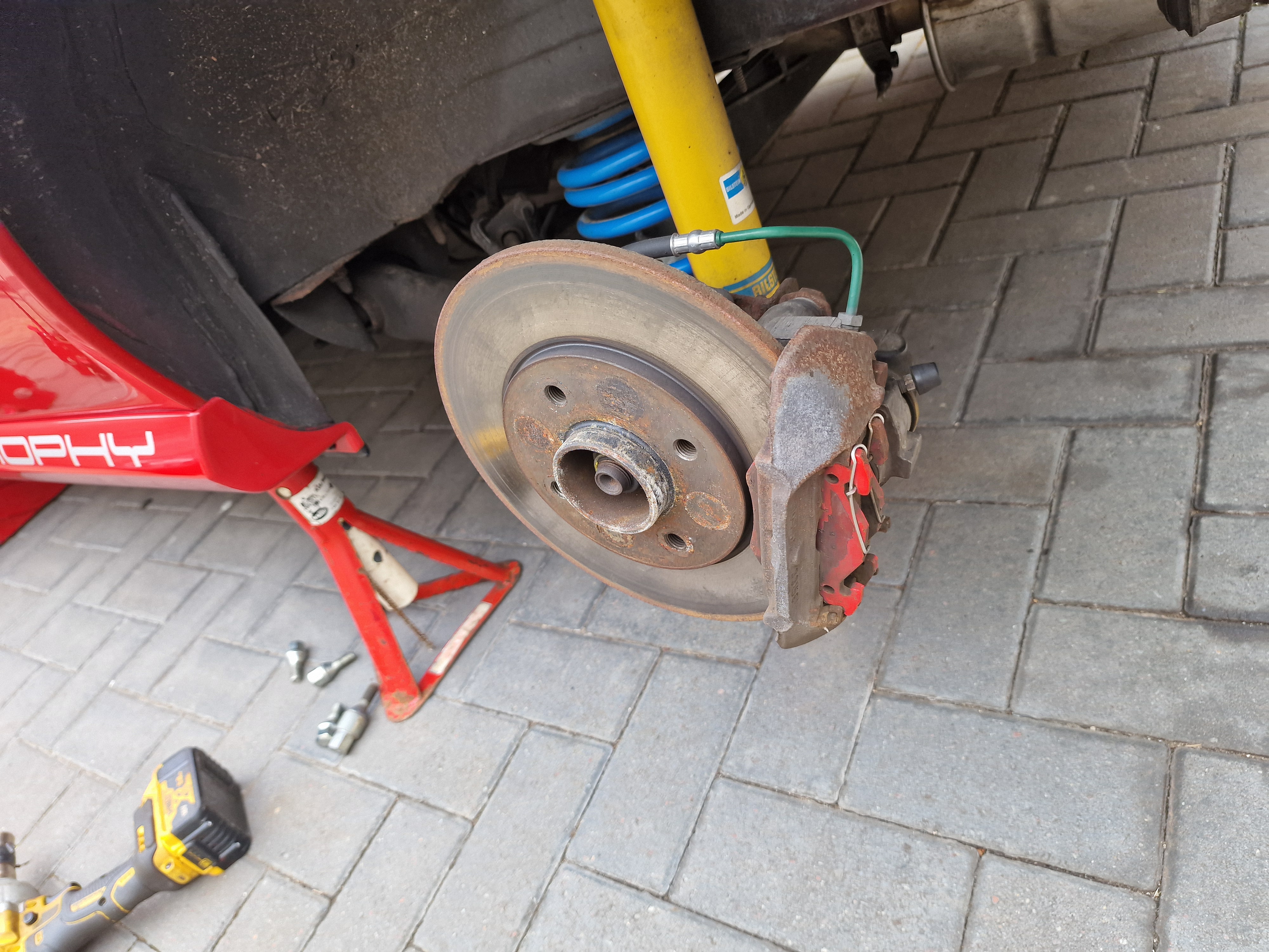

Noticed n/s rear brake pad had worn on the piss when getting tyres changed last week. Ive never touched the rear brakes on this and this was the first time the rear wheels have actually been off in my ownership - rear pad notch was not located in the piston cutout..rectified it before journey home but too little too late..
Not good.
I think the rear discs were the originals on this due to mileage, and to be fair they were still serveceable to a degree.

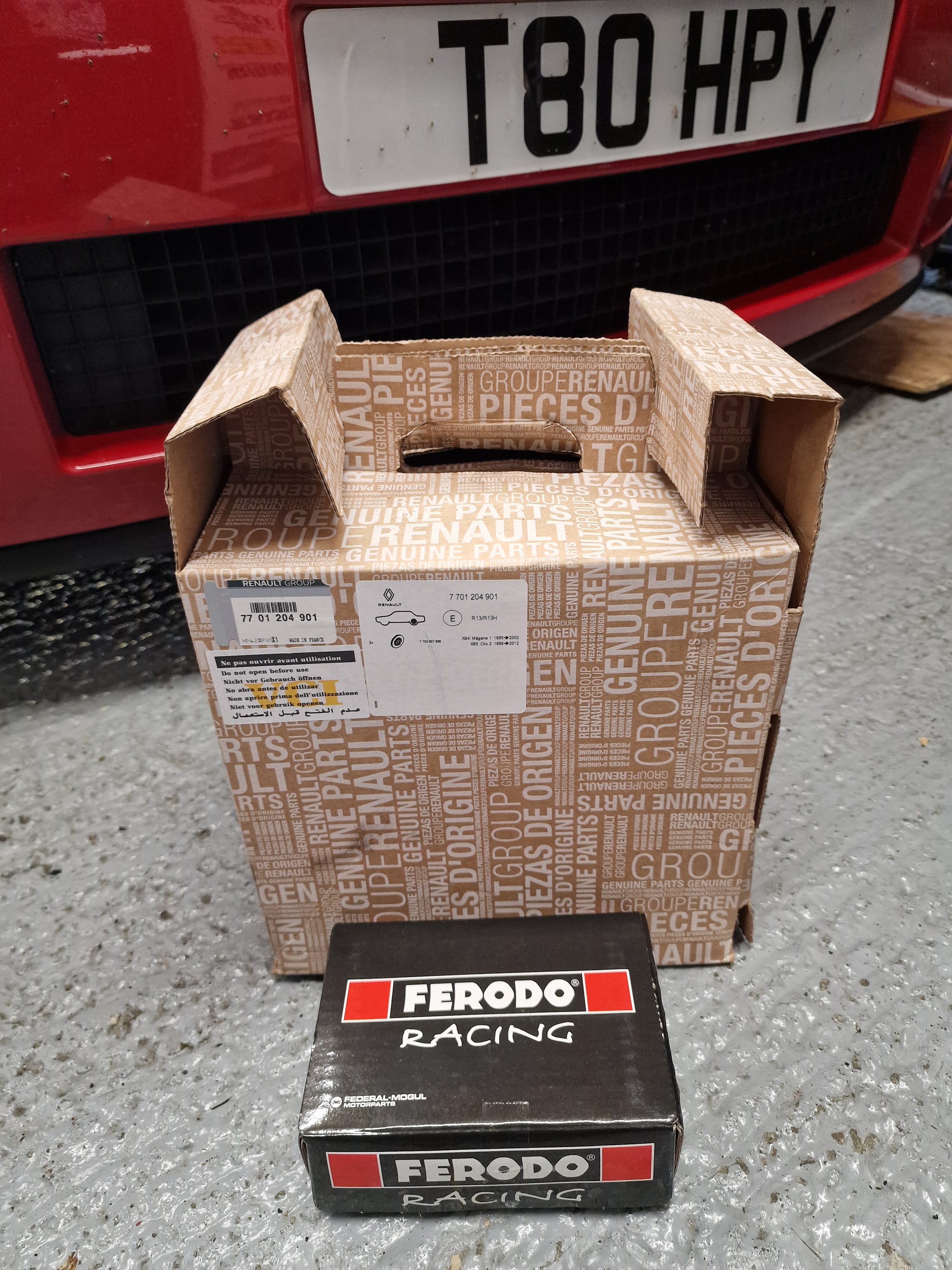

Regardless, i had planned on changing the rear discs and pads almost 3 years ago to get rid of the rust ring and scoring visble through the wheels, and had bought new oem renault rear discs that were sat on the shelf but had not got round to actually doing it. Only needed to buy pads so ordered a set of rear Ferodo DS2500 from @FrogJam Motorsport which arrived mega fast with nextday delivery.
Frogjam Motorsport delivers the goods.

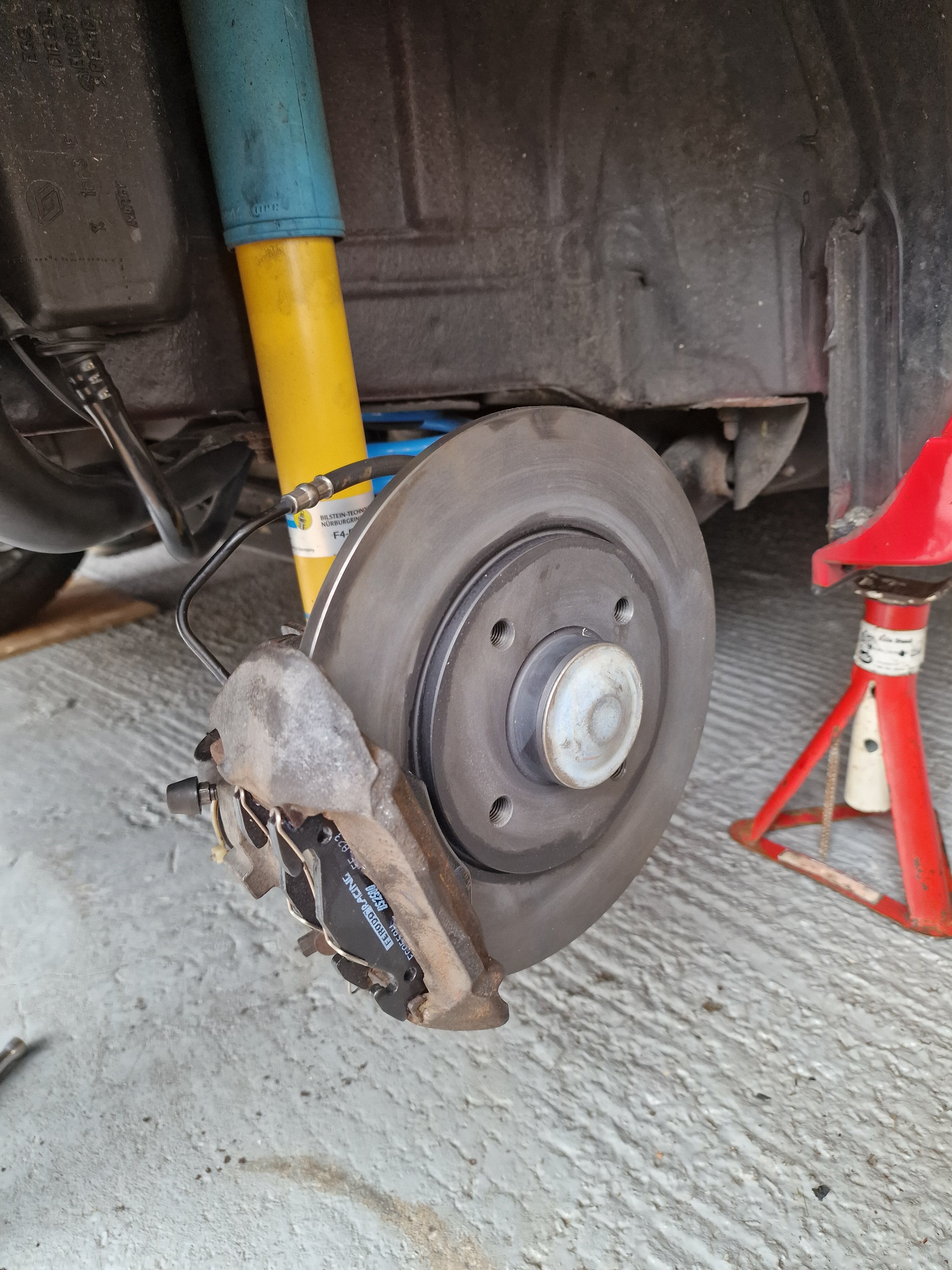

Dug out the new oem discs today and cracked on.
O/S first.
Stripped with spacer visble.
Caliper piston free/OK, cleaned/greased sliders, piston lubed with red rubber grease and sent back home, pads fitted correctly with notch lined up. Wheel bearing torqued to 175nm and caliper bolts 100nm.
N/S next
Pads be fooked. No idea on brand ebc red?? Bin for them.
Caliper piston again moved OK. Sliders on this side were stuck, removed, scotchbrite to clean, lubed and refitted..pads fitted correctly and hub nut/bolts torqued to spec.
Brake pedal pumped both sides to check the pad notch was correctly located.
In hindsight i should have cleaned caliper visible face up and painted. Ill prob leave it for now and revisit in winter, drop beam and get it powdercoated etc. Also cleaned wheels inside and out whilst there.

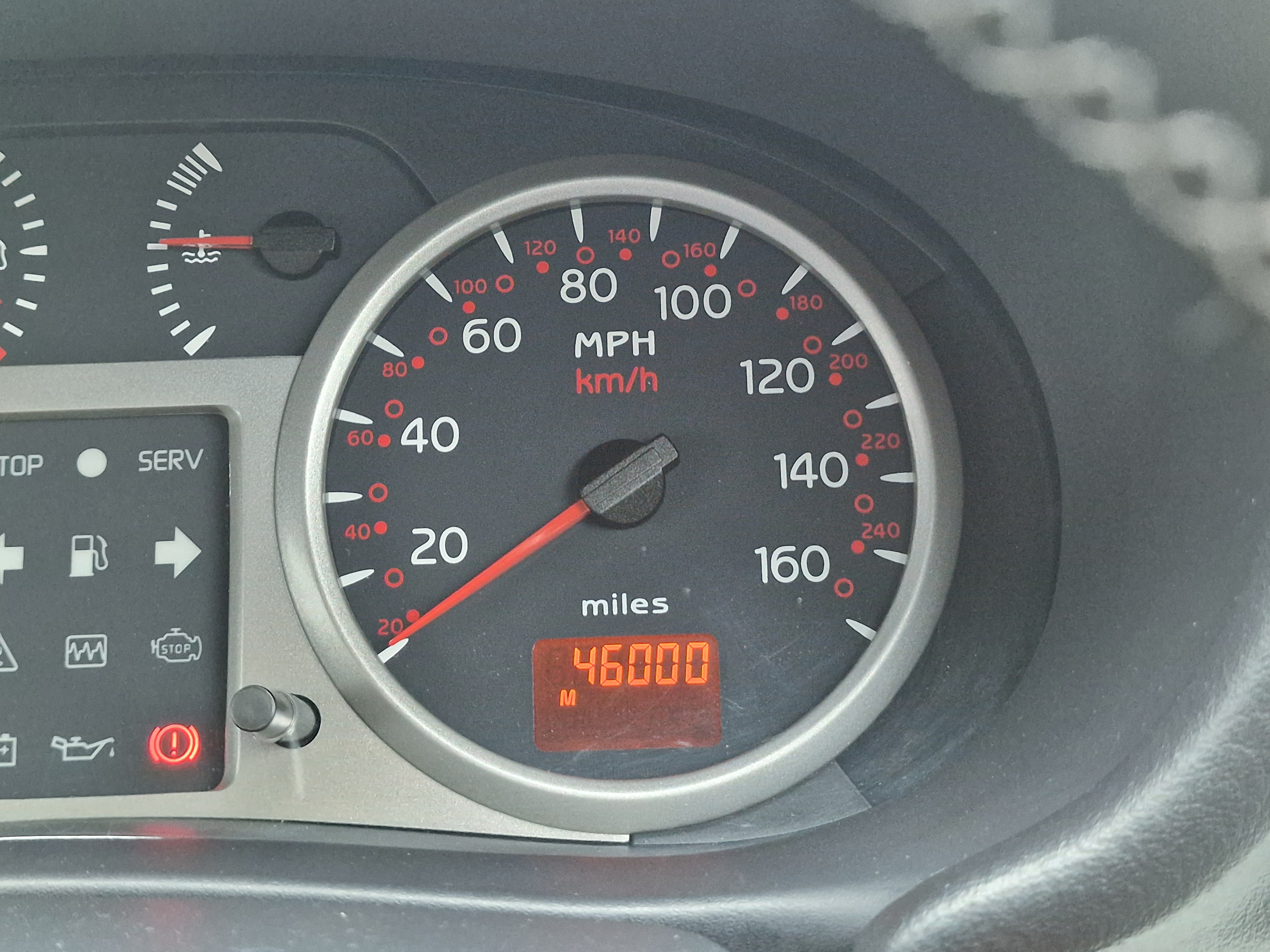

After that, took it for a run out to bed rear pads in.
Also hit 46k whilst out.

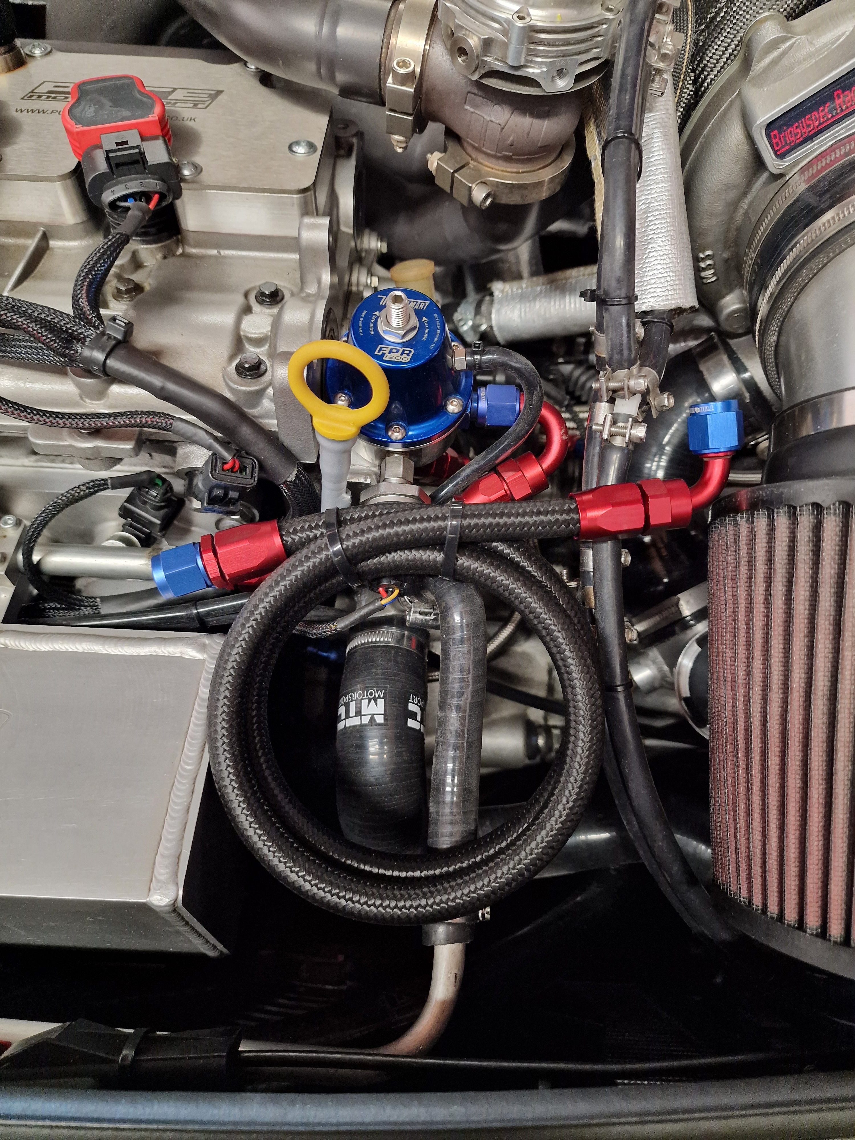

Ive knocked up a rubber fuel pipe with torques braided rubber and fast flow fittings. Hose is identical to earls pro lite 350 so good for 150deg and 300psi.
Be interesting to see if it makes a difference. Ill leave the 1mtr coiled and see if any of the fuel curve changes up top at some point in next few weeks.
Be interesting to see if it does do something, if it does ill add some rubber in as i cant be arsed chasing it any longer. If it doesnt do anything, ill be booking in for mapping/diagnostics on the dyno. Ill pay for a full day if needs be and try a load of diff fuel parts on it to get the issue sorted.

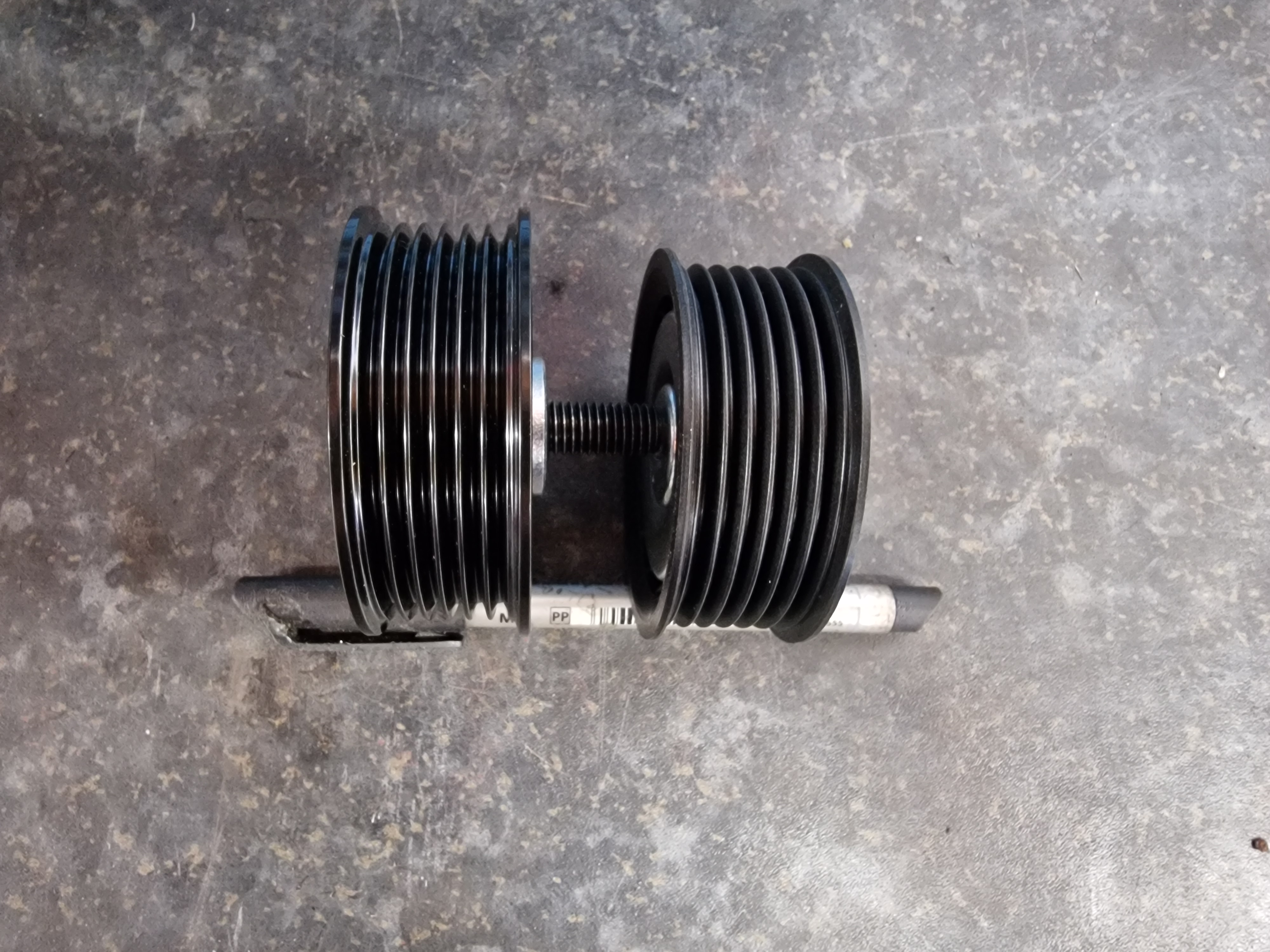

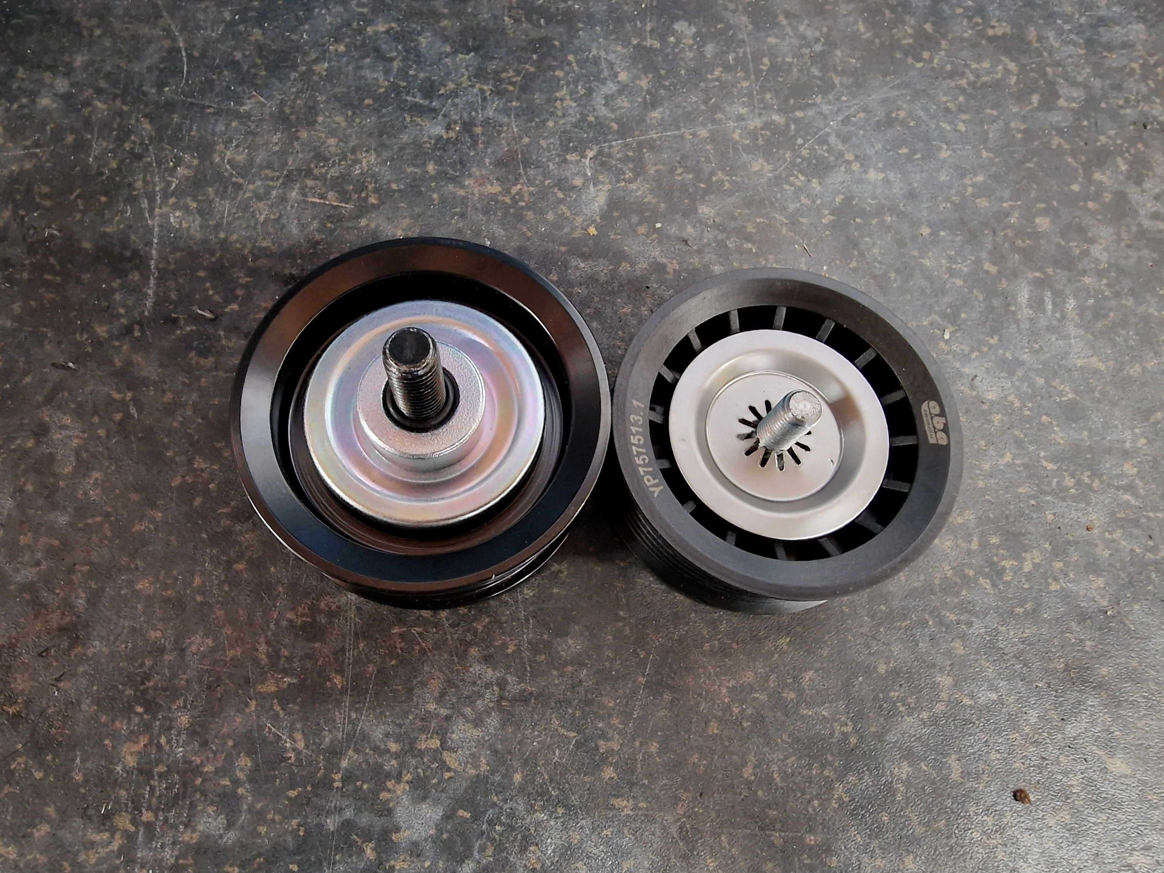

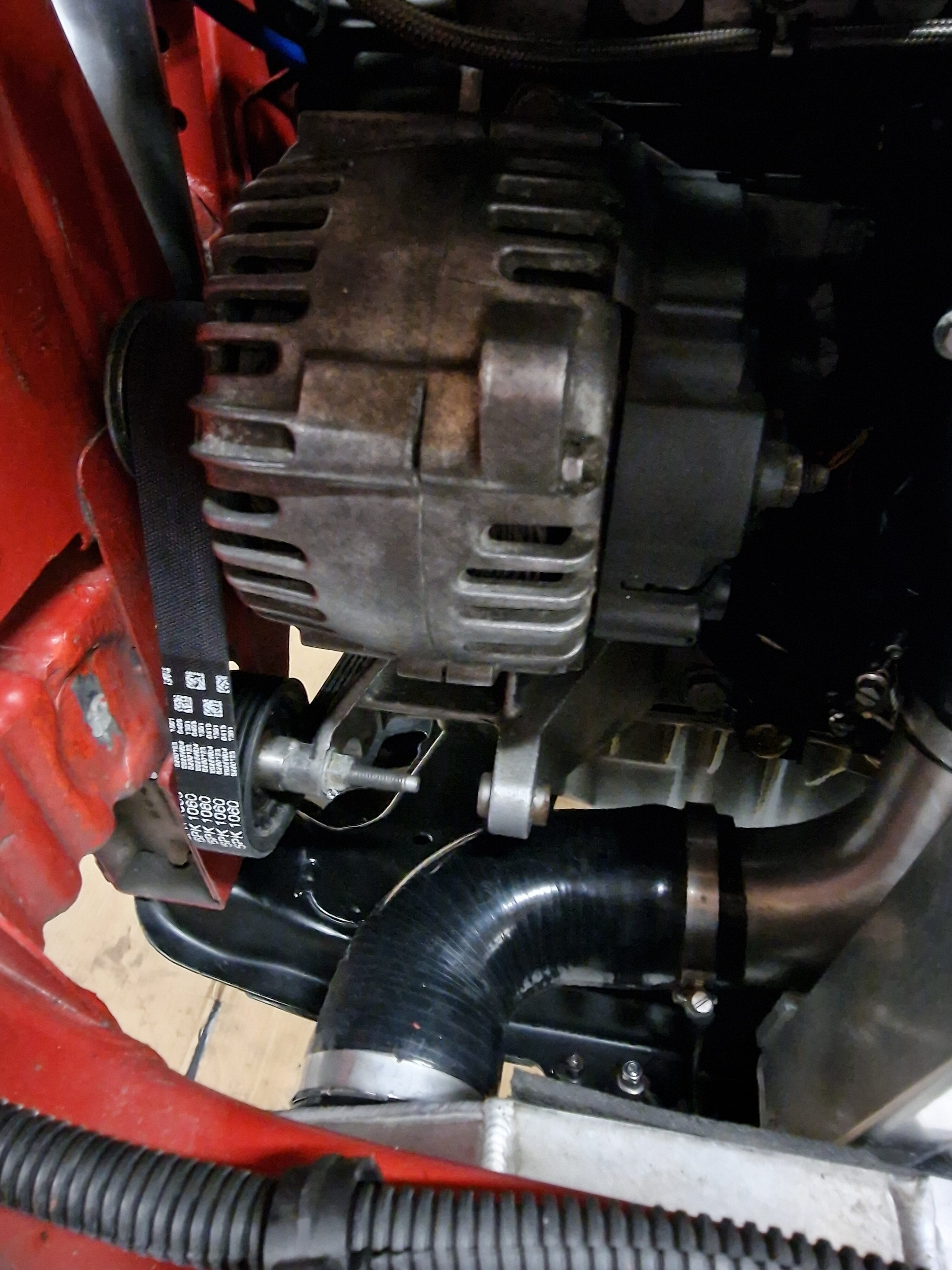

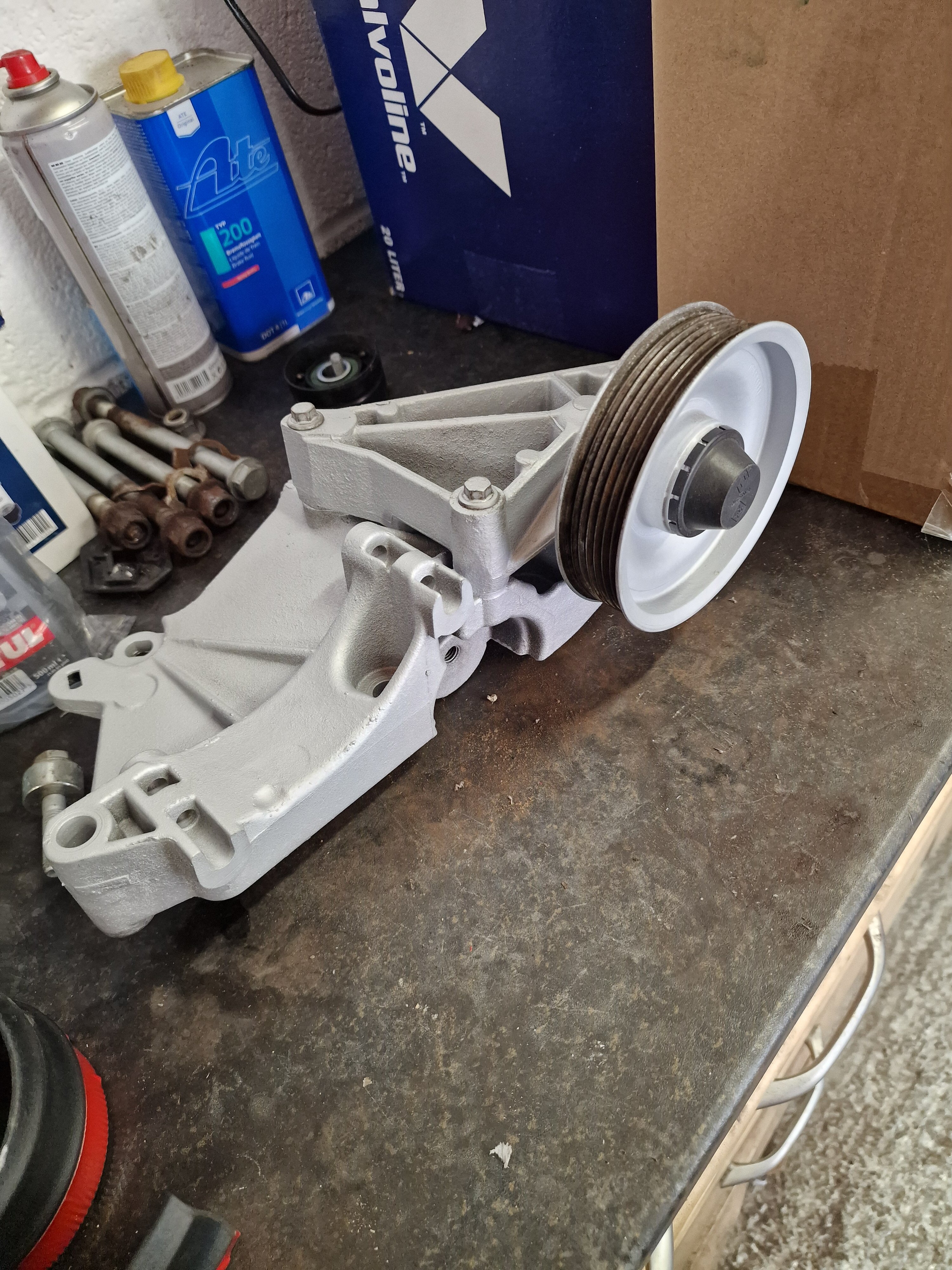

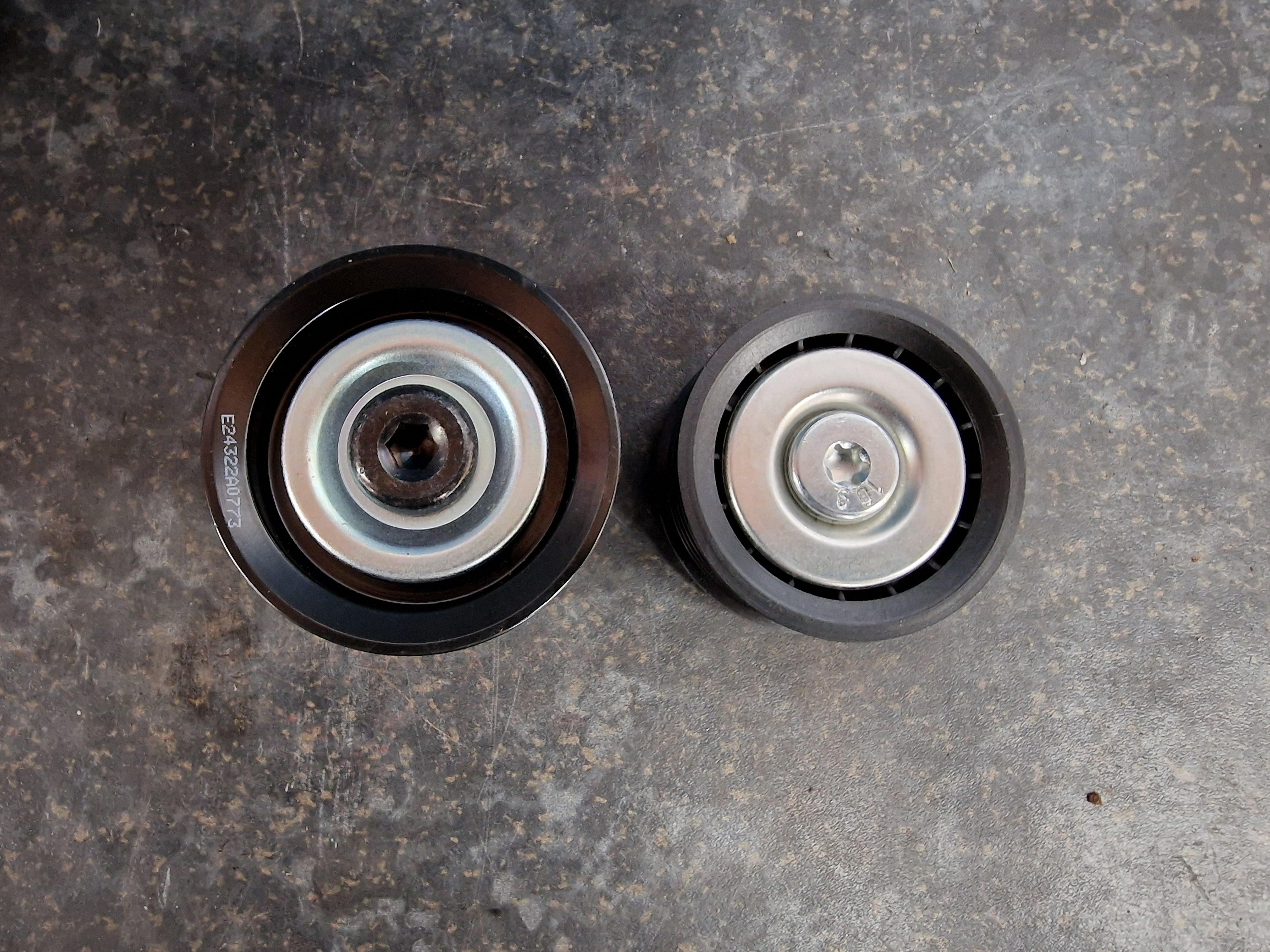

With this running megane block i have to run associated alternator setup. This runs a renault traffic alternator bracket, megane 225 alternator, aux tensioner, avensis idler pulley which assume replaces the hpas pump and 6pk 1060 belt.
Current setup.
The current setup works ok and has not given any issues. The avensis pulley is plastic, as per a lot of aux stuff these days and doesnt seem to be wearing but be nice to have a metal pulley. Ive been looking for an alloy or steel replacement for a while and looked at a couple of options.
I managed to find a 197/200 cup racer ac delete pulley which would mean going back to megane/clio alternator bracket but looked like the solution.
Tried this and no good as the larger pulley was about 10mm from the front crossmember when fitted.
So with that idea shelved started looking for other options for a similar sized pulley for current setup. Found a cnc billet pulley for a Ford Barra engine but in Australia so pricey once shipped/import.
More sniffing round found V-Ribbed Belt Deflection/Guide Pulley SKF VKM 65078 for Hyundai/kia. Sizes very similar and daft £20 so bought one.
Looks like it might go ok with slightly longer aux belt, next time bumper is off ill offer it up. Might be an option for 172 ac delete too if using oem bracket.

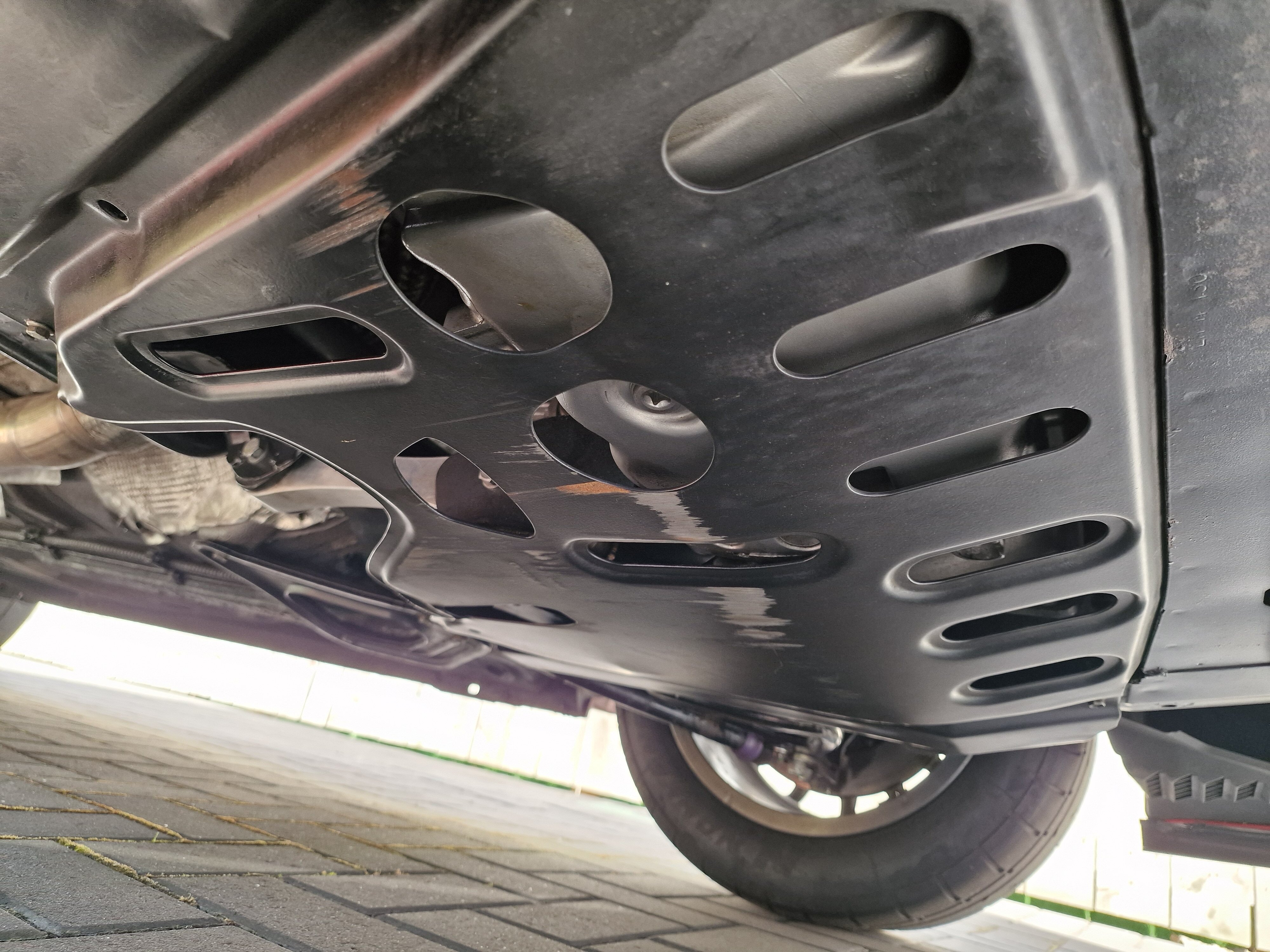

We done some b road driving on Sat and the roads had cambered/worn parts which is not good for a fairly low car. Its on bilstein b14 so pretty solid but still.
I have a renault sport metal sump guard on it as a sacrificial, as the sump and ndo gearbox diff casing is slightly lower / exposed than the oem engine and box. Sump guard is lower than the bumper luckily, lowest point of the car underside and apparantly there was a few sparks out the back with a touch of the tarmac briefly. Its not the first time this has happened however as it already had scuffs on it from when Haswell owned it, and a few off when i done the Welsh weekender a few years back.
I was interested to see how much of a hit it had took so jacked it up yesterday.
The answer was not massive as its still straight but you can see where its touched a bit😅 there was no other damage so its absolutely done its job
To stop rust i give it a once over with vht black.

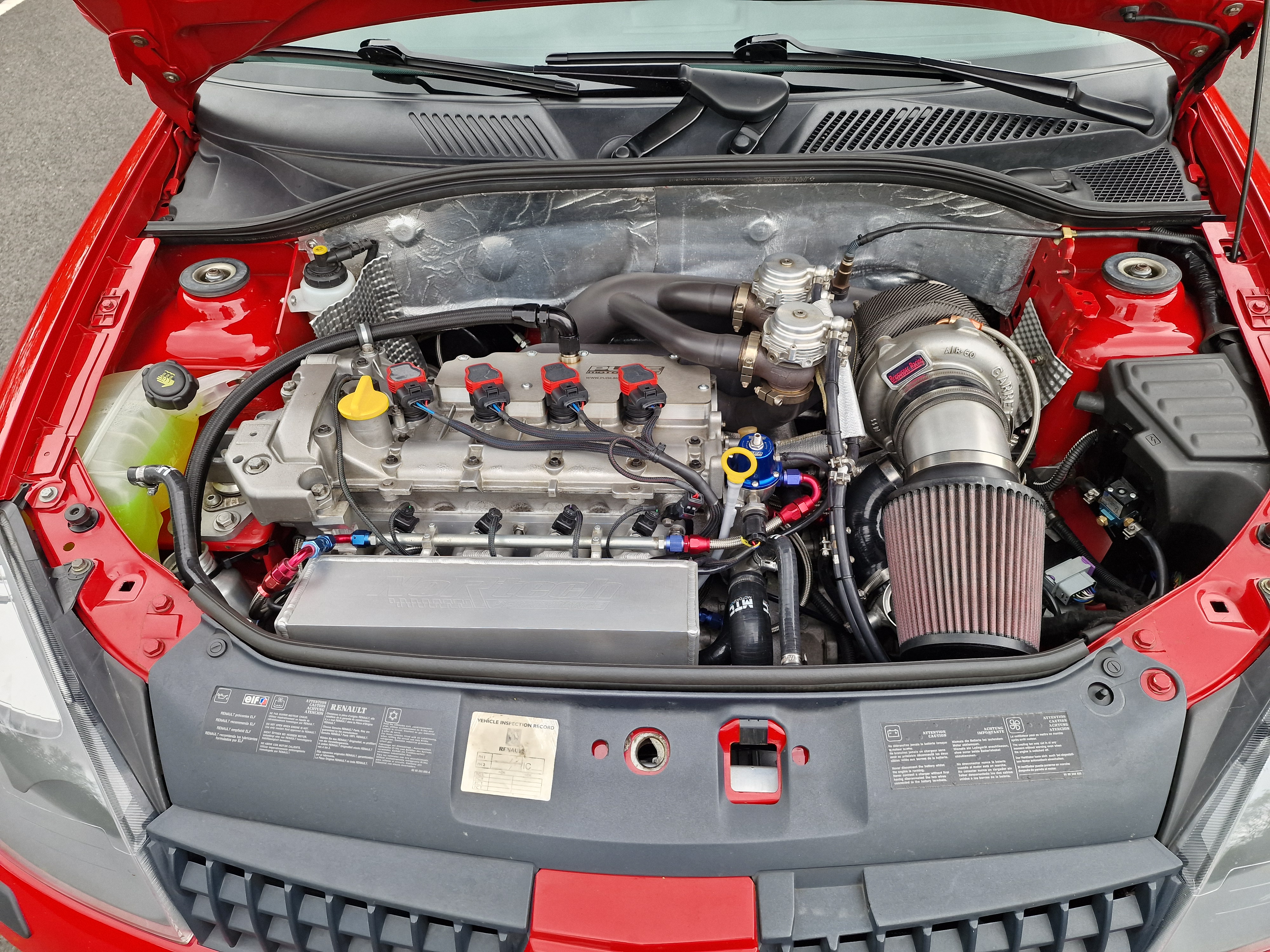

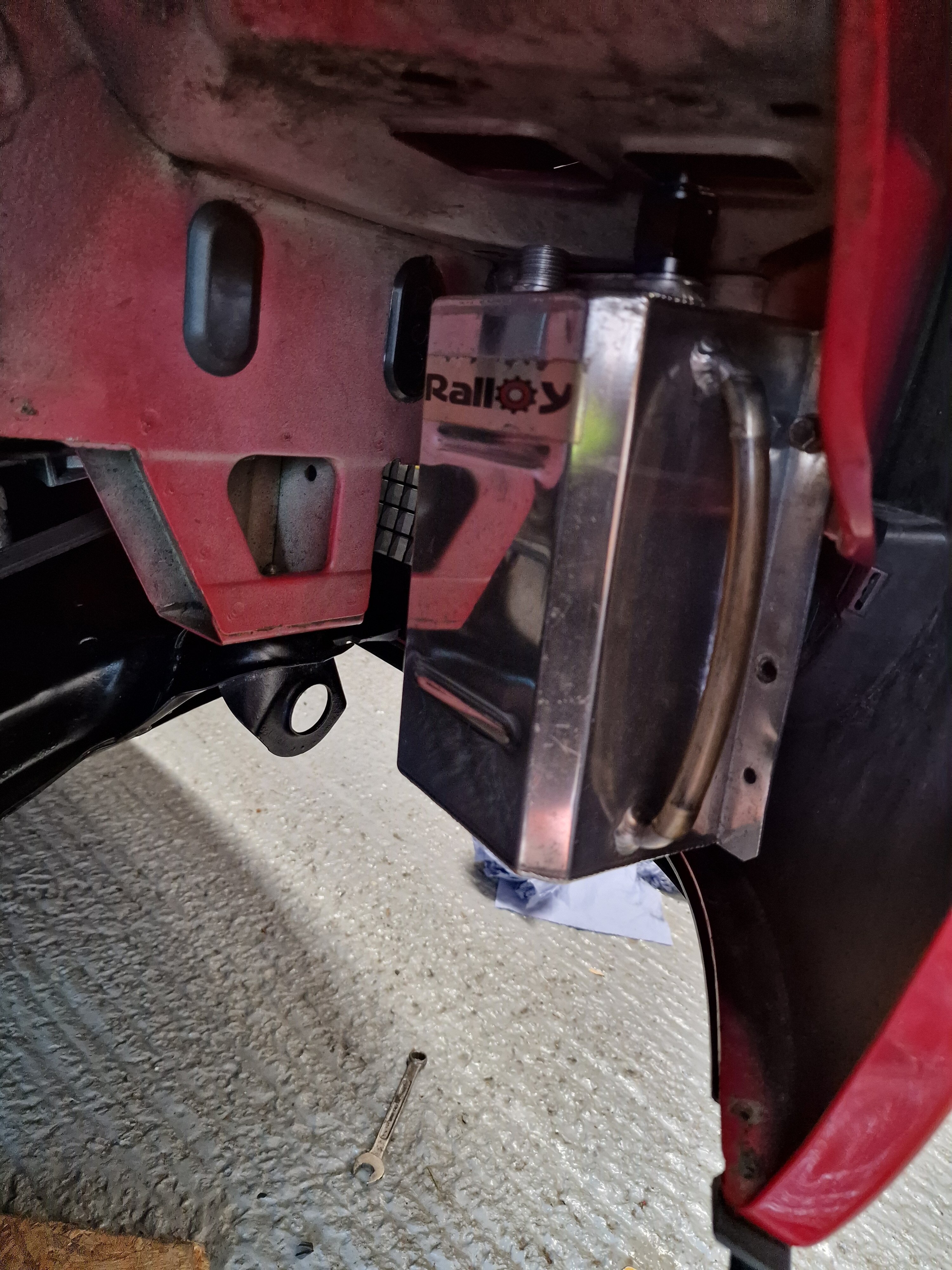

Whilst up in the air, i mocked up a 2ltr catch tank. As seen the engine bay is rammed full with turbo etc and i had a protein shaker as a catch tank for years. The 2ltr catch tank fits well in the carbon canister area with the -10an hose routed through the oem holes. Its not the ideal location but its better than above the exhaust manifold. The engine does not breathe as such so dont expect to see much in it as never put any oil in the protein beaker. Also if it does ever fill a 2ltr tank, its got big problems!! Arch liner fits straight back over the top of it.
I would have had this finished yesterday but the chinese an fitting i found in the garage fell to pieces, have ordered a torques one. Ill give the tank a buff before final fit so it looks nice and shiny before hiding behind the arch liner.

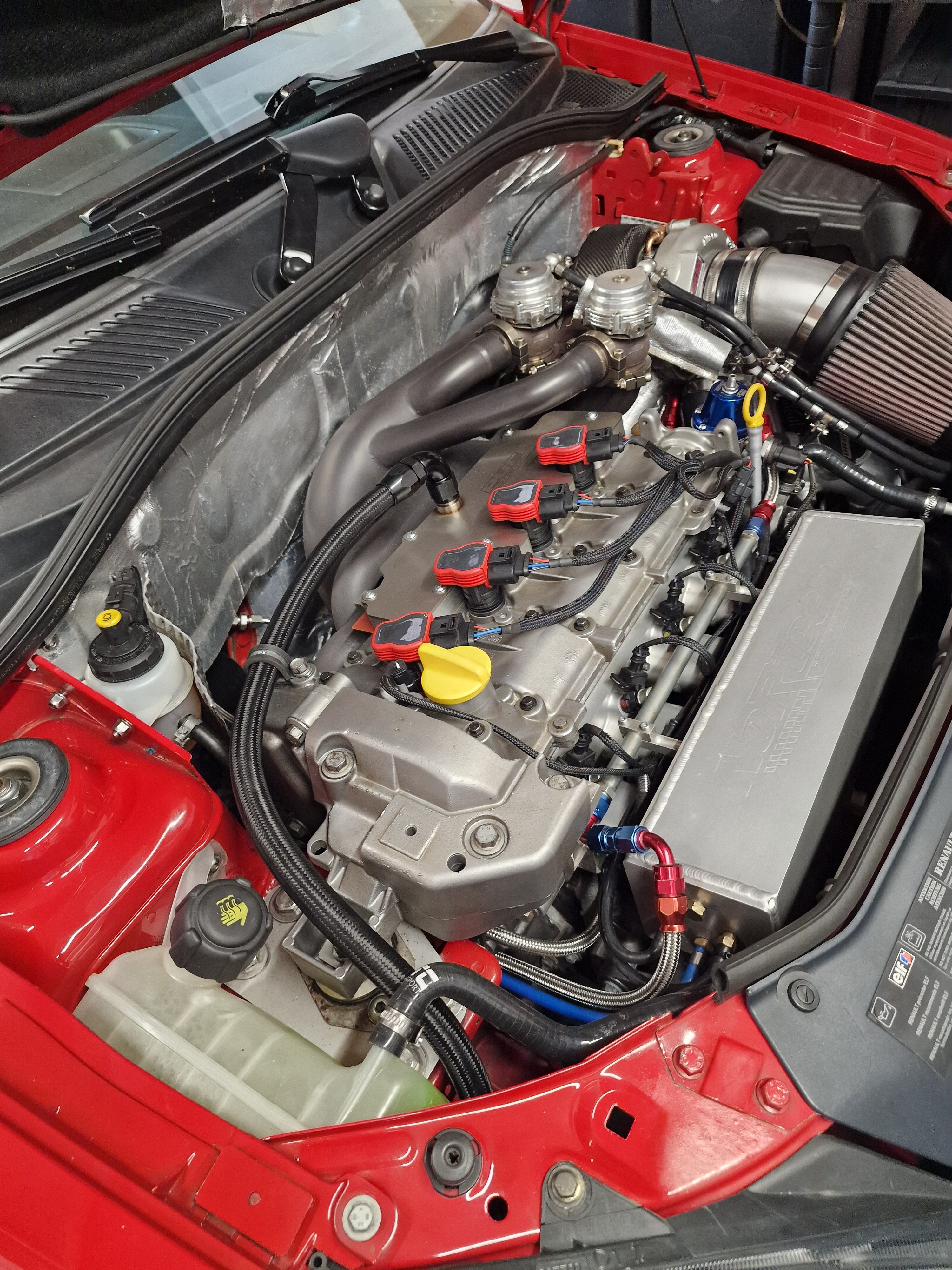

Small update.
Some/most of you noticed i had a small protein beaker as a catch tank on the Trophy. It was a last min thing before mapping and was a bit pikey but worked so sent it.
Protein beaker in corner.
Ive been looking for options for a 2ltr catch tank but no room apart from above the exhaust or the carbon canister area. I bought a cheap 2ltr ralloy catch tank to offer up and it looked like it was a goer.
Location is not ideal but everywhere is a compromise. It doesnt breathe heavy infact puts nothing in the tank normally, and if it fills 2ltrs, we have large problems so not too concerned. Can vac pump it out in situ easy to empty if needs be.
Made up an An10 hose with fittings both ends. Plumbed in and looks fairly tidy. Arch liner back in and nothing to be seen.
Thanks for reading!!
