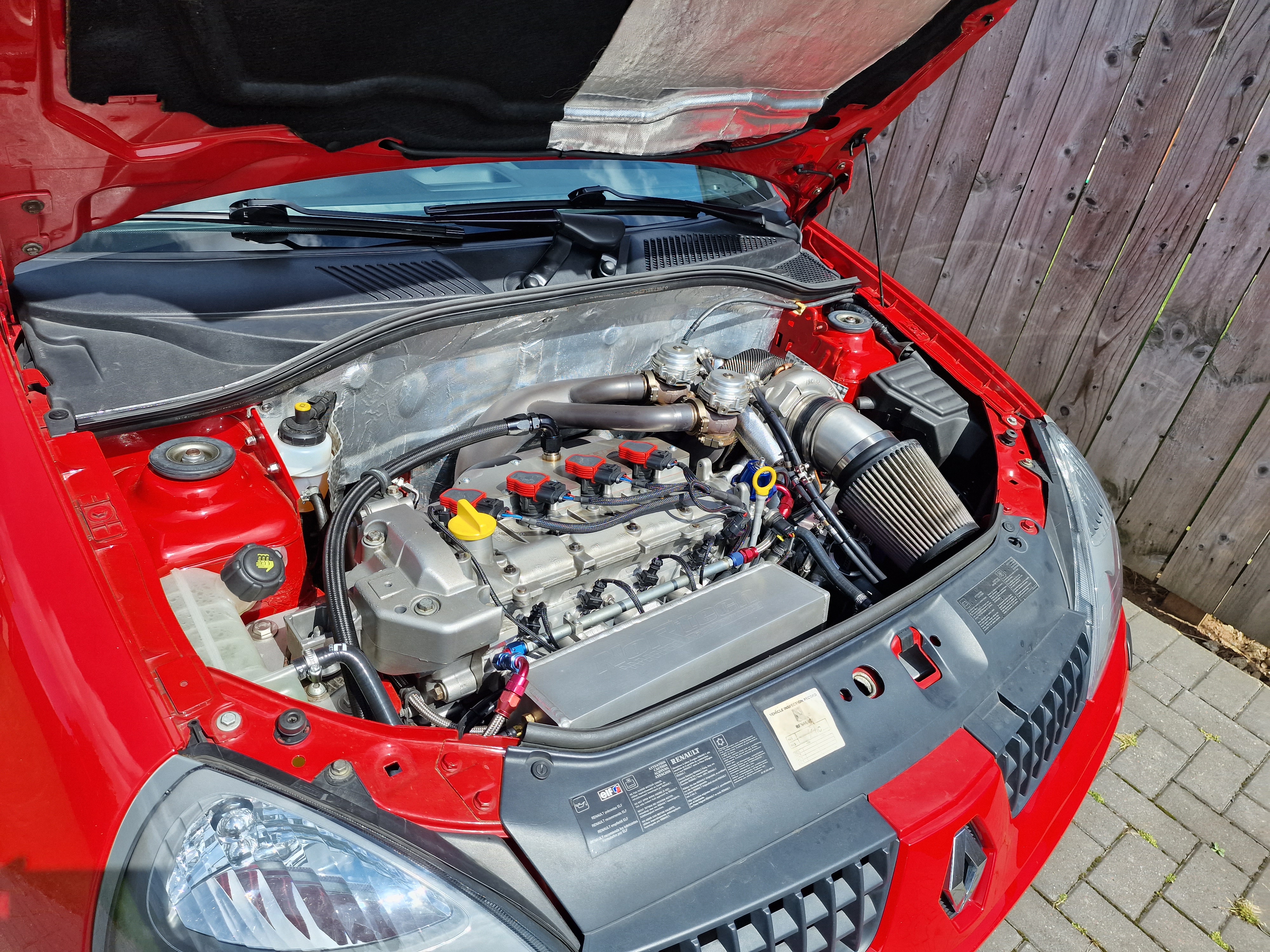

Taxed the Trophy at start of month as planned on taking it to Oulton Park for Autos De France.
Best get some miles on it as only been for mot this year and its a long trip.
Done 20 mile trip to see my mate and mcdonalds (well im getting fat again now diets over :LOL:)
No issues good to go. Sat in garage until last Friday. Out early doors 7 am to clean before temp got up.
Fuelled up and ready for journey.
Typically mad hot day around 29-30degrees which doesnt bother the engine as it runs cool in the low 80deg coolant range on the move. Driver proper overheating however with no ac!!
165 miles done to the airbnb. Big posh digs.
Up early doors to get to Oulton.
No more pics of it as i was too busy catching up with everyone. Travelled back home after the show, pissed down late afternoon so it needs cleaning again. Apart from that all good no issues to report. Had boost wound up to 14psi on way back and its mega. Squats and goes on 4th gear roll!
Worked out real time mpg and its averaged 35mpg. Thats with giving it some on the way back and stuck in loads of traffic on the way there. The bosch 980cc injectors are great with good mapping from Chris @ Efi.
Will be time to fit new clutch soon. Over and out for now!

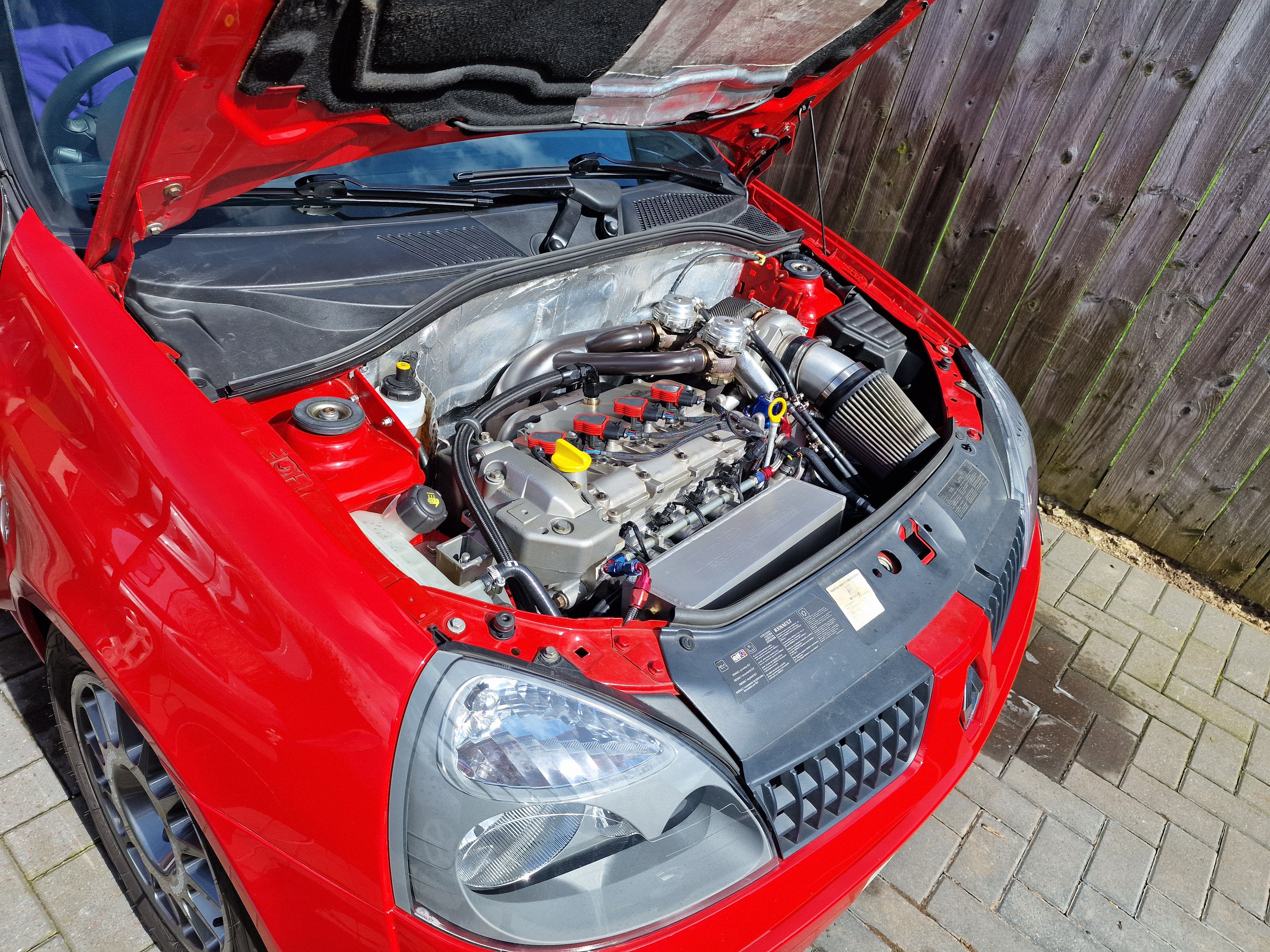

Sometimes i forget ive got this as it barely moves out of the garage. Took it off the road last September and its not moved from its spot since.
Connected up battery, and primed oil system as its been laid up for ages. Unplugged coilpacks and injectors and cranked on starter - oil pressure flew up on the gauge straight away. Connected everything up and started instantly on the 9 month old fuel and ran like it was used yesterday, no rust on the brakes or nothing.
Backed it out of garage and ran it up to temp.
Cleaned the dust off ready for maiden voyage to mot station tomorrow.

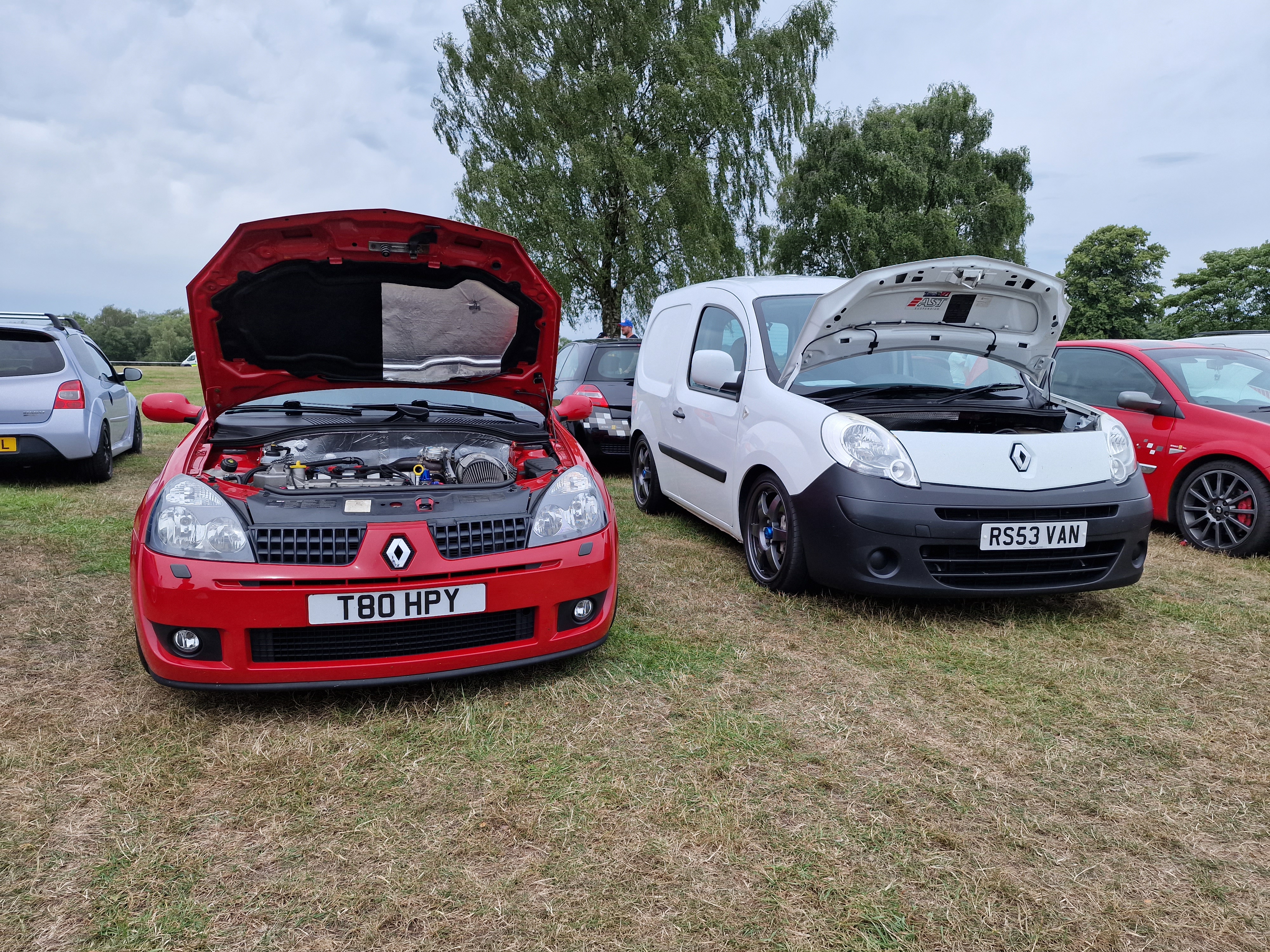

Done 20 mile trip to see my mate and mcdonalds (well im getting fat again now diets over :LOL:)View attachment 1652083View attachment 1652084

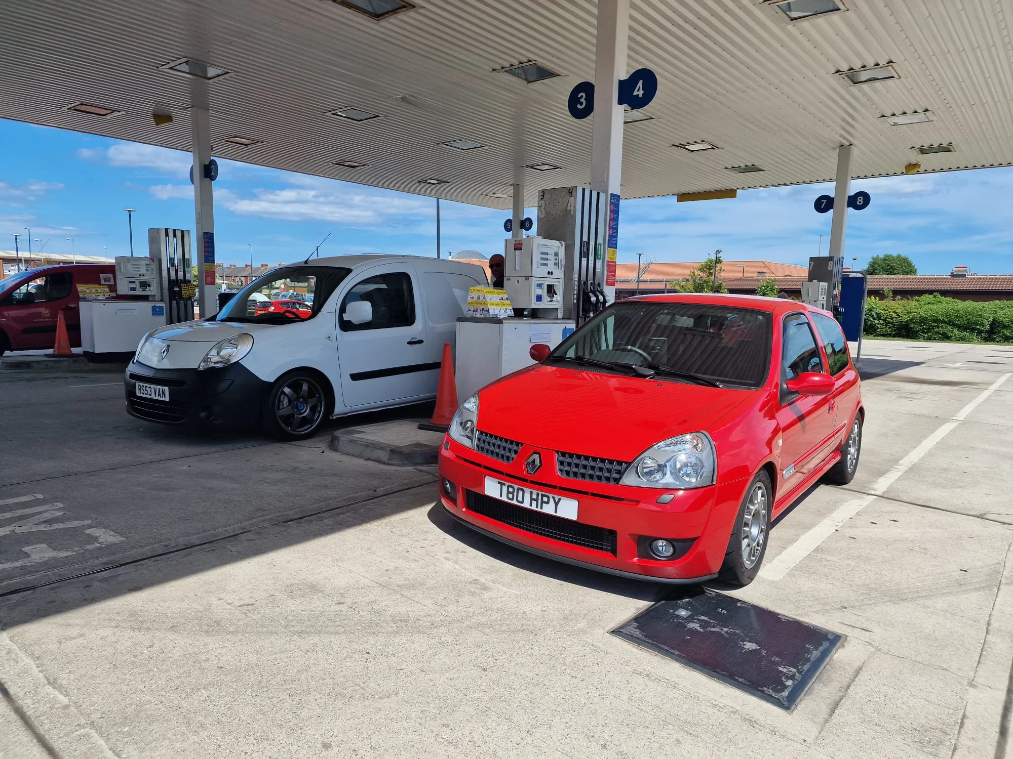

Fuelled up and ready for journey.View attachment 1652089Typically mad hot day around 29-30degrees which doesnt bother the engine as it runs cool in the low 80deg coolant range on the move. Driver proper overheating however with no ac!!

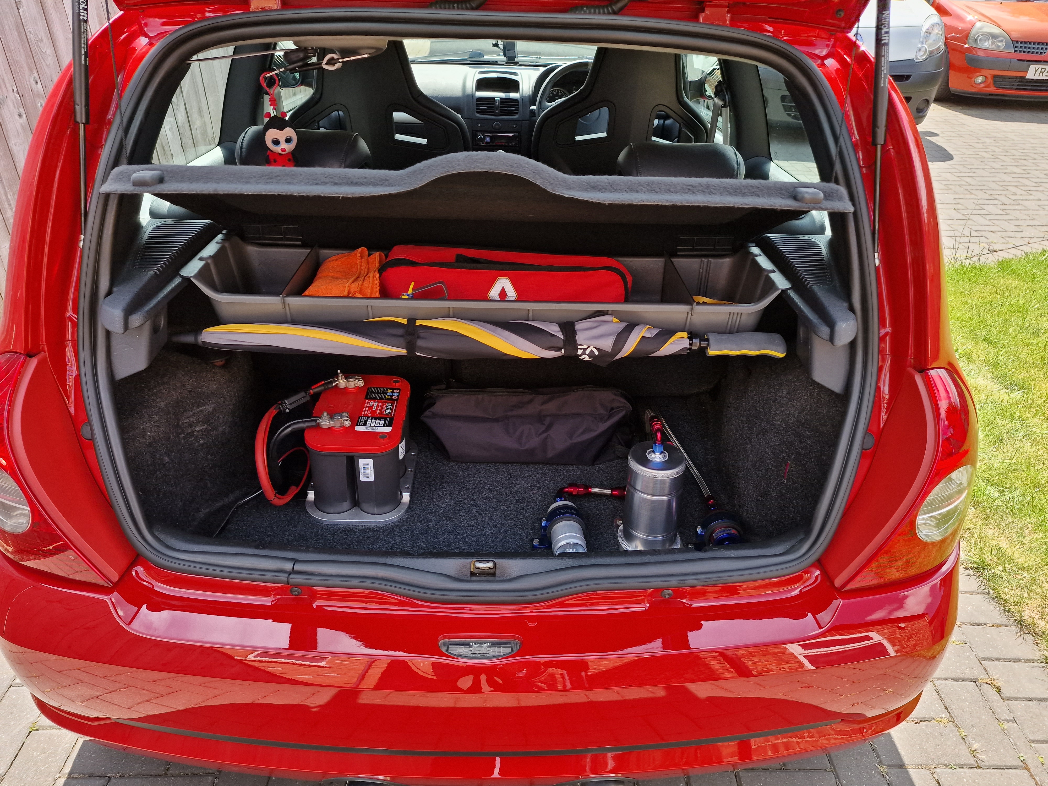

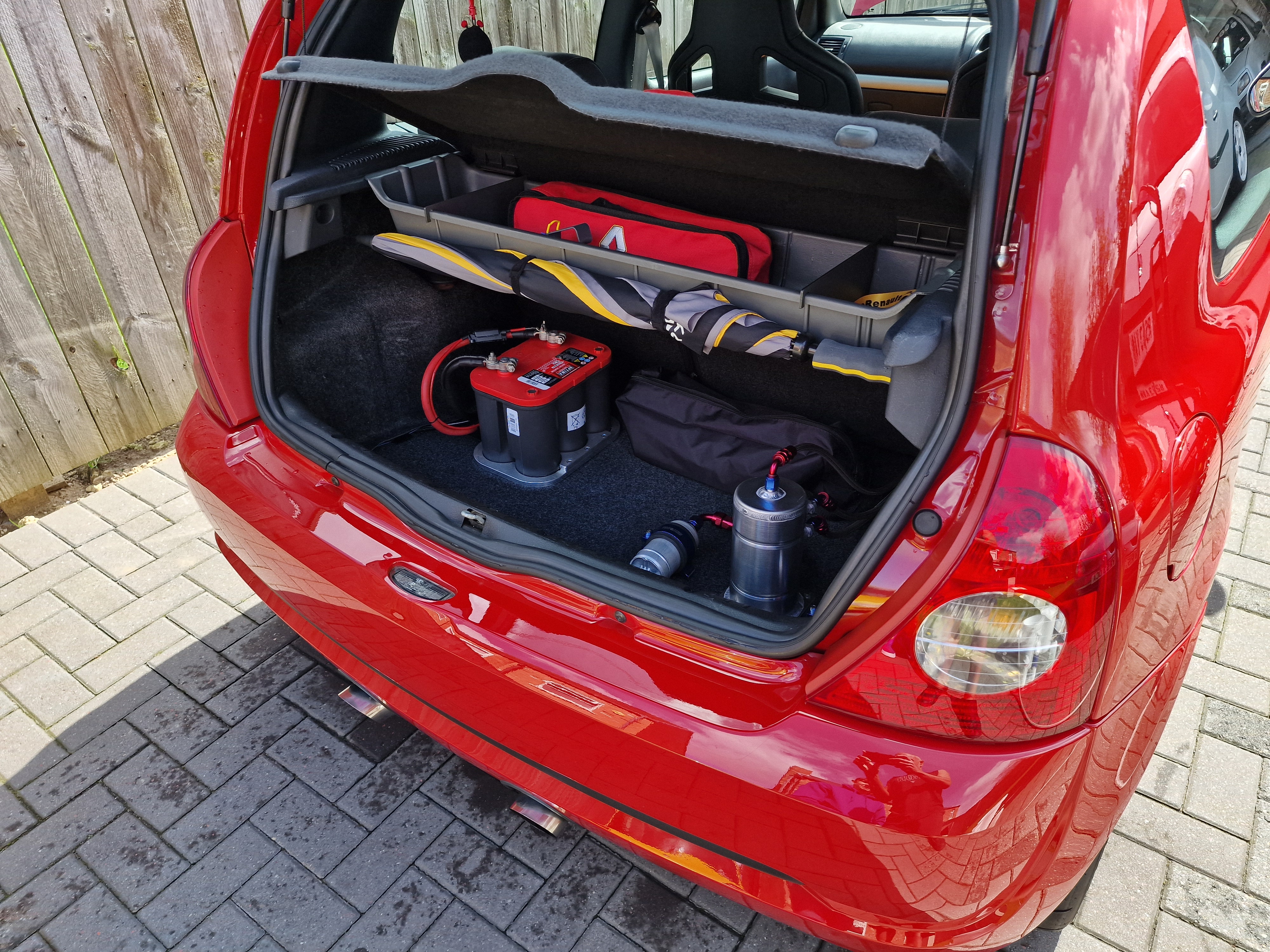

Great stuff! Can I ask what is the boot storage/organiser part/model that you use? Thanks!

Does the pump in the boot annoy you?
Drives me insane, i need to do a soundproofed cover. Its not as bad as the 044 in the extra though, that is pure tinitus :LOL:
This aint no volvo so i have to run one :LOL: pistons send me a love letter under half a tank
Storage tray is oem renault. No idea on part number sorry, very hard to find now.

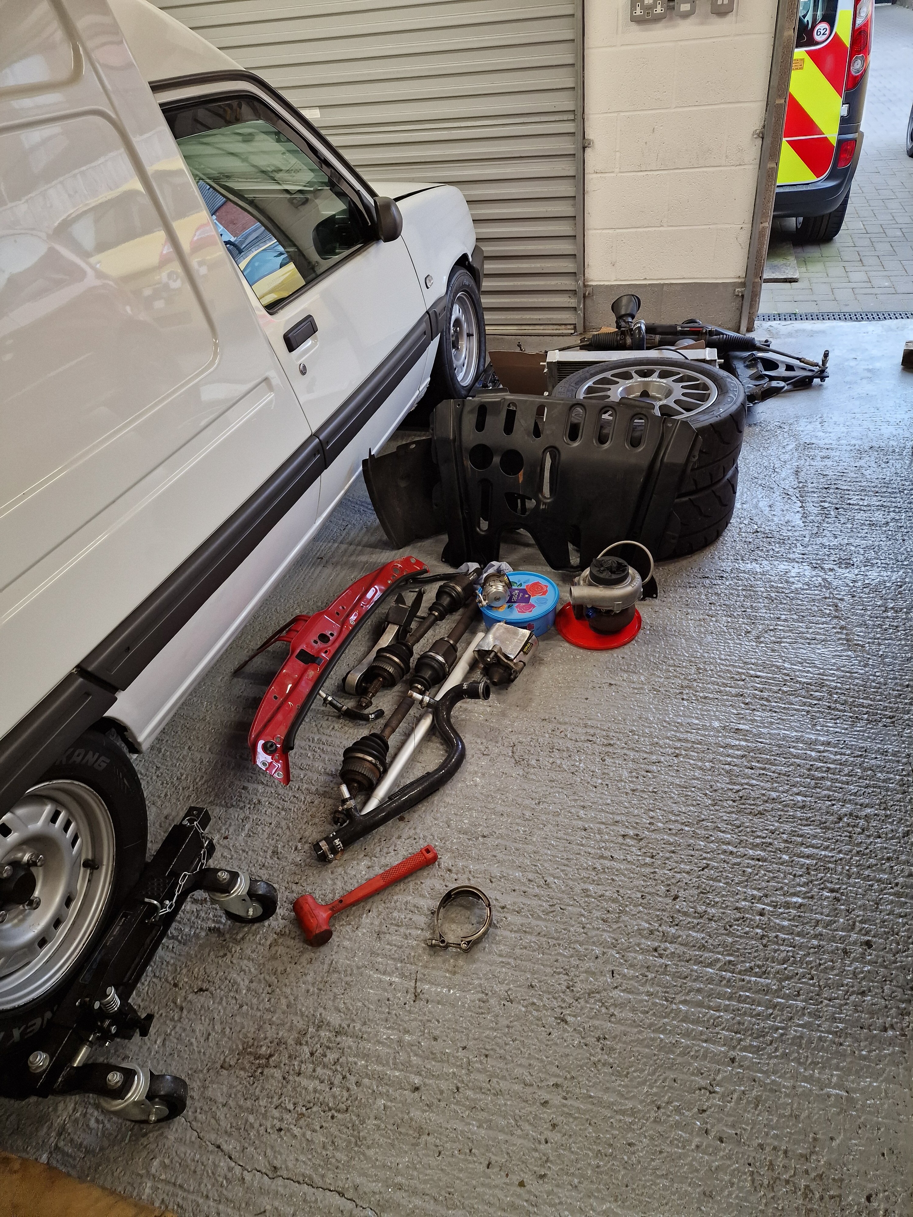

Solid 4 hours done today.
Engine and box dropped straight down and gearbox off.
No oil leaks suprisingly
Ttv smf with twin organic plate fitted using a cut off ndo spline to line up both plates.
Flywheel lock in place whilst torquing all bolts.
New luk concentric slave fitted.
New bushes fitted to gear selector as it was a bit tight. The new bushes were even tighter than the ones i removed so sent the 10.5mm reamer through. All good now.
Back in the hole.
Bled the clutch up to check it was all working as intended before refitting more parts. I pre filled the concentric slave before fitting to save lots of hassle when bleeding as these mk2 meg setups can be a pig to do. This worked excellent and had a good pedal straight away with minimal hassle. The clutch feels much better than the old helix, its heavier than stock but not knee breaker.
Also flushed all the brake fluid for fresh rbf600 whilst there, as well overdue.
Back on it tomorrow.

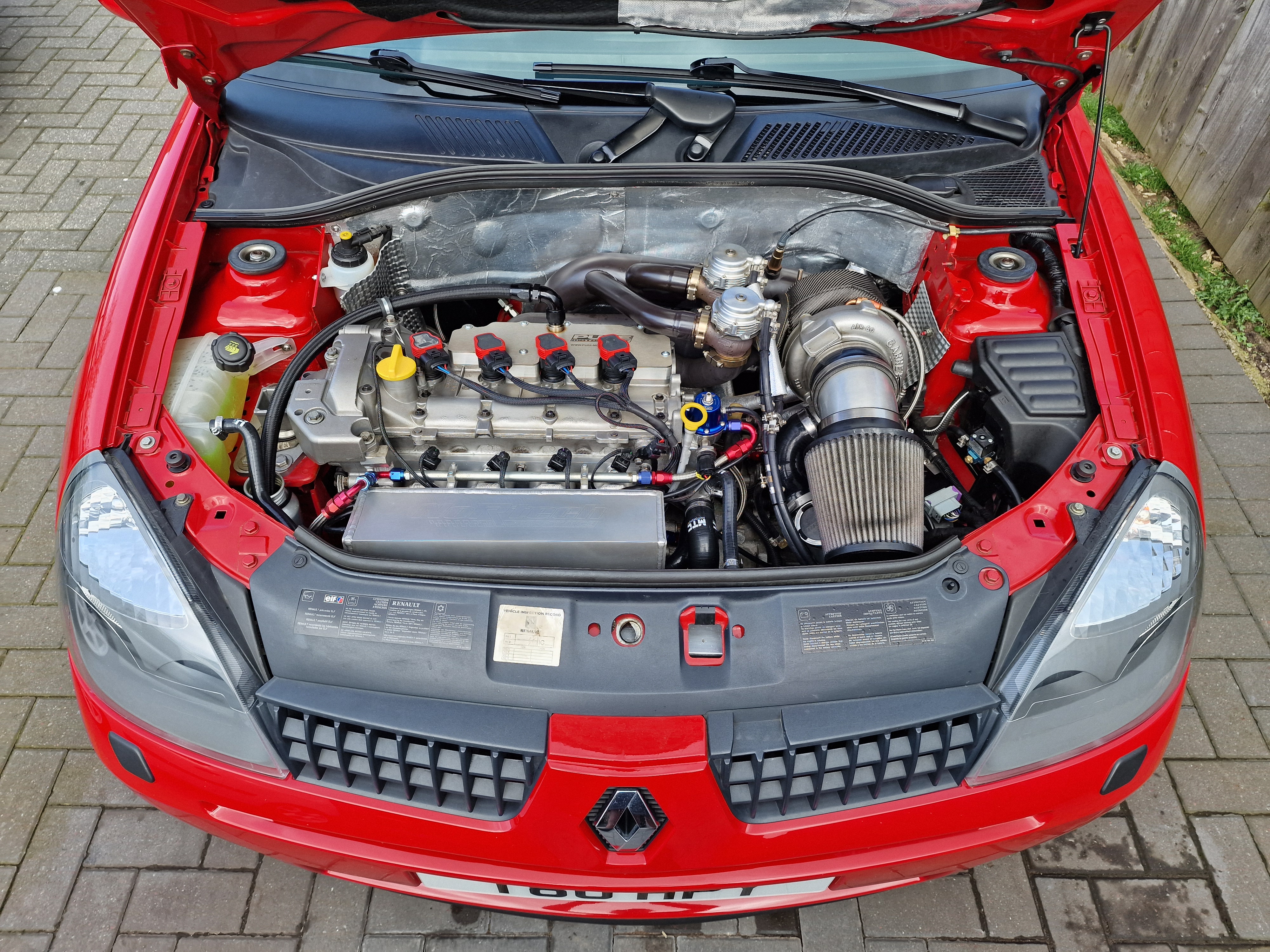

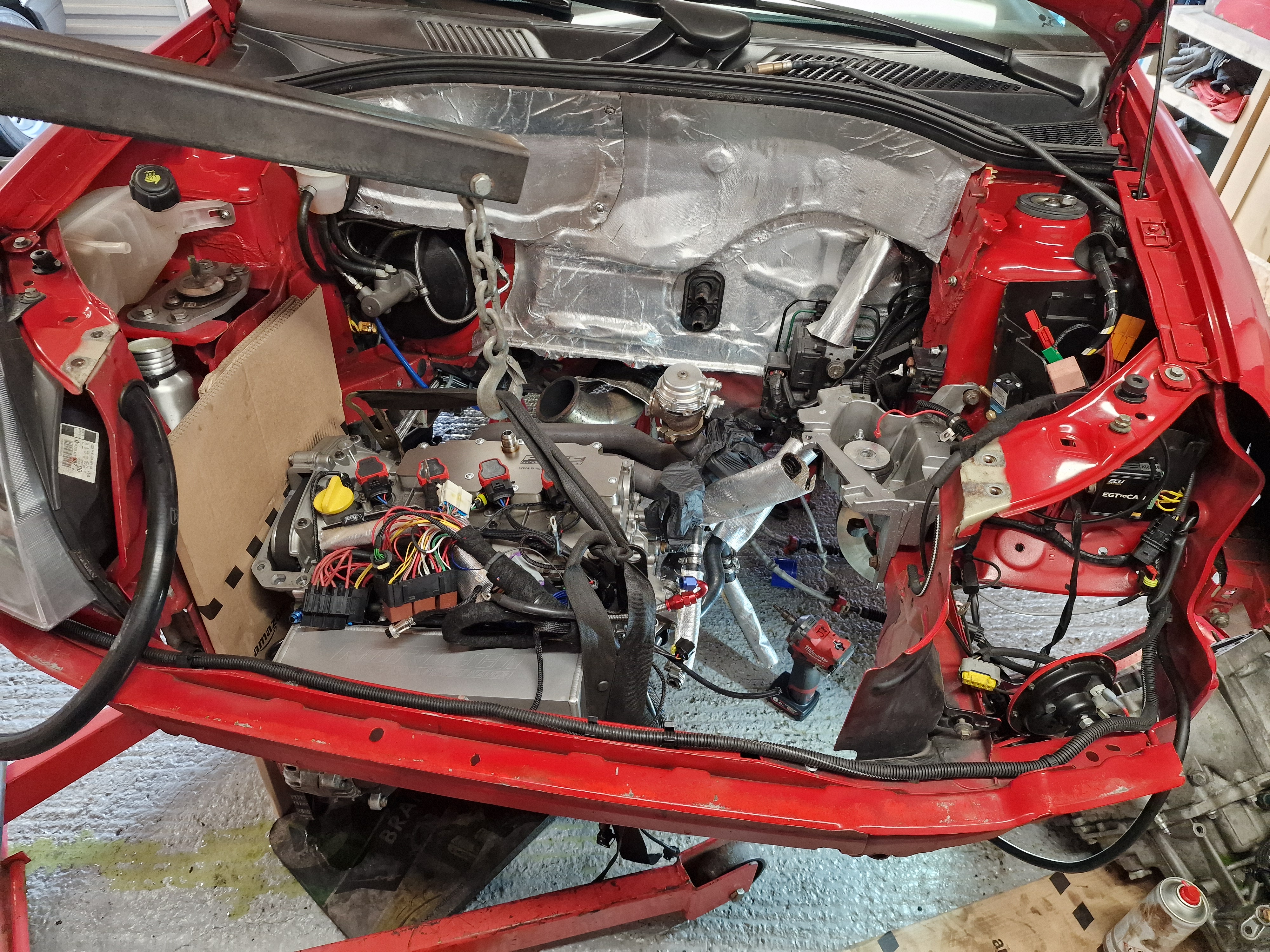

With that done, got starter motor on and wired, egt sensors reconnected, wiring reconnected and fuel system plumbed back in. Small jobs taking ages as all bits fit in one place.
Egt per cyl.
Coming together.

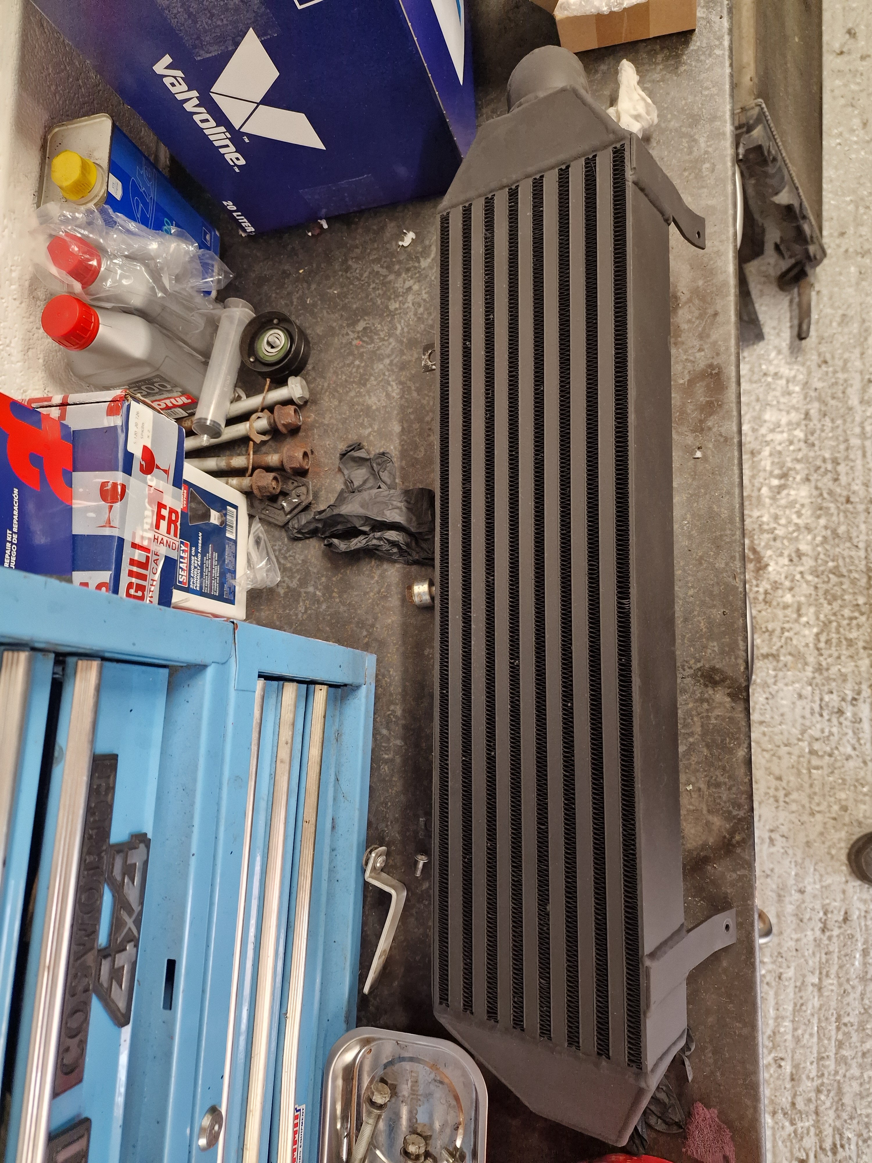

Intercooler given a quick coat of vht. The intercooler is genuine garrett bar and plate core rated to 500hp. Works surprisingly well.
Back in one piece. Fresh millers 10/50 and coolant filled with type d.

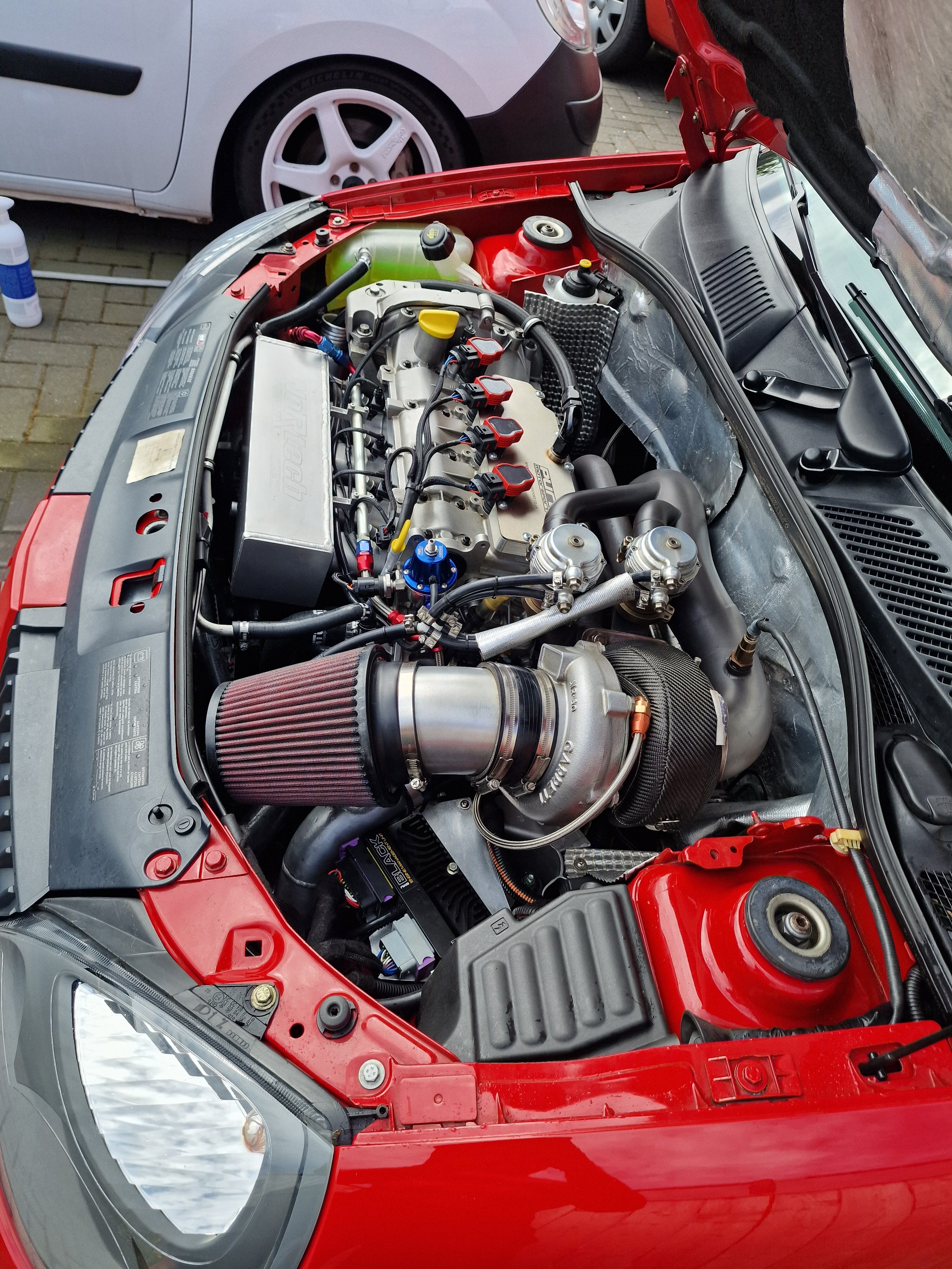

NDO gearbox in situ, knacker tight. The gap between subframe brace is not very big, engine and box more or less solid mounted on vibratechnics mounts and solid dogbone.
Ac delete on traffic alternator mount for subframe clearance. I planned on changing this for a clio mk3 rs cup racer ac delete but it barely fitted so has to stay as is. Current setup seems OK.
Hot side boost pipe to throttle body. Tight but does not touch rad. Its bumper and boost hose off to change oil filter.
Air temp sensor is a right carry on to access.
The joys of a megane engine and box rammed in the engine bay.

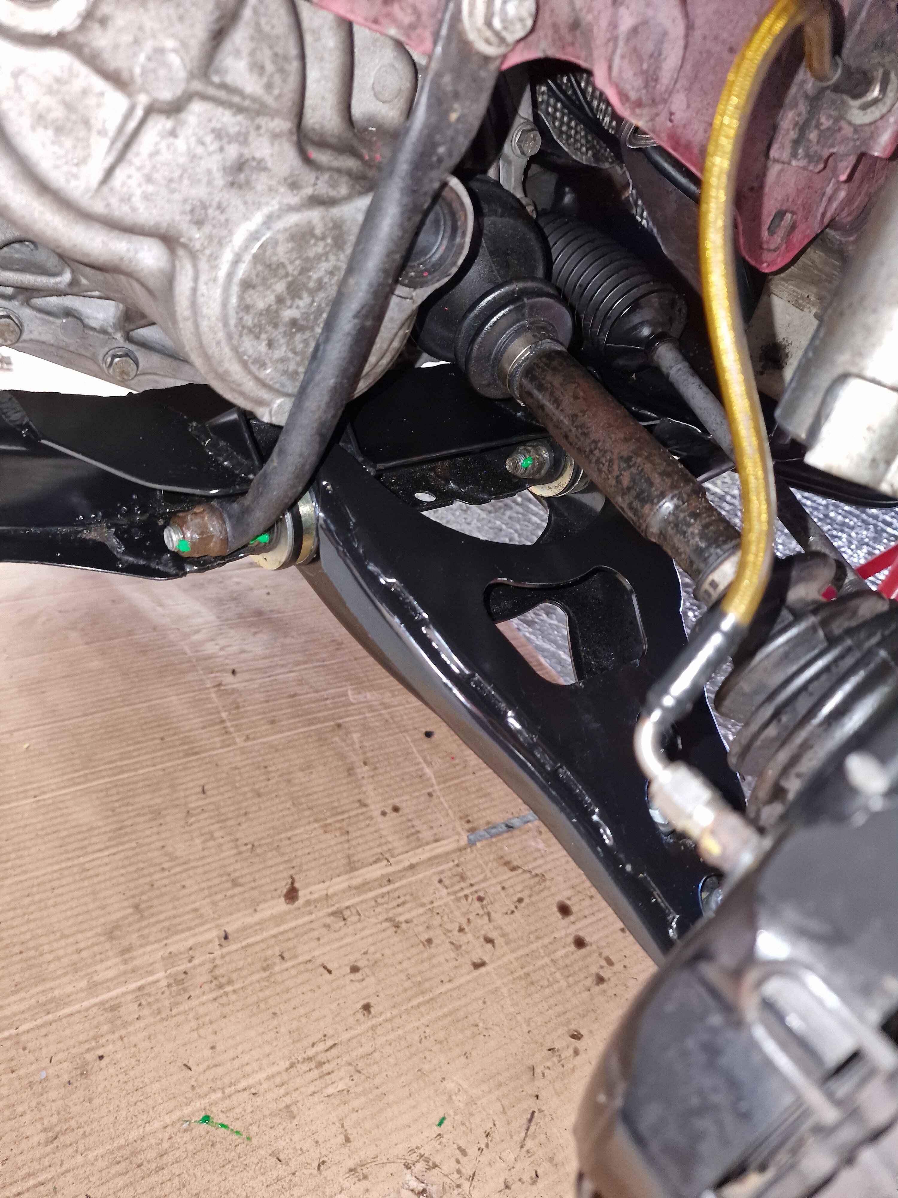

Started with changing the lower wishbones. Whipped them off and the powerflex bushes were in a lot worse condition than expected.
Fcuked
This beauty was not visible until removed as hidden behind the reinforcing plate on the subframe.
Pretty bad, the thin outer casing on the early powerflex not fit for purpose. Im suprised it did not pull all over on the road but suprisingly little play considering. Stuck the new arms on with the new style powerflex black bushes with thick outer casing, and the washers that keep them tight.
Problem solved.

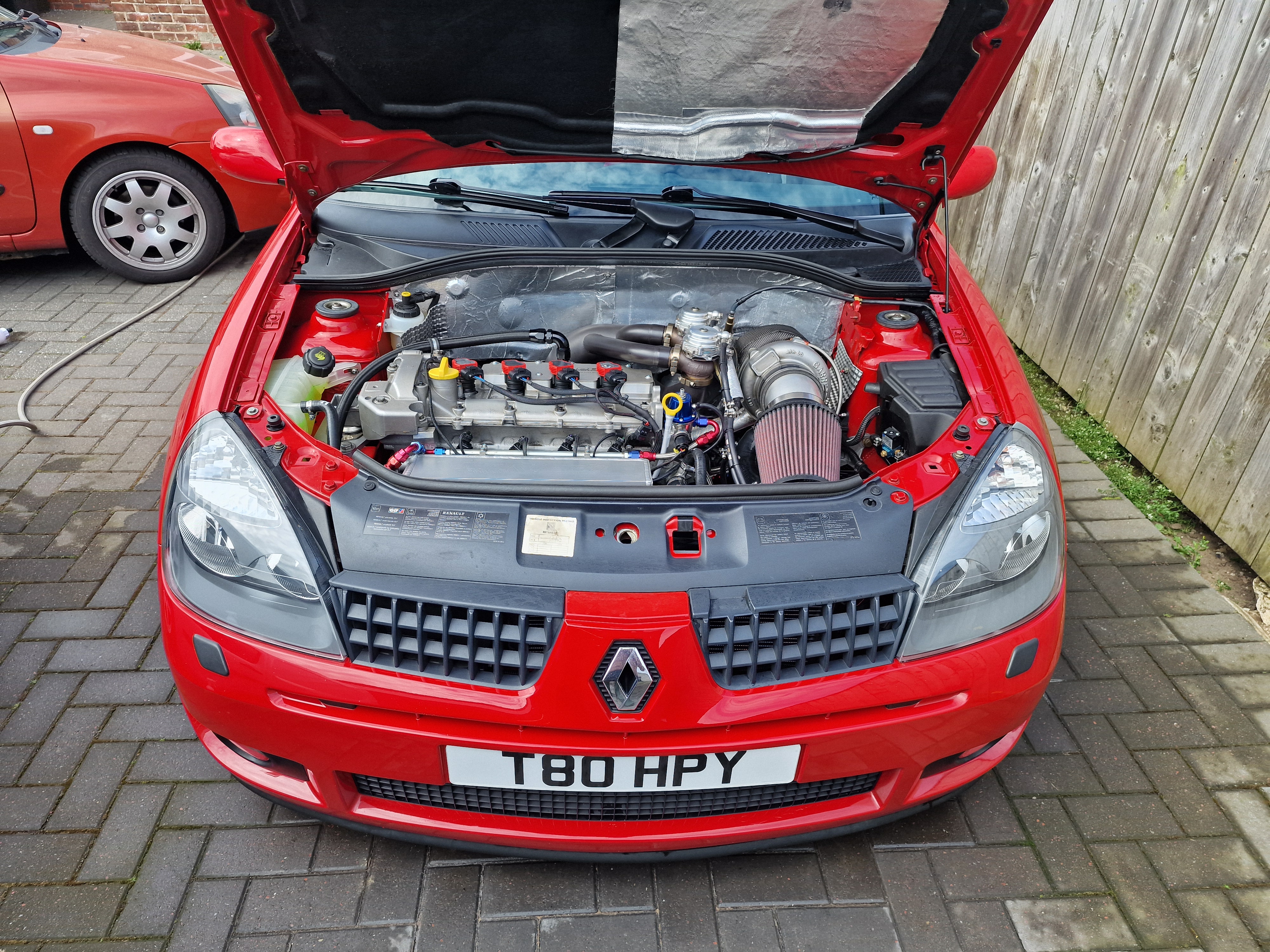

Finished off last few jobs on the Trophy on Sunday morning and test driven a few laps of the block.
All went well, new clutch is quite snappy but a decent improvement over the old helix/less of a knee breaker. Gear change is improved too much better than last setup, shift feels quite positive compared to the old vague feel. The steering is also much better with the dci rack compared with the old looped 182 rack that had a deadspot due to the torsion bar. Geo is a bit on the piss at the moment but will get sorted asap.
