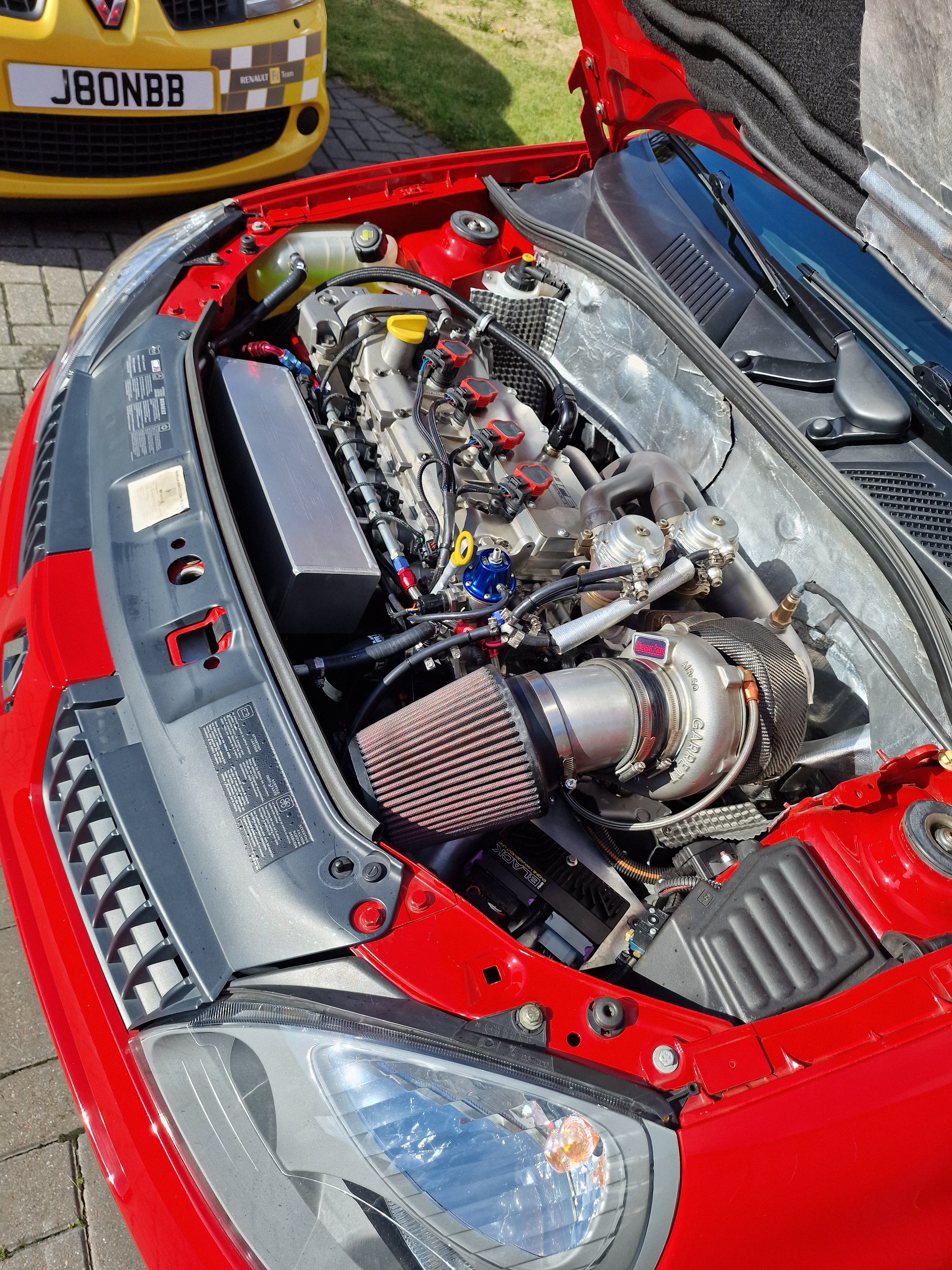

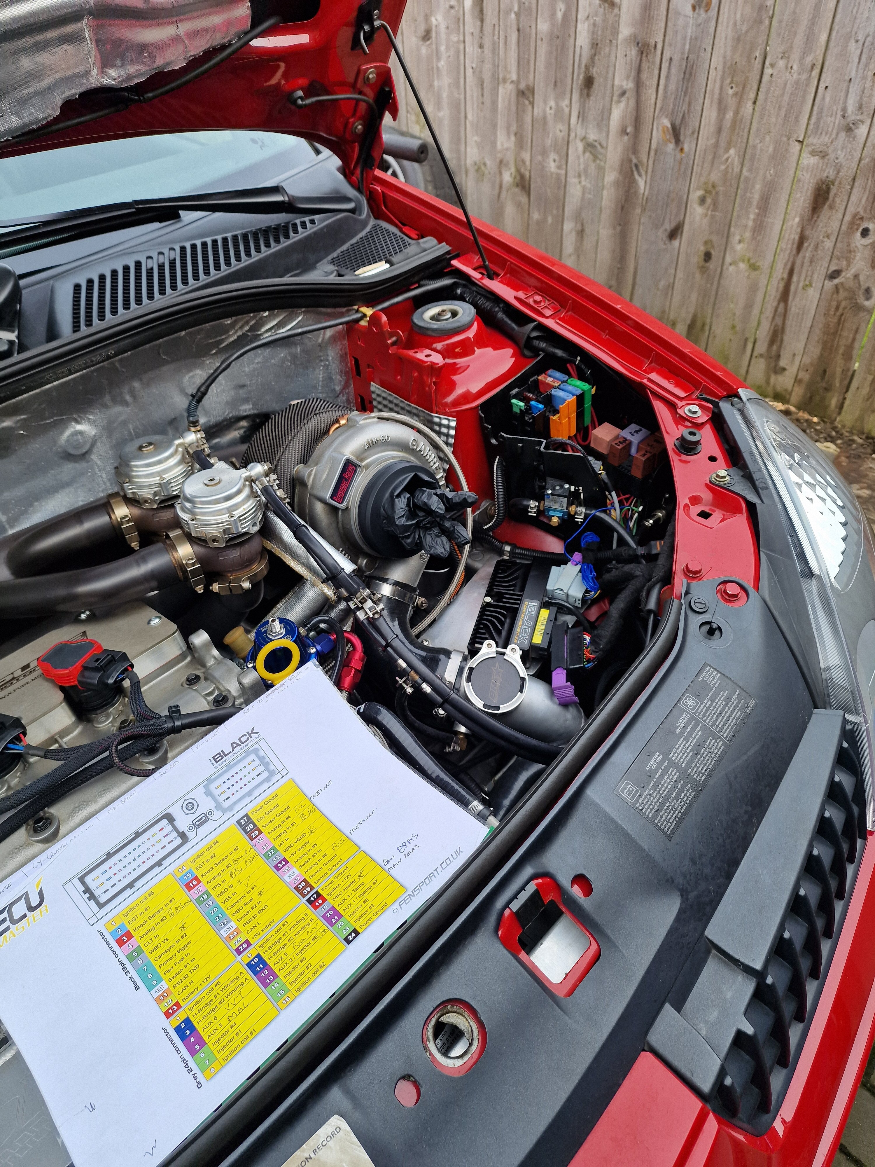

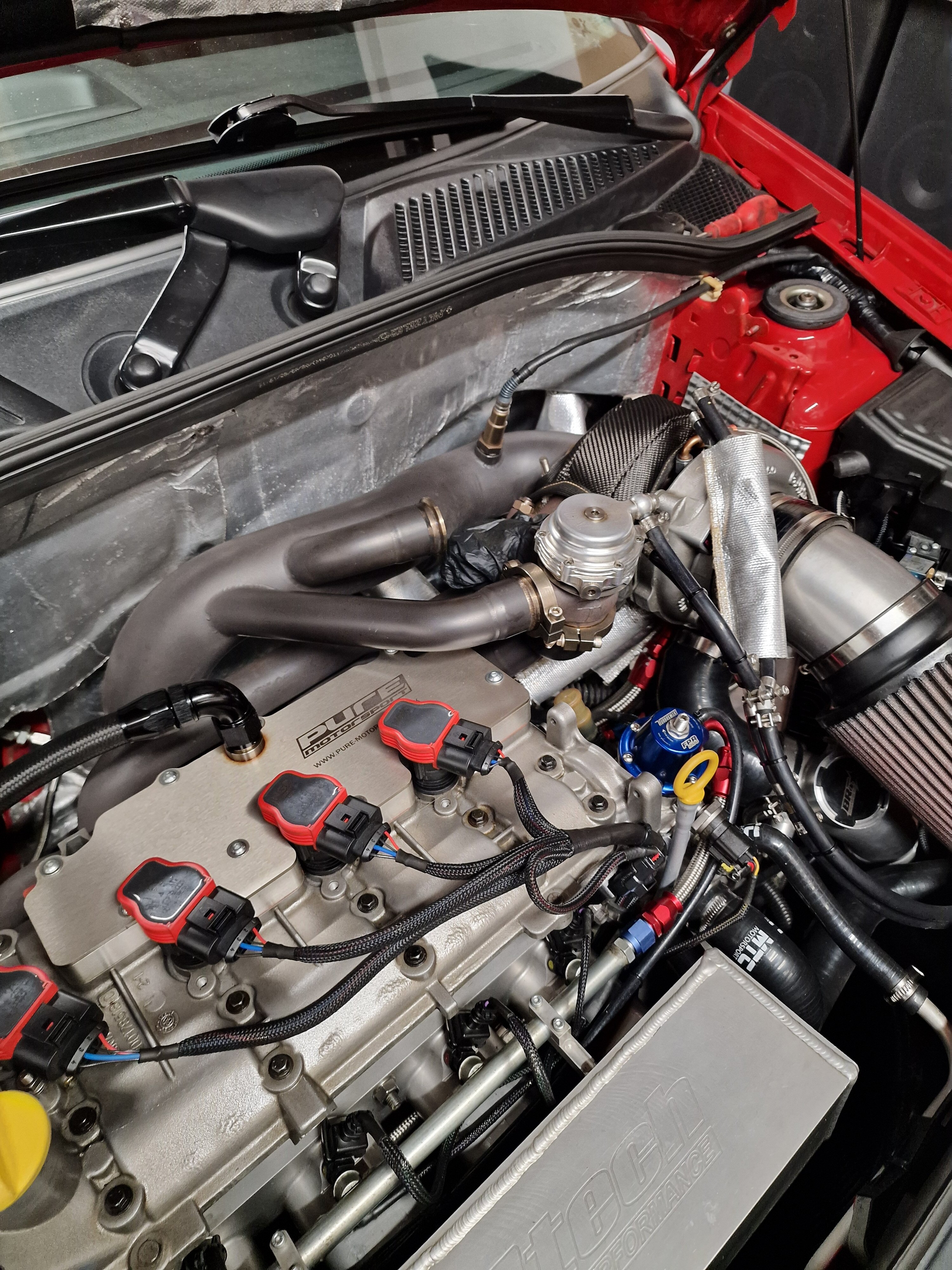

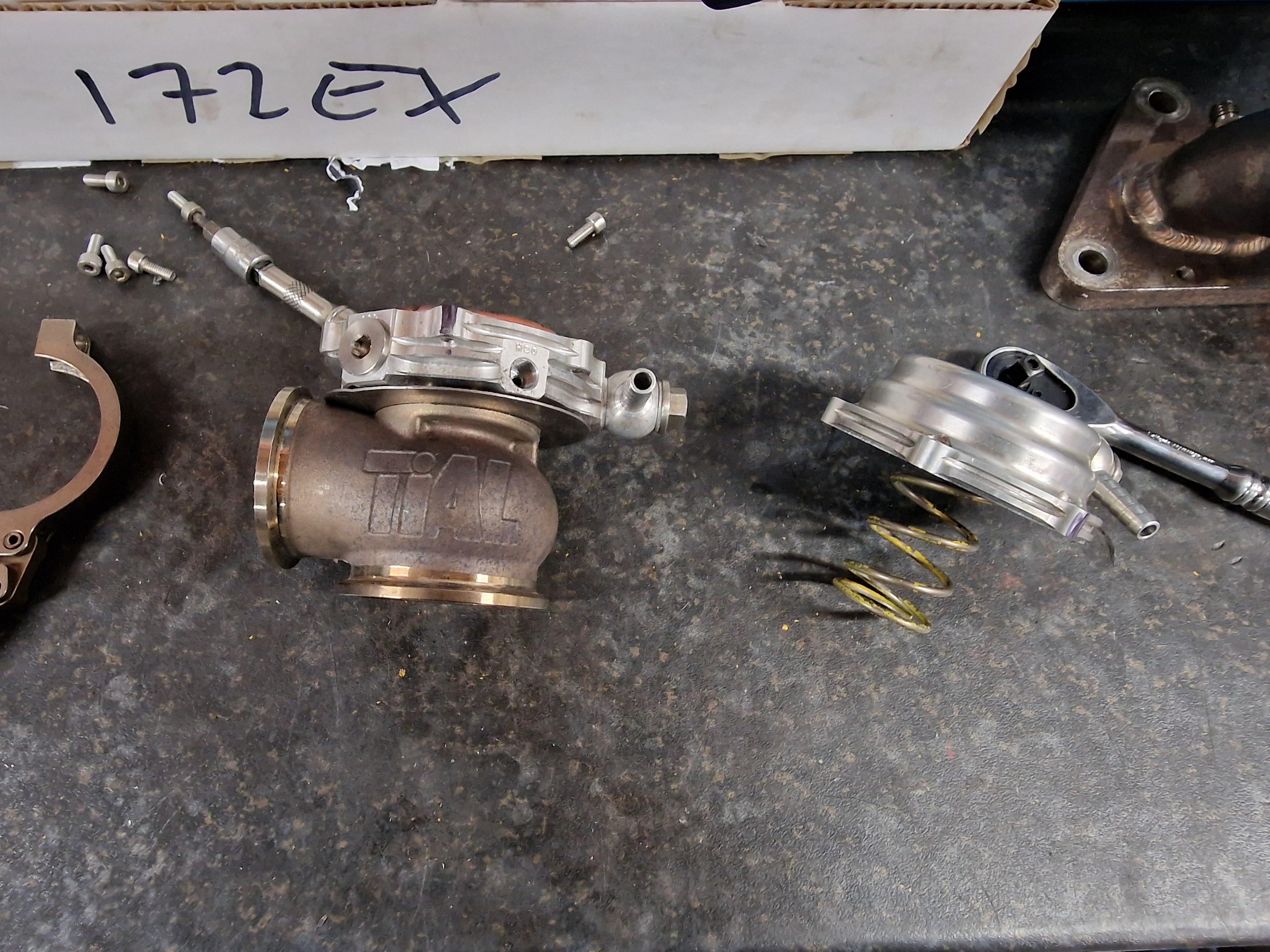

What’s with the twin wastegates? I know nothing about them but is one not enough?
Brigsy
  T.Turbo
Twin scroll turbo so one wastegate for each scroll on the turbo, with 2x exhaust ports feeding each side. In theory one large gate would work but thats how Nortech set it up.
It does spool quite fast for a low comp engine and large turbo, so overall it works decent. All in around 3800rpm from memory. Boost control is rock solid hits whatever level its set at, and holds it right to the 7800rpm rev limiter.

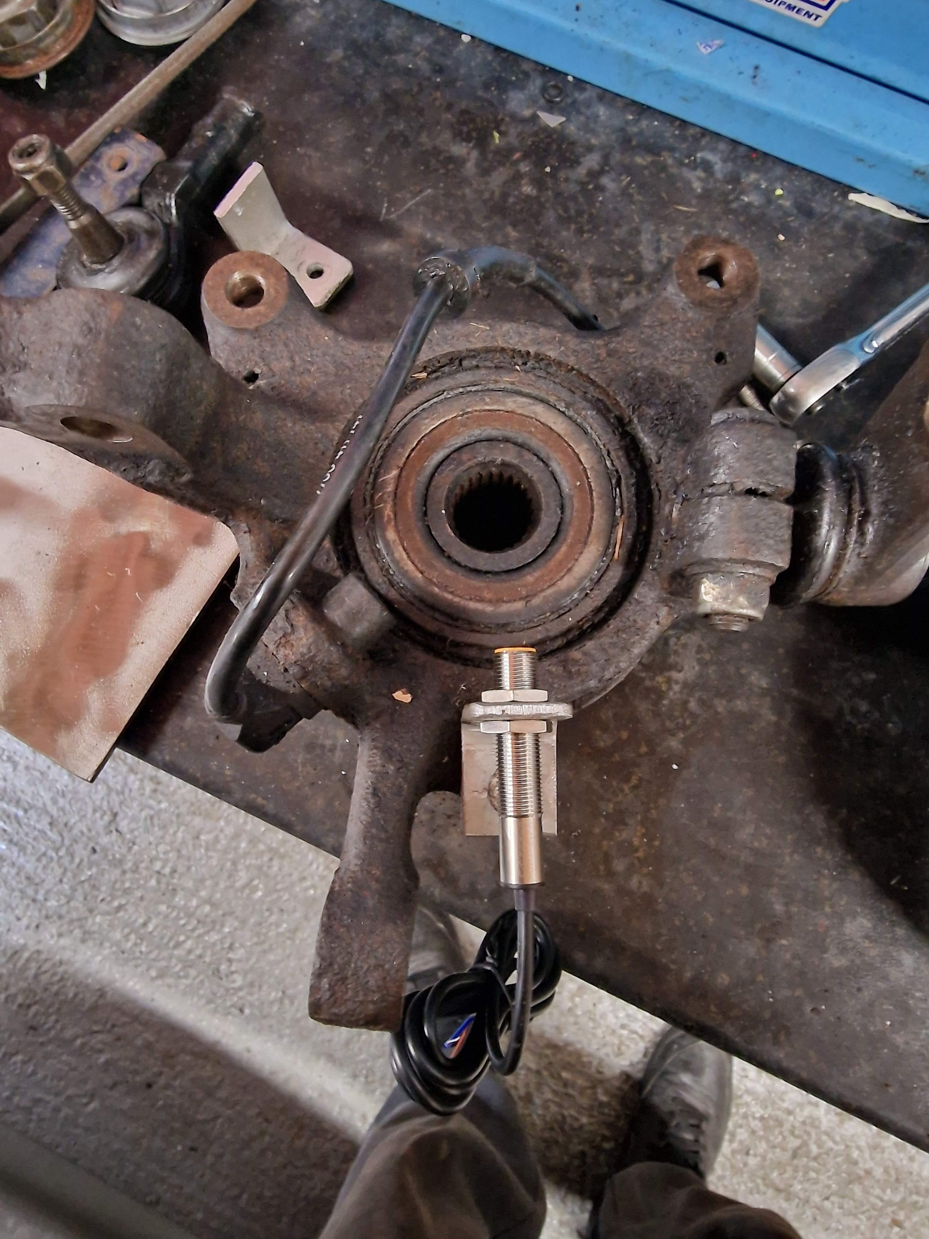

Wheel speed. I need vss to work on driven wheels for boost by gear. Dont want to tap into abs, actually not sure if it works but no light on dash so whatever, leave it be..
Brainstorming last week on how to fit a hall sensor to read off abs ring and dug a spare hub out to mock up. There is 3 random holes on the 182 hubs for whatever reason, maybe they planned on fitting a s**t guard behind disc at one point. These look like holes full of rust but actually m6 threaded when you look closely. Chased the hole out with a tap, one l shaped bracket made and it looks like a goer.
Cleaned up the setop and transferred to the car.
Bit of wiring.
Ran the car up on axle stands. Did it read? Did it f**k😅 messed about with pullup settings no joy.

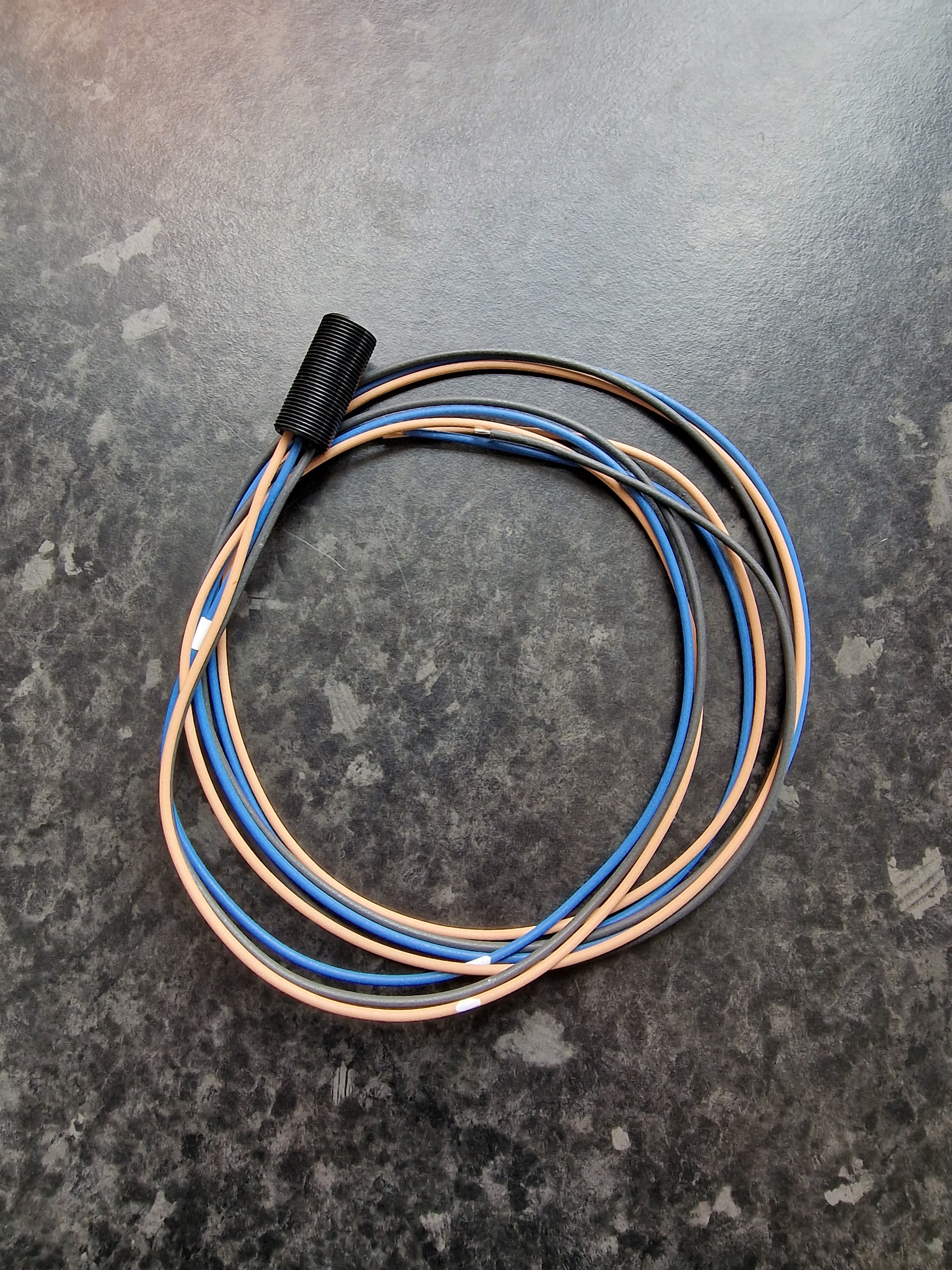

After a bit of digging id ordered the wrong sensor, this is supposed to be 2wire hall (i think its reluctor anyway) and requires a magnet installed to read off. Prob could make it work if i moved sensor/installed magnets.
Ive ordered a 3 wire hall sensor that doesnt need magnet and will read off ferrous toothed ring to replace. Not holding my breath as feel like abs ring may have too many teeth but we will see. The legwork is done now so its simply swap out sensor and fit new one adding a 12v supply wire.
One bonus is i got a shorter sensor so more clearance on rcl kit as the current one is tight. I done a bit of sniffing round and the recommended sensors are the cherry red ones at £80+ from most places. It turns out its just a bog standard zf hall sensor that Rs components sell for £30ish. So not too bothered if it doesnt work.

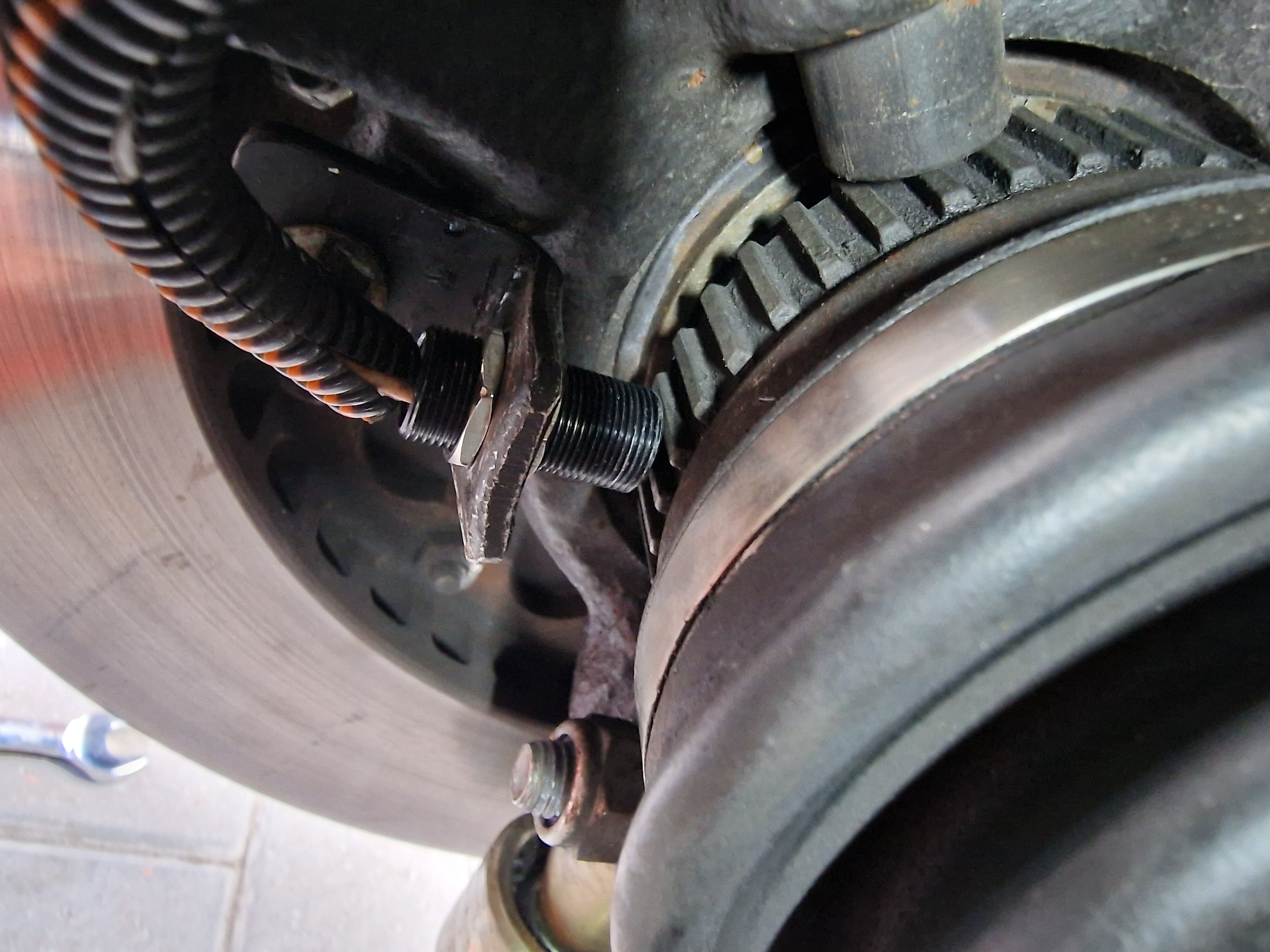

ZF gear tooth speed sensor arrived today (part no GS100701). This is the same sensor ive seen for £70 -100 on a few tuner places, where in reality its £30 from Rs Components.
With weather being good and curious to see if it was a goer, i freed a couple of hours up this afternoon to fit it to the Trophy.
It was a relatively easy fit as straight into my homemade bracket. Small amount of extra wiring as 3 wire. The sensor is rated from 5v to 24v dc. I planned on wiring 12v but without butchering more wiring in fusebox for an ign live, i decided to give it a go on the ecu sensor 5v circuit, using sensor earth on ecu and vss pin.
The spec sheet says give it a 1k pullup at 5v and ecumaster has that selectable on the ecu so no adding external pullup resistors.
I was not really confident this would work on the 182 abs ring, as the spec sheet has minimum specs for tooth height, gap etc and the 182 abs ring is a fair bit smaller than suggested.
With the send it, it will either read or not approach, i fired the car up with front end on axle stands and ran it up in gear. It only reported vss frequency on the logs straight away so was a goer.

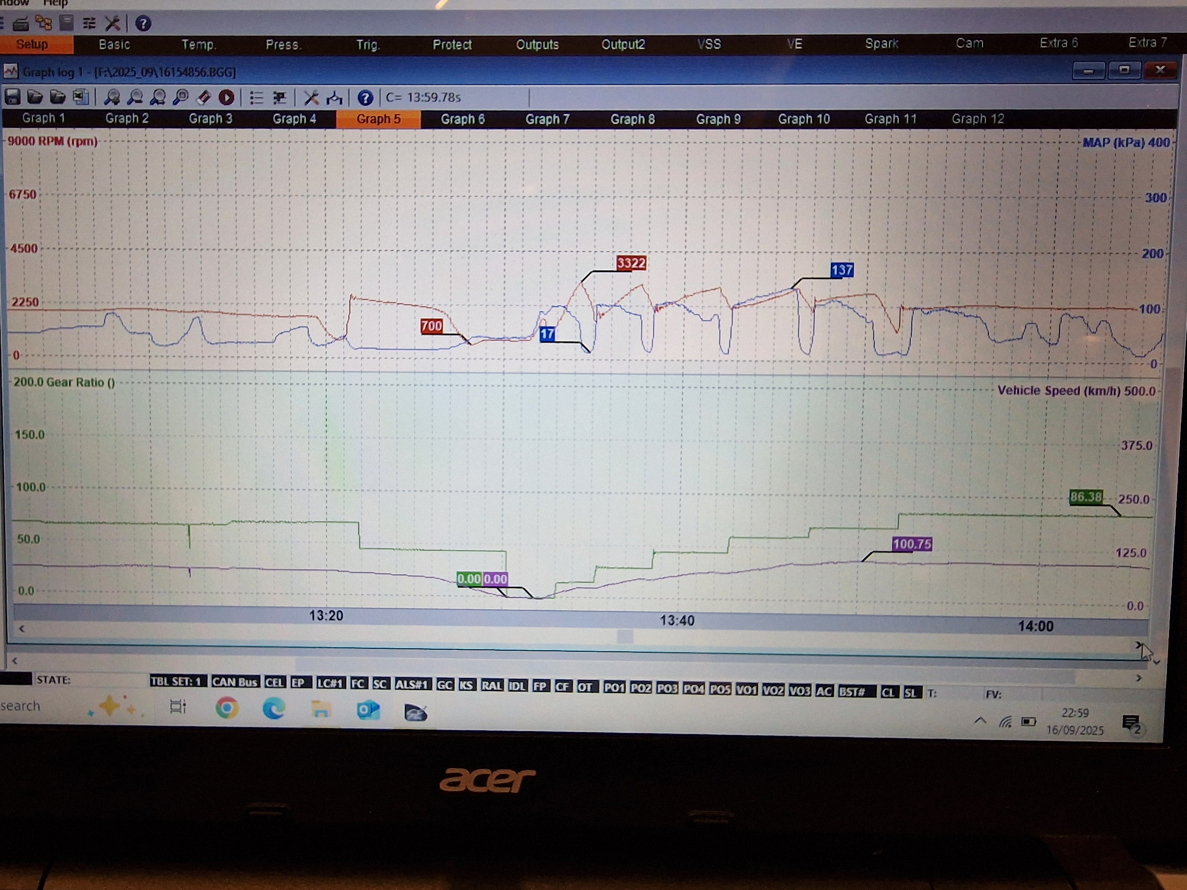

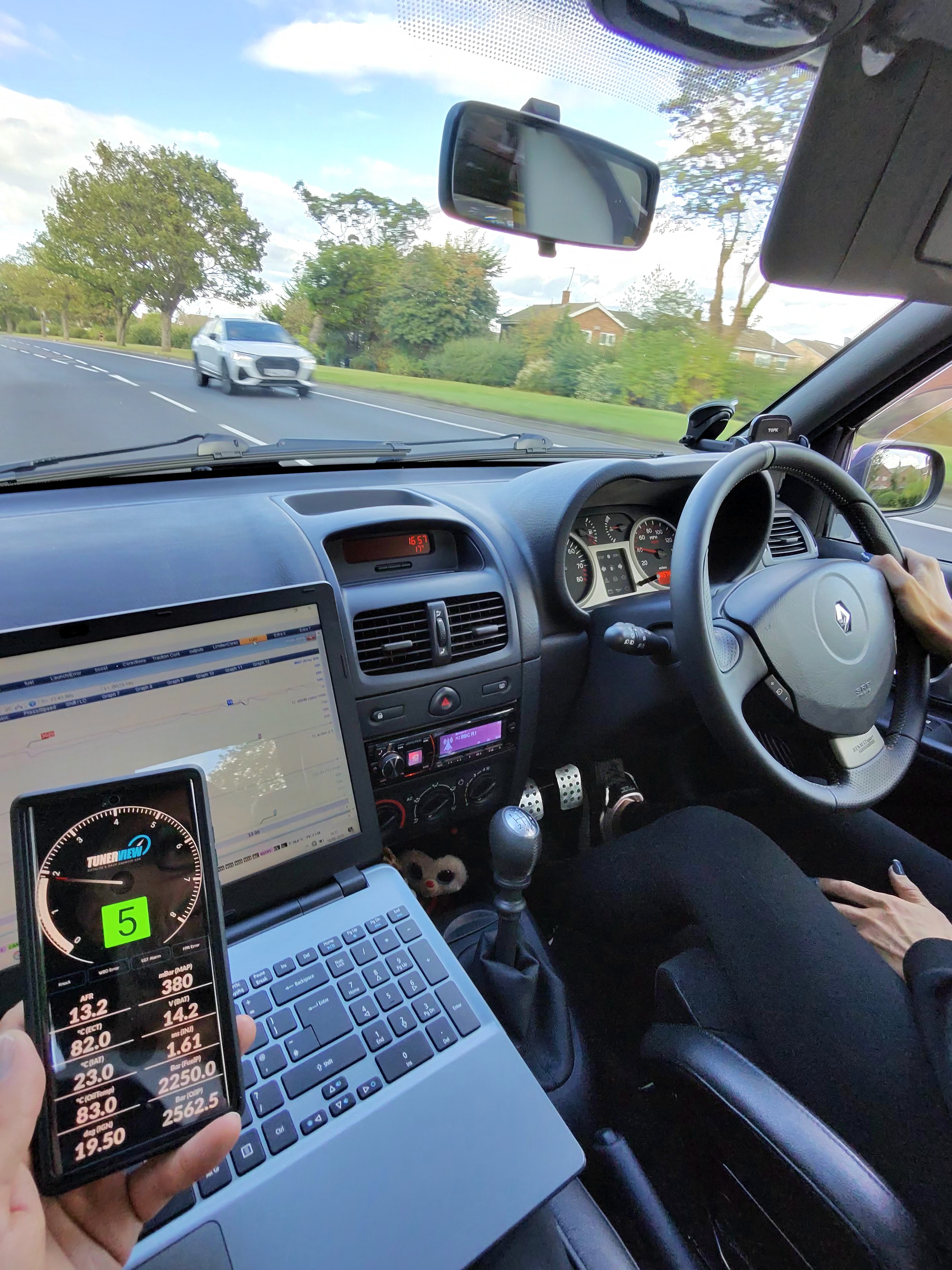

Initially it said aomething daft like 180kmh at 20mph, messed about with the frequency divider setting it at 4, and fine tuning with the speed ratio i managed to get it to read about c**k on with oem speedo in kmh of course as metric only.
Took it out and with the mrs driving, i set up the gear calculations so the ecu knows what gear we are in. This is done by viewing the gear ratio log, and inputting the average of the numbers logged on each step when in gear as seen below in green.
As no gear sensor on the box, gear selection is calculated by rpm & wheel speed (might be wrong but im fairly confident). Anyway it appears to work well, with tunerview actually logging gear selected for first time ever. Prob still needs a little tweak, im sure Chris will fine tune it if needs be.
Vss should add a few nice features. Oem stuff like throttle strategies for increased idle when rolling up to junctions out of gear. Possibly throttle blipper but might not work without gear sensor.
The spicey stuff like boost by gear, rolling anti lag, launch etc should work though. With the f4r being piss weak ill prob not use the latter two but boost by gear will be superb.

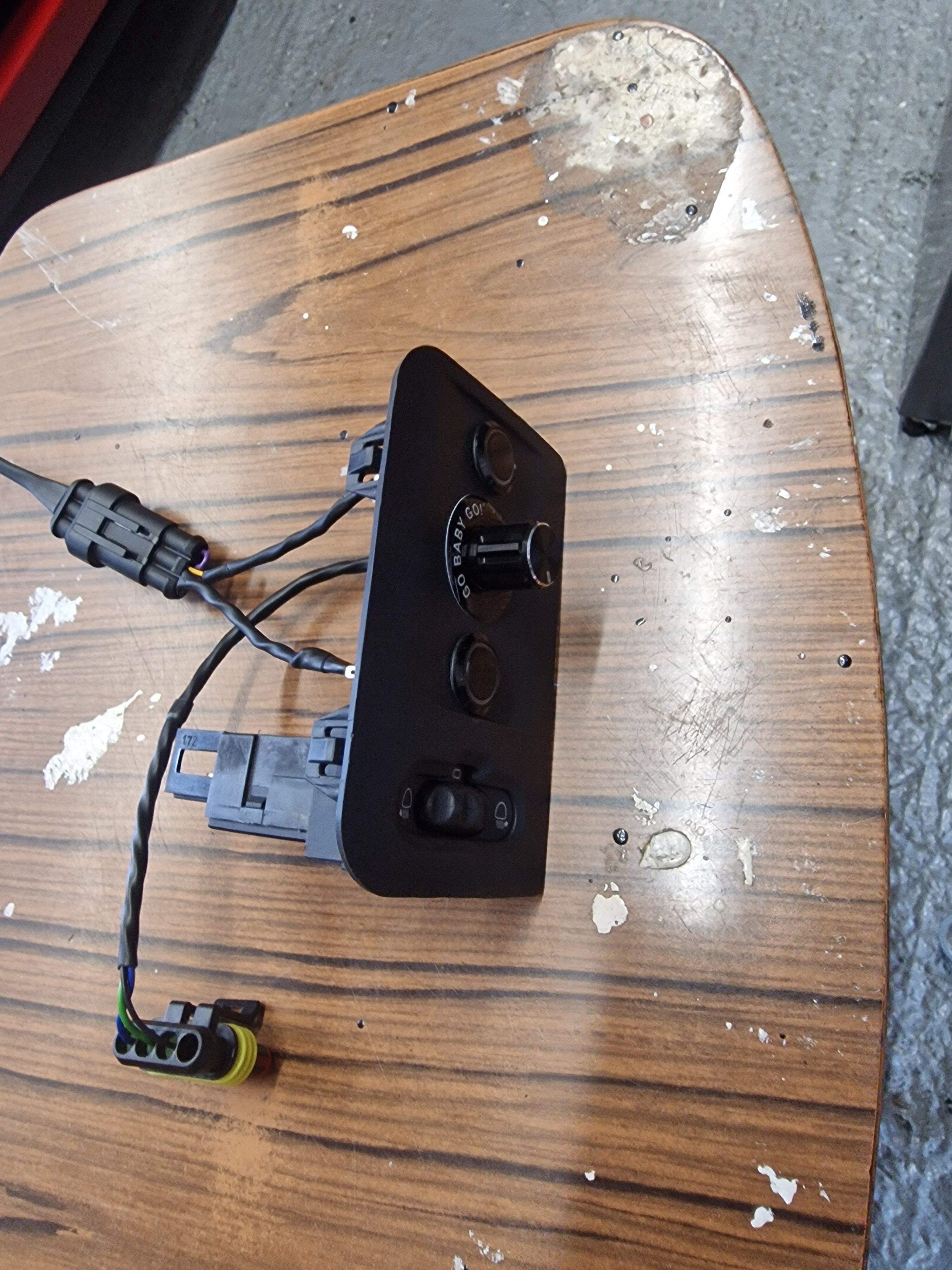

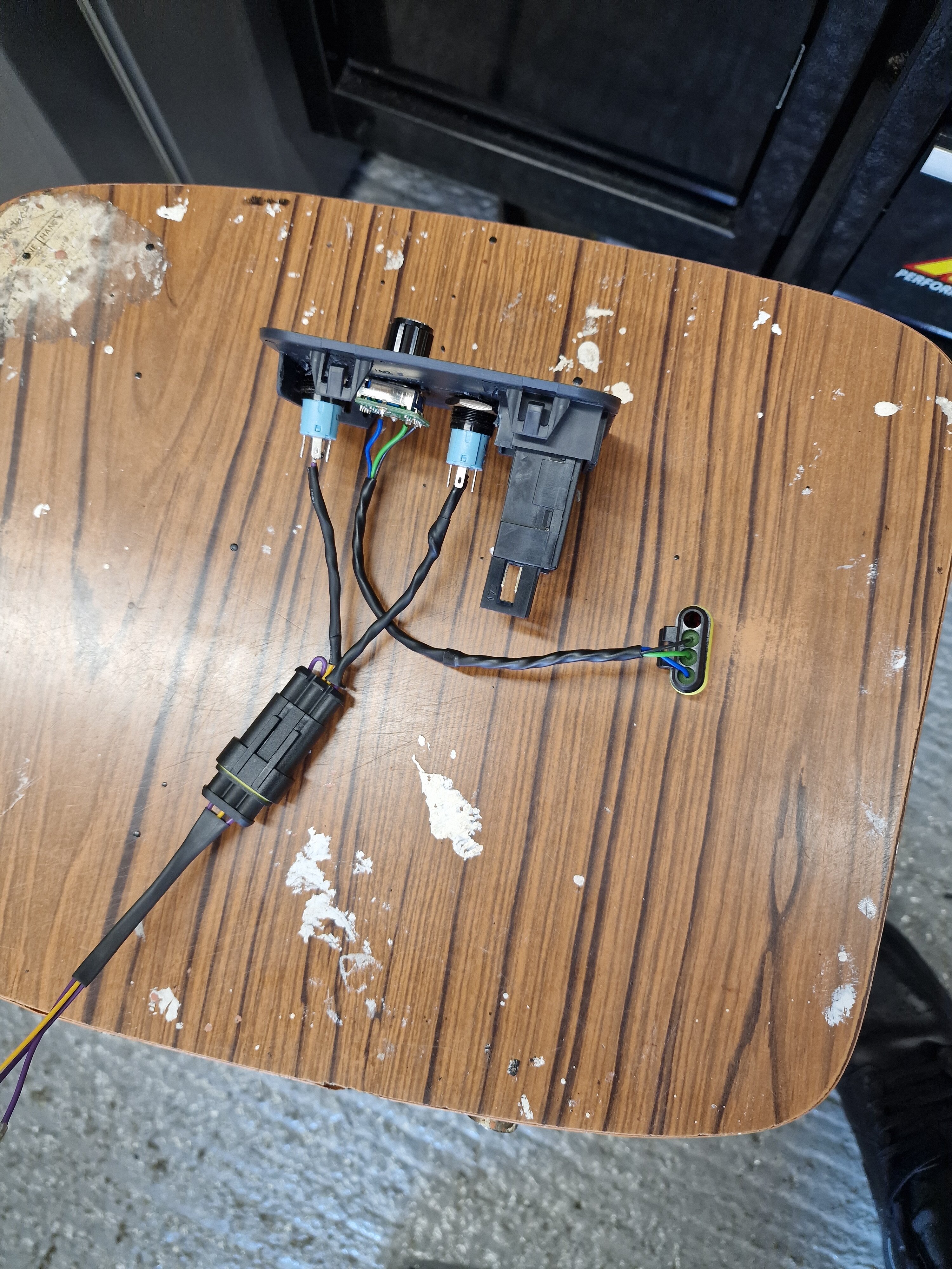

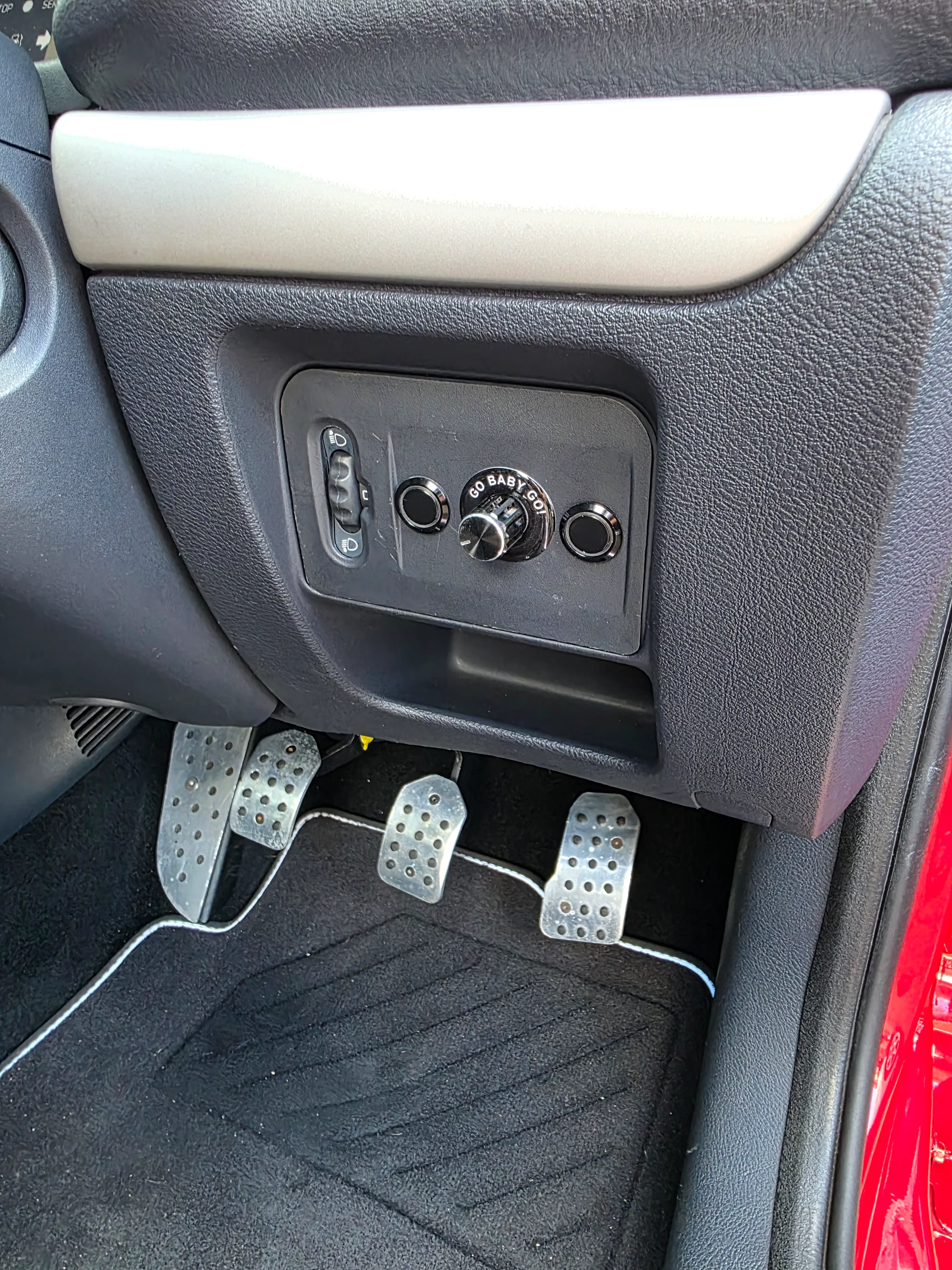

Knocked up a small loom to add a couple more switches on the ecumaster canbus switchboard today in the sacrificial dash panel. Daft hours work.
Both setup in ecu and working. Not sure what to use them for yet. Poss sport throttle map and linear for street. Maybe rolling anti lag (Danger to manifold?!)
If none of the above ill be boring and hook up cruise on it. We will see.

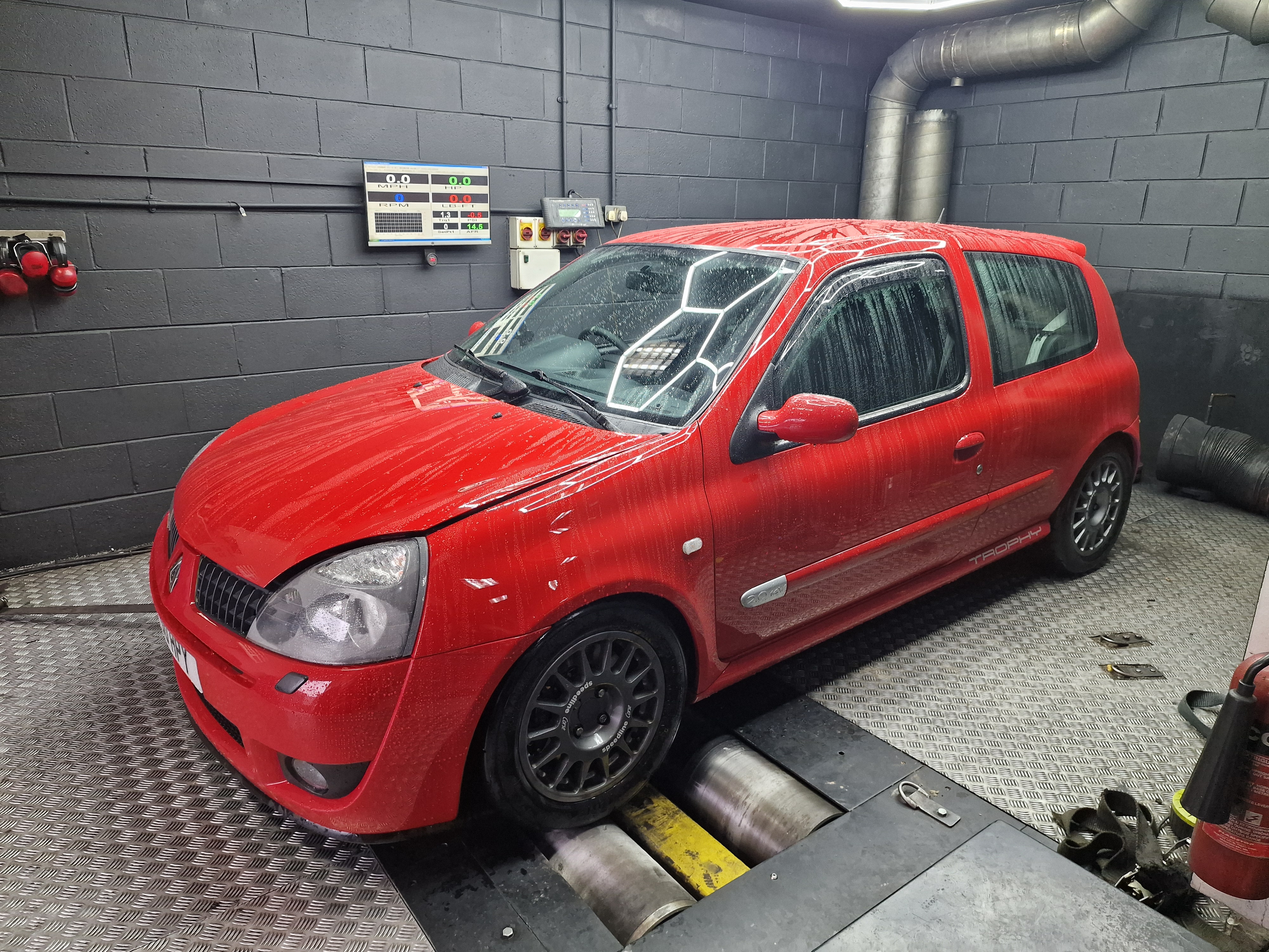

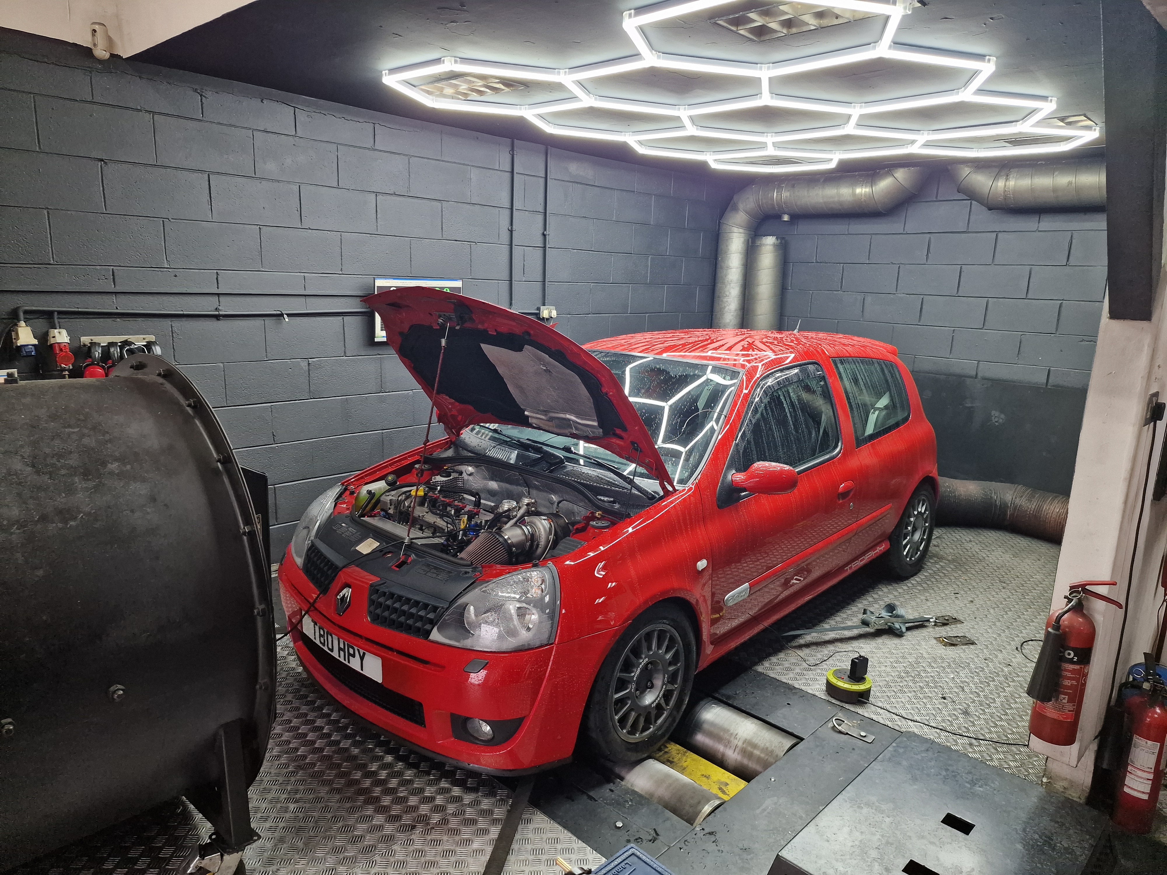

Arrived at Efi just in time for 330pm slot. Lashing down. Orange clio as backup full of tools and other s**t that might be useful.
A nice supercharged 197 was being finished off so short wait and strapped on.
Single roll incase it works.
Discussed with Chris the current issues with the setup, and what i had done to attempt to resolve this, but needed more help as fuel map needed work/needed to be run in a controlled enviroment to log and change parts. So this was essentially a diagnostics session in some respects if the issues could not be resolved on the day.
To recap it was going horribly lean for a split second around 64/6500 rpm which was almost impossible to tune out last time, and things were initially pointing to the fuel system. I had changed fuel pump to aem 400lph which had richened the fuelling up a point across the mid range.
The idle/low down fuelling also needed attention due to flywheel and clutch change for lighter twin plate setup. We agreed to sort this first, then start swapping parts coming back to the mid range fuel map later on.

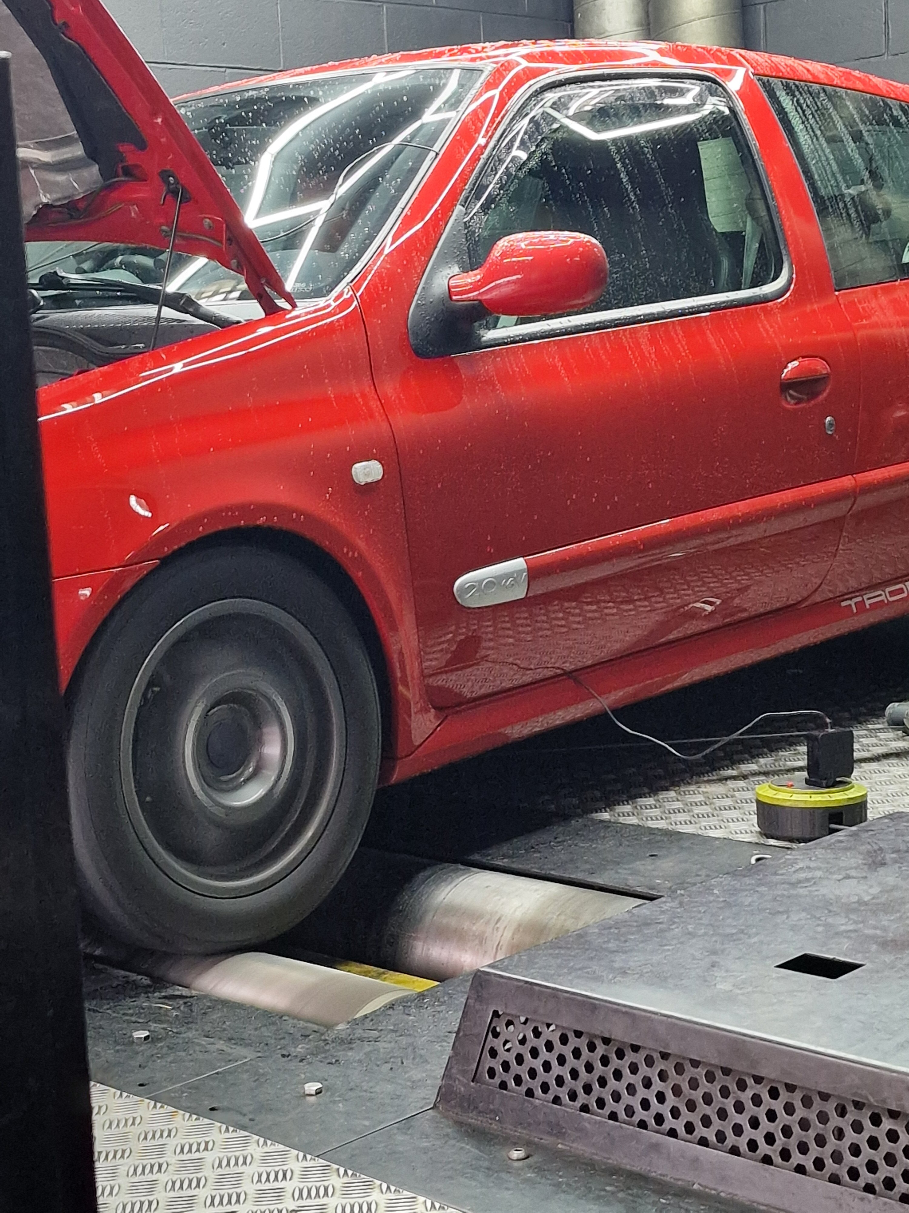

On with the tuning.
First run up and the fuelling is lean at the top. It was noted fuel pressure was rock solid and did not drop off so that was not an issue.
We then tried the below to see if the fuelling would change.
1. To prove the fuel resonance theory, i then fitted an extra meter of rubber fuel line on the end of the fuel rail, leading to the fuel pressure regulator inlet. Essentially moving the regulator 1mtr away and rubber to dampen the pulsing.
This done nothing unfortunately. Proving not a resonance issue. Reverted back to old setup to remove pikey 1mtr coiled up fuel line.
2. Software changes. We looked at the datalogs and nothing was jumping out. All tables/settings in ecu were checked and nothing untoward that would cause the fuelling to lean off.
All we could see was egts on cyl 3 & 4 were spiking higher than cyl 1 & 2 before 6400 rpm issue the dropping after this, indicating lean then not lean on that pair. Egt sensors are very slow to respond. To rule out wiring, and voltage drop to the injectors we swapped the injector plugs around to opposite cylinders and changed the software to suit.
Again no real change. Reverted back to old setup.
Also changed injection angle and a few tricks in the software. No real change.
3. As we were starting to clutch at straws, we discussed the possibility of something on the piss with the injectors. Chris has the 980cc bosch injectors in stock so a new set were selected and tested on ansu machine. I installed them, done a run and the fuel curve did change slightly but still same issue. We tested my injectors in the ansu machine, and mine flowed 5% better than the ones off the shelf and were all bang on flow matched, so basically the changes were due to mine being slightly better if anything.
So it was off with the fuel rail again and reinstall original injectors. The pressure falls off instantly but this time i pulled the rail and ended up covered in fuel. Nice.
4. Disconnected the vvt and done a run to see if that was causing issues. No joy, it was pig rich in the mid range losing power everywhere as expected and still similar issues.
5. Fudge the ve fuel map to get over 6500rpm to see if any more data would be seen as its looking like mechanical issue. A few runs were done monitoring egt/increasing the v.e in the cells required and trying to trim cylinders 3&4. The v.e is nice and smooth around 106, and you literally have to ramp it up to a large peak of 156 to get over this lean spot and then drop the ve back down again towards the limiter as it is then stupidly rich. Its not right as it still goes slightly lean, then rich as fook.
With a pull to 7800rpm limiter we made 260/270ish hp at 7psi but again the fuel curve was s**t. You can see it holds boost rock solid to the limiter and the power curve is there or there abouts, so does not indicate any valve float issues..which it should not have anyway with supertech double valve springs and 7psi boost.
5. Final thing we tried was changing ecu to.my spare ecumaster black. This was to rule out any funky injector driver issues. Fitted, map flashed on and no change.
Vid of one of the many pulls done.
To sum it up, we ruled out quite a few things but no definitive answer over 4 hours on the dyno. Massive thanks to Chris as usual for his patience with this one. He said hes never had this issue before on one of these.
Honestly, not 100% sure where to go next. Its pointing at mechanical issues..engine runs lovely typically.
Cams in it are a bit lairy for turbo. 197 inlet/182 exhaust. Chris has tuned a similar setup and it worked though.
All i can think is, it is too much cam overlap at that rpm point for whatever reason causing potential reversion issues. With egt's pointing towards cyl 3 & 4 this is also on the longer runners on the manifold as its unequal length due to how nortech made it. We are unsure if the extra runner length is an issue or not and its causing the issue. But again you see allsorts of s**t exhaust manifolds working without similar issues. Hopefully not the manifold as it will be painful to change the design.
Another thing that could be considered is the inlet. We dont think this is an issue, as its a basic square box centre fed with trumpets in, no tapered design etc. Again any shitty inlets work usually.
Prob pull cylinder head off this winter and see if i can spot anything. Change cams to 182 inlet and exhaust as i can verify they work.
Thoughts welcome as usual. Thanks for reading.

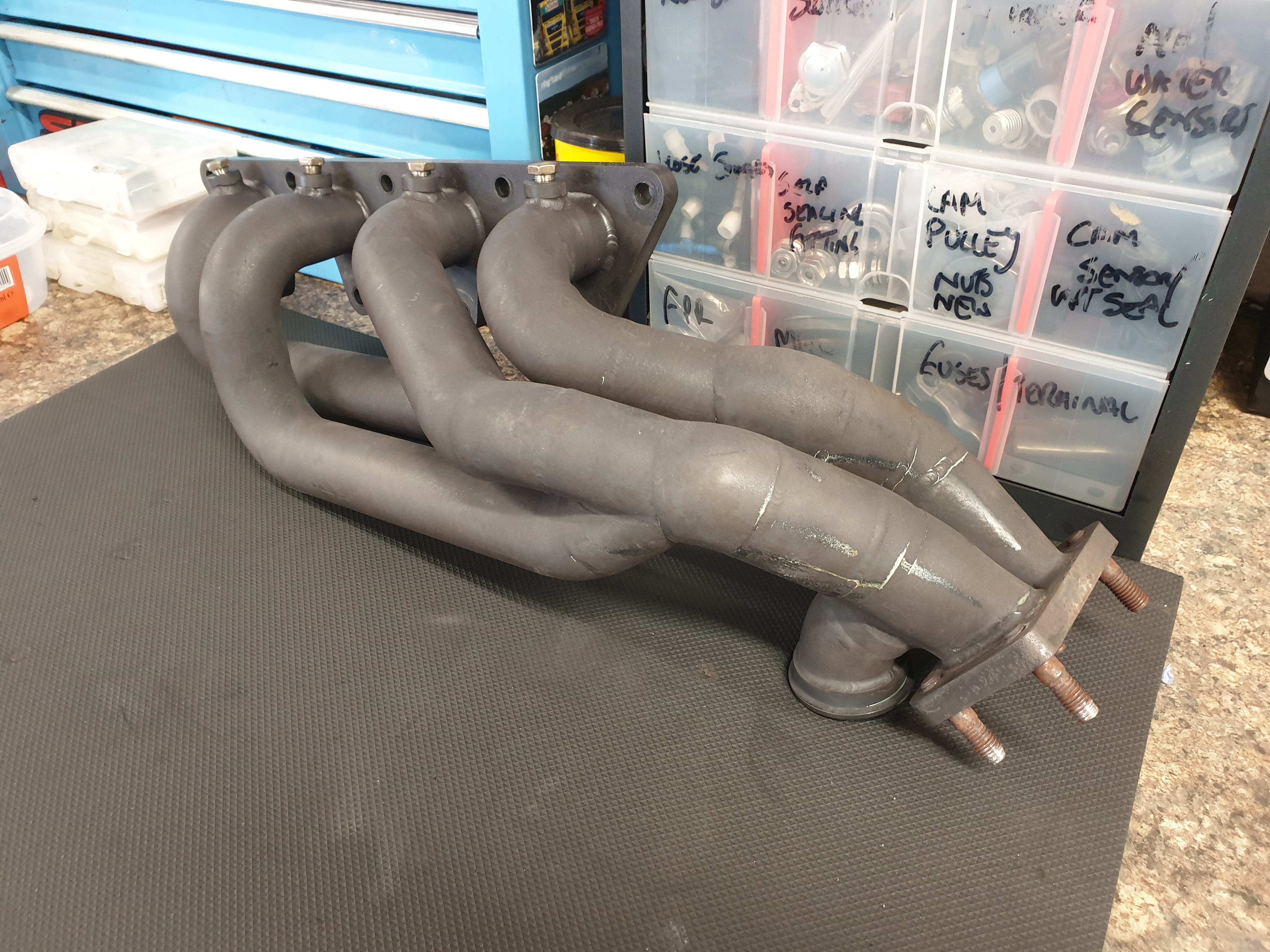

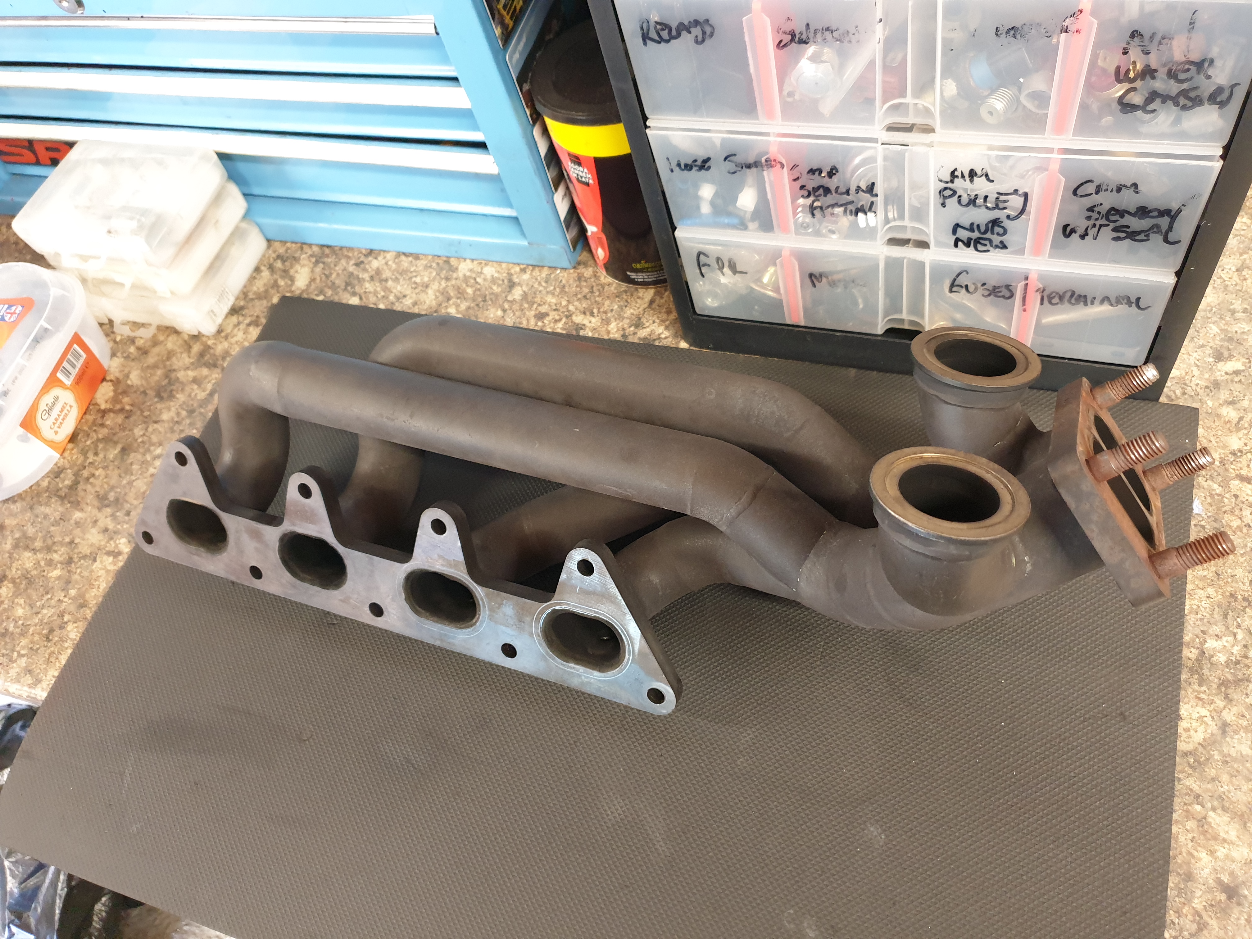

Exhaust manifold pics for ref..note longer runners on cyl 3 & 4 where egts spike briefly. Cylinders 1/4 & 2/3 are paired for twin scroll so assume no gate/backpressure issues and boost holds rock solid.

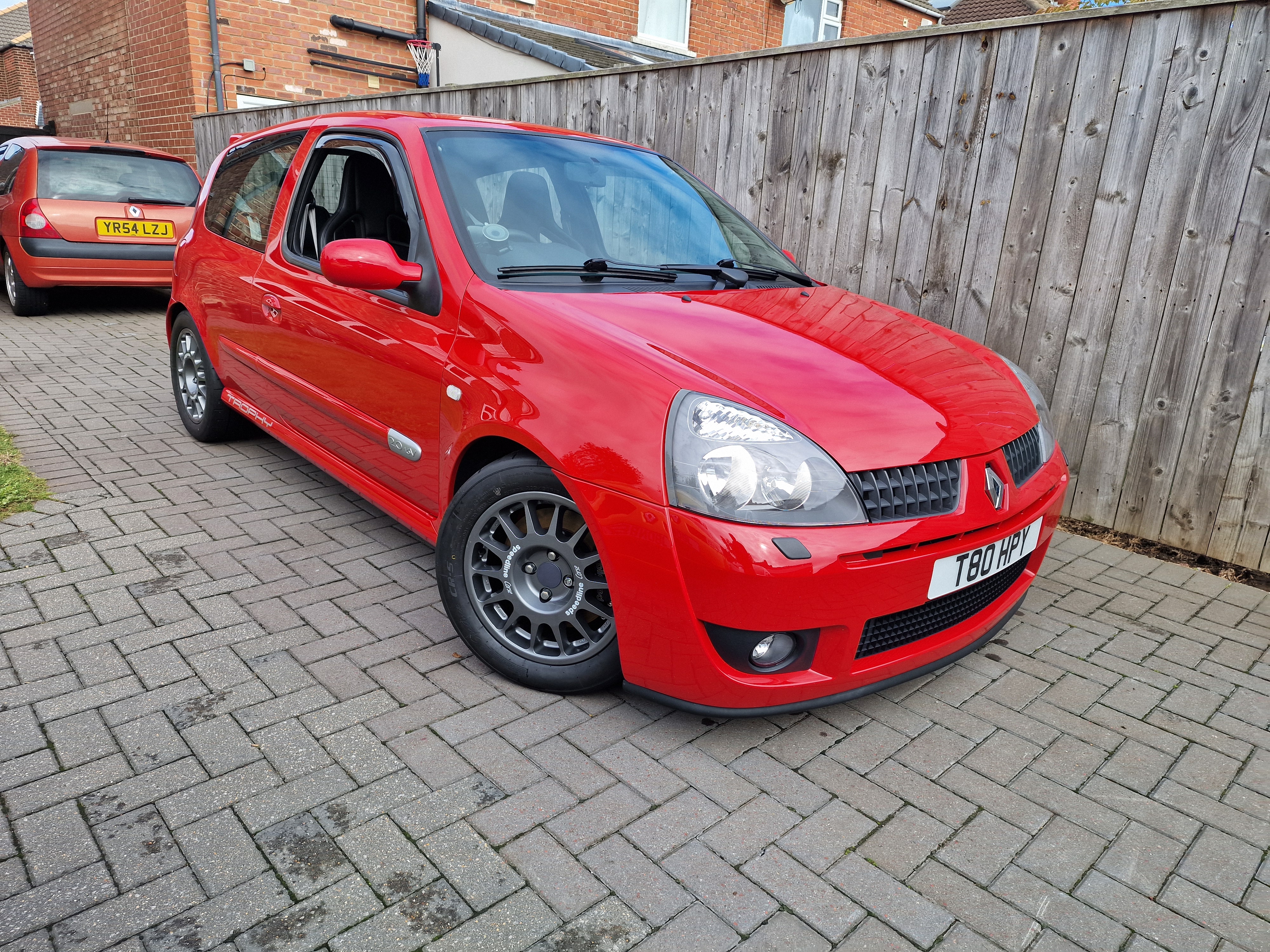

Forgot to add washed it on Sunday morning. Quick acf50 over the bare alloy parts and rcl kit.

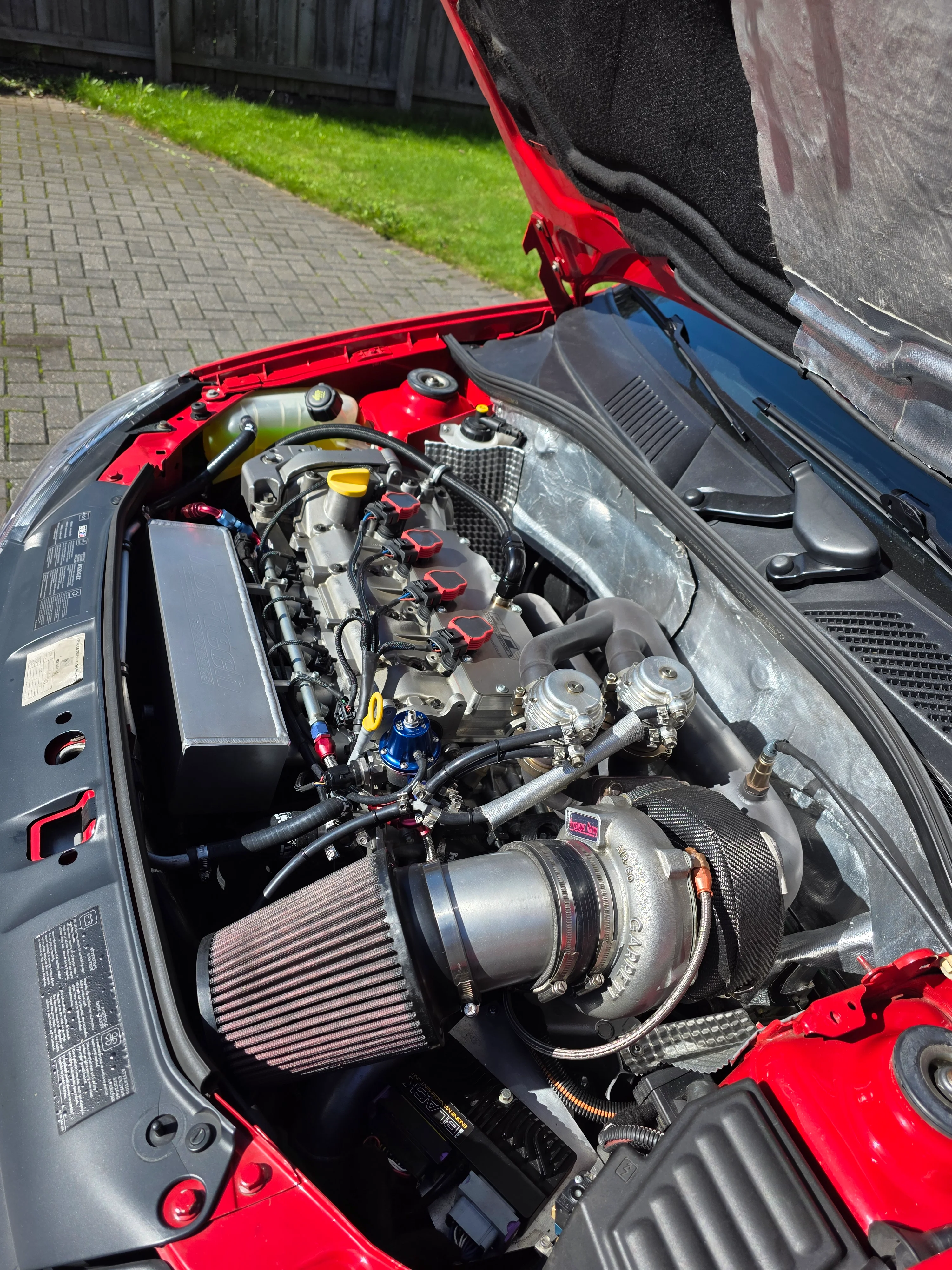

Update,
Well nothings happened really. I was brainstorming with Haswell on things that might have changed on the car since he had it. The only real changes are supertech double valvesprings, larger supertech valves and different inlet and exhaust cams.
Haswell suggested looking at the wastegates to see if anything funky was going on as it was noted higher egts on 2x runners/rear gate.
Couple of hours spare so had a look to satisfy curiosity if anything.
As expected, nothing wrong with either, both move OK/no issues, and both have 7psi springs in, so no imbalance.
So its off with the head soon to change the valvesprings to single catcams and prob change inlet cam to 182 as i know its a working setup.
