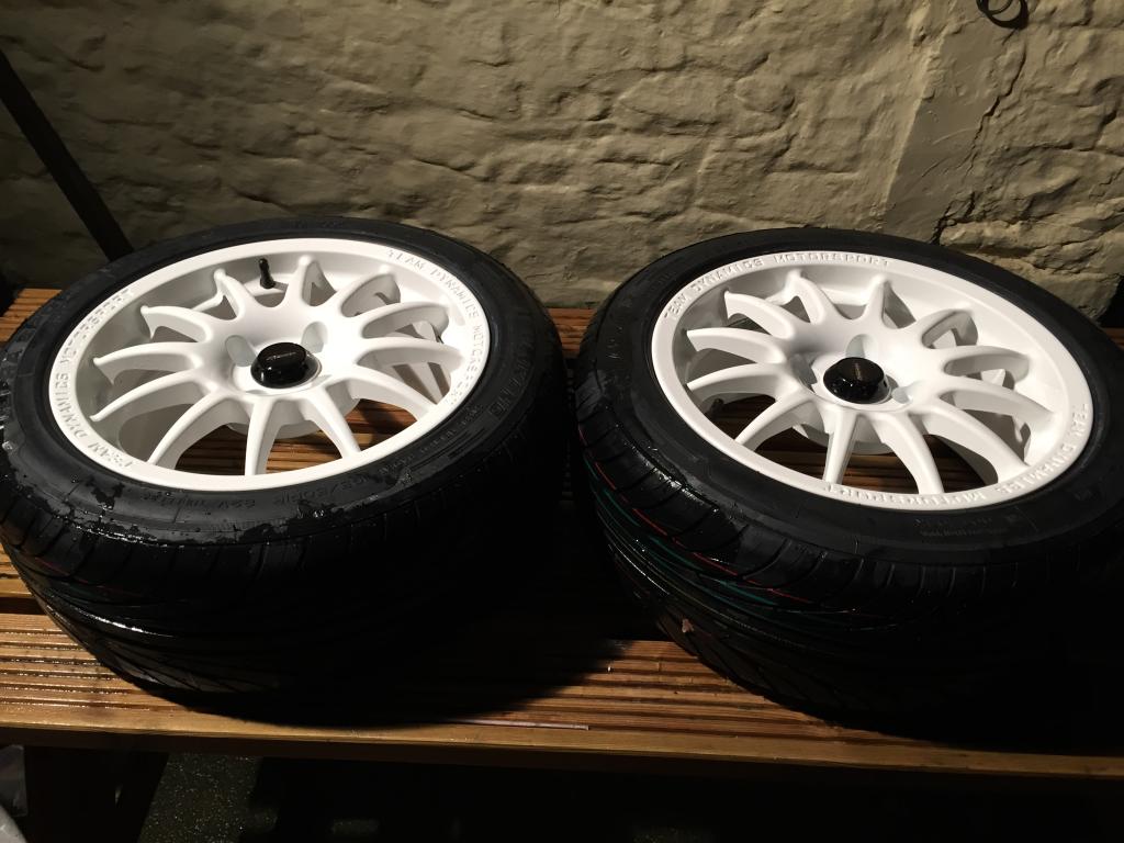

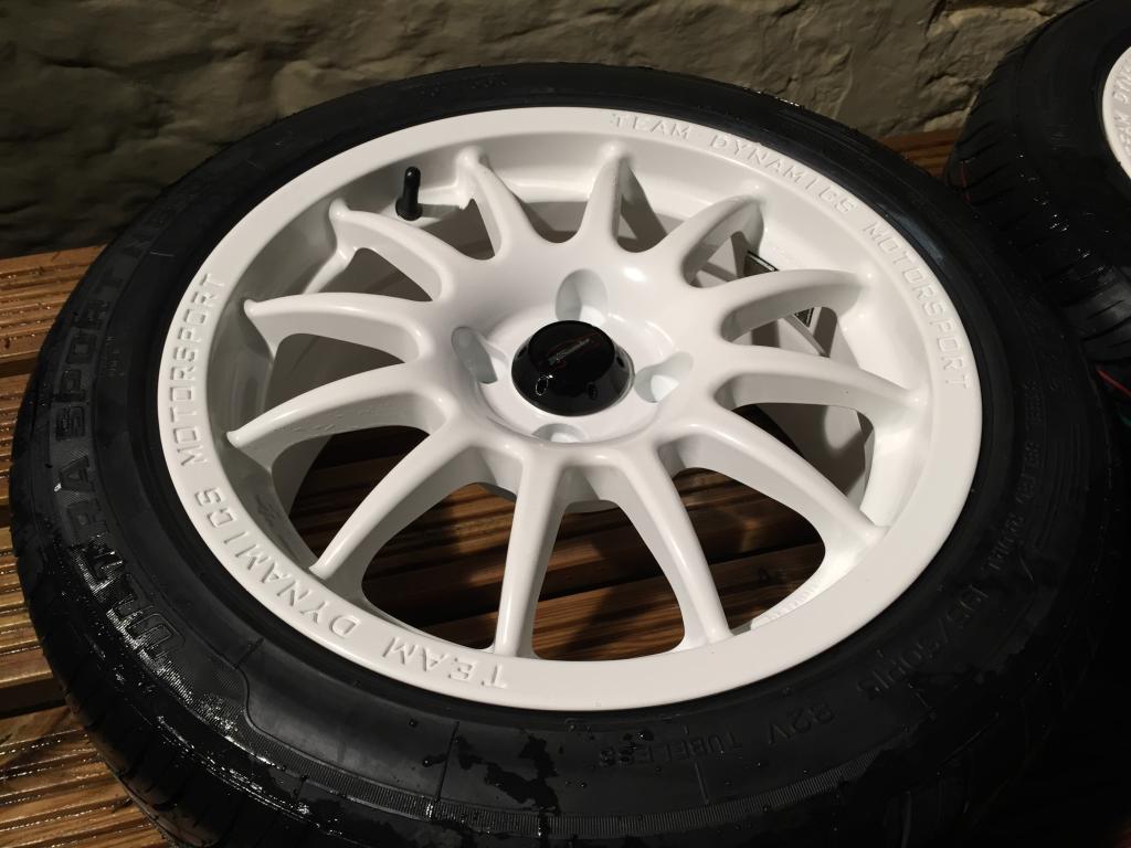

Finally got home from offshore to be greeted by these waiting for me:

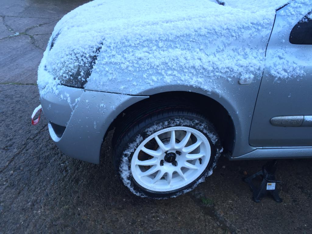

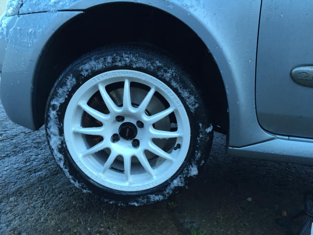

A thing of Beauty even with cheapy tyres fitted. 15" Team Dynamic Pro Race 1.2 ET35

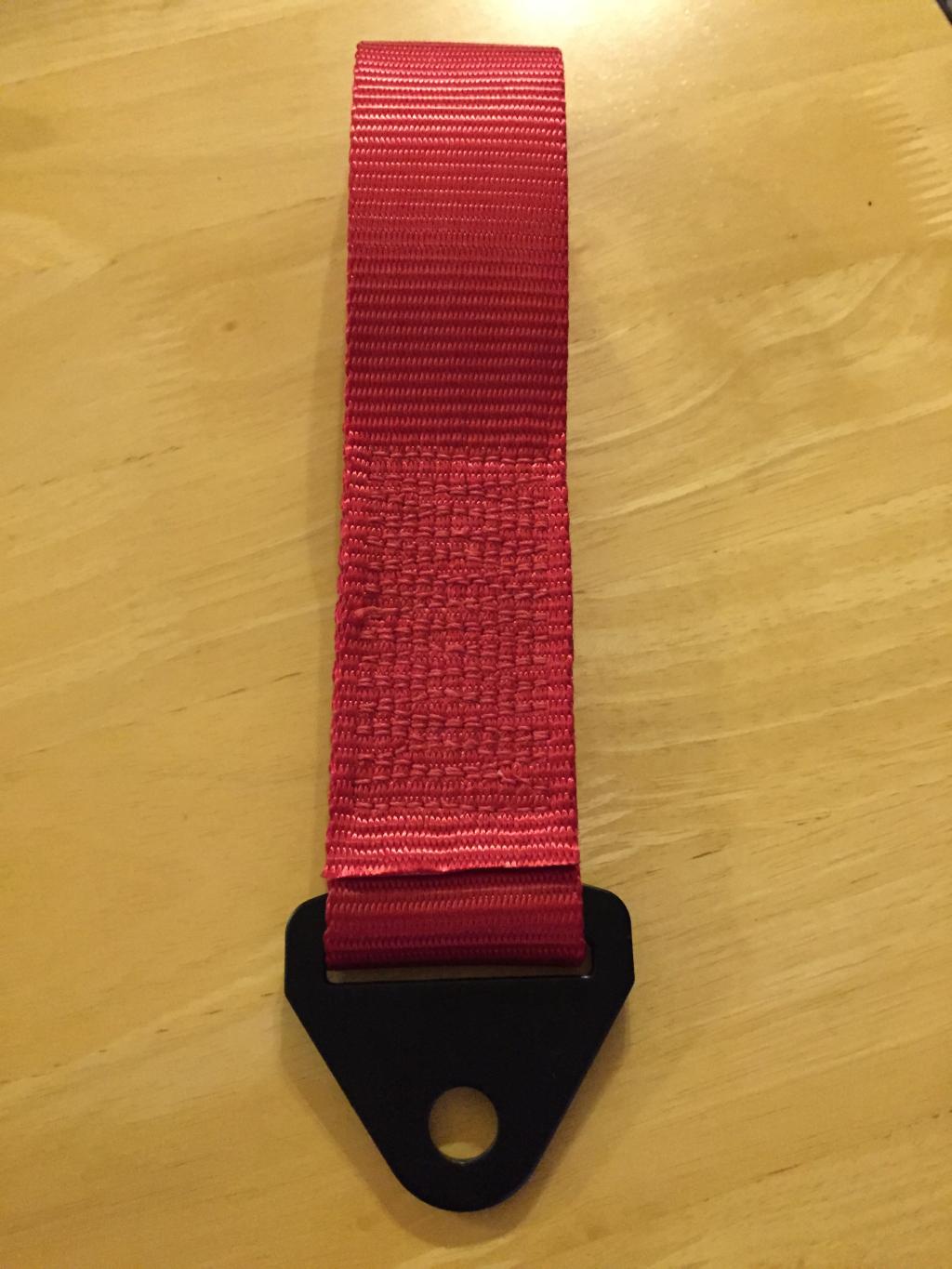

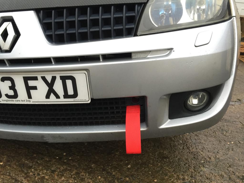

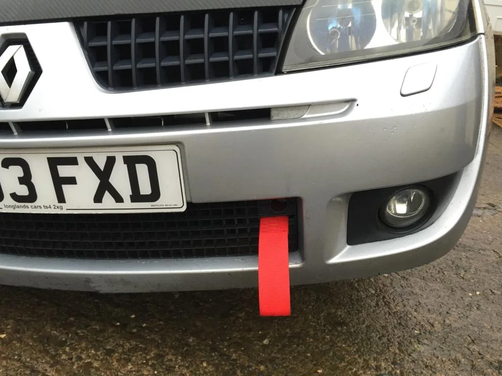

I bought a tow strap from eBay and managed to find one with a 15mm hole so I had less to file off. I have seen K-Tec sell them with a 16mm hole but their price takes the p*ss.
I also bought one for the rear with 13mm hole.
Anyway this is what they both look like:

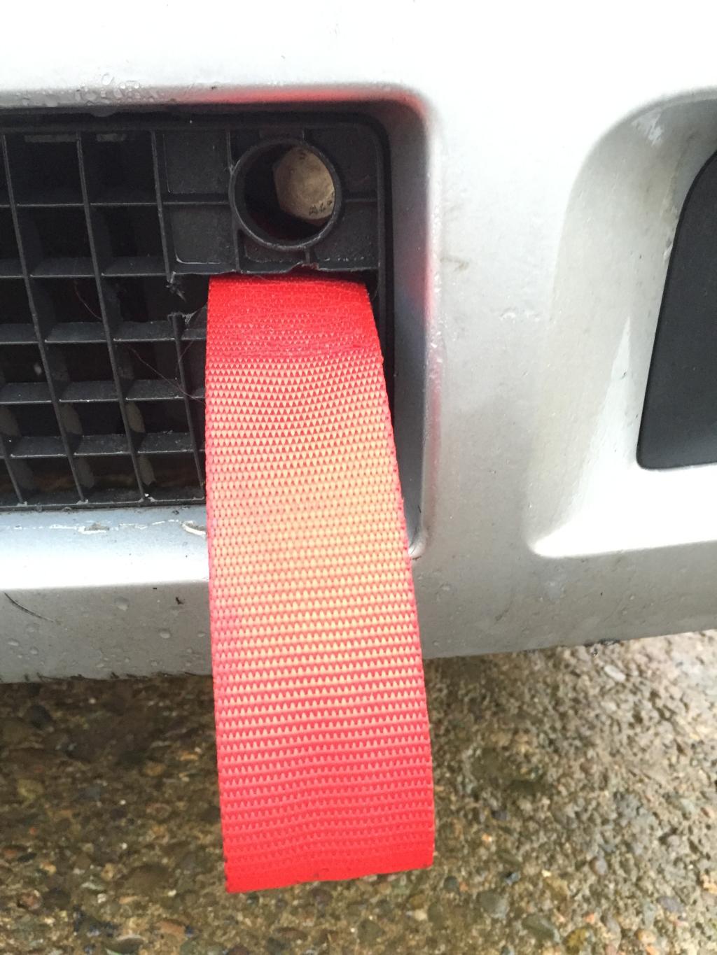

For the front I opened out the hole from 15mm to 16mm so I could get a standard bolt through. The depth of the original mounting point is only about 40mm so a 16x40 should do. My bolts were a little long so I had to use a nut as a spacer for now.
Once I had aligned it up against the car I cut a slot out where the strap would come through and made sure it would be a straight pull and not put pressure on the grill or bumper.
Then with the undertray removed I tightened it up and poked the strap out.

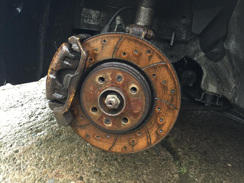

Current brakes are fine but going for a full fresh set from G 172 so these drilled and grooved front discs will be up for sale soon. They are a little rusty but only from sat without a wheel on for a few days:
Not so rusty here after being driven:

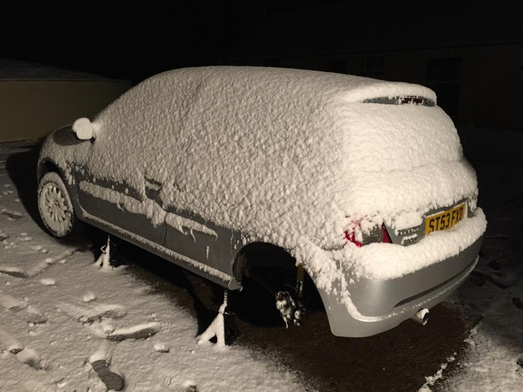

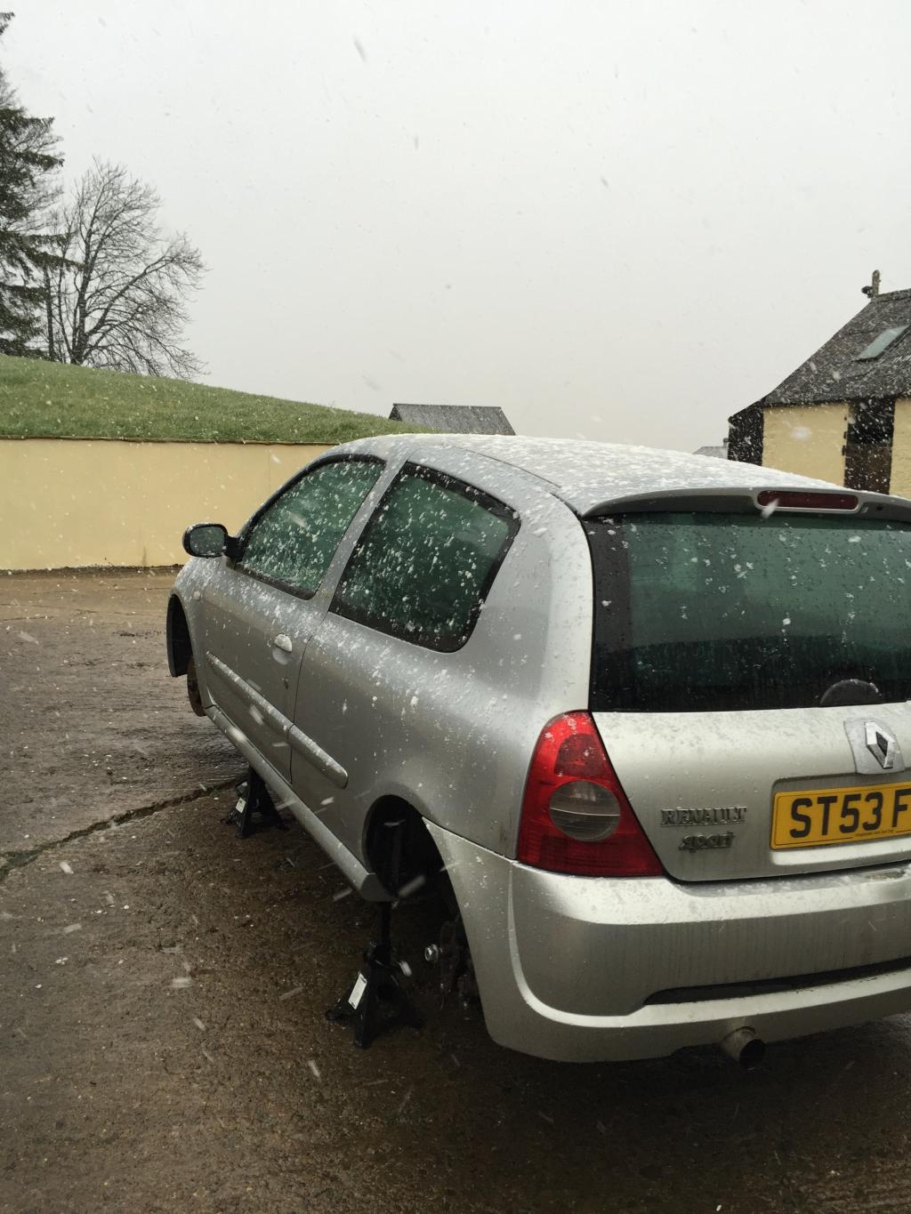

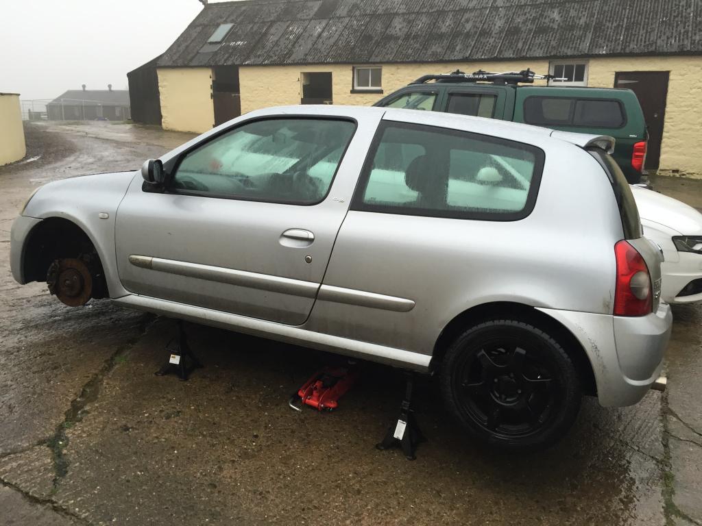

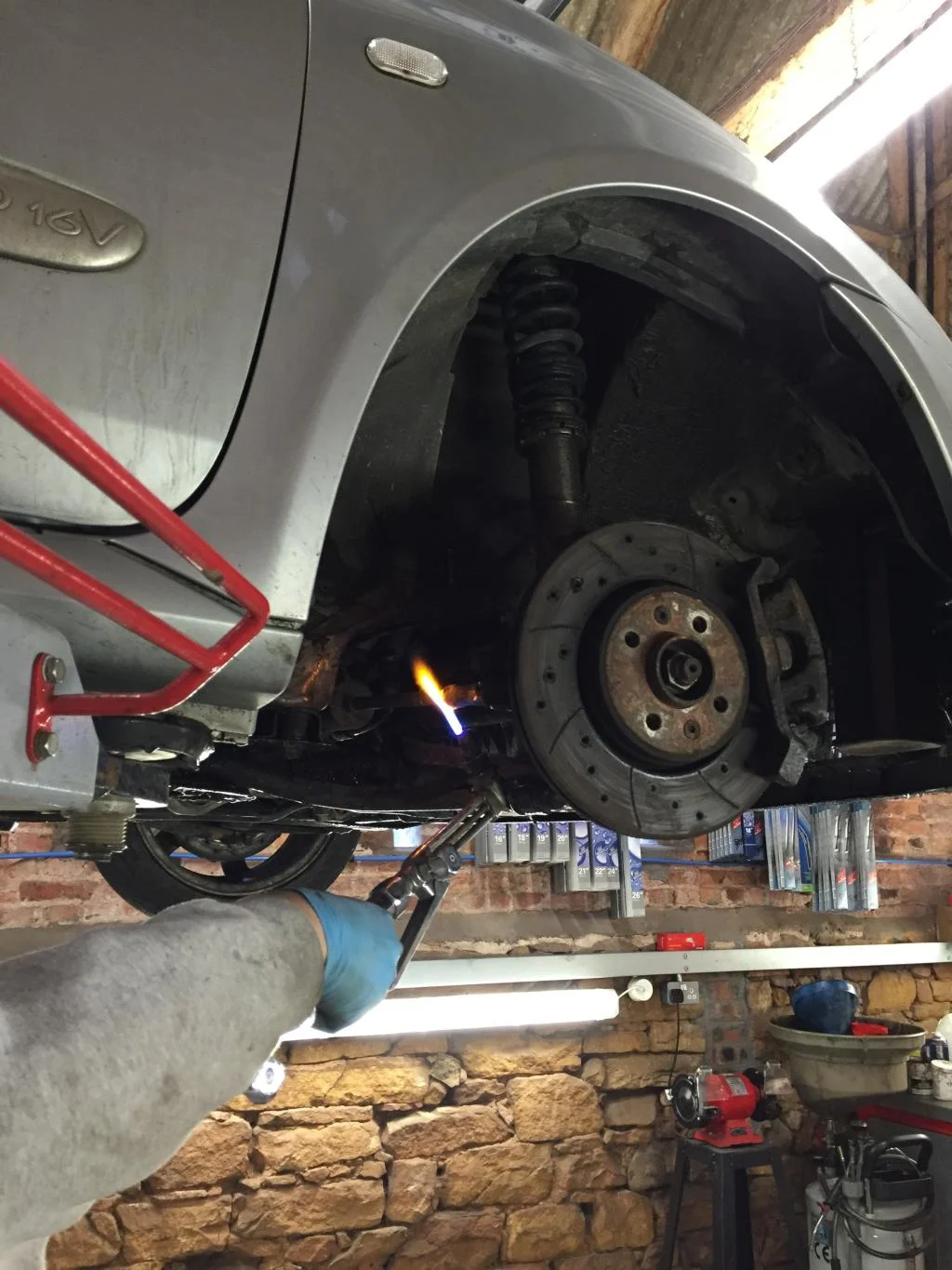

Well the brake parts have arrived but so has the snow!
I wrapped up warm and just got on with it:
And got the first corner done:

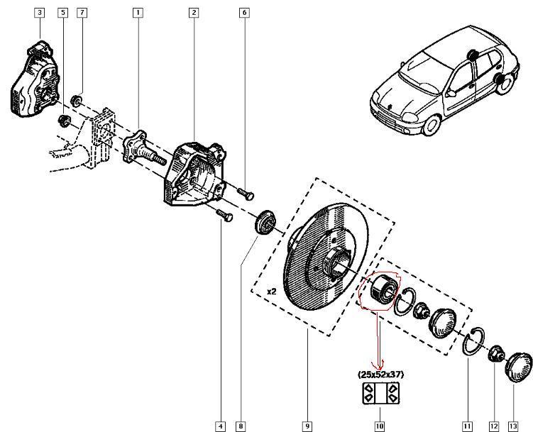

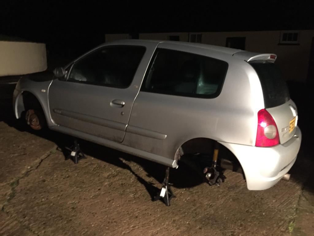

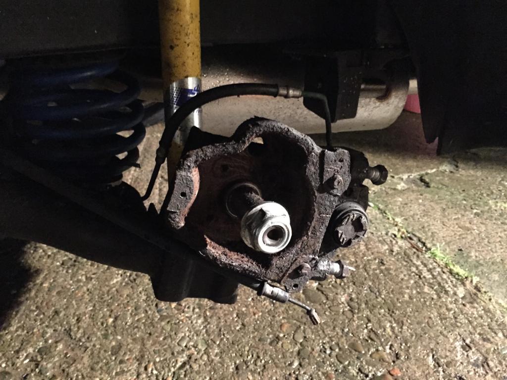

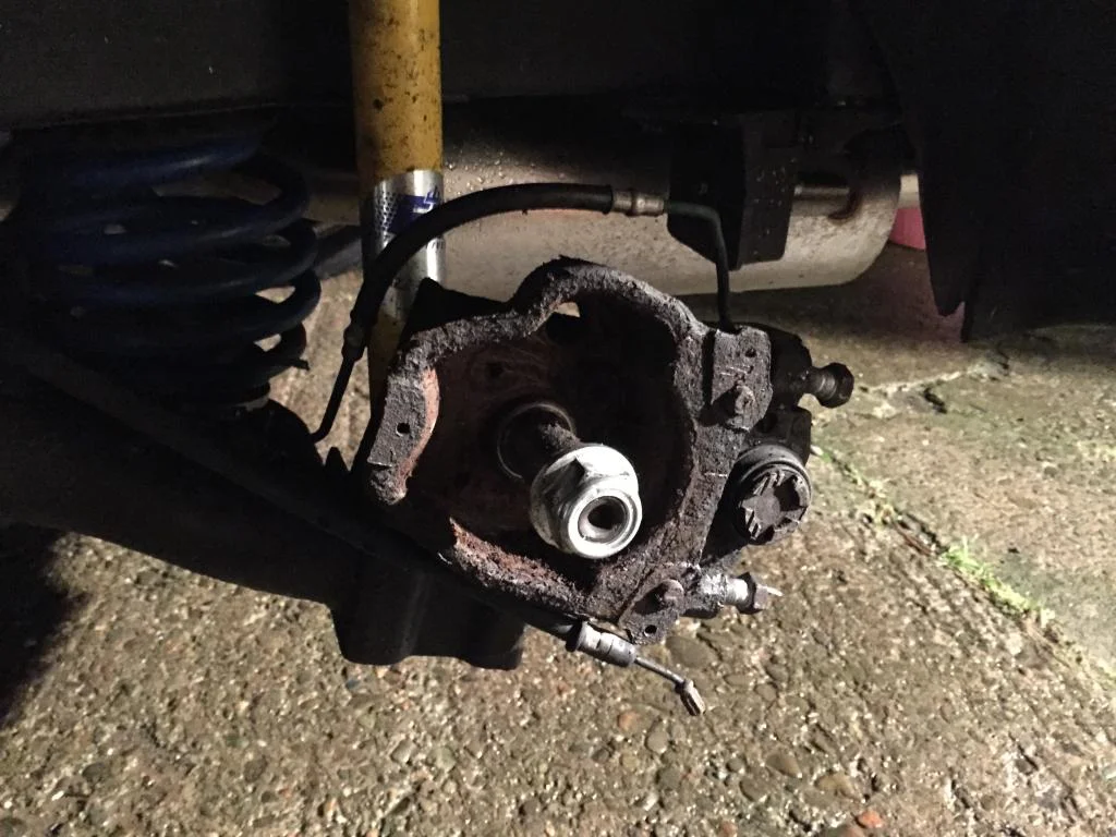

Had a hold up on the backs as the spacer was missing between the hub and bearing so will do these tomorrow hopefully. Item 8 I believe!

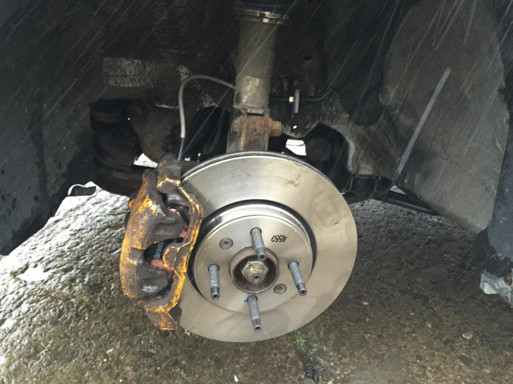

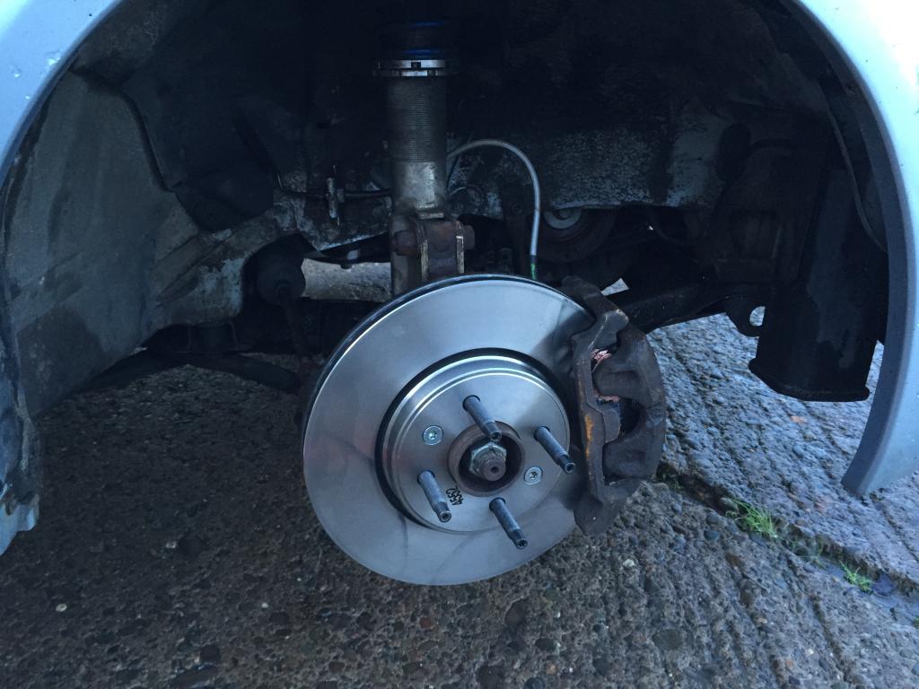

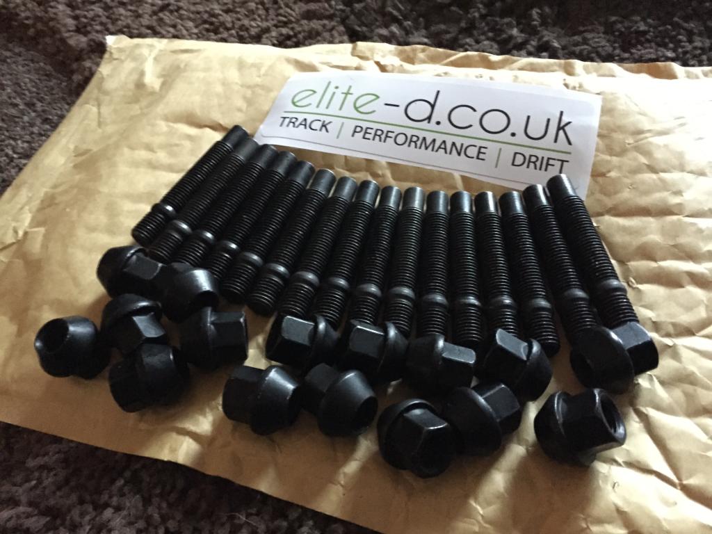

I braved the snow and wind and finally got the front brakes on. They still need bleeding but I want to get the rears on first and bleed them first. After fitting the drivers side disc, pads, lines and Stud conversion I couldn't resist putting a wheel on just for a look.
Get the rears sorted tomorrow when the bearing spacers arrive, get it all bled through and then I might take it for a spin to the barbers!!

Coming on nicely. Might have missed it but we're the discs shot or you just wanted new ones on there? Looked ok in the photos on my phone.

Wheels look good
Thanks. They look like they will suite it better than the Black Comp 2's

Yeah the original brakes were fine I just fancied starting from fresh with a complete new set so I know what's what. I don't know what make the front discs are but they are fine condition so will put them up for sale. I thought the back discs were a bit thin but turns out they aren't much thicker when brand new anyway. Glad I looked now as the rears were missing the baring spacers.
Calipers need painted
Yeah they are in a bit of a state but at least in perfect working order now. I didn't have enough time this week to do the callipers and as they were wet, oily, dusty and rusty I though I would leave it until summer when I have more time and maybe even get them stripped back to metal and paint them up properly.

I like White wheels on a silver car, looks good and coming on nicely.

I do like white wheels but I just couldn't live with the cleaning of them! I find silver bad enough

I am a little concerned that race pads might destroy the white wheels which is why I may use the black ones for the track which is a shame as the White look really race car!
