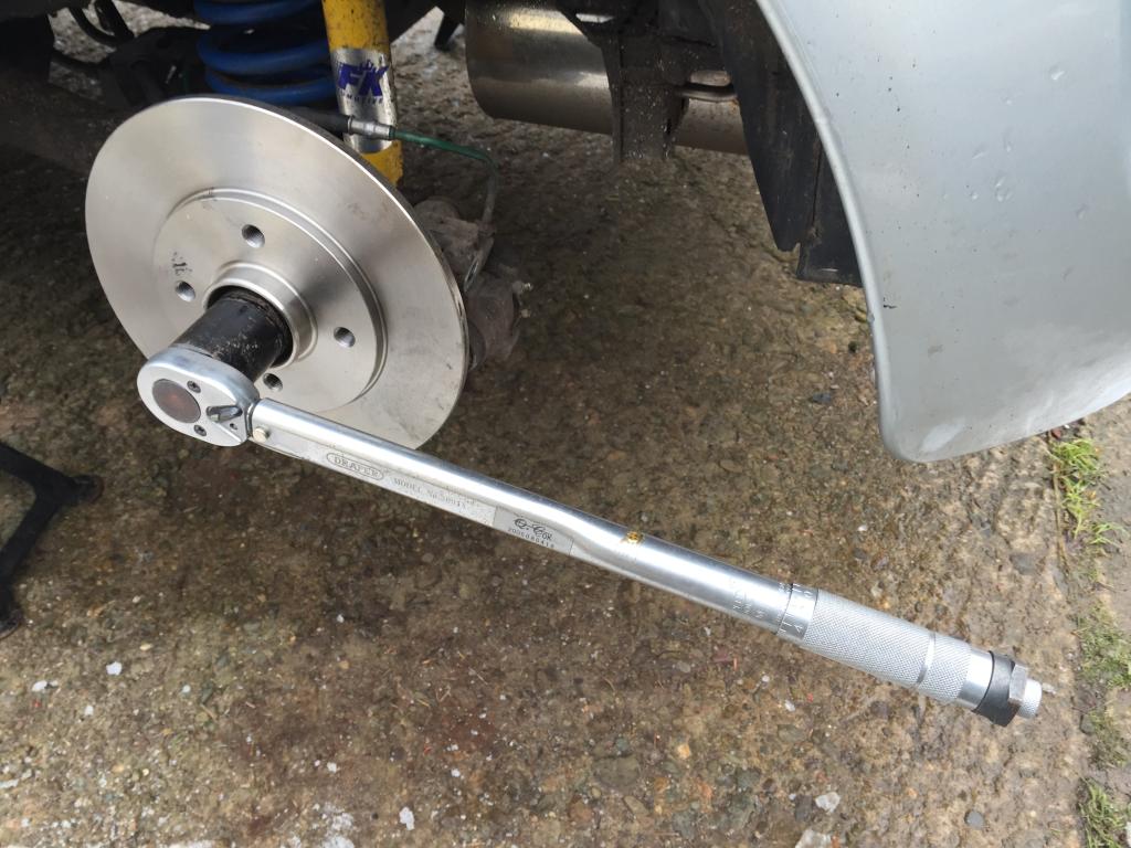

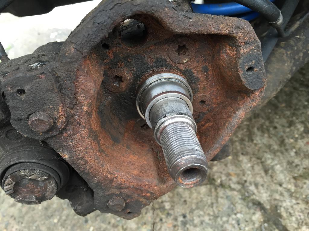

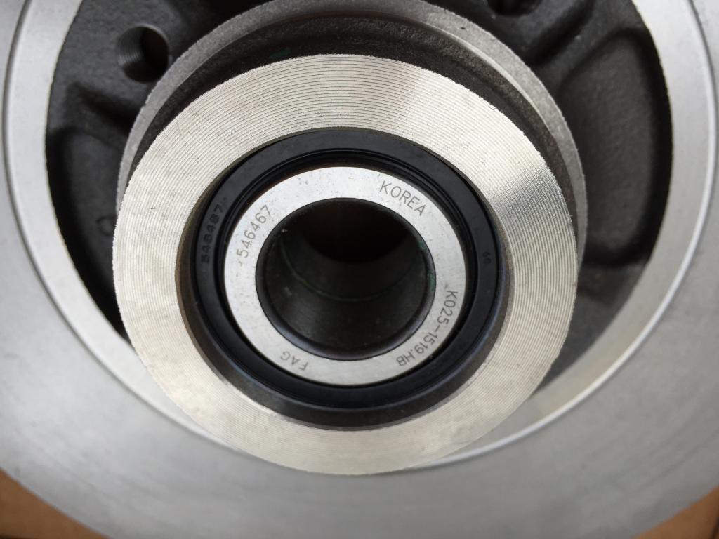

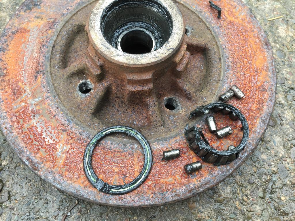

Anyway I came up against a problem with the drivers side rear. The bearing came apart and left the bearing inner sleeve on the shaft:
The passenger side came off no problem and I managed to get that all fitted together again:
I have just managed to get the bearing sleeve off with a grinder so will hopefully get it all finished tomorrow.

If I recall I had the same issue on my 182, it was a struggle and I was SO paranoid about the stub axle but it came off in the end thanks to a grinder.
I have just got to the bottom of it. The stub axle was flared at the end which wasn't allowing me to slide the new bearing on. I assume that someone had tightened it up without the spacer in which caused the issue. I even tried heating it up like I do at work to expend the bearing but it still wasn't having any of it and the new bearing came apart leaving the inner sleeve on again and a few rollers fell out. I managed to get the inner sleeve off the stub axle and reassemble the bearing. I had to grind and file the stub axle to allow me to get the new bearing on. It's all back together now but I am stressed that I now know the stub axle has been butchered and the bearing has been apart and reassembled in not what I would describe as an ideal environment. It doesn't feel bad now all back together so I will keep my eye on it.

Those rear wheel bearings are a f**king pita. I've had failures after only 25 miles use!! Used SNR bearings (oe make) had the spacer at the back and I torqued them up to 175Nm as specified. Not no f**king more though!!! Got a solution sorted that retains the original stub axles and disc but uses a larger bearing. That should hopefully see an end to the failures. Grrrrr.

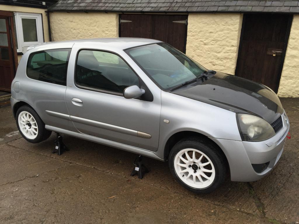

Well I managed to get everything finished in the end. I removed the carbon canister and the fog lamp from the drivers side too. I will do the passenger side when I have more time and can relocate the horns.
Looks alright with the White wheels:

I'm interested to know how you are going about that. Same stub axle an same disc but larger bearing? I'm puzzled and intrigued.

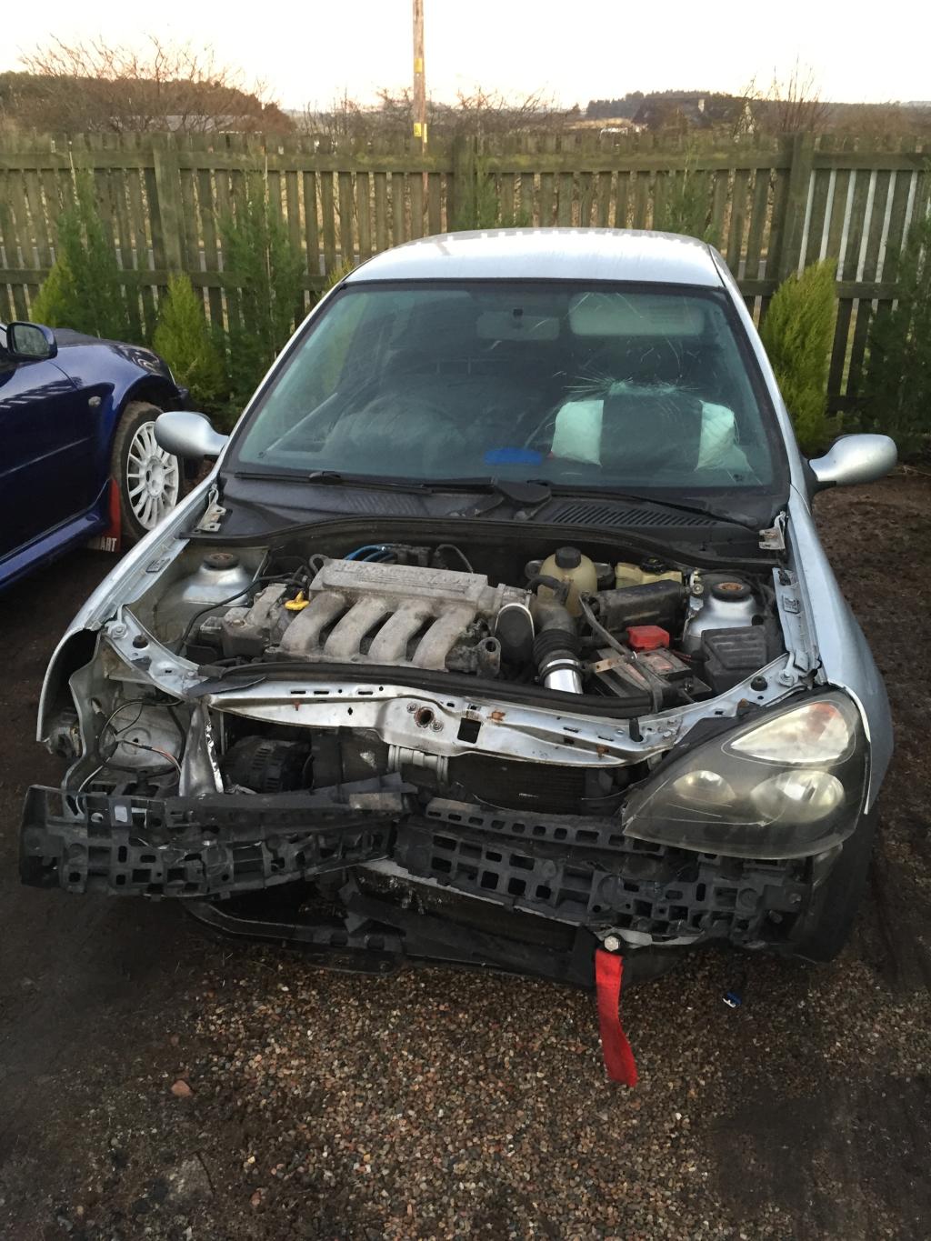

Quite simply not paying attention as I was just driving along in a world of my own, 1% throttle straight road, lovely day, watching the world go by and then..... Holy Sh*t that van in front of me is stopped in the middle of the road! No ABS and just skidded into the back of a van with a big step on the back!

I got a sore neck for a few days and feel a bit silly for not paying attention but the van driver was fine and there was no-one else involved. It could be repairable but just a quick observation would be it need a fair few parts and the subframe is twisted, inner wings all bent, windscreen smashed, outer wings cracked and then there will be all sorts of brackets, hoses, wiring, headlights, bumper etc etc. For the sake of buying another Cup needing some TLC for less than £1000 I didn't think it was worth bothering to repair this one.
My plan is to swap over all the parts from this to another one and then sell everything left over and what I have replaced from the new one.
