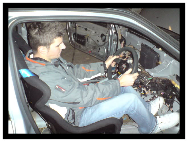

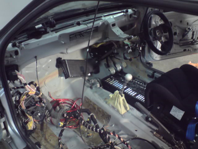

Well not a mega update but had abit of free time this afternoon to work on the car, had to head off for a meal at 6'ish so couldnt get my hands dirty but thought it would be rude not to install the new sparco steering wheel & boss kit i picked up from peperami this morning, Thanks again mate ;)
So now with the dash ripped out & the new wheel on
Had a sit & all felt spot on

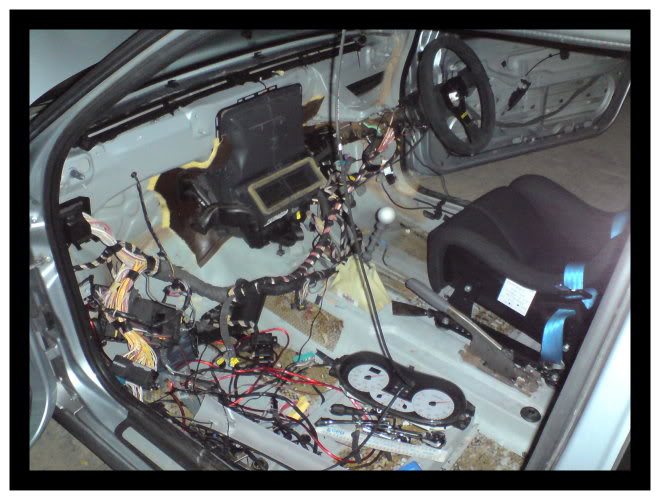

And the current issue.... what the fook am i gonna do about the heater/fan set-up.. still deciding weather to remove it all & run electric set-up
Dash is also staying out - Hardcore FTW :evil:, have been thinking up some cool ideas for the dash display but we shall see what i "create" lol

Imo you should scouer the scrappys for a light and compact heater box that will fit. Or just cut off as much as you dont need and get a non a/c clio fan. This will loose you the recirculation box on the drivers side scuttle. where the a/c evaporator is.
Worse thing would be to bin it all and then be dissapointed with a s**t performing electric fan. You wouldn't find out how good or bad it was untill a very very wet day.

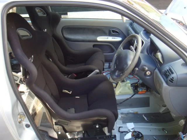

Get the rest of that brown s**t out and the seat looks a bit high

Christ!! Those seats are really high! Can you not get some lower subframes??

First thing I thought when I saw the pics lol

theyer at the highest bolt hole so wont take long to drop them down, i had mine midheight then got bored as i could see too much road, so dropped it all the way, about half inch off the car floor :) can now see some road but struggle to turn sharp left without the worry of knowing where the kerb is lol.

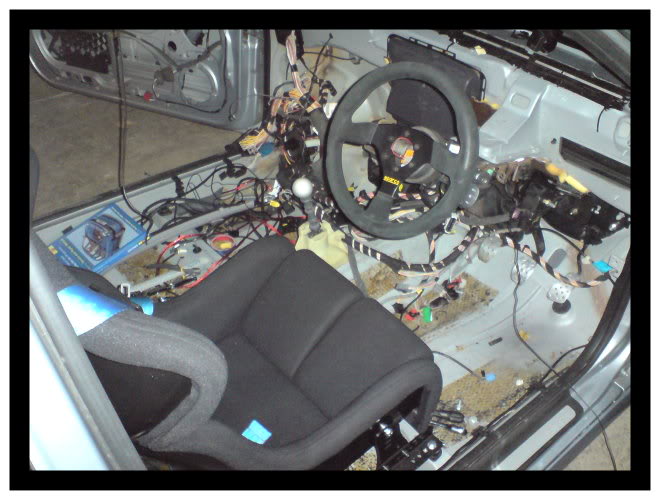

Regarding the seats, for some reason they look high in the pics, maybe because the dash is all out :S, belive me there low, steering wheel is on its lowest setting, when the dash was in i could just see over the top of the dash so any lower would result in blindness lol
This is how they looked with the dash in
Will get some better pics tomorrow night hopefully ;),

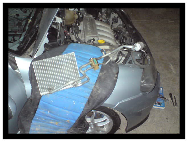

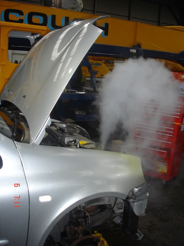

Attempted air-con removal... what an evening lol
So i recall that it is illegal to drain an aircon sytem into the atomosphere.. right? but how would you go about doing it? the idea at the moment is to remove it complete, which so far is going well but i can see in getting caught up some where :dapprove:.. so this is what we have managed today
Aircon interior rad - free
I was surpised by how big the thing was.. what little fuk it was to get outta the scuttle pannel, the remains of the fan housing lol
So as mentioned whats the best/safest way to bleed the aircon unit? & a quick question, what PSI is currently in a working Clio sport aircon set-up?

Nice lol
How did you do it by "accident" would just like to know so that i also dont make the same mistake ;)

'accidently' twisted the cap off and somehow a screwdriver got stuck in the hole/nipple thing and emptied the system
prob just f*ck with the environment mate, but the way 'JMS tuning' is going about its work I think that's the last of its worries ;)
  e92 + E46 M3 + Cup
basically its classed as polluting, the same as you cant pour oil down the drain
So its not dangrous to my self or paint work & the rest of the car then? just the enviorment? hopefully i dont slip with the screw driver in that case
M
mini-valver
I'd just get some tin snips on the hose by the strut top and look away!
  Focus RS Mk1
air con fluid is pretty toxic stuff. wouldnt wanna breathe it in, put it that way. loving the project :)

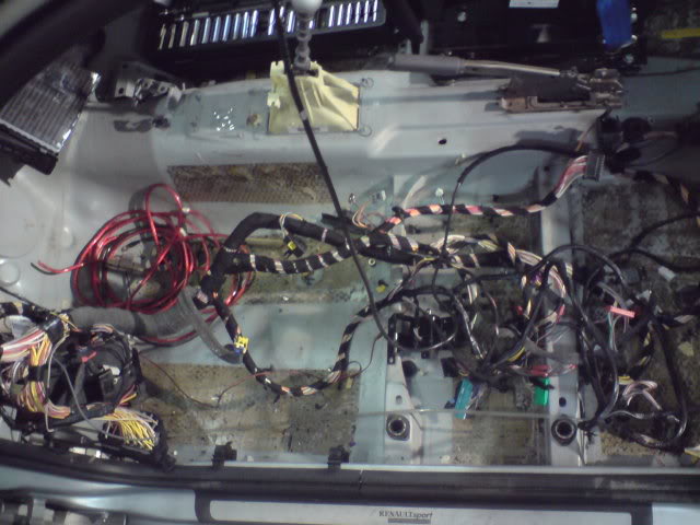

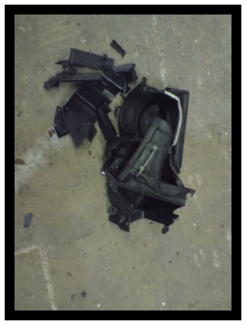

So finnished off getting the heater gear off, awkward fook!
Really dont wanna put all the shite back in but after my thread about the electric heaters it seems i have no choice :dapprove:
The next Job i need to complete at some point, sorting out the the mass amount of wires :dead:

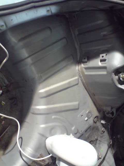

Had a quick sand & paint of where the old tar patch was in the boot, was trying it out as at some point the whole car needs to be done
Came out pretty good for 20mins prep & spray ;)
Cheers mate, affraid the air con unit leaked in the end, dropped my flat head screwdriver & it hit the valve, what are the odds! :rolleyes:

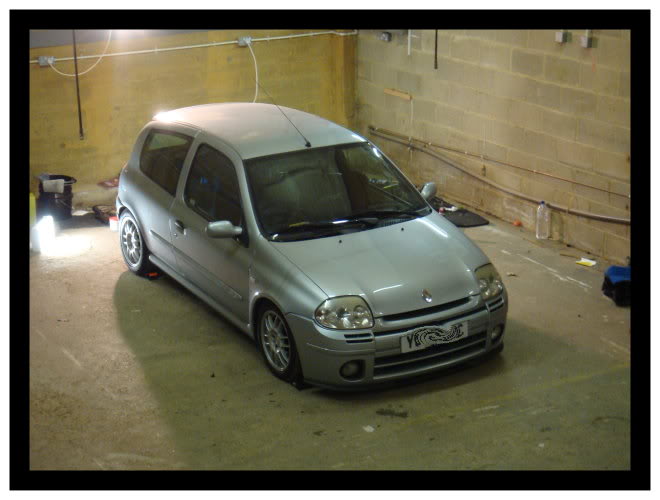

Wish I had a garage like that to work in :dapprove:
It does make life a touch easyer :rasp:.. although i may only have it for a few weeks/months so gotta get the project moving!

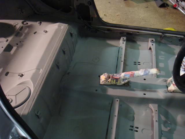

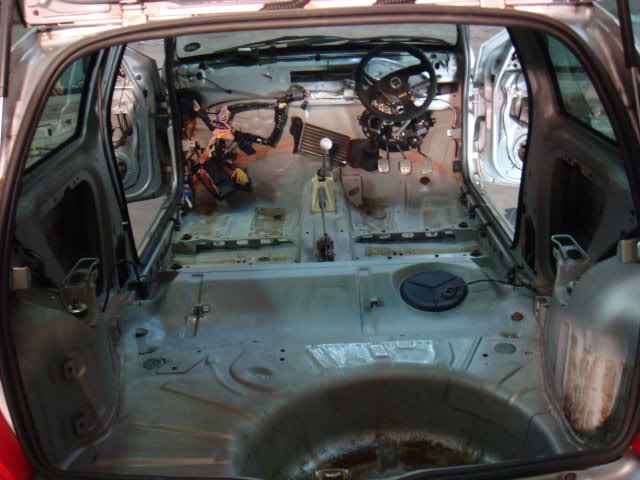

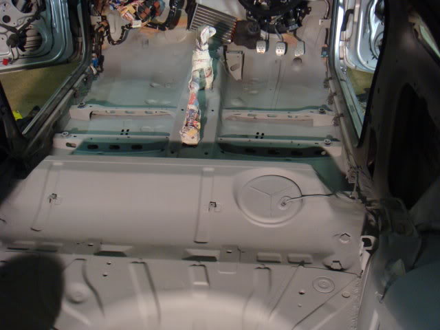

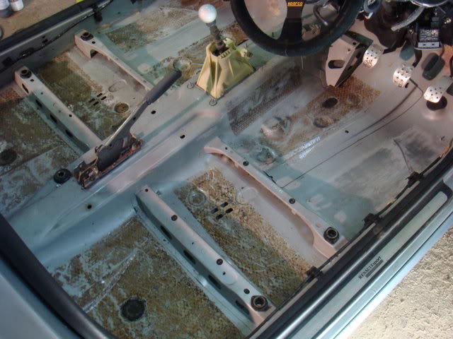

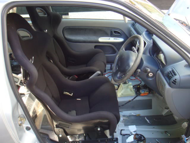

Firstly job, painting! so it was time to sand all the inside, then wash all the s**t out, which was fun as there was all sorts of manky stuff under the rear bench & spare wheel well looked rotten too so fair bit of prep was involved, how it stood after the clean & sand

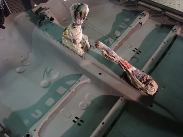

Sad sight! so masked up the windows & everything that didnt need painting & armed my self with some halfords rattle cans :evil:
The finnished piece :cool:

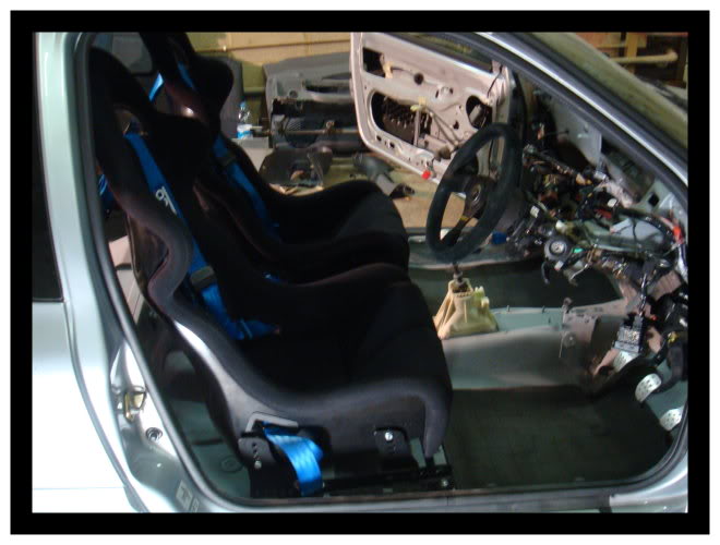

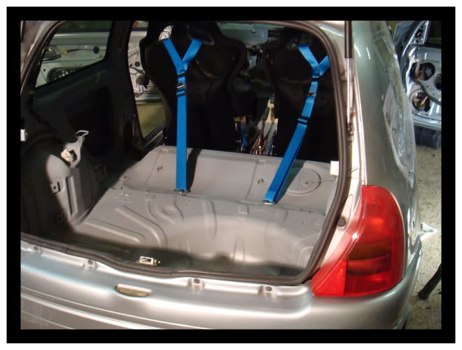

Bolted the seats & harness in, the blue against the grey looks very trick :cool:
