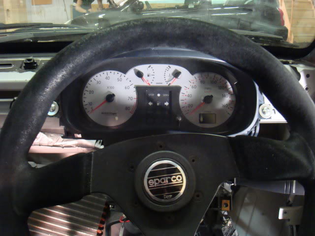

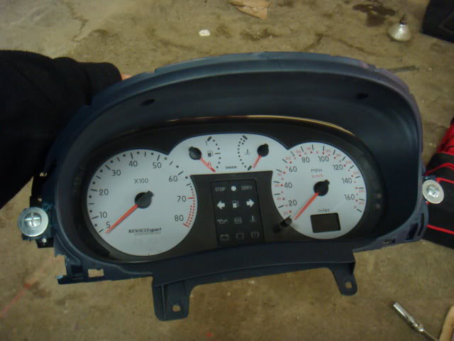

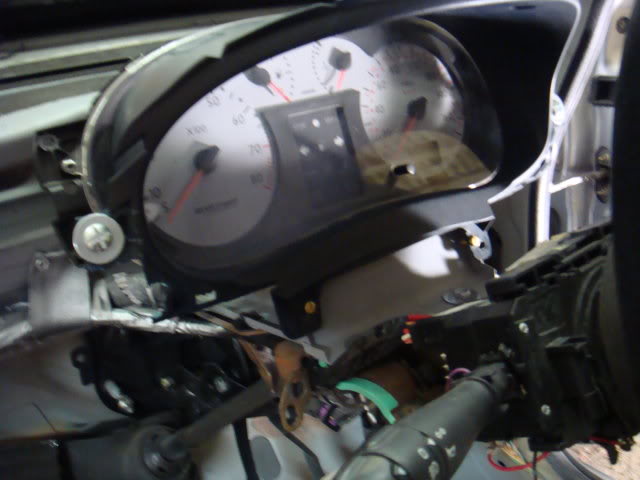

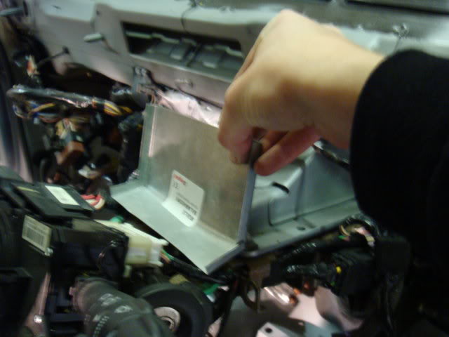

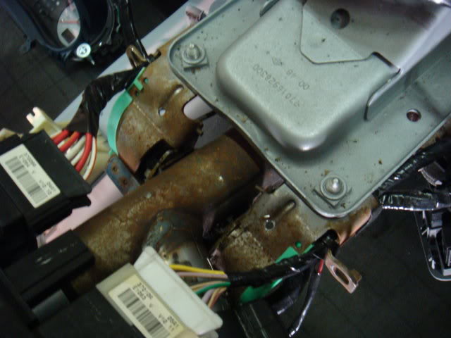

Next challenge was the dials/dash set-up, the plan!

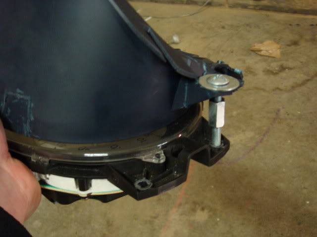

Rip apart the original part of the dash to mount on to the clocks, like so..
Bolted through like so, smoothed all the top half off to so it should look fairly tidy when its all covered up

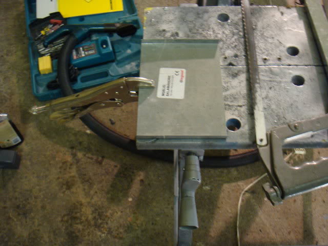

Next, sourced some 150mm trunking lid from work, have other uses for this stuff in the future to, keep an eye out for the brake cooling ;)
So added some cuts to allow it to bend & then had a quick trial
Then added some 6mm holes for the bracket to be fixed down too
Then got my custom plate to the right size, fitted the dials to it using 4mm screw & nuts, did a quick trial mount with it all thogether, took it all apart for filling & painting, then bolted it all back togehter, finnished piece :approve: - no £400+ dash needed here!
View from the drivers seat

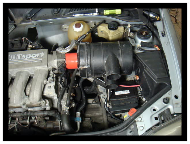

Just a small one, engine bay almost complete on the induction side of things
ECU now mounted flat
Fuel cut off smitch moved
Positve feed to the boot ( Concetions all tidy insed the fuse box ;) )
Pipercross panel filter installed
Red sleeve coupler installed ( pics not shown with jubiledd ties )
They you go MoRpH3uS, Just for you ;)

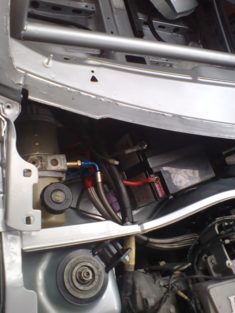

Burp, hows your power steering removal going? i'm waiting for some one to put some pics/info up before i start pulling it all to bits lol
  172 Race Car
its done mate. no pas pump on the engine just a alternator.
im switching to an electric pas pump from a saxo
  e92 + E46 M3 + Cup
No faith in the trusty DCI rack then? how come? thought running an electric pump would still cause the alternator to work which would mean you could still loose BHP? how much work is involved in your saxo set-up? may well be interested in this route my self if its simple to do so, i imagine not though right? as getting the pump mounted & plumbed into the lines?

doing the same on mine its simple enough only issue is getting a high pressure line made (return you can make yourself)
i personally would rather do that job than change the rack
  e92 + E46 M3 + Cup
Hmmmmmm... sounds tempting & easyer lol, ditz or burp, any idea's as to how to make either of the lines, high pressure & return? to be honest i havent really looked to much into this so i think a morning out side with some hot choclate & i'll get the thinking cap on, got any pics of the saxo pump? ideas on mounting? & is it used on all models or just the likes of the VTR / VTS?
  LY 182
used on lesser models too,, you want the later one ideally as the res is built it earlyer one has a seperate res just harder to mount.
your cars stripped isn't it so no heater box?? i'd put it in the scuttle..
or where the battery goes
lines can be made easy there are loads of on site hydraulics places that will come and do it
return is just a length of pas hose you can jubilee clip
  e92 + E46 M3 + Cup
Thanks for clearing that up for me ditz, i imagine there fairly cheap to come by in the scrappy then, when do you plan on doing yours ditz/burp? need pics & inspiration lol, take it its not very big if it can be mounted in the scuttle pannel, ideally i would like it mounted as low as possible, aiming for a vey low CG to get the car to handle spot on, hopefully the polly carb windows will be a big help but hear the rear window is near impossible to do unless you go to a specialist = £££ :dapprove:
  LY 182
mine will be done after christmas got the pump but need some brackets to fit the pas rack..
already cleared a space in the scuttle (it does fit) but if you want it low you could probably make some brackets and mount it infront of the gearbox behind the front bumper
and yep thats the pump
  e92 + E46 M3 + Cup
Nice one ditz, sound like in front of the gearbox is my best choice, keep me posted on how you get on with yours pls mate as i'll be looking to have it in for january for surrey rolling road on the 31st jan;)
  172 Race Car
Ive got the pump with the built in resovior. they go for about 80-100 on the bay. Got mine cheap through a mate tho. High pressure pipe can be made up but it might be easier/cheaper to get the clio and saxo pipes joined up, depeding on where the pump is gonna sit.
Ive planned on putting it in the scuttle (one reason ive done that wiper linkage mod) Ideally I wanted it on the nearside but the wiring loom is in the way. it will sit on the off sidequite nicely, cup racers have them there............
Not sure if its the ideal place for it on our right hand drive cars. Other options im exploring are to fit it in the original battery location or be really hard core and mount it in the passenger footwell, with the pipes going through the bulkhead.
Currently the idea im leaning towards is the original battery location, purely coz the clio pas pipe runs near here and will be very easy to join to the new pump at this point. At the gearbox mount area the hose is steel and not flexable. making all new pipes is doable but more hasstle/expense than going to my local guy and asking him to join pipe A to pipe B. Low pressure pipe is a diy job with some suitably sized hose and a joiner so no probs on that. Hope this helps
Mark, got to keep it coz my Doris drives it occasonaly. Plus im planning on getting some serious castor dialed in so it will be heavier than yours if i went to manual.
