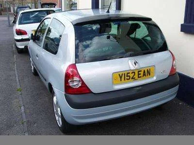

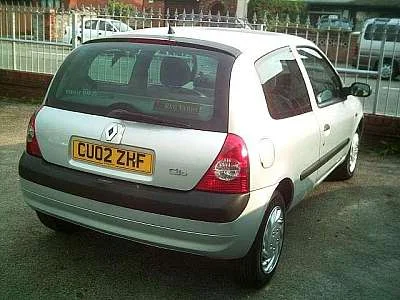

1. Base range Clio spoiler (non Dynamique models) - Very small, Red light.

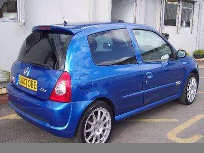

2. Dynamique / 172 / Non cupped 182 / V6 Mk1 spoiler (colour coded on 172 / 182 and later dynamiques) - Larger - Clear light

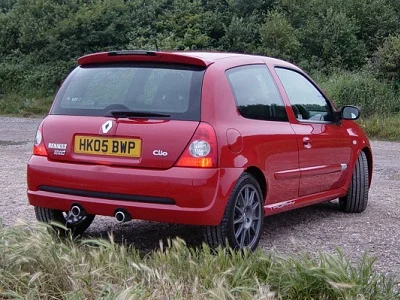

4. Clio V6 Mk2 / 182 Trophy spoiler - Largest - Clear light
