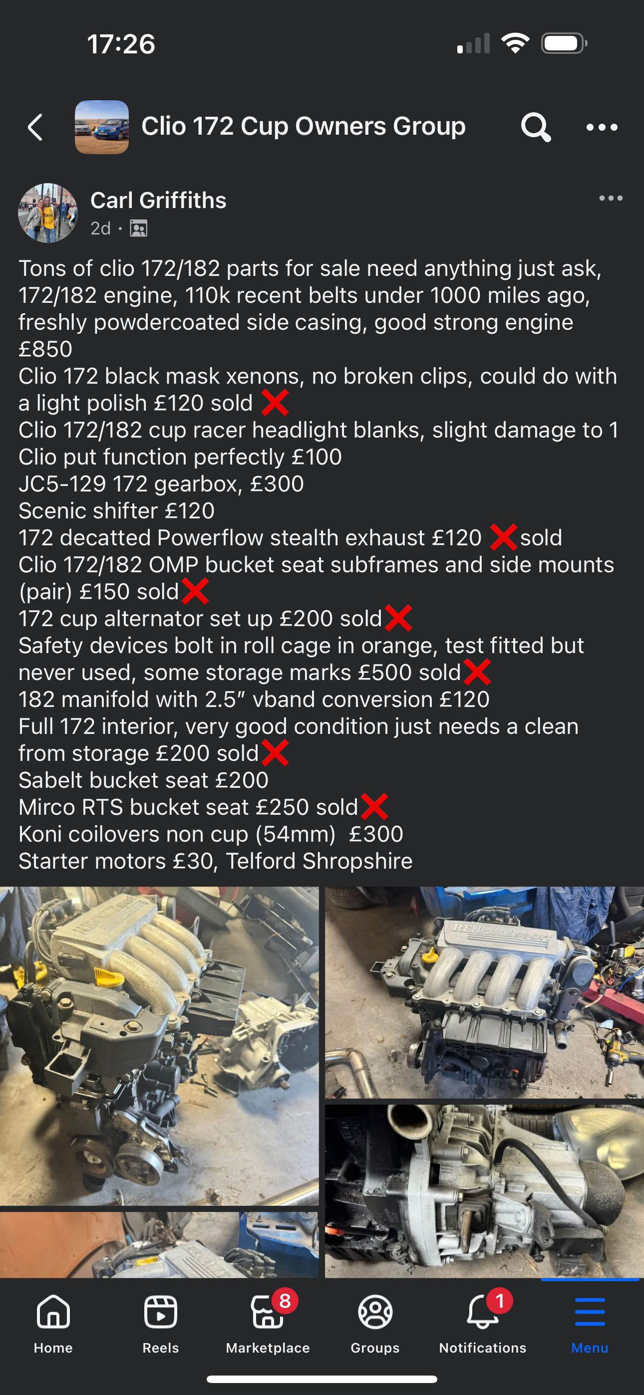

Which brings me to the main reason I'm updating this thread, I need an engine, a provable compression tested engine, the options I've got are :
1. Buy a random engine for £250 - £1000, total lottery as none of them come with a provable compression test.
2. Buy another Clio for under £2k, not that I have £2k to spunk on another Clio atm, swap the engine and maybe the box and have an entire car of spares leftover, but without testing the engine I could be buying another headache that's down on compression, I doubt anyone would be happy with me removing their inlets, unplugging the coil and testing every cylinder on their driveway, storage is also an issue with a third car.
3. Get mine rebuilt, I have no idea what's actually wrong with it so it would need a complete tear down so see if it's even saveable, I'm thinking a minimum of new piston rings, assuming the cylinders aren't scored, a complete head rebuild with the block skimmed, that's before buying new belts pullys, tensioners, aircon delete kit to replace my pikey setup, I have no idea how much all that will cost but I suspect it would be cheaper to just buy another car.
So in short has anyone got an engine that isn't a heap of sh*t?

Nightingales garage in Blackburn are always breaking Clios. You could give them a call and see if they have any good engines available.
