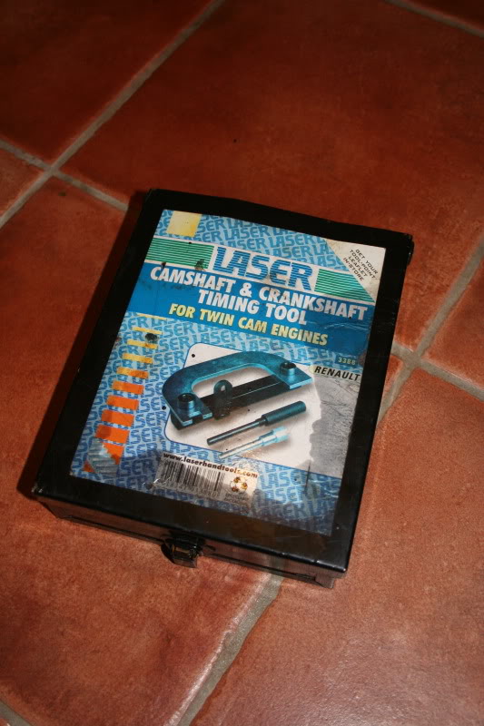

no you dont get the locking tools in the kit...
you need the cam locking tool, pulley locking tool and the crank locking pin to do it properly :)
Nafoff
Re: someph-ing different...........
i think i have sourced one to borrow,
otherwise jord can you advise were i could borrow one from, don't fancy renault prices on that
£140 for the whole lot of tools I think from renault
or quite a few people on here have them, they may rent them out to you.... Fred, burp maybe, cant remember who else

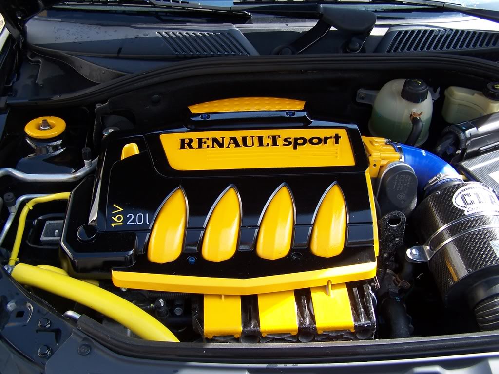

I hope your not copying me! Looks really good though. I love the yellow calipers on the black rims. Good job!
Thats a sexy bay man!! Love it!!
Nafoff
behave.....if i wanted it to stay clean constantly i would polish it.....
appreciate mint bays but no thanks, i want hassle free

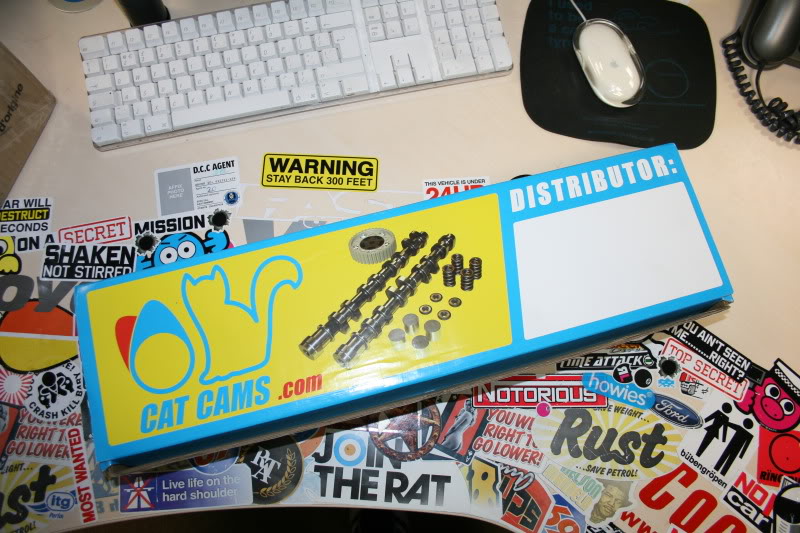

another thing to check off my list...
received my catcams today.....yay
so before thursday i need oil and coolant...job done then

Got the crank and cam locking tools if you need a lend but dont have he pulley one anymore. Sold it to Matteh

i have the cam locking tool and the crank locking pin, not got hold of a pulley locking tool,

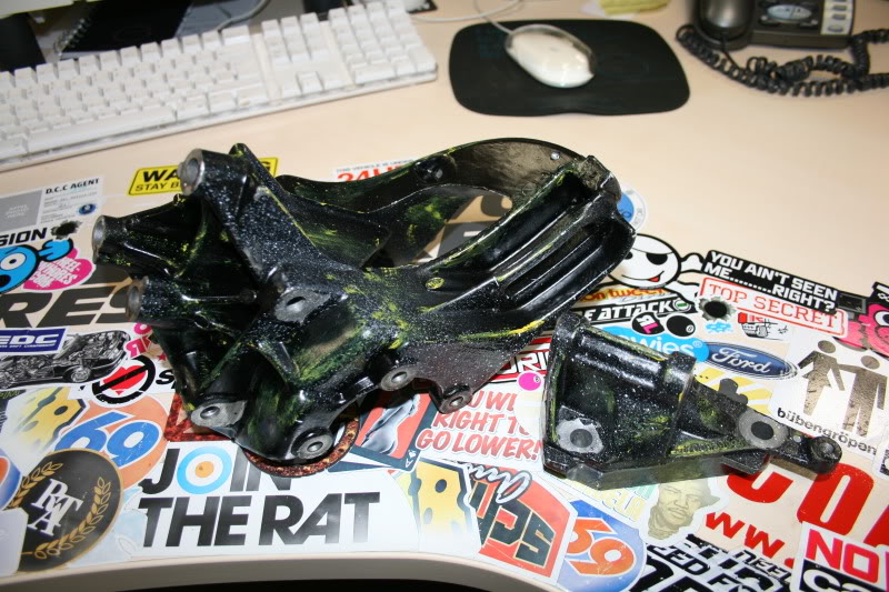

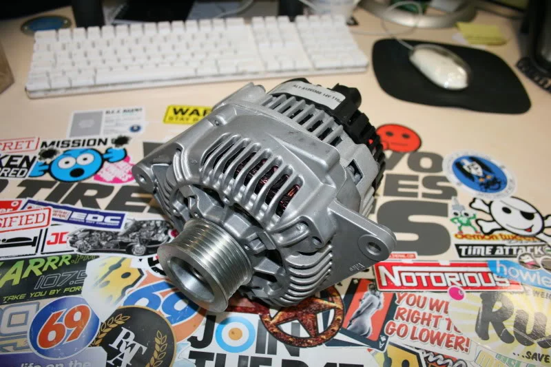

the set-up, well i got the alternator second hand off here for £80 unused
the mounts i was told were hidden in a laguna in a local scrappy, i got them and couldn't get the PAS pump off so took that too, all for £15

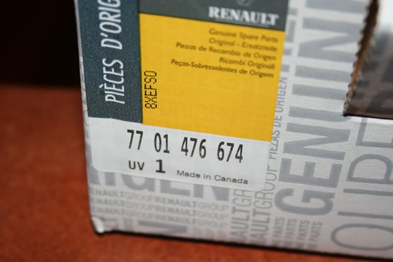

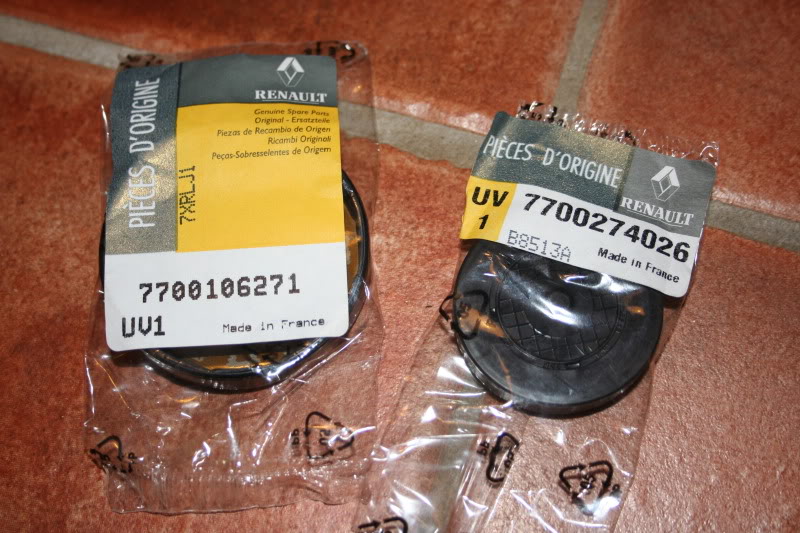

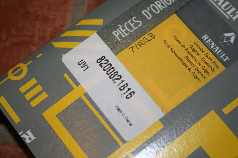

copied from freds pm to me, thought i would post it on here as people may find it helpful
Head Seal Kit - 7701471629 -£21.59+vat
comes with inlet and exhaust (timing belt end) cam seals, new vvt pulley bolt, new vvt pulley cap cover, new exhaust pulley nut
stud for the exhasut cam - 8200778847 -£2.41+vat

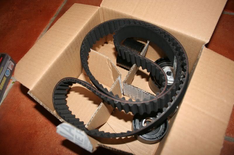

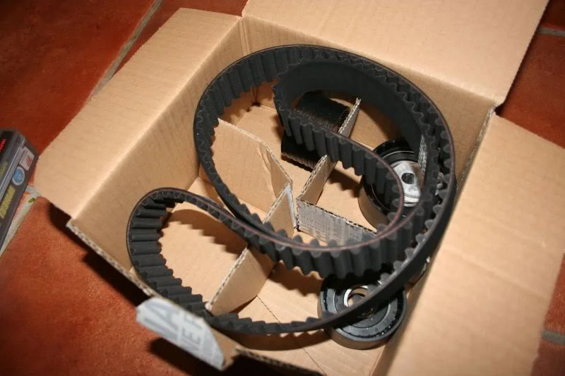

cam seals for the gearbox end are included in the gates power grip cambelt kit, seperatly (if you use another cambelt kit as i am) they are 7700106271 £6.87+vat and 7700274026 £3.69+vat (seen below)

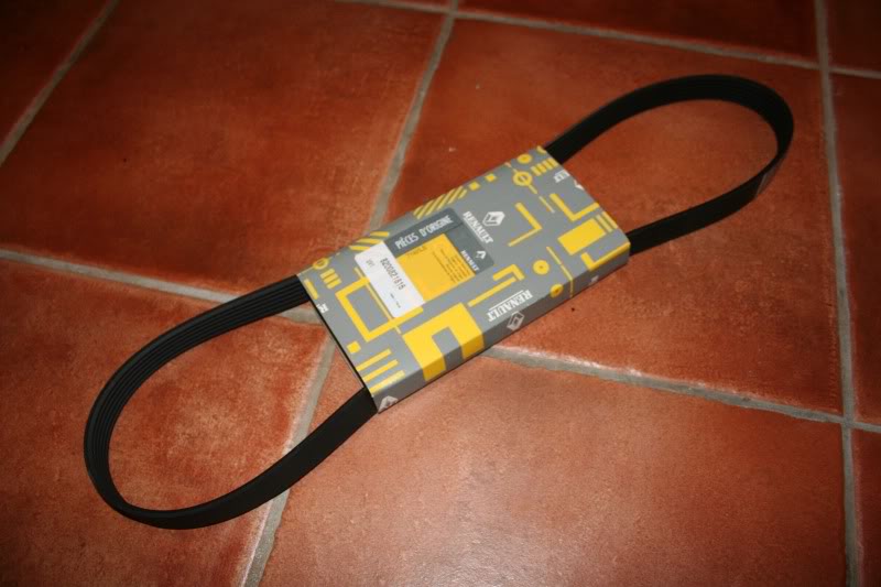

my kit for the work to be done, again some may find it handy...
cam locking kit and cam locking pin (thanks danlp6 / dunlop)
seals as mentioned above
alternator belt
cambelt kit (cup)

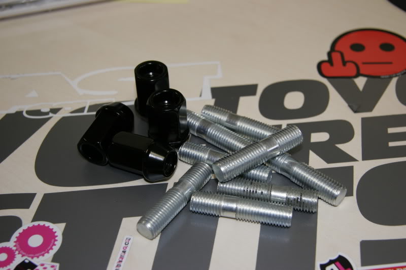

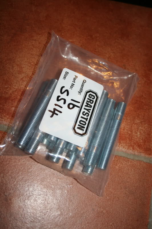

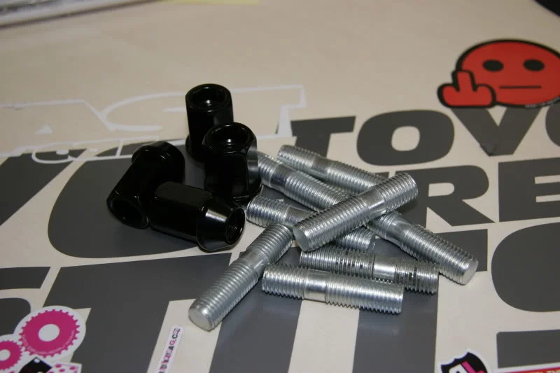

turns out i got the stud length wrong, the above studs were sent back and i am now the proud owner of 80mm studs...yay, these will also go on on thursday
i will be photographing all so will update thursday / friday i expect
  SchwepTek™
Hmmm i have just done a stud conversion.
Those black nuts look the dogs dude!
Where can i get? ;)
