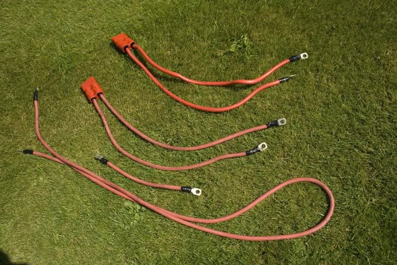

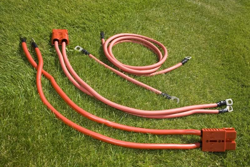

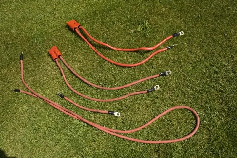

As said the other day i took all the battery cable bits to an auto electricians, i collected these yesterday, not only did i have to tolerate the fu*king weed smoking hippy idiots of glastonbury to do this but i also felt like i got bent over on the price....not to mention the PCSO kindly informing me of the fact i had no front plate on the passat... thanks for that...
anyways today i took the battery cable bits and gave them a good clean up as they were filthy...
before:
and after, from top to bottom:
- main battery cable from engine bay to battery (live)
- battery cable earth
- in car battery cable with anderson connector
- exterior battery cable with anderson connector (should i ever need to boost/charge the battery)
i said i got bent over but it is a good job, all the connections are soldered and crimped so i shouldn't have problems in the future...

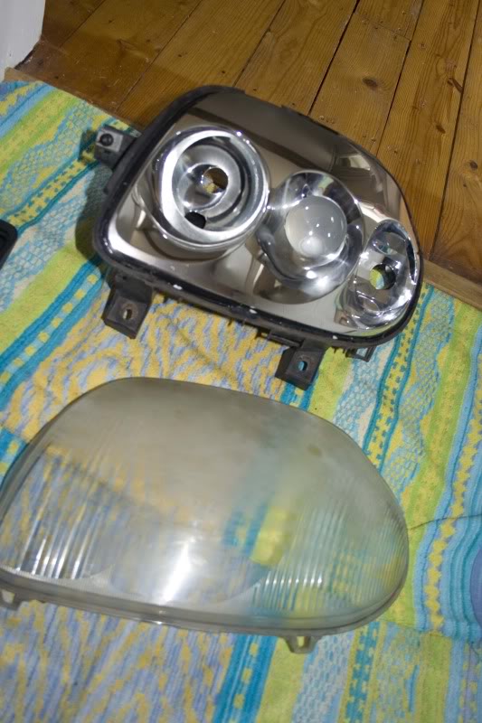

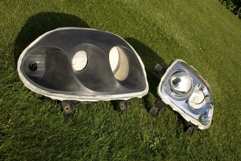

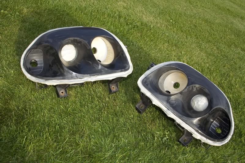

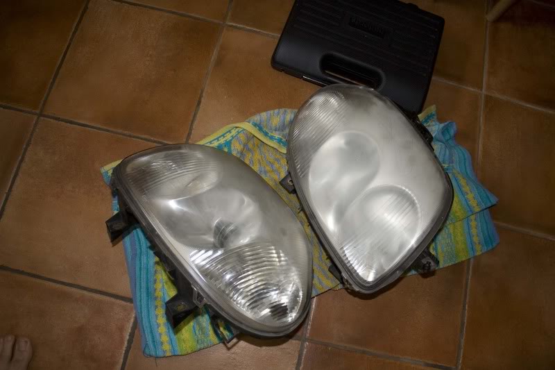

next up was my headlights then, i spotted that jay and tony had done this with the burpspeed car and with this one hopefully going a bit darker in colour i think these will look much better once done.

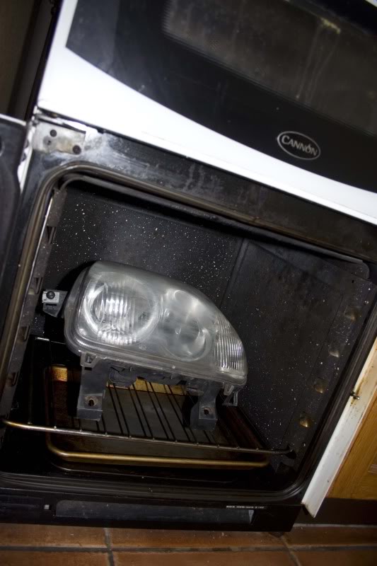

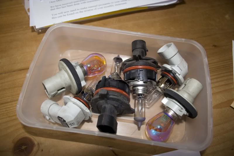

so first up i needed to split the headlights down, all bulbs were removed,

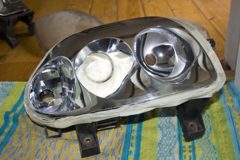

5 mins at gas mark 6,
and they split down pretty quickly,

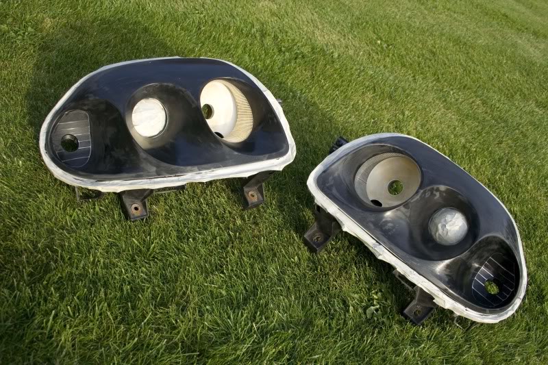

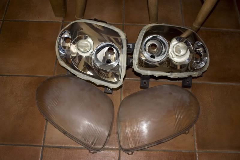

i then masked them all up (dunno why i done this, this early but oh well, it protects the glass lense in the central optic i spose)

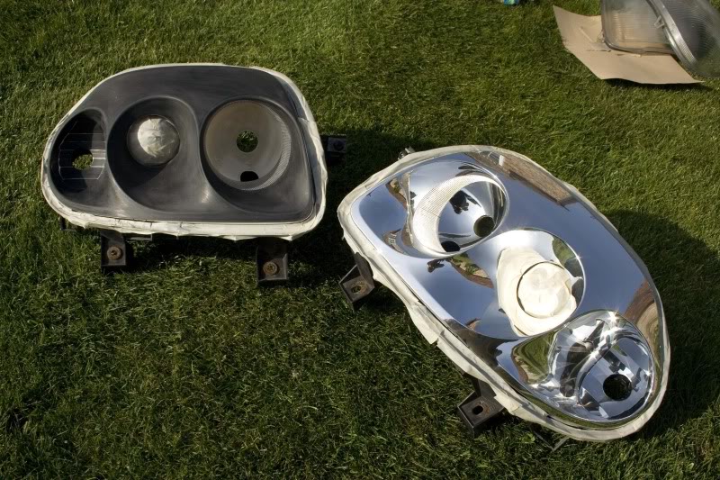

once both were split down i then spent all afternoon sanding the lenses down with some 240grit, nice and smooth and have lost all the reflective silver,
and both done,
they will be going satin black or maybe even the same colour as the car, we will see, i am happy with this afternoons work, at least it wasn't wasted...

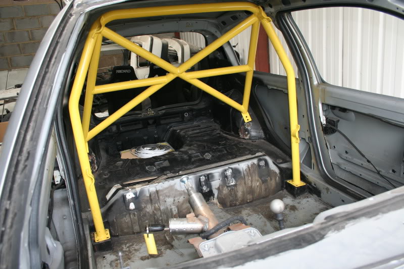

So over some sweet and sour chicken balls and hong kong style pork the painting was discussed. My mate confirmed that it should be fine to get the clio over to his bodyshop by the end of next week. That way things can crack on whilst i start my new job and look for a new house etc.
So there are a few little things to do,
1. Remove the last excess metal from the drivers footwell
2. Drill hole in firewall for dash loom
3. Possibly cut remainder from doors (opinions on this?)
4. I may also order some new koni rear shocks to fit as my others blew before i went to europe
Better get on it.

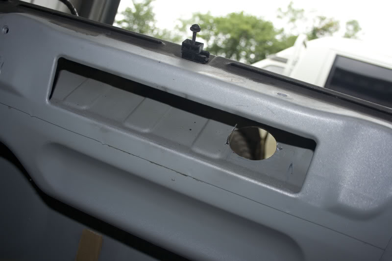

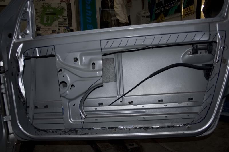

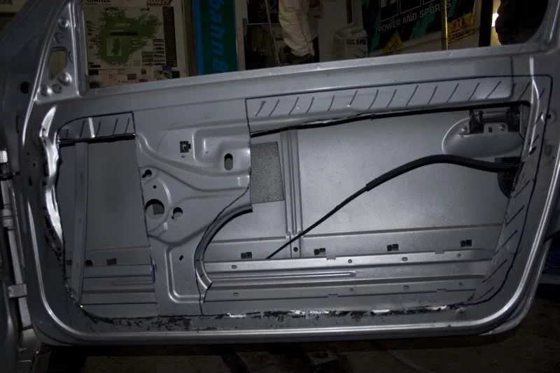

I'm cutting my doors out (and tailgate) like Chris has, just gonna leave a lip for the liners to bolt to and thats it. Who needs a door when you have a roll cage with door bars.
Nafoff
this is how it currently is:
what i am saying is, once you put the doorcard on, and the handles on, the handles would need something to bolt to, otherwise you will be pulling on a quite central part of the doorcard that isn't secured.
  BMW Z4
Yes I agree and will leave that central strip in place where the handle screws to that plastic bit.
  TrackCar & F30 330d
I'm not running any door cards, or the standard door pulls. So I have cut as much off as poss. I'm going to put special trim round the sharp edge and I'l just be using that just to pull the door shut. I'm finishing the doors off tomorrow so i'll update my thread to show anybody that cares.
Also with your doors you've kept the door brace! I removed mine because the roll cage is strong enough to protect me. There's still at least another 2-3 kg to removed from your doors if you wanted to.
Nafoff
Cheers for replying chris, i think i will be keeping the inner skin as mentioned, mainly to keep the carbon door cqrds strong when i fit them.
How did you remove the bracing? Just cut it out?
  TrackCar & F30 330d
There are 6 spot welds, 3 at each end of the bracing. just drill them out, and then cut the bar inthe middle and wiggle the 2 bits out. really easy, but you need to take the doors off to get to the spot welds next to the hindges. But thats really easy too! :)
Nafoff
The doors will be coming off when the car goes to the bodyshop so i will chat to my mate about them then. Cheers for letting me know, i will have a look when i go down to do my final bits this week.

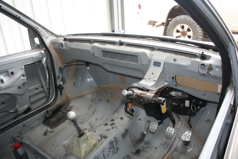

I went to the clio with the intention of a few things, i needed to prep the shell a little more, just 1 or 2 things left to do before paint,
i also wanted to organise all my stuff so it was easy to sort when we come to move the car.
So first things first, i started to organise some of my stuff, separating what i needed to bring home etc and what needed to stay with the car, whilst doing this i found this wheel that was donated to me, its a bit of a mess but when the car is done and there is a rainy day i will sort it out as a spare...
with the majority or bits organised i then started to look into the next thing.

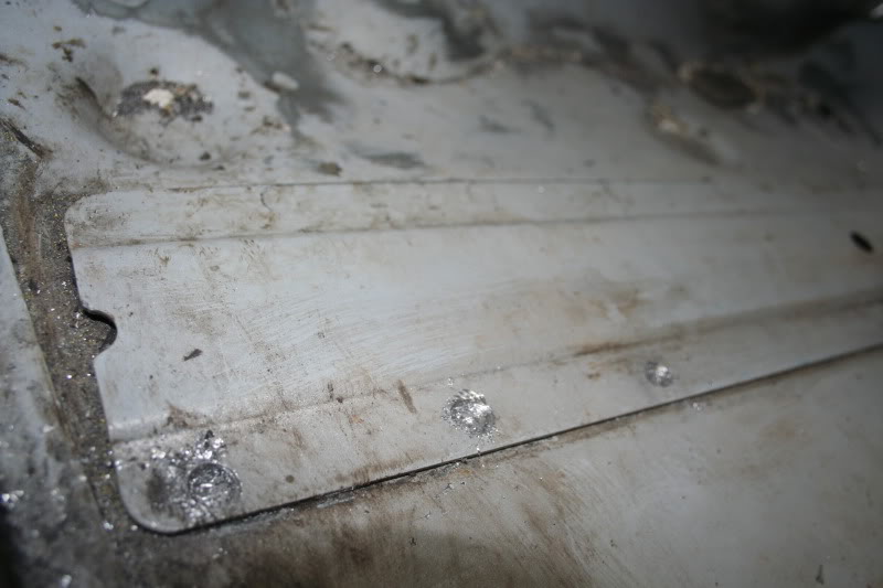

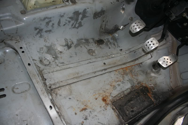

I wanted to remove the central bit in the front footwell, for some reason i left this previously, anyways today i wanted it out, Knowing i would be making a fair bit of mess and that it would have to come out anyways i set about stripping down the front half of the interior again..
POW, ready to attack the spot welds then, well kinda, i didn't get very far and it was evident that i wasn't going to get much further as the spot weld drill bit was shagged... game over for that then,
so that will now have to be done at the bodyshop, i want to remove the door braces also, so they will come out with the new spot weld drill bits too....

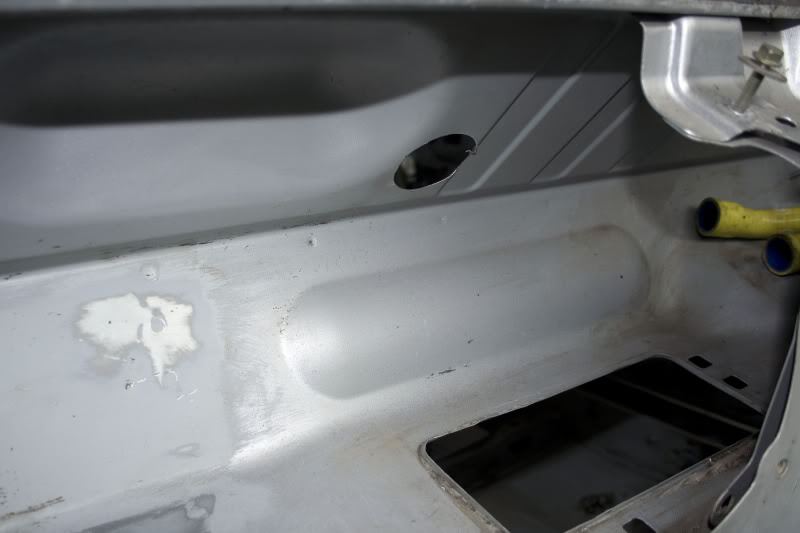

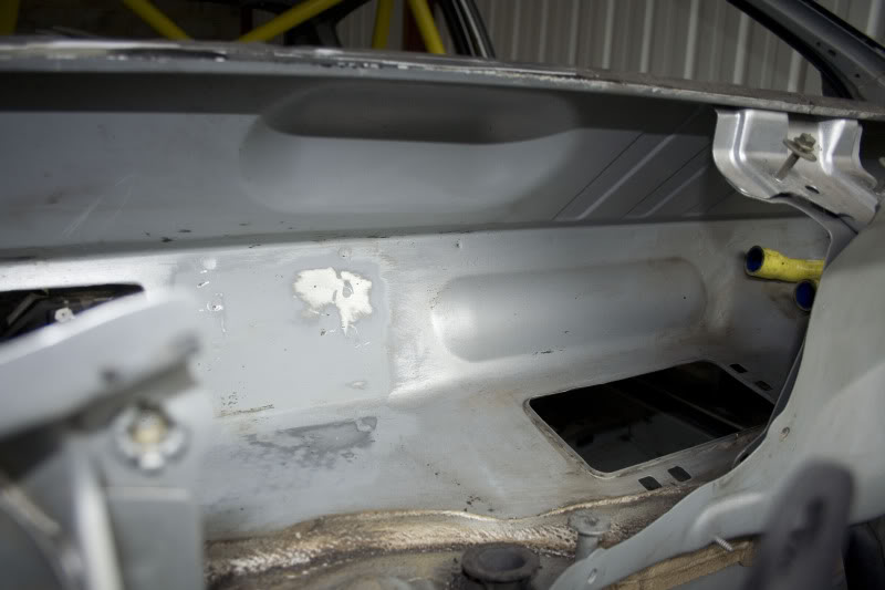

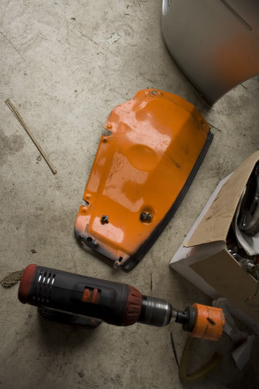

i then looked into the firewall area where i have decided my loom will be passing through, I worked out a location for the hole and set about it,
tools and access made for said tools...
before:
after:
when it comes to it i will gromit it up and pass all the wires through here nicely... happy days.
so that was pretty much all i could do, gutted again, feels like its not going very well...lol
