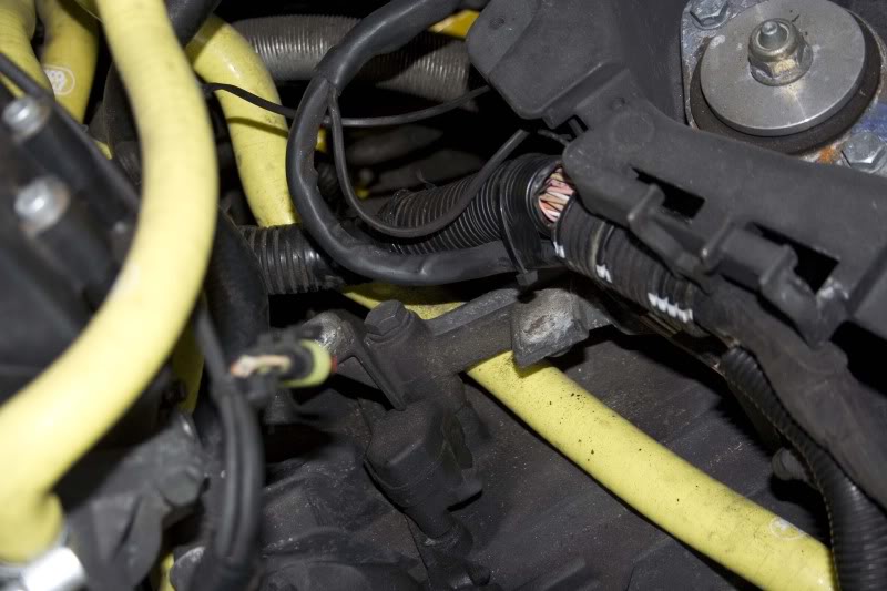

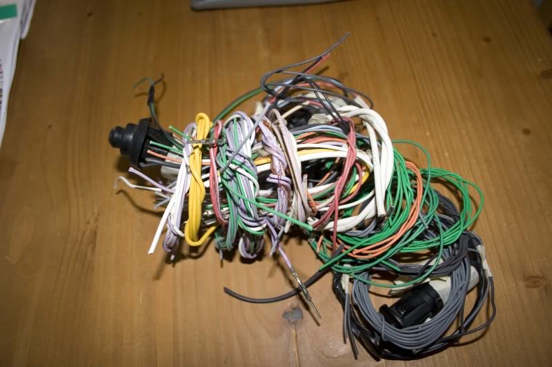

i then started to look at how i may route the loom. I finished trimming the loom down the other day after loosing the door sensor etc....
see the last few chunks of wire...

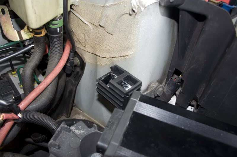

i really don't want to have the massive fuse box etc inside the car once done so i looked at how it could sit in the scuttle pannel. Initially i will just slot it in here for the 1 journey it will make which will be to matt at TDF, then this will probably all come out again and be redone, for that trip i will not put in the washer bottle so there will be enough room for all the gubbins....see below
this will allow me to loose a fair few big holes in the bulkhead/dash area of the car. i have made up the cardboard templates for these so we can cut the metal to fit then just weld it in.

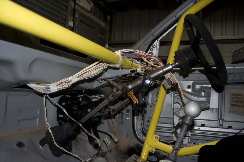

with these now enclosed i looked at how i would route the loom. the passenger side loom is very small so this will come trough a small hole (i will probably just chop the wires and re-attach them the other side when it comes to it), but it will be nice and neat.

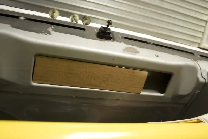

for the rest of the loom, i looked at how i could get it discretely to the other side of the car, i come up with the idea of running it across the bulkhead in the scuttle panel and then emerging it through the upper middle air vent, i will need to make a hole in the bulkhead somewhere but that shouldn't be too much of an issue....

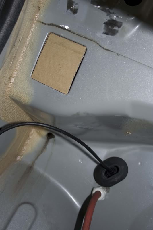

so after making up the template for the middle air vent i marked it and cut it, this should give me enough room to pass all the plugs and loom through.
so from this
to this

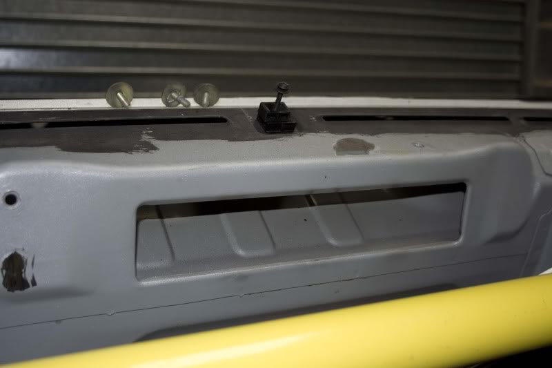

i will cut a hole just behind the gap i have left here so it will pass straight into the bulkhead. that may be tomorrows first job.
to make sure this would be viable though and that all the wiring would fit where it would need to go i routed it through the lower blower hole (a longer way around)... below you can see that it still reaches everywhere, happy days, once it comes out of the upper hole i can nicely hide it behind the dashbar...

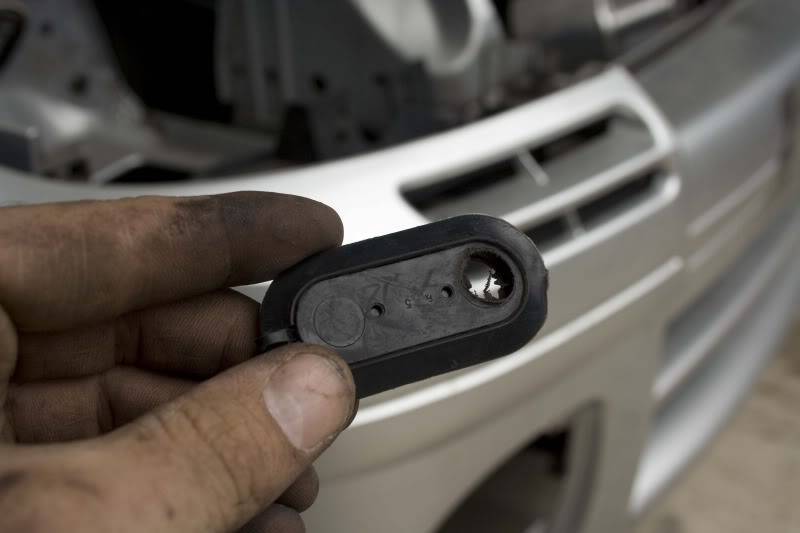

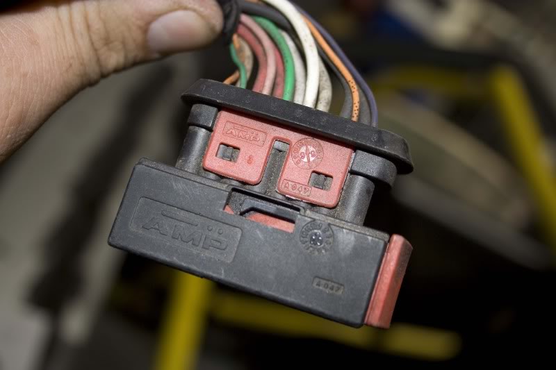

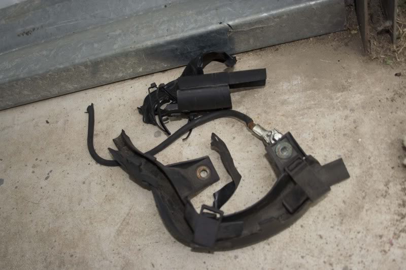

i then removed all the wiring again so i don't damage it, in doing this however i came across this plug in the scuttle, the wiper motor plug also comes off of its loom, for the life of my i can't work out where it goes, any ideas?

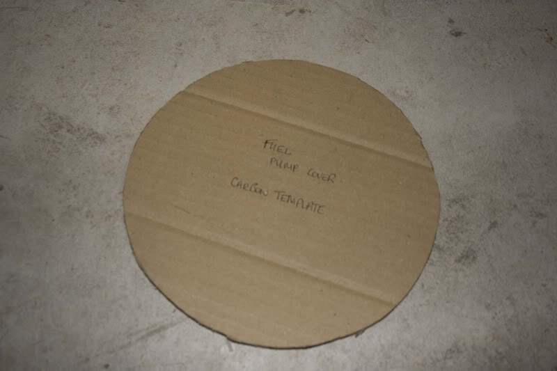

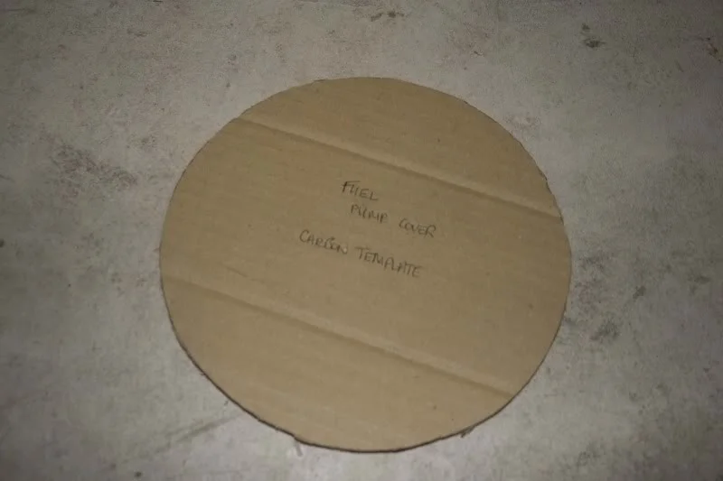

so my last job was to make a template for the fuel pump cover that i will make from carbon....(the big circle really tested me)

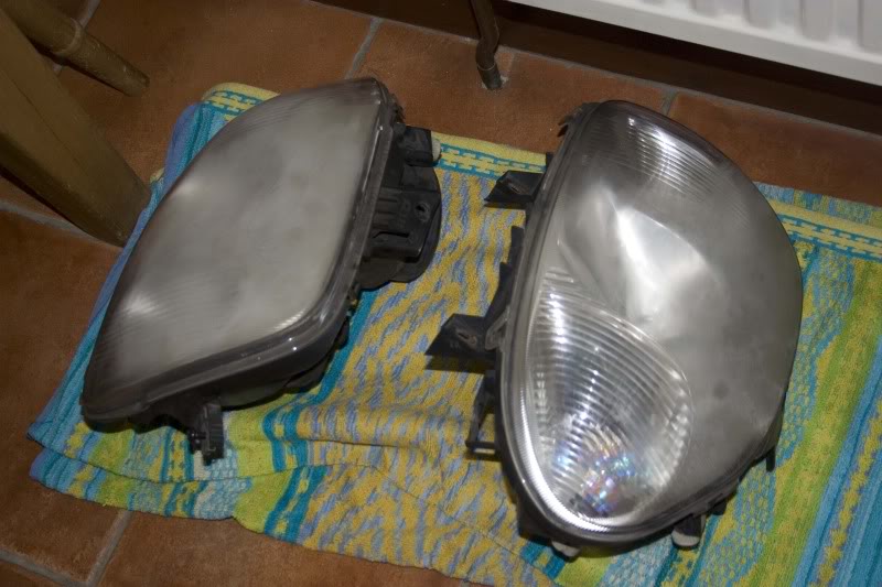

before i left i also picked up my headlights, i am taking these home to bake, i plan to split the lights down and then paint the inner lenses black, i thought about doing this before and when i saw burpseeds ones i was sure to sort it, so i will do that shortly....

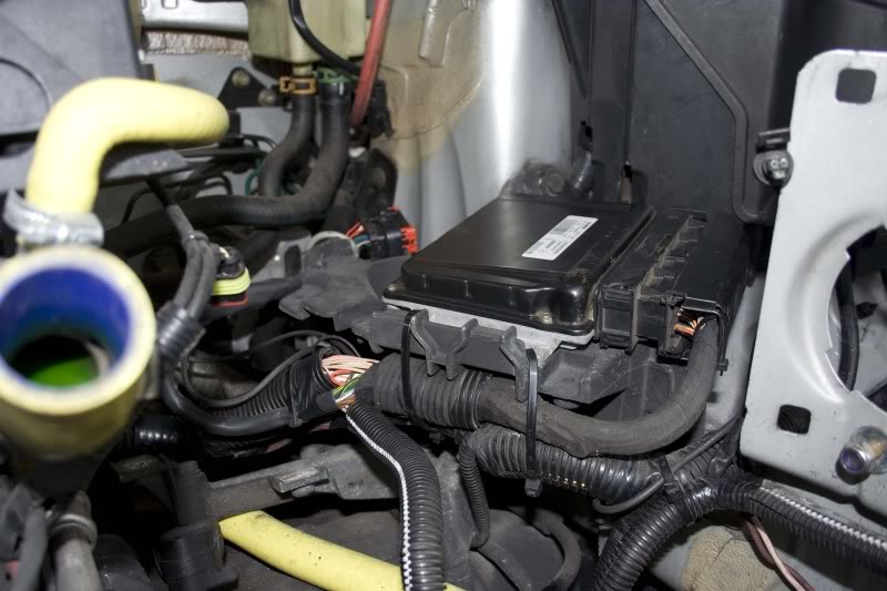

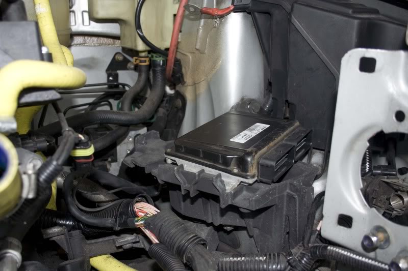

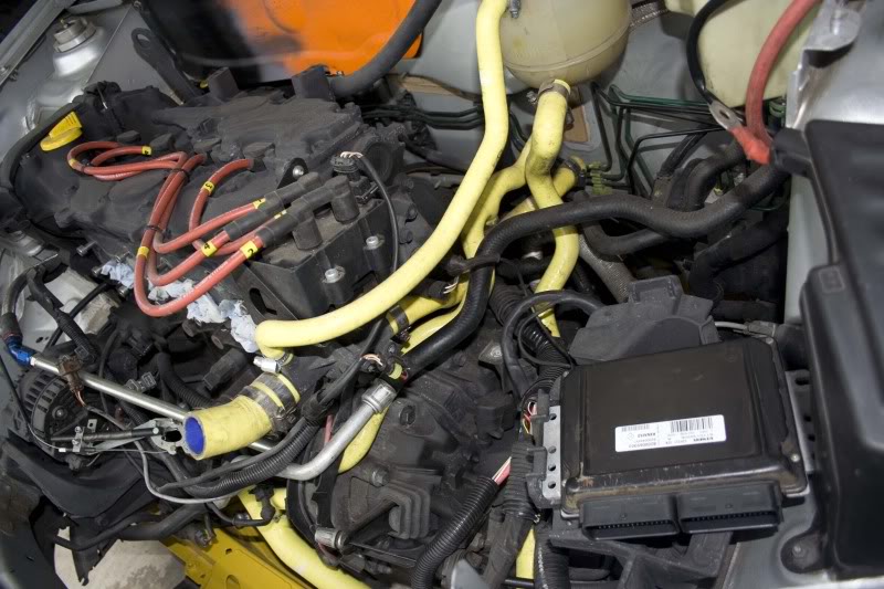

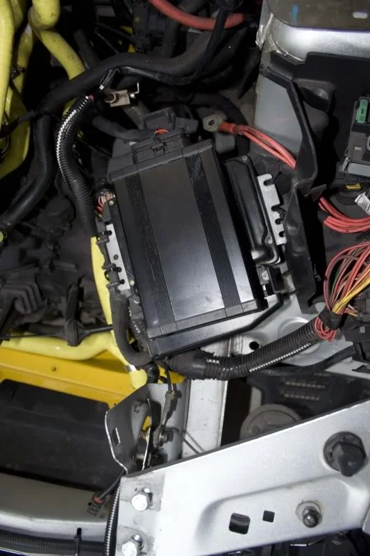

i started off by looking at the ecu, this needs to be re-mounted and the wires need tweaking a little to line up, as posted previous i had an idea of what to do from bomber but as soon as i started looking at it it became aparent that i would not be able to use his method. first of i decided i would loose the plastic (wire tracking???) that holds the loom above the gearbox, doing this would give me a little bit more length to play with...
plastic removed
along with a few other bits
once this was done i could look at how the ecu would sit on the battery seat / engine mount, i found it slotted in quite well and once i had re-routed the loom it would reach so i set about attaching this here.
zips ties would pass through the holes in the ecu bracket, through the battery tray and also hold the wires/ loom securely underneath.... neat

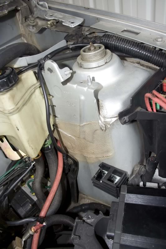

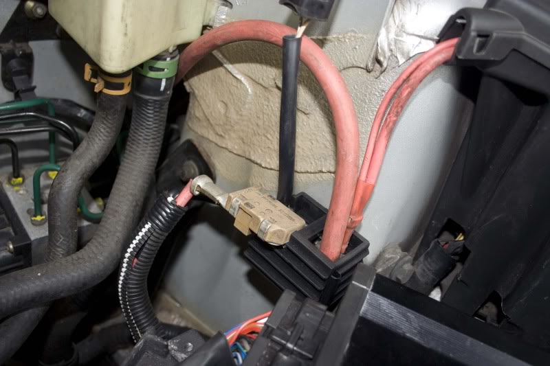

now this was secured all nice i started to look into the battery cabling, routing and distribution. i already had the distribution block but i needed to work out a location for it where not only would the engine live reach but also the cables from the relays in the engine bay, after alot of faffing, some annoyed words and various positionings i then deided on a location, again i messed with cable/wire routing a bit and again it gave me the extra few cm's i needed, the distro block was trimmed to allow the fused engine live to fit, then the car was jacked up, the front wheel removed and i drilled and bolted the distro block to the front passenger suspension turret..
and with the wires going in.
job done, so that was basically the front end sorted with regards to the battery bits but i needed to sort the cabling, i had already cut it all to size but i needed to attach the ring's at the ends and the anderson connectors just in case, i didn't have crimps big enough so this has all been dropped off at auto electricians... will collect it and trial fit tomorrow.
