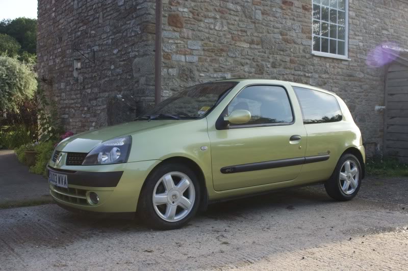

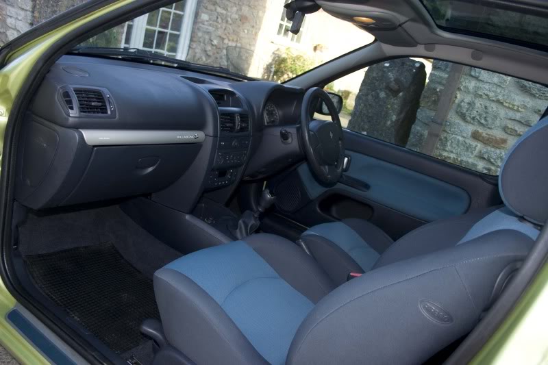

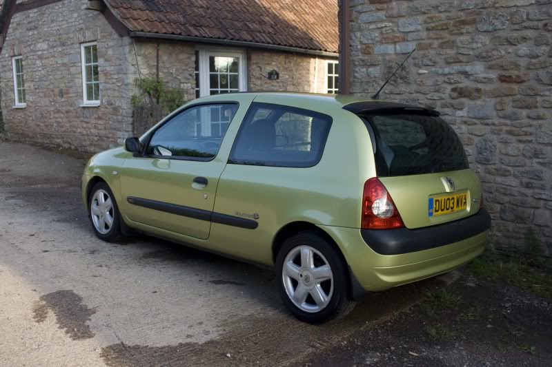

1.5 DCi 80 dynamique Billabong
totally stock.. nothing singing, nothing dancing...
its just had a service so it will be running sweet, i found it also had a cracked spring and the front pads and discs needed doing, bit of a pain but it got done, it will pay for itself pretty quick.
anyway pics....

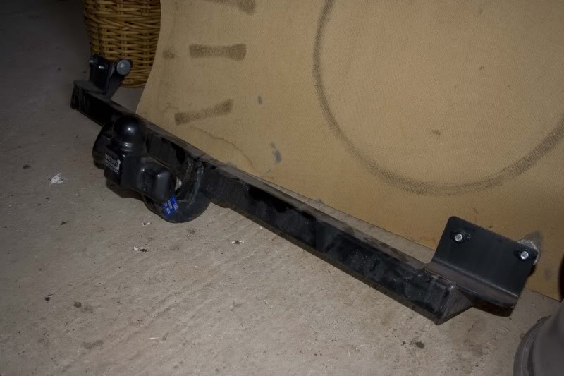

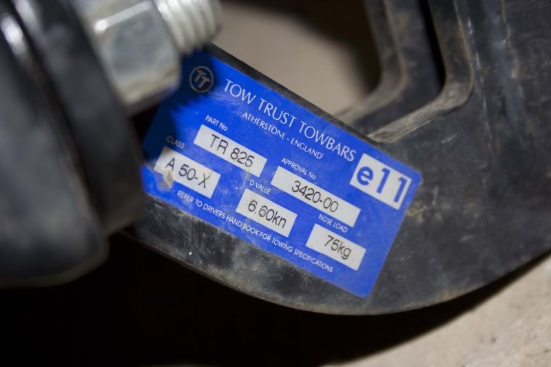

and it even come with a tow bar, i sorted the wiring and removed this... (although i did wonder about towing the ITB 172 with it)
so i am back in a clio, i haven't driven it yet as have been away on holiday, but my big commute starts again tomorrow, hopefully it should be a bit cheaper in this rather than the passat, however i do feel it will be a little less conformable or fun...

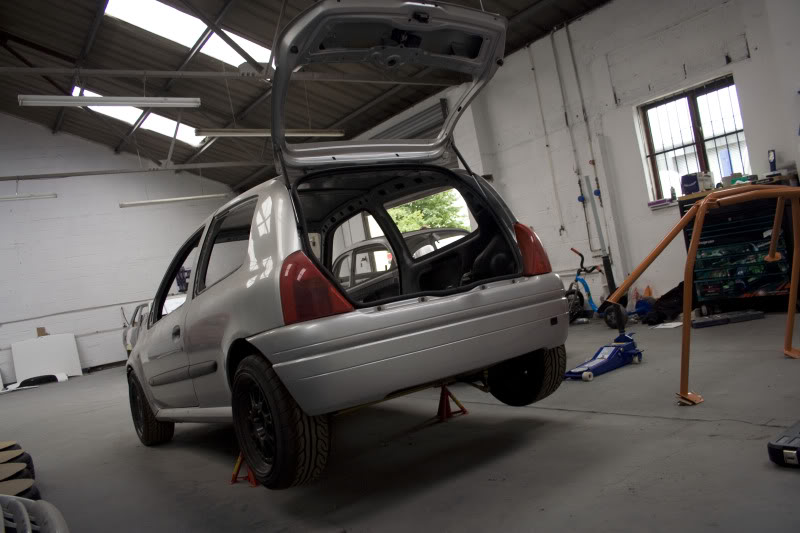

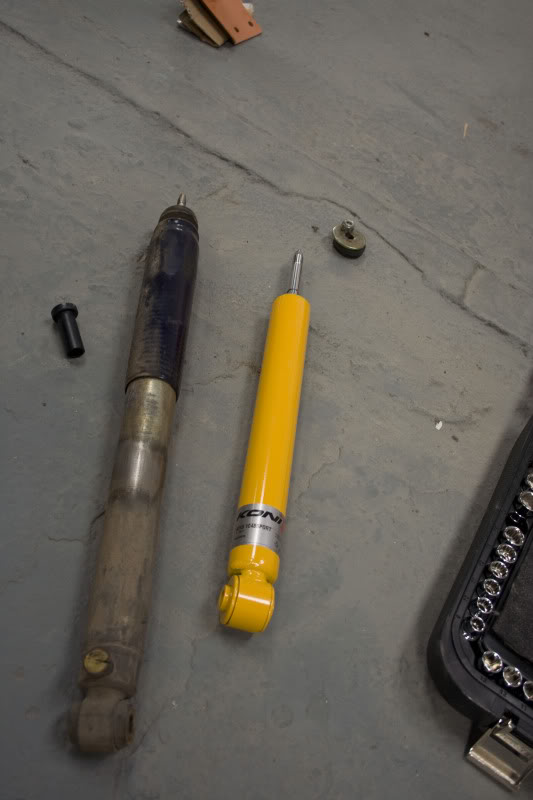

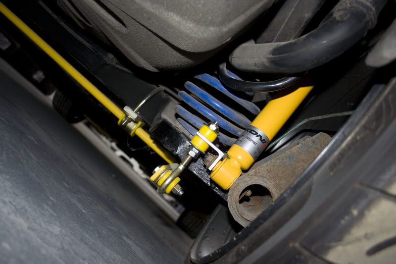

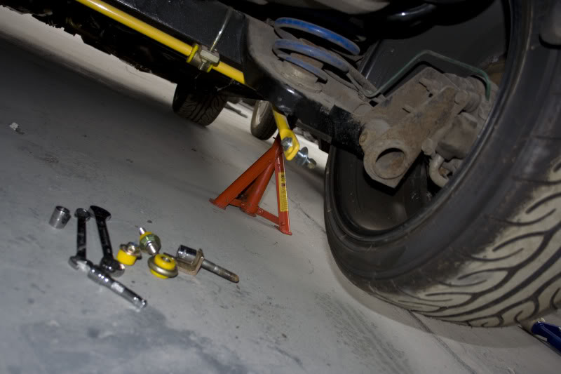

so i got down there today with a few jobs in mind, first up was to change the rear shocks, about a year ago i was off to a roadtrip around europe and only a week prior to that i found that one of my rear FK shocks was leaking, luckily Danlp6 stepped in and leant me his, i bought a new set of rear shocks about a month ago so it was time to fit them and give the borrowed shocks to the owner of his old shell / project....
car up...

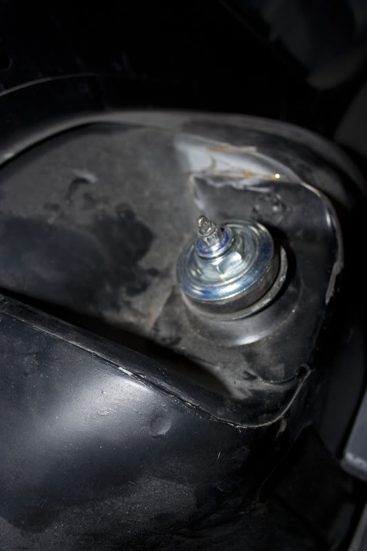

old shock removed, and then washers etc transfered over etc etc...
new shocks bolted in (took a little while to sort, few little niggles but got there in the end)....

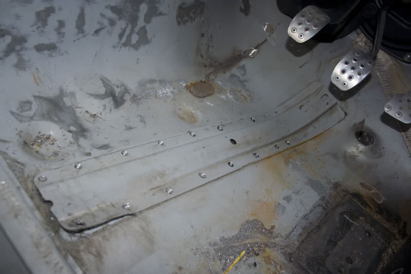

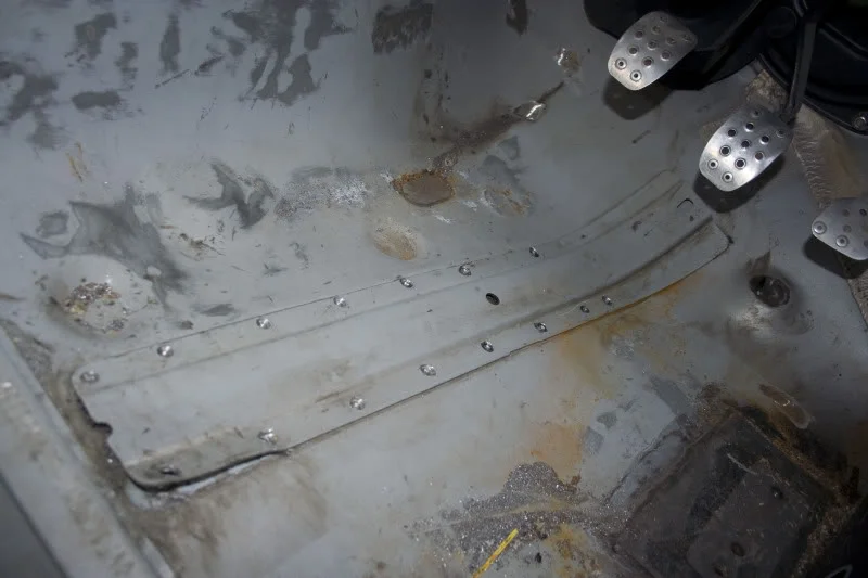

well now it was lunchtime, after that i then started to removed the last piece of extra material in the cabin, (the piece in the drivers footwell)...
I was having a mare, using spot weld drill bits (which are F*cking expensive, i managed to blunt one and am now onto my second... pretty cheesed off tbh,
and i still didn't seem to be getting anywhere really, i ended up having to take a step back as i found myself getting frustrated, perhaps next time it will go a bit smoother..(this is how i left it...)

I removed that bit from my old shell, was a bit tricky but managed ok, i'll need to do it again on the new one but at least ill know better how to attack it!
You've probably noticed the spot welds are quite big on that bit, best get your self one of these
http://www.ebay.co.uk/itm/Spot-Weld..._Body_Shop_Supplies_Paint&hash=item2a125fd039
I bought the above for doing the new shell but managed ok using the 8mm one I already had, just had to drill 3 holes in a triangle pattern to get all the weld out. I've had the 8mm one a while (same type) and drilled loads of spot welds out with it, important not to get gready when using it, dont go too fast and dont lean too hard, just let it cut at it's on pace. The ones up by the pedals are a bit awkward mind you but i'm sure you'll get it.

Thank you very much for the advice, i may look at purchasing one. I do have a supply were i am doing it as the car is in a bodyshop run by my mate, however i am extremely concious of wearing them out at £10 a pop, i must admit its my least favourite job thus far.
  Audi A6 & 172 Cup
What type of cutter have you been using?
I tried the hole saw type with the pin in the centre but they're hopeless imho, they can work but I found you had to centre punch the spot weld to give it something to locate on otherwise it would just skip about all over the place and then break the teeth off.

that is the type i was using yes, but as you say they do slip a fair bit....
near the end of the day a lad turned up who restores/rebuilds classic cars so i asked his advise, he said use a small normal drill bit first and drill down through the centre, then this gives you the purchase for the spot weld drill bit...
Buy a spot weld drill off Snap-on mate. They ain't cheap but i've got one thats been used at least 3 cars now! Plenty of life left in it as well.
the ones i am using are not cheap mate, and my sprayer/panel beater friend is supplied by snap-on so he could use them if he wanted...
thanks for the advice though.... i will nail it...lol
  Audi A6 & 172 Cup
If you've been using the hole saw type, that would explain the frustration, if you get the type shown in the ebay link, first time you use it you'll wonder why you struggled with the other kind, honestly the difference is night and day. They have a small centre drill on them and you simply put it down where you want to drill and it does just that, wont slip or jump about, makes your life so much easier and they're the same price if not a bit cheaper than the hole saw type.
