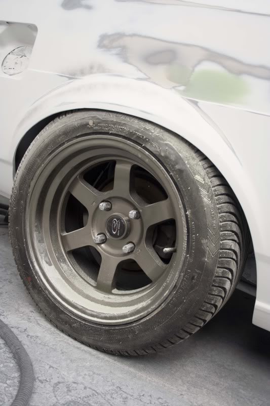

Give me your tyres please
the only road they have seen is when i got towed from one workshop to the other...lol

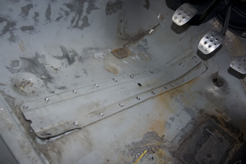

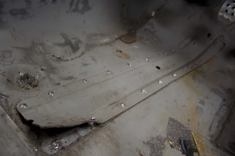

so another week has passed, i visited to work on the car again and tbh i am getting a little deflated, its mainly down to one thing but its just getting to me a fair bit on how the car is progressing extremely slowly, then when i think how much £££ is tied up in it the sensible part of me just thinks about cutting my losses whilst i still can....anyways,
the little thing that is getting me down a bit...f*cking spot welds,
i don't know if i am a complete r****d, am useless, i am having a complete nightmare with them. as i said i visited again yesterday (so now 2 days on it) and i still can't see the light at the end of the tunnel....
last weeks work...
this weeks,
i seem to have a fair few more drilled out but for the time it took it was a nightmare, the spot weld drill bits had previously made a mess so i had to work out someway of centralising them again, i managed to do this with most and drill through but trying to move the actual metal piece is a complete ballache.... i ended up just walking away again (with alot of the day left) otherwise i would have just got fed up / annoyed.... it'll get there in the end.... where-ever there will be...

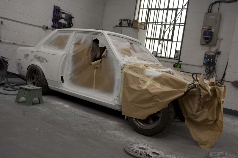

because this is a bit of a pap update however i do have some pictures of something else that is currently awaiting paint in the same workshop.
datsun anyone?

That panel still giving you grief, by the looks of it you need to use a bigger spot cutter. The welds on that bit are at least 10mm diameter. The plate is quite thick (for a clio that is) so even if you miss small bits of spot weld, the top plate will not tear off as with other brackets else where on the car.
You should be able to see the outline of the weld, only thing i can suggest is to do what I did and use the spot drill to make 3 holes in a triangle patern, you may even need to put a 4th one in order to ensure you cut through all the weld. I didnt take any pictures while I was doing mine or i would post them up.
Only other way is to use a grinder and thin down the area round the spot weld and then chase it off with a chisel but this is definately the messy way and will take quite a while as you'll need to be careful you dont go right through and into the floor skin.
