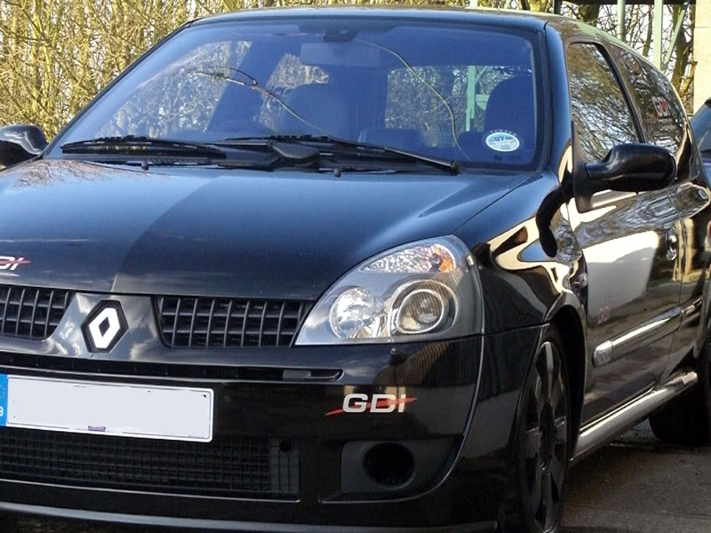

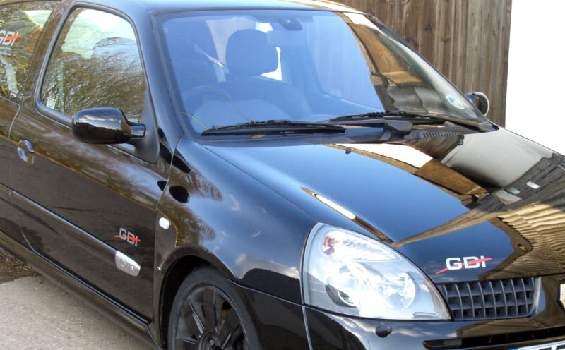

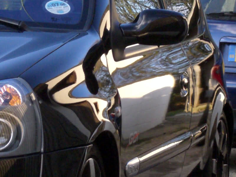

Had a little trip to GDI today to detail the GDI clio, rather badly swirled to say the least!!

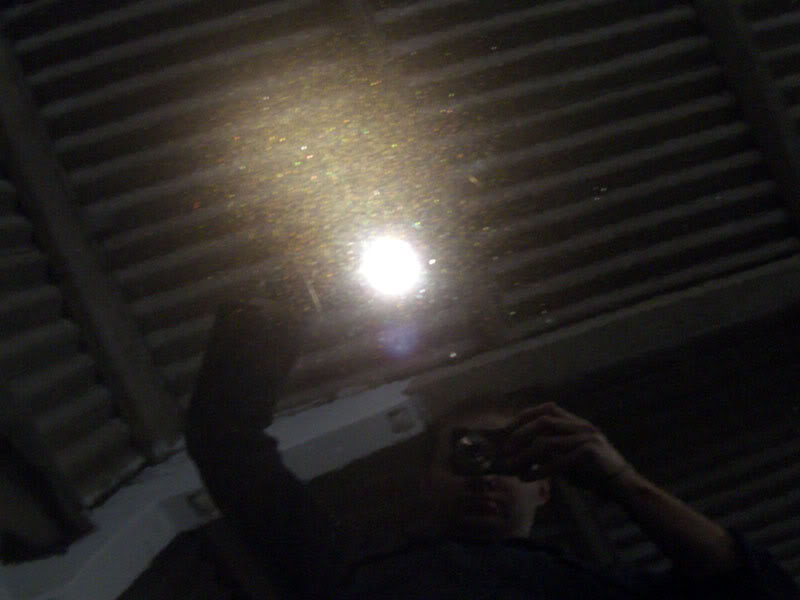

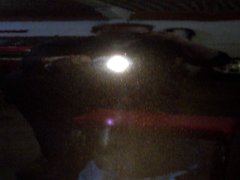

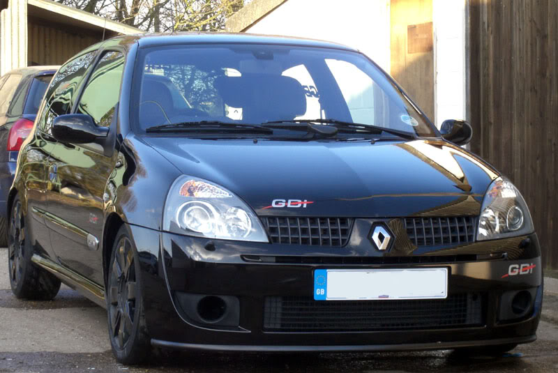

Paint after claying

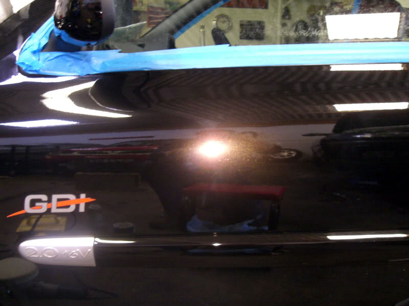

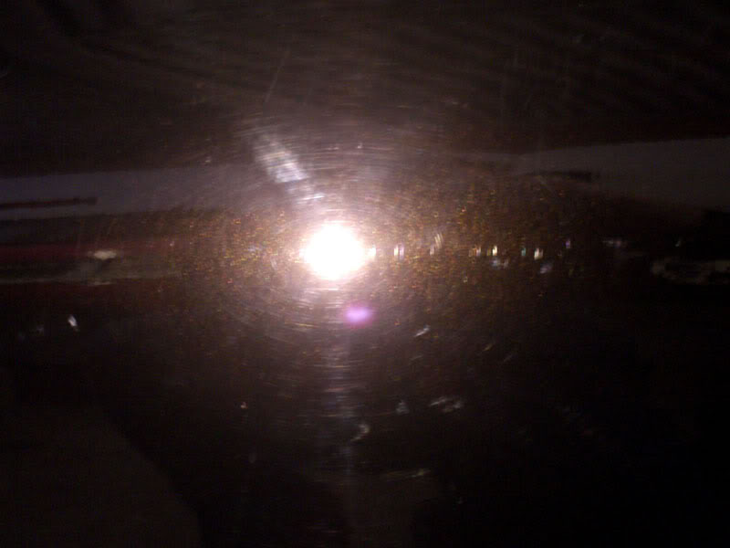

The thickness was a good 150 microns all over which gave me plenty to play with. I compounded with SSR2.5 @2000rpm which cleared most swirls but left a few random scratches - and today thats where they stayed :thumb:
Next up I removed some glorious buffer trails with #80 on the pc to leave a significantly better finish
Process was wash QEW - the look on Andy's face when I said I could wash it inside the workshop was priceless lol. ;)
Sonus gray clay and AG tar remover to rid the paint of the brake dust.

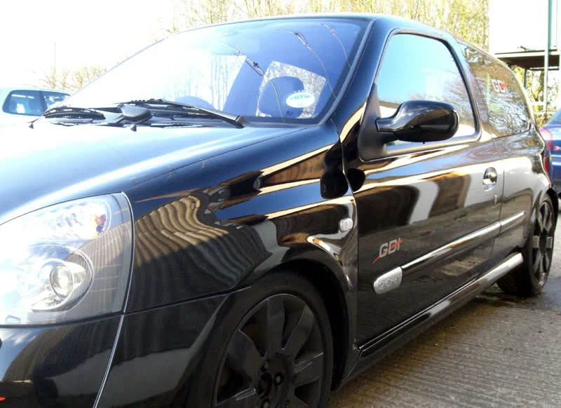

SSR2.5 and #80 on rotary and PC

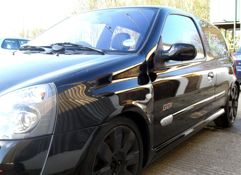

Finished with megs #21.

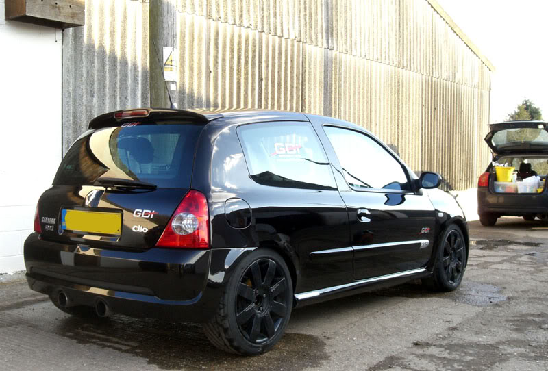

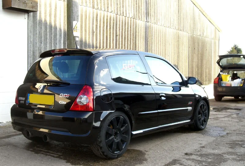

the car was in a state due to the PF pad dust all over the bodywork.... (the wheels are beyond fixing now, they need a full refurb)
after 7 hrs of very hard work the paint was dust free and looking better than it had ever looked...
you could run your finger down the paint and not feel a single bit of dirt....
I also have never seen anyone spend the time to mask off the plastics and rubber to stop polish getting into them with the buffer etc
I would have no hesitation recomending anyhow (especially those with brake dust problems) in having this treatment done....
I am hopeing to have my other car done soon as well......
WELL WORTH THE MONEY AND TIME.......

Thanks for your kind comments guys especially Andy, I'm glad you were pleased.
I will be the first to admit the final finish isn't 100% in all areas but given the state of the paintwork before I think its come out rather well :)
