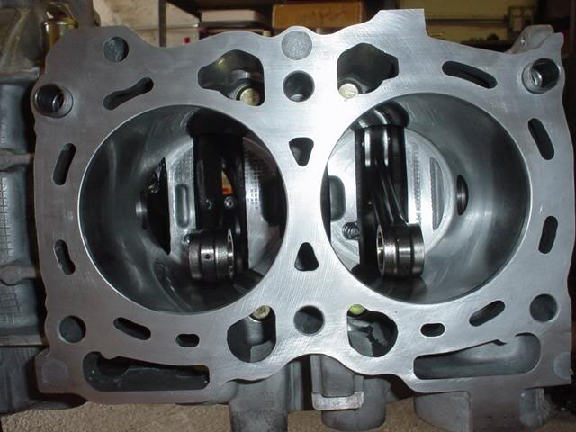

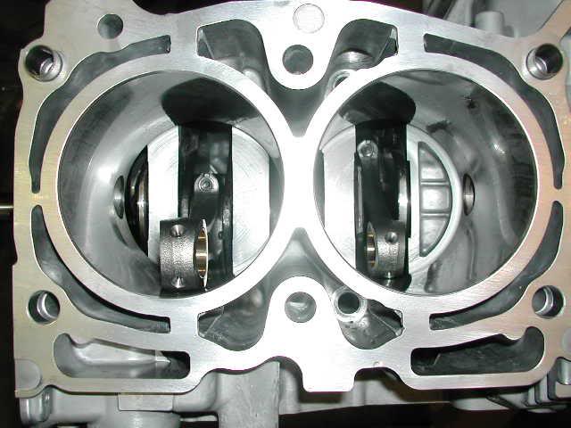

Subarus are a mine feild but ill try and explain block differences..
The Subaru block comes in 3 flavours....Closed Deck, Open deck and Semi closed deck. Some pre 96 cars(mainly series 1 cars and all RA's) came with the CDB, it was the cost of individually casting each block the reason Subaru decided to end the production of the CDB and use ODB's. The ODB is used in all other classics including V3-V6 WRX and STI's including Type R's and RA's. ODB's are also used in 2001-on WRX's but 2001-on STI's got a stronger Semi closed deck block....Don't even ask about the 2.5 block found in 2006-on cars...lol
