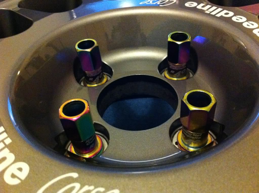

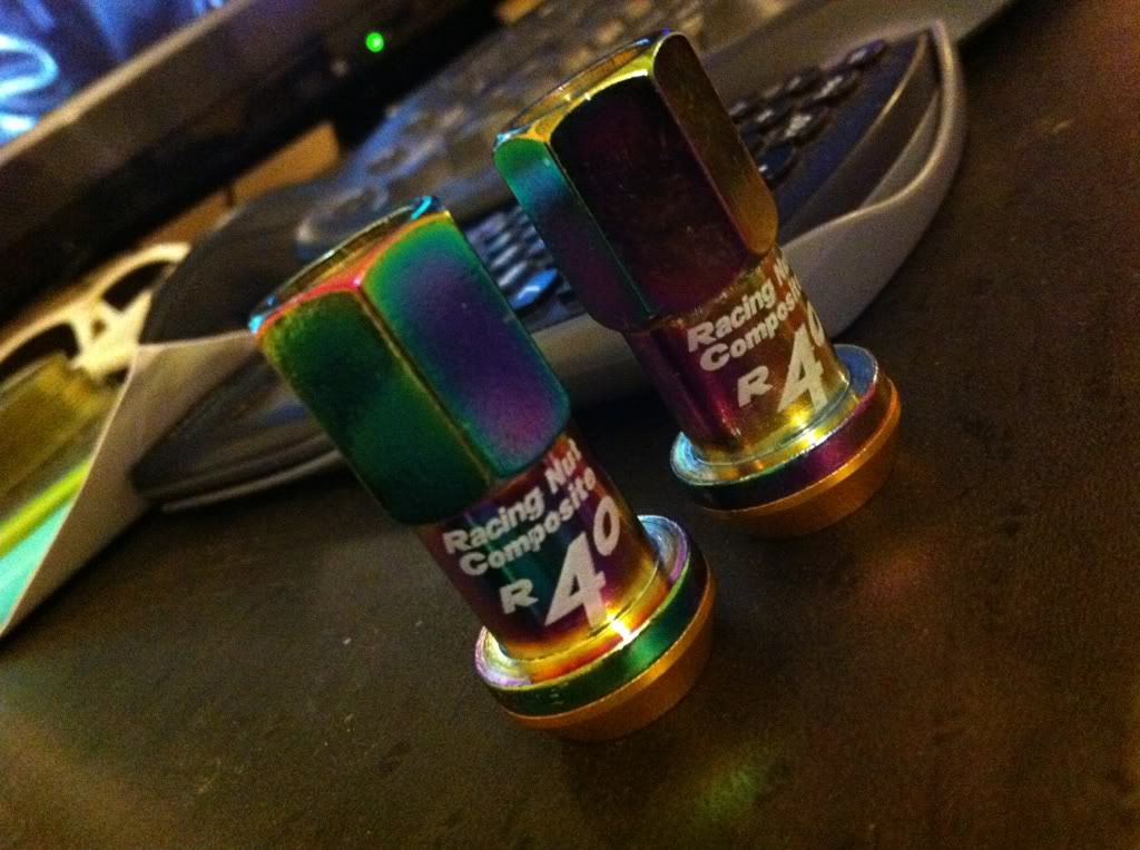

I went for the rally design studs 60mm long (to accommodate a 20mm spacer) and I use muteki 7sided lug nuts on them. There anodised black so dont go nasty, 7 sided so doesnt need a different locking nut and the key to unlock them all stops the nuts from getting marked.
Heres the link to the wheel nuts, I went open ended as I thought my studs would be massive! but there not luckily.
http://www.ebay.co.uk/itm/MUTEKI-M1...Wheels_tyres_Trim_Nuts_ET&hash=item3cbef86d80
You can also get them in neo chrome if you fancy something a bit flash!
Drop me a pm if you need any help ordering the parts. It really really does make life easy changing wheels etc though!.

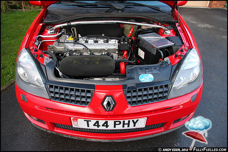

This weekend gone I decided to open up the bonnet and carry out a bit of routine maintenance and to give the engine a wipe down with a cloth / degreaser. It was a lovely day, blue sky and the good lady had gone off to work (hence a hassle-free afternoon! LOL!) So, yes, I opened up the bonnet and went about my business in terms of getting the degreaser, the cloths, fresh oil (to top-up), screen wash - the usual stuff.
I was faffing around getting the bits sorted, making a cuppa and answering the call of nature when I heard the heavens open and - sure enough - it was absolutely p**sing down. I got back outside and found the engine bay soaked and water pooled across the top of the block (right where the HT leads and spark wells are located). I quickly mopped up and shut the bonnet but obviously was fearing the worst. :(
After the rain had passed I went back out and opened her up again and found the engine bay pretty much soaked. A quick look at the trumpets suggested that - thankfully/hopefully - water had not got through the filter and into the trumpets. On removing the HT leads... *sigh* ...water was found in the wells. I immediately got the water out using a spray from an old cleaning product bottle and dried up the well as best I could (I didn't fancy removing the spark plugs at this point as I was pretty miffed and hoping that water might have somehow not leaked further down).
There followed some hefty drying and eventually I decided to try and turn her over.
The engine turned over and she kicked into life without a problem. She was idling fine (no different from normal as far as I could tell) and there were no obvious signs of problems. But after a short while she started to become a little bit lumpy. Not so far as to the point of cutting out, but definitely lumpy. I turned off and left the engine to dry further whilst it was warm. Upon starting it again it started without problem and - again - I noticed no obvious problems. After several minutes of running it was still fine, no judder, no smoke, no misfire, no signs of excess water or moisture. At this point I decided to take it for a short drive.
After a brief judder as I pulled from my driveway (which may have been my map as it is a bit lumpy around 2k) it was driving steady and without issue. I didn't want to stress the engine hence took it extremely cautiously. I drove a good 20 miles without a single problem and it was only on the return home when it started juddering. You could hear the pops and bangs as it misfired and the obvious judder shook the car, and the power dropped massively. It would run for a few seconds down on cylinders before catching another spark and - oomph - the power came back and it was like having NOS!

As some folks may already know (or have read previously) I had a little issue over the weekend just gone. It's true what they say... engines, electrics and water don't really go together all that well.
On Saturday I had planned to open up the engine bay and give it a bit of a wipe down and clean as it was still covered in oil from the various leaks I'd recently had fixed. But, and much to my embarrassment, whilst I was faffing around inside, getting my bits together, making a cuppa and (importantly) answering the call of nature... the heavens opened and there followed a torrential downpour. A moment or two later realisation dawned and I remembered I'd left the bonnet open. Not the smartest of moves.
Sure enough, I hurried outside but I was already too late. The engine block was soaked along with the leads, coil pack and - well - pretty much everything. Water had pooled around the leads and was no doubt leaking into the spark plug wells. I quickly mopped up the water best I could and waited for the rains to pass. Obviously I was fearing the worst.To cut a long story short I spent the rest of the day trying to get things dry. The car would eventually turn over but it was juddering and misfiring, and you could hear that it was not running on all 4 cylinders. I also spent Sunday trying to get everything dry and to gradually coax the Trophy back to health. I guess I got extremely lucky as the coil pack seemed fine, as did the HT leads. The sparks weren't too bad either in the end. The main problem was simply moisture down the spark wells.
After some much welcomed advice (and turning the engine over with the plugs and leads out to eject some of the water) things started to get better. I let the engine warm before removing the leads and plugs again; allowing it time to dry further overnight. This morning I put it back together and started my journey to work. After a hesitant start it soon started to settle down. By the time I arrived in work she was running fine. I did have the toolbox in the car just in case mind... Likewise, the return journey home was pretty uneventful (a good thing!) and all seems to be good in the world again. Lesson learnt! :D
My thanks go to all those who contacted me and helped me out along the way. Cheers!

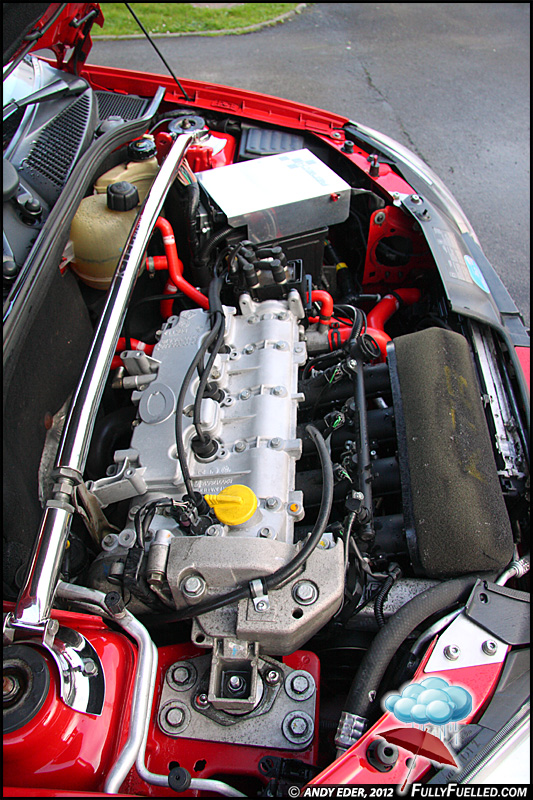

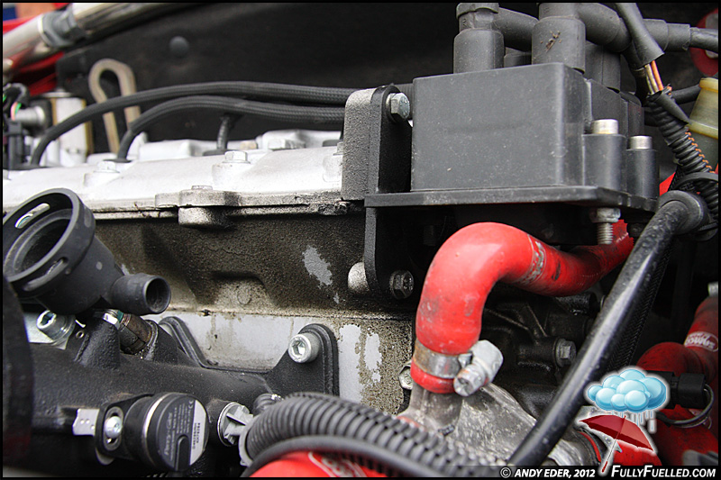

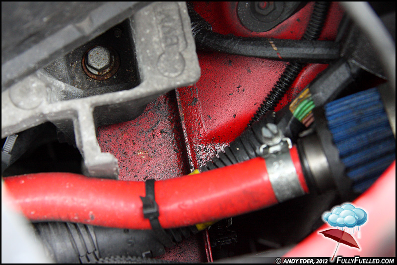

On a separate note, whilst this fiasco was going on, I did manage to give the engine a bit of a clean up. The oil breather pipe and filter was again filthy and full of cr4p (but easily cleaned). The trumpets looked good and fortunately no water had gone in through the filter during the downpour. Admittedly the filter didn't look quite so healthy afterwards but... hey, it did a good job in this case.
Oil deposits and a general build up of grime throughout the engine bay:

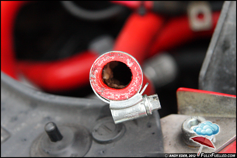

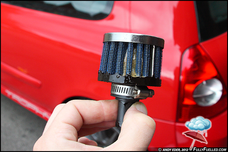

The dirty oil breather pipe and filter:

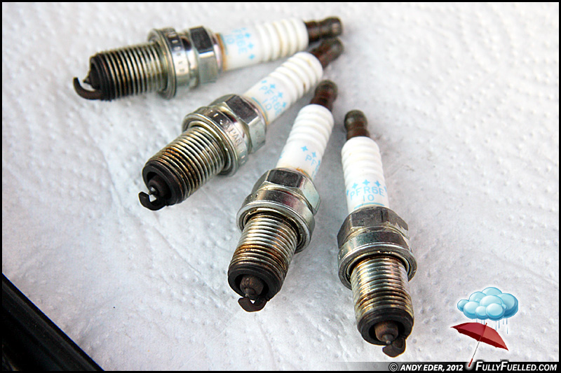

The spark plugs cleaned up well and should be good for a little while longer:
Despite the water issues she cleaned up quite well. Good enough for now anyway!
