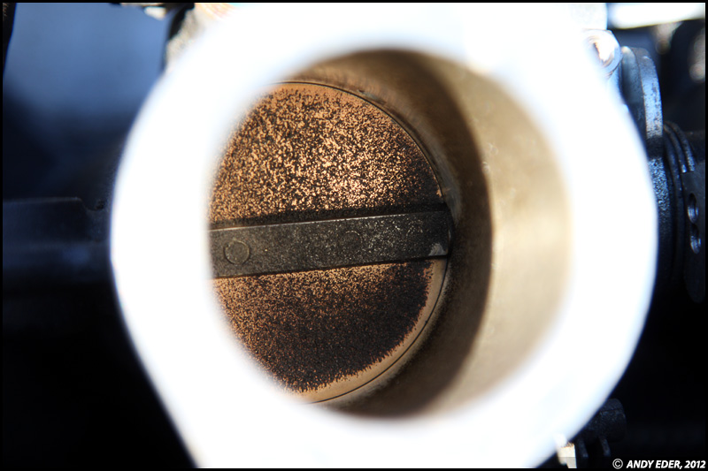

Are you still using the filter of death Andy?
  Evo 5 RS
Most foam filters will produce build up like that over time, the pipercross 60* range are the least prone to it though I've found. Generally the bigger the better.
As long as the mesh isn't making it's way down there ;)
SharkyUK
No mate - using a MUCH better solution now. To be fair, the filter was in need of a clean as I'd not done it in a while (so the build-up was not unexpected). All seems to be well as far as the filter is concerned. :D
^ I checked the mesh and can verify that all is present, intact and exactly where it should be... i.e. in cylinders 2 and 4! LOL!
Seriously, all appears well at the moment mate. All that I need is for the ITB's to be balanced and possibly a remap as it appears to be running a little rich. The amount of soot coming out the exhausts is ridiculous at the moment. I'm literally having to clean the rear of the car every 15-20 miles to get the deposits off. Case in point, I cleaned the exhausts for the Action Day at Combe Friday night... and by the time I arrived at the circuit Saturday morning (an hours drive) they were thick black with soot. Chip reckons it might be the map having bumped into him at Combe.

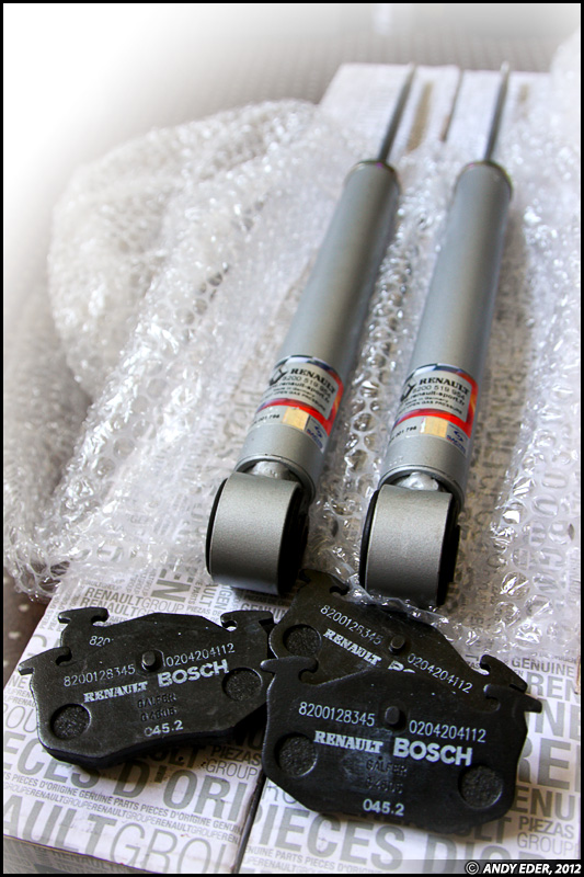

September 2012 - Update

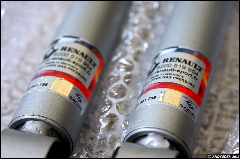

Despite flying through the MOT the other week the inspector did notice a slight leak from the rear dampers. It wasn't bad enough to fail the MOT but definitely needed to keep an eye on it. Unfortunately the week between then and now has seen me travelling some significant miles with work and sure enough the dampers have pretty much given up. Whilst steady driving was fine I certainly wouldn't like to have pushed on too hard so it was time to get in some new items (along with rear brake pads which also needed replacing).
I had already received the brake pads a few days prior (standard rear Renault OEM's) so they were good to go but I needed to source some Sachs rear dampers pretty quickly. The ride was noticeably degrading and I have a trackday coming up on Wednesday! After a brief look around I contacted Mick at Diamond Motors to see if he could help me source new rear Sachs. And that he did. Within a few days of ordering them I had a shiny new set arrive at 7am this morning (a time I never knew existed on a Saturday).
All I need now is to get them fitted in time for Wednesday. Fingers crossed...
I'd like to say a big thanks to Mick at Diamond Motors (Long Eaton, Nottingham) for sorting out the Sachs. And at a good price, too. In fact, I can't thank Mick enough for the great service, communication and general chat we had on the phone. A top bloke and someone who I would happily recommend to sort out their Clio. :D
