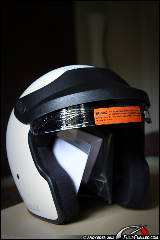

And to protect my head (hopefully, should the worst happen) at future trackdays, a new helmet.

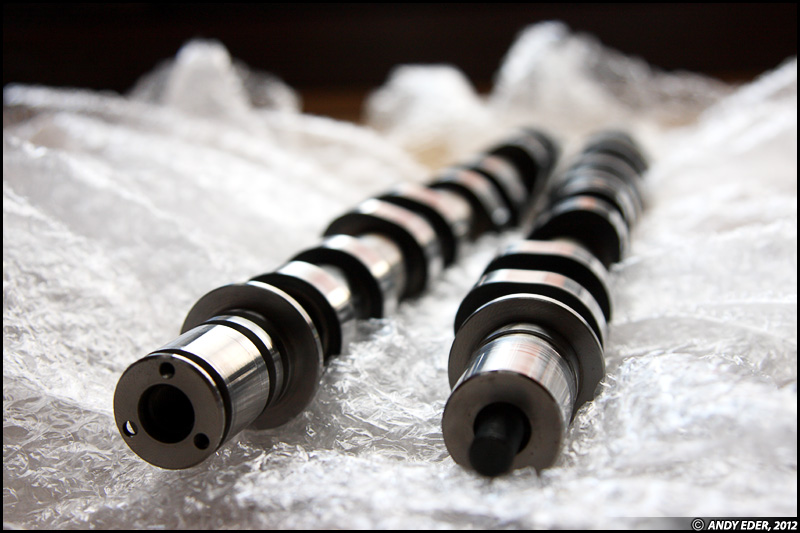

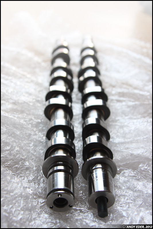

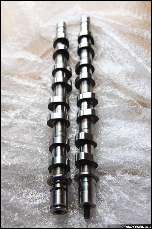

The only other item of news at the moment is that I have just purchased some rather tasty bits of metal that will, at some point, be installed. Why?
BECAUSE SCHRICK CAMS! I'm a little excited. Shame I'm not due a cambelt change for thousands of miles... I might have to hurry that along a bit!

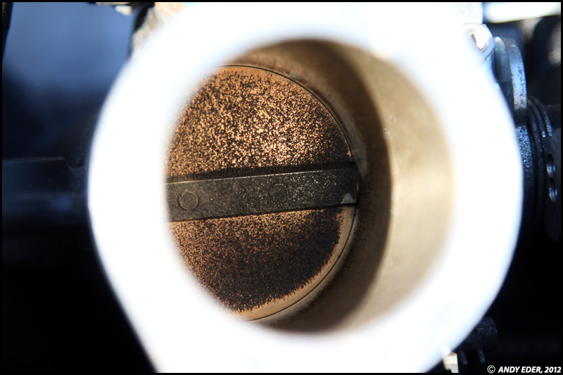

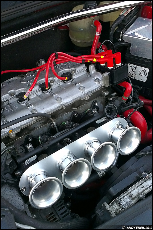

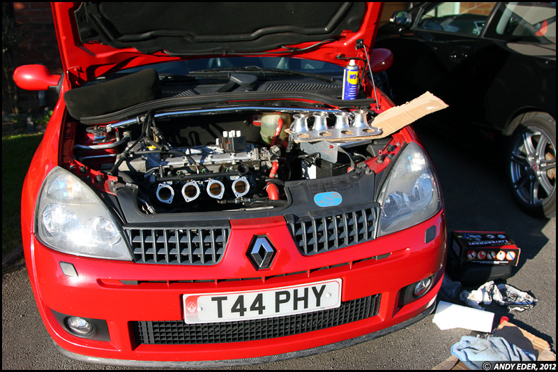

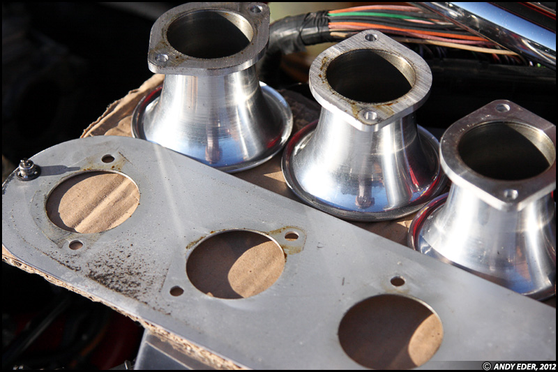

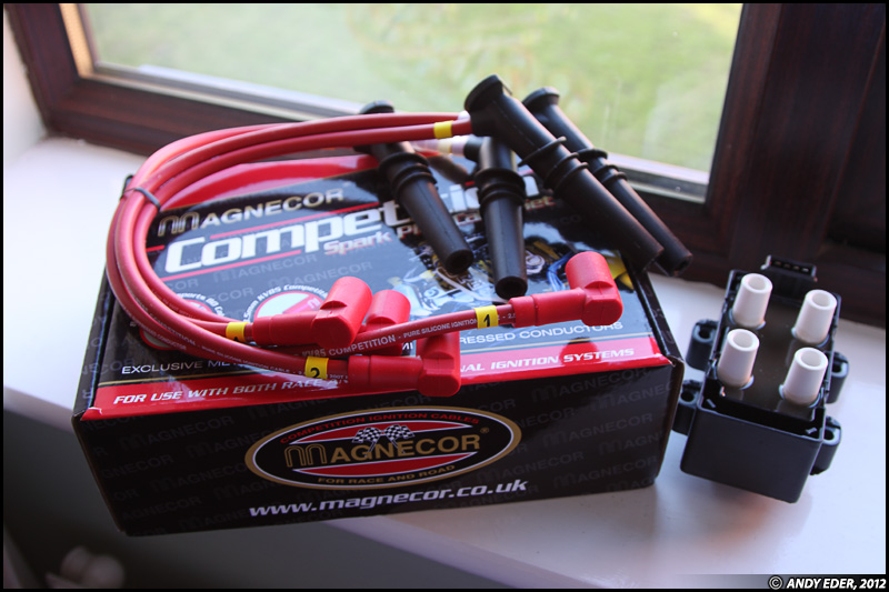

Last Friday night (the night before the Forge Motorsport Action Day at Castle Combe) I decided to replace my coil pack with a new unit and to replace my HT leads with some decent red 8.5mm Magnecor items. Ever since 'the incident' a few months back (where the engine got flooded following a downpour of rain and my bonnet being open) I've had recurring misfire issues. The spark plugs looked fine, the HT leads looked ok and the coil pack appeared to be ok, too. However, as these (leads and coil pack) had never been changed on the car I thought it wouldn't hurt to order new bits and to replace them.

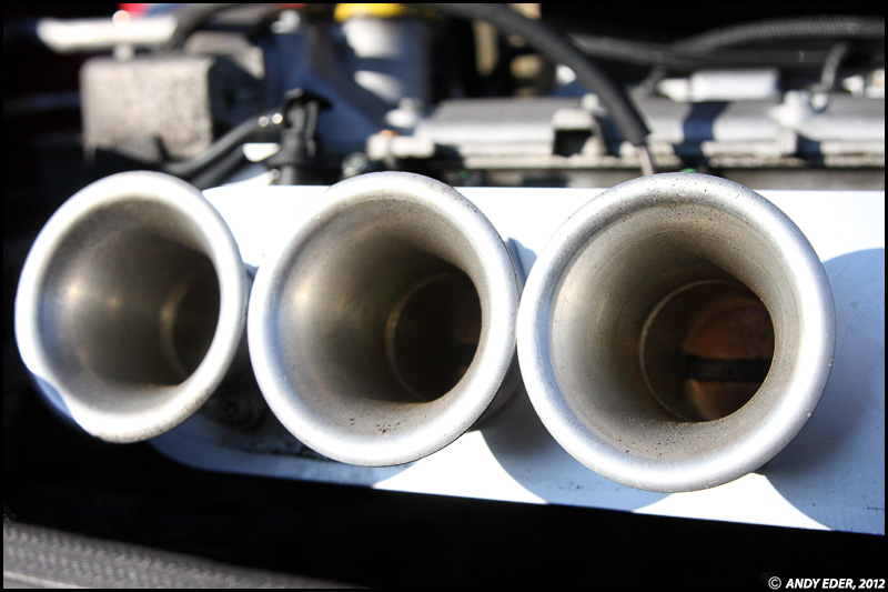

As the ITB's were also filthy I decided to take those apart and to give them a bit of a clean, too. The filter itself (not pictured) was quite dirty and definitely benefited from a good clean. Sadly I had run out of the ITG dust-repelling filter spray so that's something I need to do shortly. The trumpets and back plate were also a bit dirty (although this was to be expected as I hadn't cleaned them for a couple of months).
Dirty trumpets...
Dirty butterflies...
Dirty backplate...
As can be seen in the pic above, there was a little bit of oil / residue on and around the trumpets but nothing serious. I still have a minor leak or two (predominantly cam seals). At this moment in time it's not worth the time / expense getting them re-done so the plan is to wait until the next cam belt change.
Here's the engine bay with the trumpets and backplate ready for cleaning and with the old coil pack and leads removed.
An hour or two later and everything was back together and the ITB's were clean and gleaming. The only thing remaining was to fire up the ignition and to ensure that all was well. The first couple of attempts didn't go so well as the car turned over, popped a few times and then the engine died. Hmmm... Luckily it was an easy fix. A couple of the leads hadn't quite been fixed as firmly as needed so by simply undoing and refitting the connections, all was well when I next turned the engine over. Here's a pic showing the cleaned ITB's and the new leads and coil pack:
With everything back together I took the T out for a quick drive to ensure all was well. I wasn't expecting much of a difference to be honest so I was pleasantly surprised when the idle appeared to be a lot smoother and the acceleration noticeably stronger! This was probably due to the fact that there were no points of hesitation due to misfiring and the T happily pulled itself along at a healthy rate of knots. Happy days!
As mentioned above, the miles are adding up and I'm looking forward to the next cambelt change. Sure, it's not cheap but it means I can look forward to getting a few more bits done and to getting these bad boys installed! They've been sat on my desk for a month or two now. Just sat there, taunting me. I'm normally quite a patient guy but I really would like to get these in asap...
A tidy set of Schricks...
