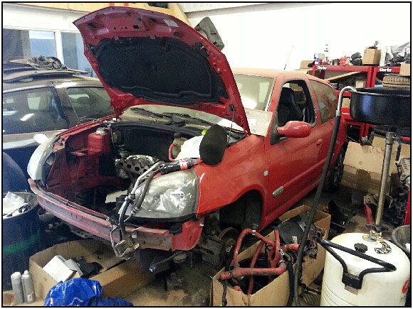

SharkyUK
March 2013 - Monday 11th
It's getting there... ;) Also saves quite a bit of weight without the engine holding things back.
Many thanks to Russ for the pic and for collecting my old ITB bits, which are now surplus to requirements (but doesn't mean that Russ and Dan can sell them cheap in the meantime, y'hear?!). The Quaife LSD is also in the process of being sorted/ordered pretty much as we speak, too. Happy days.
