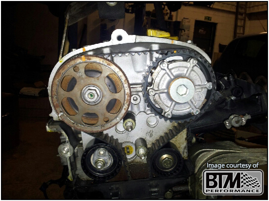

I've followed pretty much the same route as you Mike so yes, it is very likely those very people. With regards the head it was taken to their workshop and acid-dipped and skimmed. It's still the original head. I have to say that I have some genuine concerns over what has (or hasn't?) been done now. Sounds painful? Yes, it has been although I appreciate in a different sense to what you were inferring!If who I think actually timed it up, timed it up, I'm not least bit surprised. Your head was chopped out for a new one wasn't it Andy? (Sounds painful)
Blimey - timing out from factory, eh? That's a bit special in itself. I had no idea. But in this case, your closing statement may be closer to the truth than I like to admit.Re: the cambelt timing, mine was wrong from the factory, must be a Trophy thing lol:
http://www.cliosport.net/forum/showthread.php?521559-JMS-cambelt-timing-fixed!!
Or you've just been using non-specialiast, specialists![]()
Yeah, I think I might have got away with that one thankfully. I would have been well pi$$ed otherwise!Surprised they didn't snap to be honest.

if the marks on my pulleys had been lined up my timing would of been miles out when it came to fitting the horseshoe tool, i think they just dot random marks on the pulleys and headI've followed pretty much the same route as you Mike so yes, it is very likely those very people. With regards the head it was taken to their workshop and acid-dipped and skimmed. It's still the original head. I have to say that I have some genuine concerns over what has (or hasn't?) been done now. Sounds painful? Yes, it has been although I appreciate in a different sense to what you were inferring!

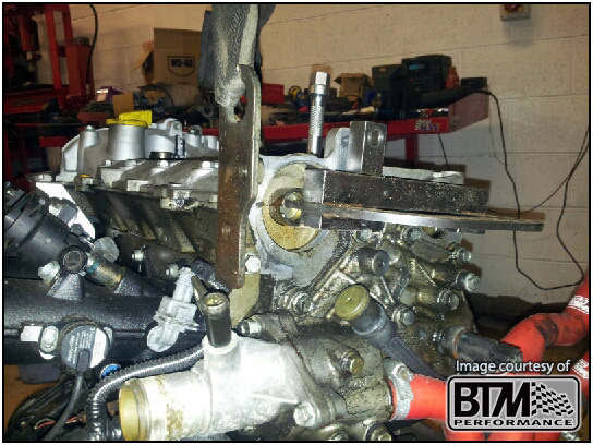

I'll just pop up these pictures for now that I received from Fred earlier. I think the picture below also shows a great job of the fixes that were made to stop the leaks I had. Twice. Which never fixed any leaks.
