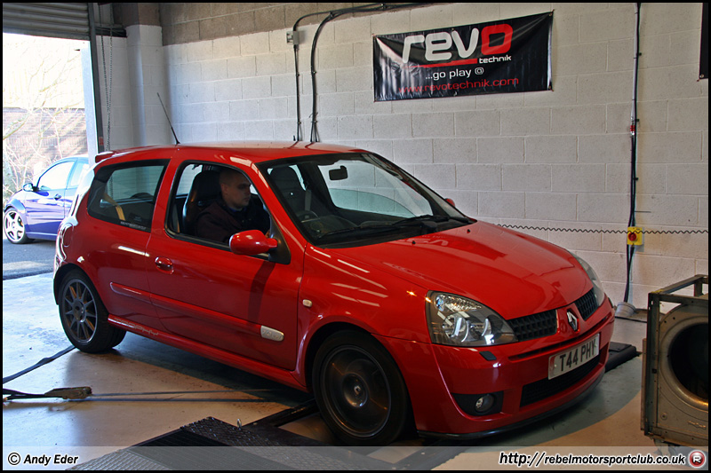

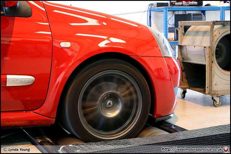

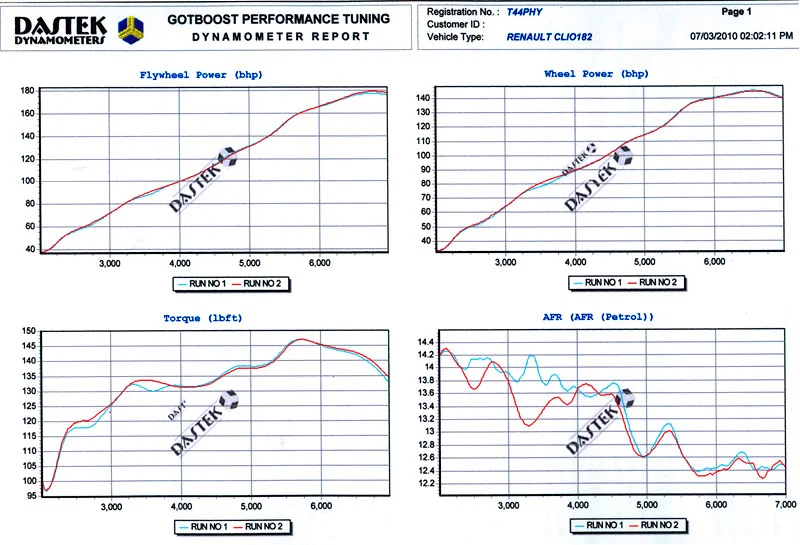

March is already here and we had our first Club event of the year earlier this month; a rolling road day at GotBoost in Llandow (as asked for by many members in the Club). I wasn't expecting any spectacular results as I had made no modifications to the Trophy over the winter (largely due to spending most of it in Perth, Western Australia) but thought I'd throw it on the rollers all the same.

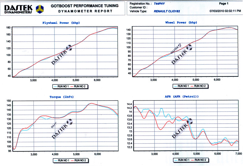

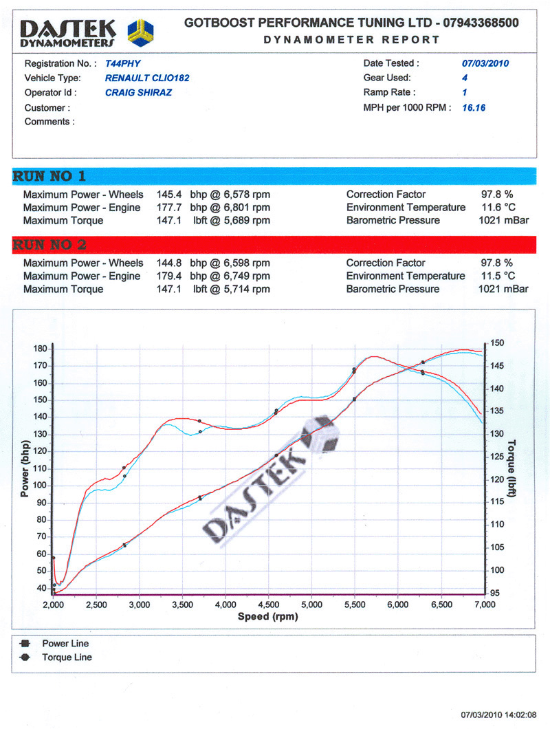

Sadly there were a few issues with the rollers on the day (calibration issues) but it wasn't too far out when it came to my time to roll. The dyno graphs are shown below. I'm not sure what was going on with the power delivery as it seems very 'lumpy' and the AFR seems all over the place. Still, I'm not complaining as it was a good day out - a chance to meet up with friends old and new and the car is driving great anyway!

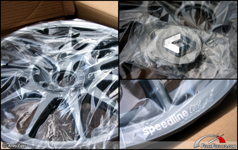

I loaded my new Turini's into the Fiesta (our runabout car) and got up early Friday morning to make my way to the tyre and exhaust place. (Thankfully I have a very understanding boss as I should have been in work that Friday morning...) I sat outside the garage and waited for the owner to arrive. When he did arrive I approached him and explained the situation. To be honest, I wasn't expecting a favourable reply but that's exactly what I got! He simply told me to bring around the alloys/tyres as and when I was ready and he'd swap them over to the new set for me. As a result of their help I was back in business - so I think the least I can do is a big shout-out and "thank you" to Beechwood Tyres and Exhausts (Newport, Gwent). Gareth, Dave and Owen - you're all legends! With the tyres and alloys now sorted, I had a bit of a chat with James and then made my way (late) into work. I was very much looking forward to picking up the car later that evening and seeing the results.
I wasn't disappointed when I made my way back to Ti22 that evening for the pick-up. Even under the dark evening sky, the Trophy looked better than ever before. It had a deeper glossy red shine and the Swissvax treatment had worked wonders. I really couldn't thank James enough. Even some of the faded plastics had come back quite nicely, too.

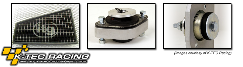

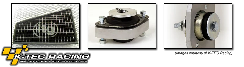

I had the air filter element replaced with an ITG performance element (I thought it was about time I got rid of the old one). I also had uprated engine mounts fitted, including the upper gearbox mount. I had started to notice a fair bit of 'movement' over previous months (and a greater loss of traction when accelerating hard) hence the reason to go with the uprated mounts.

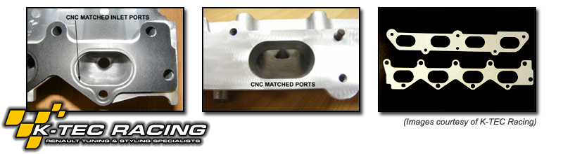

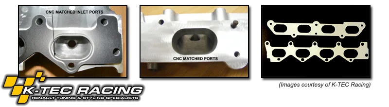

Engine-wise, I also opted to have the CNC matched inlet work carried out. I'd been looking to have this done for a while and saw no point in waiting any longer! To accompany this the PTFE gasket kit was installed (cylinder head to lower manifold gasket and manifold to plenum gasket). With a bit of luck this will help keep the temperatures down a little and, in conjunction with the port matching, offer a mild performance increase and improved throttle response.
As already mentioned, I also had the 60k service carried out and had the uprated Powerflex polybush kit installed along with the uprated engine mounts. To cap it all off, I also took the opportunity to have KTR remap the car to make the best of my current modifications (in their new custom-built dyno cell). Being realistic I wasn't expecting too much in the way gains and was hoping more for an improvement in the throttle response (which I'll get onto shortly).

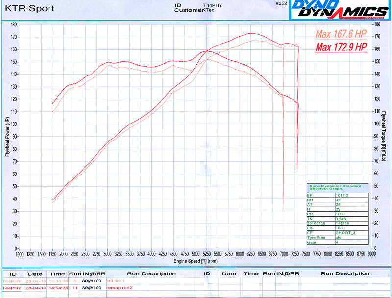

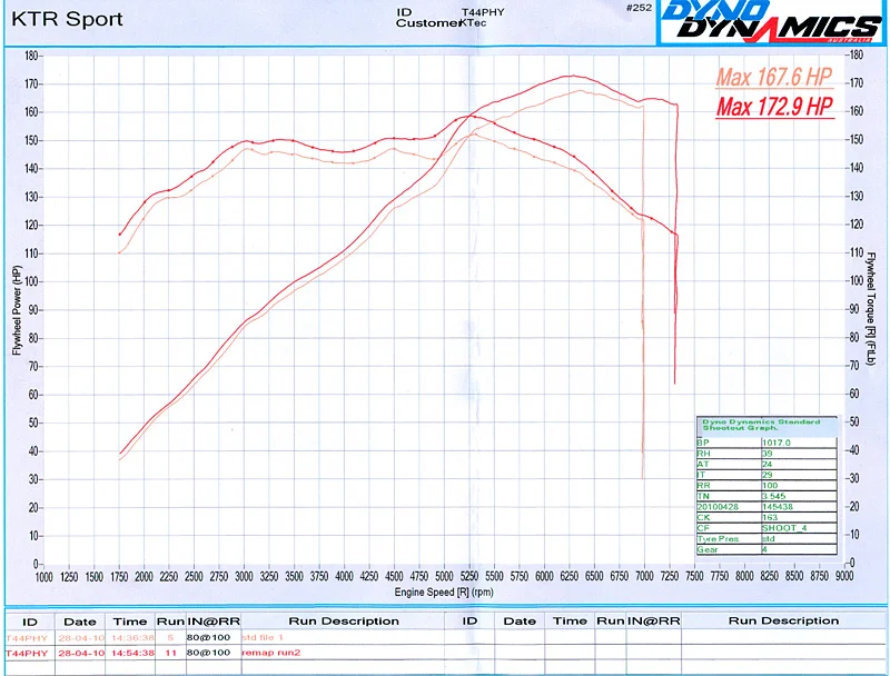

Below is the dyno readout showing the performance gain from the remap.
As can be seen in the graph above, I've got a nice little increase in both horsepower and torque across the rev range. The increase in torque (coupled with the improved throttle response) made for a grin-inducing drive back home to Wales! In a nutshell, the Trophy is now driving and pulling better than I've ever known it to. When I plant my foot it now instantly picks up and the traction is noticeably improved, too. The biggest surprise was the in-gear difference that the modifications have made; again with the pick-up and power delivery much more evident and welcome. The way in which the power is delivered is also smoother and a quick glance of the speedo suggests that it might be wise to pay more attention to it until I've become more akin to the different feel that the car now gives me.
Sure, the car may have a bit more vibration in the cabin with having the uprated mounts fitted - but this is a very minor thing and something that doesn't concern me. The car is in great shape, it's driving beautifully and I'm chuffed to bits with this latest round of modifications. What next I wonder...?

No mate - I don't mind you asking. The best thing is to take a look at the K-TEC Racing website - click here - as that is what I had done and the price I paid (plus fitting and obviously I had other work done, too).
It's hard to say what sort of difference it (the matched inlets) made simply because there was a fair bit of other work that contributed to the overall improvements and gains. As I understand it the difference may be negligible or it may free up a handful of horses; there is no real guarantee with this mod. However, I would get it done alongside other things (as I did alongside the PTFE gaskets and remap for example). Sorry I cannot be anymore specific than that mate.

Dean, I have noticed a significant improvement in performance to be fair. Since I had this done last week I've covered some 700 miles and noticed that the performance has even upped a little more over that distance (which is a very nice and welcome surprise). The improvement is across the whole range but moreso in the mid-range (which is where I wanted it). I think the uprated mounts have gone some way in improving things though as the Trophy seems to put down the power much better in terms of greater traction. Rather than pick a particular 'thing' I believe it's more a case that all the mod's I've had done have come together nicely.
If you are looking to simply get a dyno reading for your car as it is (a baseline figure is a great idea if you're looking to modify it) then look to pop along on a dyno day and you can get a couple of 'runs' for £25-£45 (as a guide). Try and choose a respected dyno/tuner and try and use that same dyno for future visits as and when you've had work carried out...
To put it on the dyno at K-TEC, I opted for the Group N specification remap (click here for more details including price, etc). I wanted to get the most out of the mods I had done that day as well as the already existing mods I'd done - such as the exhaust and sport cat. It's not a cheap option but it's worth getting it on the dyno and remapped by a respected tuner when you've had work carried out; it just makes the most of what you've spent your hard-earned on.
Interestingly, the dyno result I got at K-TEC is the lowest I've ever had for my Trophy (by almost 10bhp). But, the important thing (as I can't stress enough) is the gain you see before and after work has been done. I saw an increase of 5-6bhp and 4-8ftlb torque purely from the remap alone. I'm not sure how much difference the other mods made. However, my 'regular' dyno is at PowerStation so I will be visiting them at some point to see how my graphs shape up now. At PowerStation my baseline figure is ~180bhp (on THEIR setup) so I'm hoping to maybe see a mid- to high-180's with a bit of luck. We shall see.
A final note - don't get too hung up on the figures and go chasing them. As I say, my reading was the lowest I've had yet but I can confirm the car is driving better than ever. My real-world 'measure' is our (my partner's) modified Type-R and (whilst the modified Type-R *is* the quicker car) the Trophy is no longer left eating it's dust and may even have the edge on the uphill stretches!
