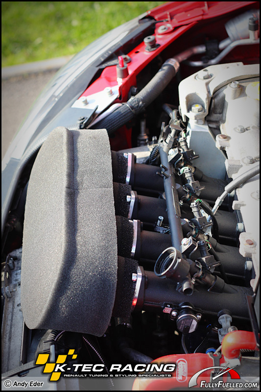

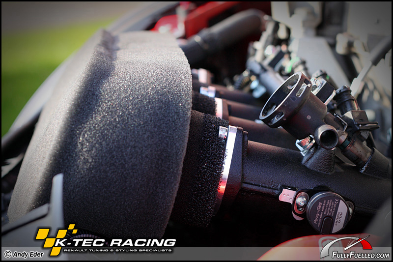

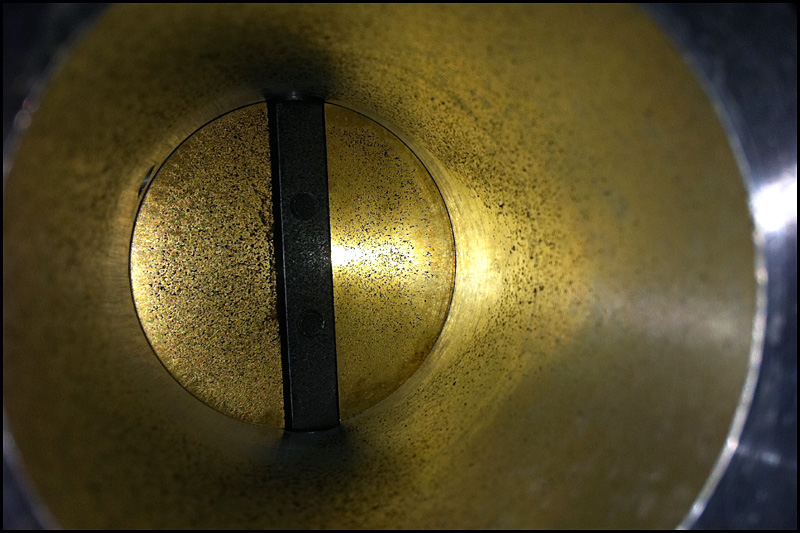

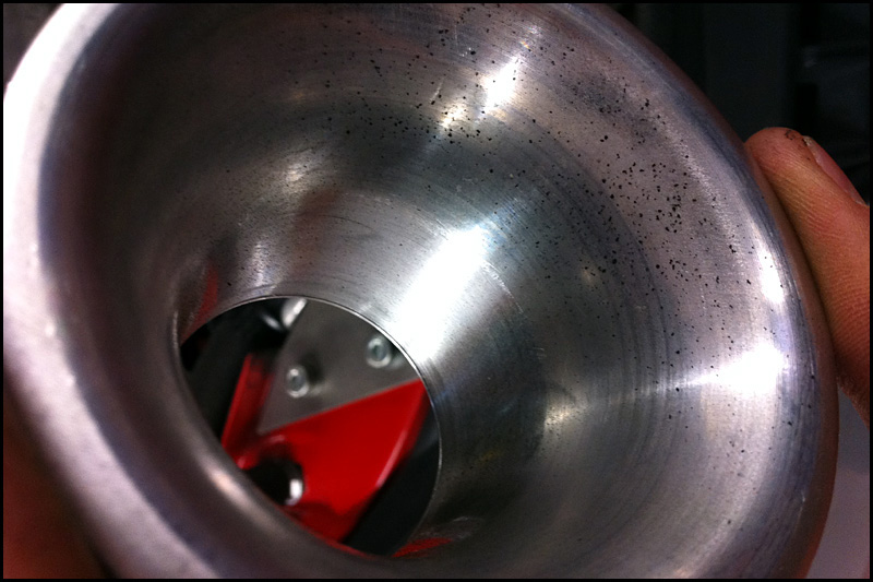

In terms of the ITB's I can't complain as they appear to very well built and put together. However, I have my concerns over the choice of filter. As well as the bad news upon my return to TDF I was also greeted by trumpets full of disintegrating foam and Matt had kindly taken the time to clean everything up for me. This was frustrating given that they had only been on the car for 9 days. Sadly, the foam components also don't hold up higher in the rev range and the filter gets sucked right up against the trumpets. Below you can see the extent of the problem:
(Thanks to Matt for the photos).
Despite the above issue my early impressions of the K-Tec DTH ITB's are very good. The filter is being replaced next week with an ITG sock and a custom-made back plate to prevent the trumpets becoming fouled.
