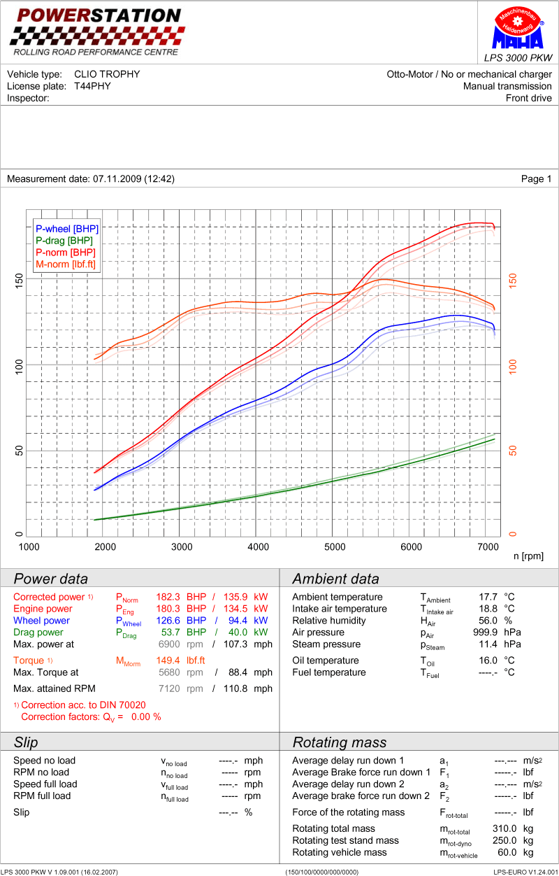

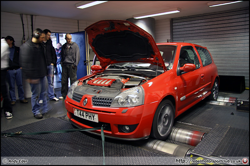

Without a doubt the Trophy has been driving (and pulling) better than it has ever done before and I can only put that down to the new exhaust. Even better is the fact that it seems to be noticeable across pretty much the entire rev range... a fact that was clearly in evidence following our recent Rolling Road day at PowerStation. Below is a picture of my Trophy on the rollers followed by the dyno plot (the dyno plot is overlayed with runs from previous occasions):
As can be seen in the dyno plot above there has been a slight increase in performance with each visit to PowerStation. The stronger/bolder colour lines are indicative of the recent run whereas the faded lines show the plots from two previous visits.

Awesome car and write up mate. The Trophy seems to be going fro strength to strength.

She's a strongen isnt she. I like how you have plotted the old line on the same graph, coooool.

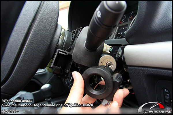

Wiper Stalk with Intermittent Wiper Control
Quite some time ago I got a new wiper stalk for the Trophy. Why? Because the standard wiper stalk is crap and has no proper intermittent wiper control! This would mean that I was often stuck in a light shower of rain with the wipers going like crazy and no way of controlling the interval period between wipes... which, believe me, was very annoying. Anyways, with the weather being fair I decided that today would be the day that I finally got around to installing the stalk. Here's what I did...

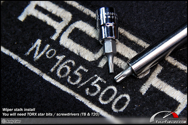

Tools needed:
  • TORX T20 star screwdriver/bit
  • TORX T8 star screwdriver/bit
  • Flat head screwdriver - to help release a clip
Step-by-step:

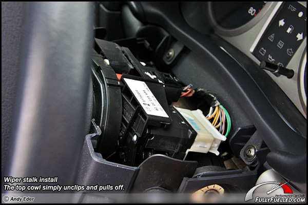

Start by popping open the bonnet and disconnecting the battery (remove the black terminal connection). Also give the steering wheel a quarter turn to the right as it will make things a little easier further down the line
There is an upper and lower cowl to be removed so start by popping off the smaller upper cowl. There are no screws so simply pop it off and you'll end up with something identical to the picture below.
Before removing the lower cowl, the audio control stalk needs to be removed. Look inside the casing where the audio control stalk is housed and you will see a small clip assembly. This is labelled (1.) in the picture below. Take a flat head screwdriver and push this clip in firmly and slide out the stalk (2.) as pictured.

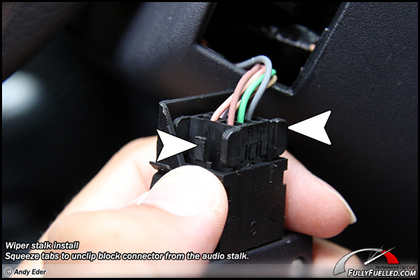

Squeeze the small clips to disconnect the removed audio controller stalk from the wired block connector. The lower cowl can now be removed.

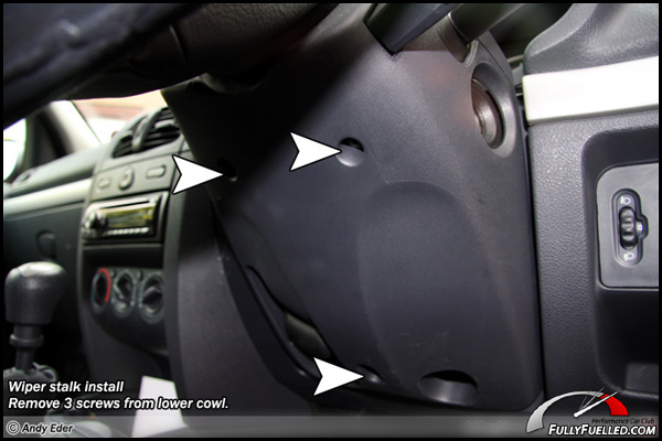

Locate the 3 screws in the lower cowl and remove them using the T20 star bit / screwdriver. With the screws removed, pull the cowl away and put it aside.
Remove the immobiliser antennae ring from the ignition switch; it simply slides off with very little effort (pictured below).

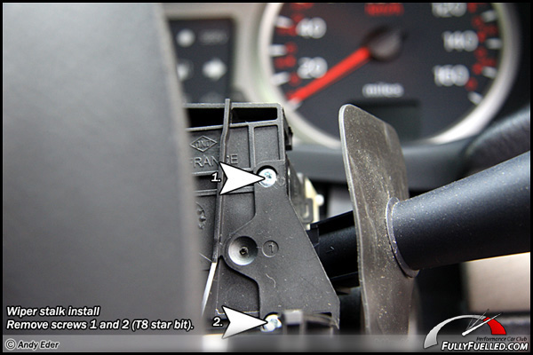

Using the T8 star bit / screwdriver remove the 2 small screws that secure the wiper stalk.

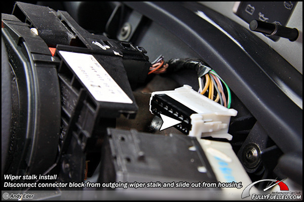

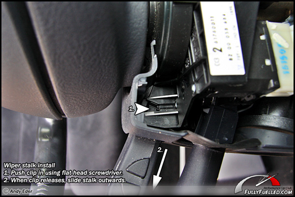

Disconnect the connector block from the outgoing wiper stalk (by squeezing the two clips at each end of the block and pulling) and slide the wiper stalk out from the housing.

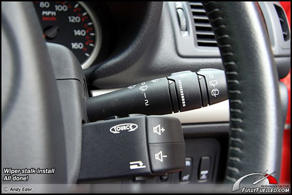

The job is halfway done - it's now simply a case of sliding in the new replacement wiper stalk and reversing all the steps.
Begin by sliding the new stalk into the housing and reconnecting the wired connector block. Secure in place with the two small screws. Replace the immobiliser antennae ring by sliding it back onto the ignition switch. Replace the lower cowl (remembering to feed the wired connector for the audio stalk through the relevant hole in the cowl) and secure with the 3 screws.
Reconnect the audio stalk wired connector and slide the audio stalk back into the housing; it will 'click' into place. Take the upper cowl and clip it back on. Finally, reconnect the battery and enjoy the new wiper stalk!

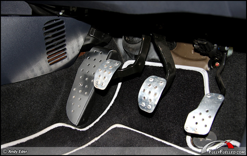

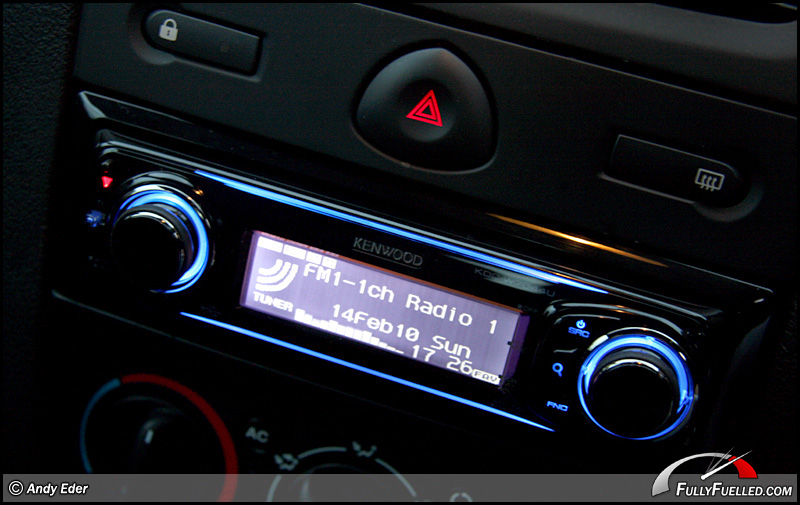

Another item for the Trophy and I braved the freezing weather to fit it earlier today. It's a new and improved footrest. Between you and me, this little addition adds approximately 25bhp in terms of additional power output. Sssh, don't tell everyone otherwise every man and his dog will be after one... Joking aside, this really sets the driver's footwell off nicely. The standard Renault item (i.e. a black rubber-topped footrest) didn't really cut it and looked a bit cheap. However, the addition of this new footrest remedies that and, as you can see, looks much better.
As well as the new footrest I fitted yesterday, I also bought a new stereo/headunit to replace the Alpine unit. It's a Kenwood system that is i-Pod, i-Phone and Bluetooth compatible. It also rather handily accepts USB devices so simply plug in a USB stick full of music tracks and away you go. I'm not really into big ICE installs and subs so this headunit should see me good for quite some time. As long as I can tune into my favourite radio stations, play MP3's and CD's, and plug in USB sticks - I'm happy. Now, where did I put my Duran Duran album?
I just need to read the instructions now to figure out how it works!
