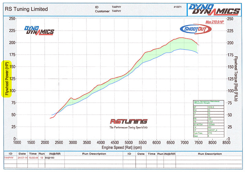

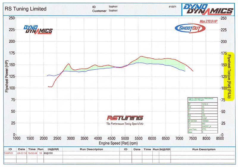

Just a little update showing a 'before and after' with respect to dyno overlays.
However, please take the following with a pinch of sodium chloride; two different dynos were used by different operators under different conditions! It's well known that dynos vary greatly from one to another so...
The before plot (the blue line) was the last dyno session before I dropped the car off with Fred. I was running:
  • K-Tec DTH ITB's
  • Standard cams
  • GEN90 ECU
  • Filter of Death
  • Mapped at K-Tec/TDF
The after plot (the red line) was the most recent dyno session when the car was being run-in and mapped. I am running:
  • Jenvey ITB's
  • Schrick cams
  • GEN90 ECU
  • Mapped by Paul at RS Tuning
I have taken the graphs I received from RS Tuning and composited the previous results over the top.
The light-green shaded area shows the increase in bhp.
And again, the light-green area shows the increase in torque.
Moral of the story? Feck knows. :)

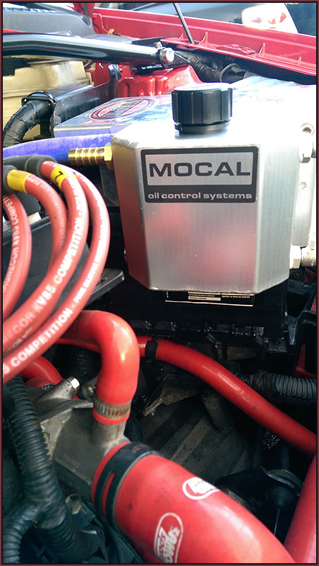

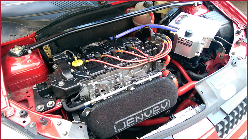

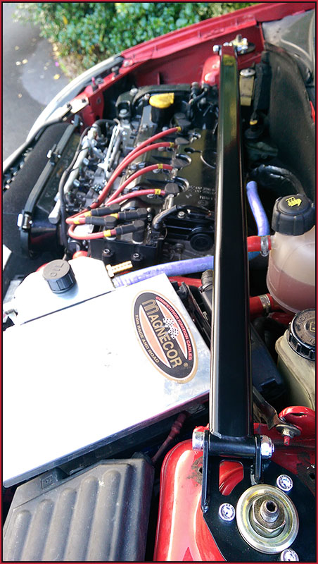

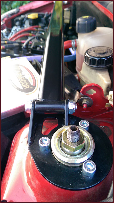

As I mentioned in an update a couple of pages back, I had ordered a few more parts and today they were being fitted (along with a bit of fabrication work in the engine bay). I was on an airport run for a friend and, being in the Somerset area initially, I naturally dropped the car with Dan at SJM. The plans were to:
  • drop the ECU as it sat too high in the engine bay
  • add a MOCAL oil catch tank into the mix
  • new brake pads to be fitted, obviously with fresh brake fluid
  • new pre-cat lambda sensor
  • fitting of Pure Motorsport top mounts and strut
To be honest, it was actually Dan's fault as he made the mistake of saying that it was a fairly straight forward job and shouldn't take too long...
:p As you'd probably expect (or Fred would know!) that's never quite the case with this f'ing car. If I just roll back an hour or so...
Setting off from Wales we hit torrential rain as we crossed the Severn estuary and I'm still not sure how my good lady and I made it down the M49 and M5. The wipers couldn't cope with the deluge, the motorways flooded as they couldn't copy with the deluge and I almost had my better half hanging out the car as we struggled to identify where the edge of the roads / lanes actually were! It was ridiculous. Thankfully it didn't last too long and another 10 miles down the M5 and we were back on dry tarmac and blue skies! But, strangely, I had thought that the suspension felt a little crashy. I was not 100% sure though; I hadn't driven the car for a long time and was swapping between a few different cars from one day to the next. I thought I maybe wasn't used to it again and the fact it was feeling different due to the addition on the diff. I thought nothing of it and carried on; the roads were generally good and it was handling fine.
Having arrived at Dan's workshop, I handed him the keys and parts I'd sourced and discussed plans for the engine bay. It looked straightforward enough to modify the ECU bracket and to fit the MOCAL catch tank so no problems were envisaged. Hence, I carried on my way and left the man to do his magic.
It wasn't long before I got a message that something wasn't quite right. Dan asked if I'd noticed anything weird regarding the handling; specifically on the drivers side (front). I mentioned the crash-ness and was then told that there was an issue with the Sachs damper. Basically it was f**ked! It was simply moving in/out and offering zero damping whatsoever. No amount of priming or fiddling could temporarily sort it so... yep. Rebuild time. This was a bit unexpected and money is tight at the moment. On top of paying for the recent work, today's work, MOT, tax and insurance (due this week) I'm also moving from my old house to a new one (and currently having to pay for both). Pay day can't come quick enough this month! LOL! Of course I was annoyed but, given the story of the car, it perhaps shouldn't have come as a surprise! My initial thought was one of dismay as it was yet another setback; and I just want to get out and drive/enjoy it. My second thought was also one of dismay. As I have no chance of getting the Sachs rebuilt in the near future it threw into doubt the forthcoming Llandow track day, my first visit to Clio Sport Saturday and a week's driving holiday I've organised in Scotland in a few weeks time. You could say I was a bit pi$$ed.
Of course, there was also another slight hiccup. Again - nothing major - but enough to give Dan a headache! (Sorry mate!) In removing the old strut to make way for the new PMS kit, the strut cross threaded. Hence Dan had to run a die up and down it. Sadly this meant he had to go out and chase up various people until he could find what he needed. After a few dead-ends he thankfully found what he needed :) Plenty of M12 when what you really want is M14... I was grateful for him running around and sourcing the part so happy days and many thanks :)
Moving on a few hours to when I went to collect it...
Yep. The damper is f**ked alright. Absolutely nothing working with it! On a quick test drive that Dan had taken, it was now obvious that the damper was screwed. The addition of the excellent PMS kit highlighted the issue as it just caused knocking over anything but the slightest undulation in the road surface. Dammit. On the plus side, the new kit looked great :)
To facilitate the fitting of the PMS kit, Dan dropped my ECU by 35mm so as not to foul the strut. It now sits at a much more pleasing level in the engine bay. He also added the MOCAL catch tank flush with my existing setup and I was able to retain the battery cover. I was expecting to lose it but, now it's being kept, I will get it polished up and/or sprayed to match the rest of the bay. All I need now is to replace the horrible blue pipe with red and to fit a filter to the other outlet from the catch tank. This will be happening very soon. Sorry for the poor mobile phone pics.
Another minor issue was with the brakes. The fronts were binding a bit (maybe from having been stood so long) so I'm keeping an eye on that. It wasn't too bad on the way home so we'll see how that goes.
To finish up, a fellow Clio enthusiast turned up at Dan's for a quick spin in the Trophy (wanting to see what the ITB's were like). I think he liked them :)
