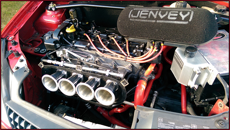

Looking mint under the bonnet now Andy :approve: apart from the blue hose ( till Tim gives you his big Red length ! :eek:) love the colour coding , even the coolant to match your paintwork ;) lol (why not type d ?)
Tim's good like that ;) Top bloke. As for why I'm using CAPSICUM RED coolant... Fred explained it well! :p
because the rad is temporary, so i just chucked it in for the time being, plus when the engine blows up it won't show up as much on his paintwork ;)
^ And there's the reason! Nothing like having faith in your own abilities, eh? ;)
Trophy's engine bay looks great @SharkyUK :)

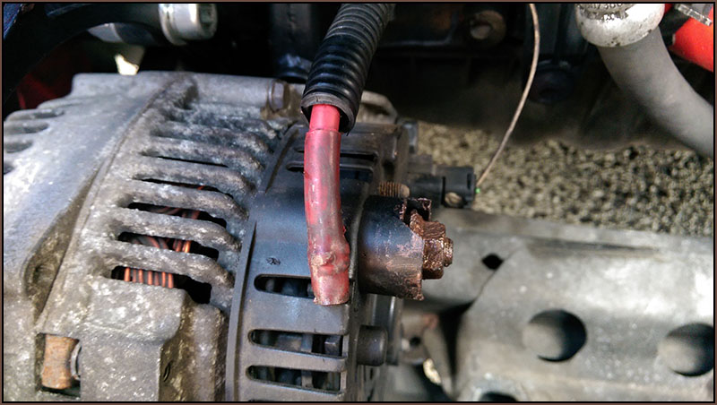

I pulled into the work car park and, as I came to a stop in the bay, the car cut out. I got a brief flash of dash lights but was unable to determine which symbols had been illuminated. With a fresh turn of the key I noticed that the STOP light was illuminated, as was the battery charge warning light. A further turn of the key made no difference as the car quite simply refused to kick into life. Opening up the bonnet I took a quick look in the engine bay but was unable to see anything immediately obvious. It would have to wait until lunch time as I had to be in work and my frustration was starting to build. Closing the bonnet I returned to the passenger door, opened it up and slid the Recaro Trendline seat forward (to access my jacket and bits for work). And then it jammed. The damn seat would not move on the rail. It would not tilt. It wouldn't do anything and no amount of swearing could budge it. :( As daft as it sounds, I flipped. I locked up the car and went into the office in a very bad mood. My (very understanding) boss picked up on this. Perhaps it wasn't wise giving him a kick in the shins as I went past him, but he knew immediately it was car related.
Joking aside, today was the first day I actually felt like throwing in the towel. Despite the time scales, the setbacks, etc. only today did I honestly feel like getting the car crushed and cubed. I'm naturally a very laid back person but this actually affected my whole day! I basically wrote the working day off, apologised to my boss and my team, and agreed to make up the hours over the rest of the week. I spoke to a friend who works with me and he agreed to meet me in the car park at lunch time with tools!
Whilst waiting for him, I decided to tackle the Recaro problem. It was still stuck fast so I quite simply put the boot in. I kicked it a few times. Real hard
:eek: I'm not proud... but it worked! LOL! And it works fine again now. The only downer is that I scuffed it a little where I landed a particularly hefty blow, but it came out later with some TLC. My friend turned up shortly to lend a hand. It didn't take long to find the problem. Alternator. The connection to the alternator had completely snapped off. This had resulted in a discharged battery and, obviously, no recharging of the battery.
With luck, I did manage to jump in the car and got it to turn over. Immediately in doing so I got my friend to follow me home so that I could get the car on my driveway before it completely packed up. It was only a 10 mile journey or so and thankfully I made it. With it parked on my drive, I returned to work in my friends Subaru and with frustrations at an all time high. I contacted my local auto-electrician (0.5 miles away from my house) but they would not fix it. They wanted to recover it to their workshop first... no chance! It was shortly after that I received a message from another friend who offered to pop over with some tools and lend a hand in re-attaching the wire. Whilst I worked the end of my day (and arranged for my better half to pick me up) my friend spent about an hour trying to find somewhere selling the required 49p terminal connector. Nowhere local had one! Oh well, temporary job it would be for now then... And, as good as his word, Sean turned up and kindly connected things back up. After another trip home, Sean returned to my place again with his jump leads and Le Clio B**tard Rouge came to life. It was only fair that I take Sean for a quick spin, so I did! All in the name of recharging the battery... :)

Sorry to hear about that mate, but at least it was a relatively straight forward and inexpensive fix!
Do you know the spec/size of the terminal connector? Mine is in quite badly corroded too so i'm thinking of changing it just to be on the safe side...
NorthloopCup
My first cup nearly went up in smoke as a result of that very same fault! Alternator terminal corroded and gave up = me considering pissing on it to put out the fire whilst frantically pulling the battery terminals off!! I ain't no contortionist neither! Lol
NorthloopCup
They're m8 terminals mate. Be careful though as they usually snap out of the alternator body when you undo the nut. Piece of s**t design!!
Cheers Tommo. As you say, it's not a major problem and thankfully there were no fires either! That would have tipped me over the edge! LOL!
Yours as well? Blimey. :S Not a good time to suffer with pee-shyness! I'm glad it didn't go up in smoke though!

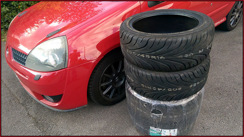

On a different note, my track day tyres arrived today. I'll get them fitted to a set of my spare wheels tomorrow and scrub them in!
New brake pads are on and fresh fluid, too. The knackered Sachs will be removed on Monday and the temporary set of 182 Cup shocks fitted (and used) whilst the Sachs are sorted out.

Nothing major to report but I did take the tyres to be fitted today. The rear strut brace comes in very useful for keeping things in place! :eek:
16" Federal RS-R's pm Trophy Turinis. Baller. LOL! I don't have any 15's.
