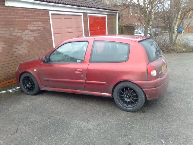

Fitted my AST's today, set them a bit low at first....!
The rear arches were supported by the tyres, wouldnt even move!!
Lifted it up a bit and went for a quick drive around the block:
jack wouldnt go under even on a 2" block of timber under the wheel!!
Got a bit more sensible and lifted the front and rear up to get rid of the scrapage, should be able to go about 10mm lower on the front again though ;)

Why spend all the money on ASTs to set the car up so it handles like sh!t?? :S
It hasnt been set up yet obviously, will be going to powerstation once I have decided if I want the stiffer spring option or not.
I want it as low as possible but to handle mint, so will probably have to compromise on the height a bit, but admit that it looks mint damn you!

Far too low at the back! If you've shelled out x£hundred then set them up properly!

Baggers, it will be set up to handle as good as possible, the lowness is an awesome addition to that though!
Got the solid top mounts on too, seems to have very good initial turn in.
Currently running max soft at the front and 8 clicks on the rear, need to have a good play about and see how much difference it makes and what feels right for me, will do that over the next few weeks.

Let put it this way if you want the car to work properly and the suspension to work properly then you will have to lift it up a fair bit. You must have almost no suspension travel at all. Curtis will defo raise it up more than that.

The rears are not the issue. Its the fronts!!!

looks great how it is now. although i would go 10mm higher on the back and leave the front how it is.

Right, the car is low as fook, because i can.
It will be set up by Powerstation, full geo and corner weighting in the next few weeks. I'll tell Curtis I want it as low as poss but the handling to be spot on, as said before I know I will have to compromise on the ride height, but for now it will stay pretty much as it is.
As Steve said, i only finished them an hour or so ago, cut me some slack!

the front is not a million miles away but under heavy cornering he will find the wheels scrubbing the hell out of the arches!!! Trust me ive had it endless amounts of times. Back is too low. The car needs to have rake to aid the turn in and try to eliminate understeer. The front must push on a fair bit the way it is.

I agree with what ur saying but with decent coilovers the setup is vital and ride height is extremely important to how the car will ride, handle, feel, behave etc. If he just wanted it slammed he may well have just bought GAZ crap. but like he said hes getting them done soon so all is good :)

Didnt say that providing you have enough suspension travel or enough room for the wheel to move which is not great on the front of a standard 182 with arch liners etc.

Told Curtis I wasn't fussed with the ride height, just wanted the best handling set-up
  Mk2 172
Me too. I wasnt allowed an input on the ride height lol.
He said ur having the best height for handling on a road car. He said do u want it to look proper or look like its had cut springs!
