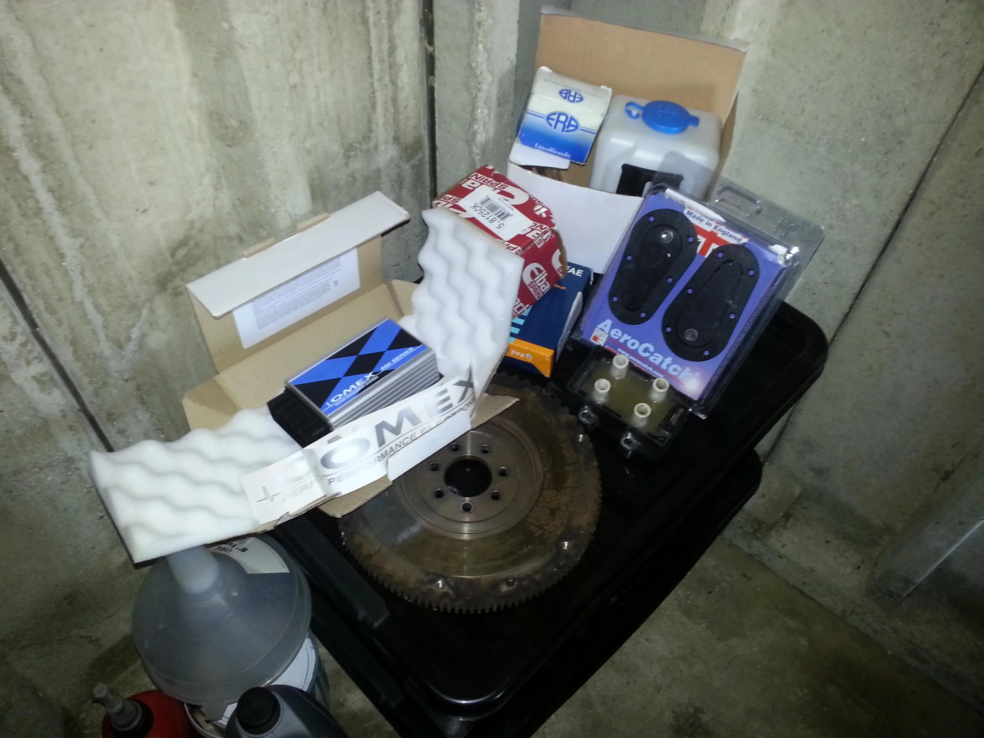

parts hoard getting bigger! lol
omex, which is getting sent to OMEX to have 70d firmware installed FOC as its new.
aerocatches
172 flywheel and coil pack
new lamda
new map sensor
new waterbottle and pump

Standalone baby!
Also
172 flywheel
Aerocatches
172 coil pack
Camber bolts
Map sensor
Lambda
Washerbottle kit

But i now have to send my omex back to OMEX for the firmware to be updatedto 70d,for telemetry. Omex said as its a new unit they would do it FOC :)
