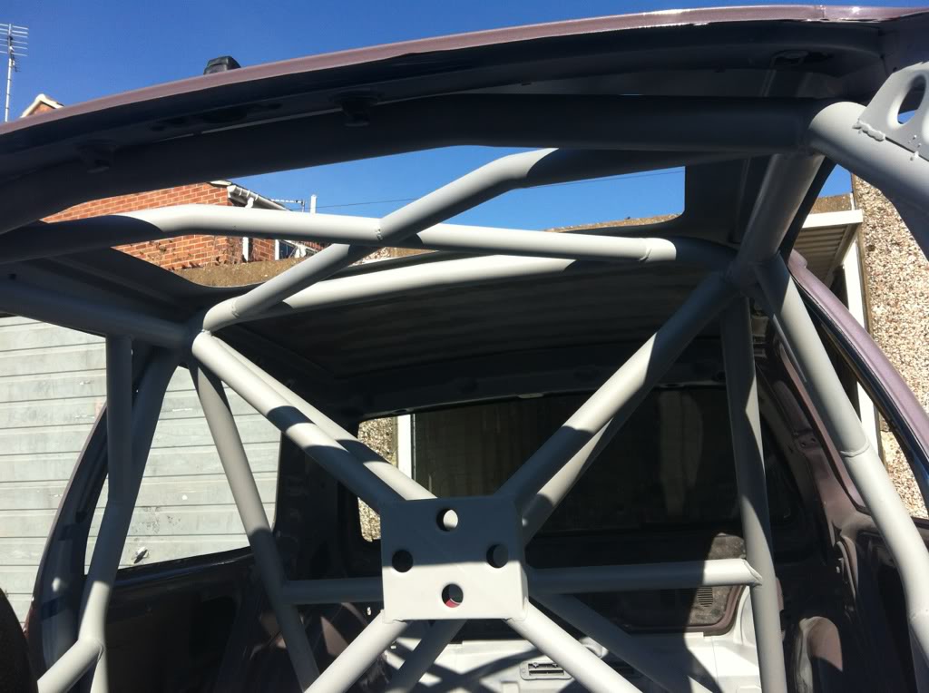

Paint arrived today, WOOP 727

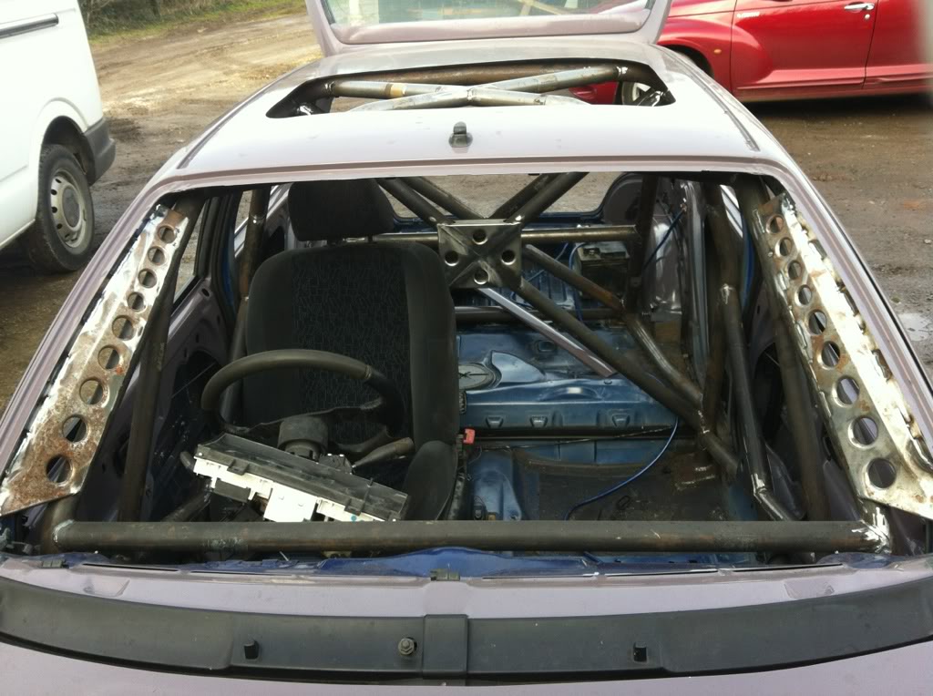

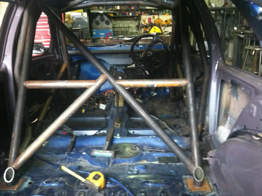

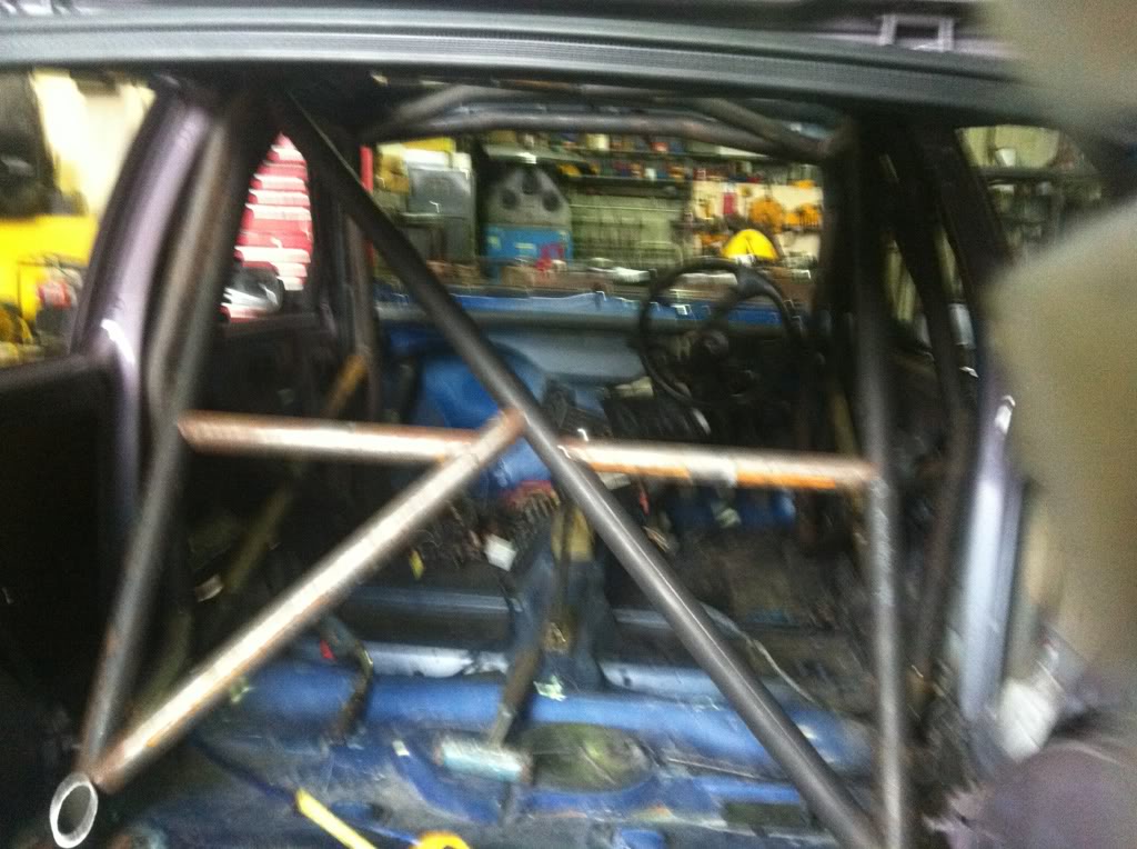

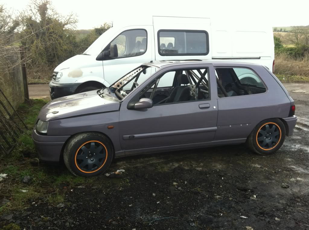

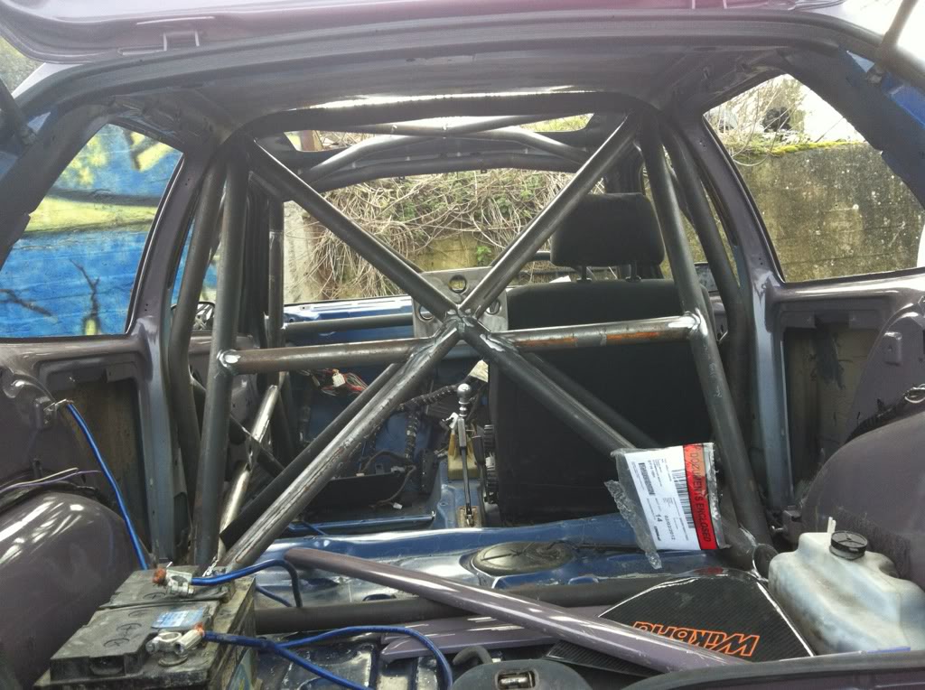

Started tacking cage in today will be finished Monday
Apologies for shite pics

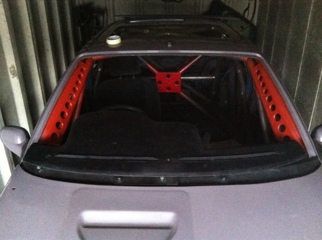

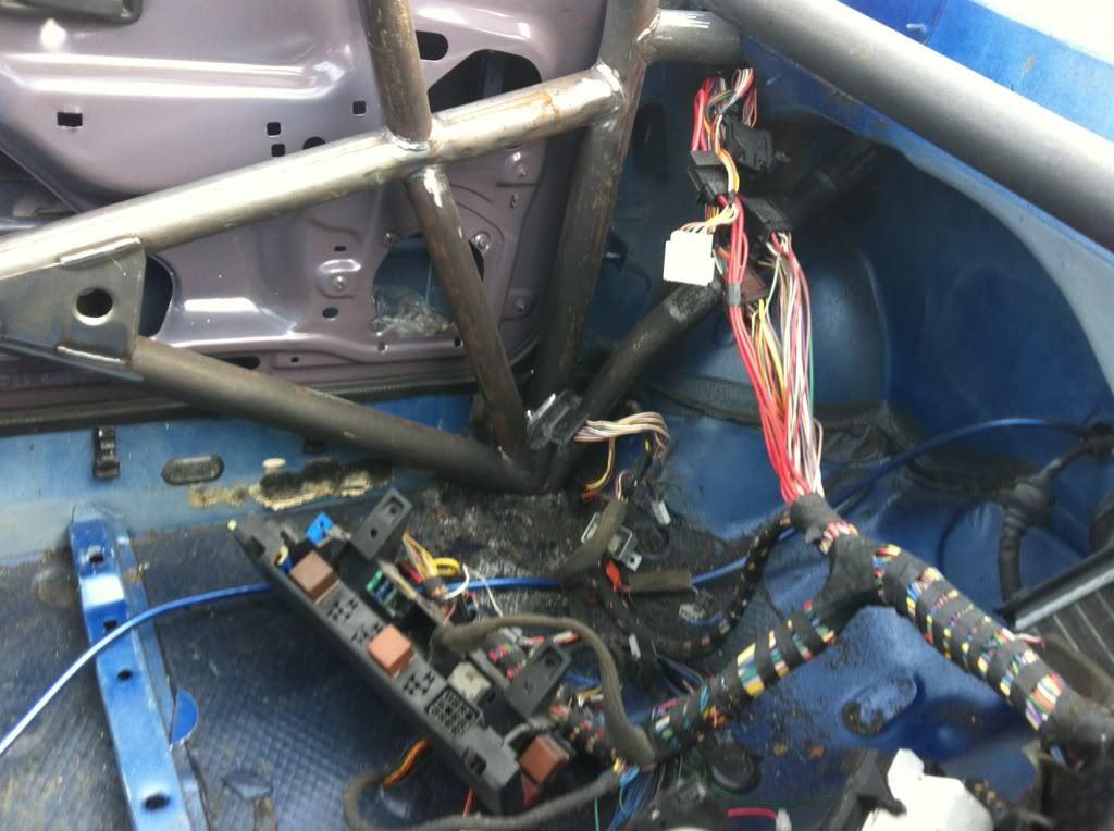

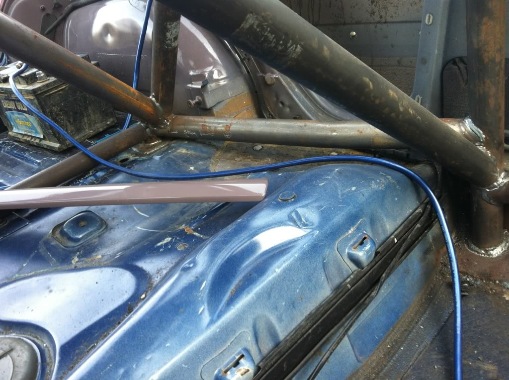

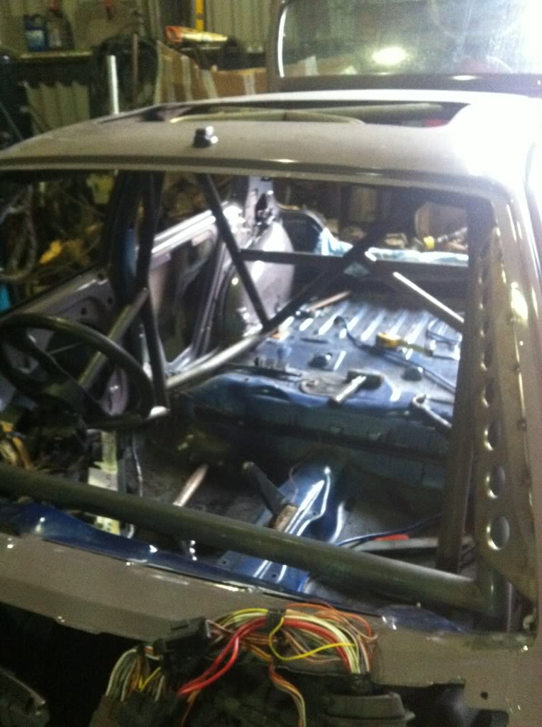

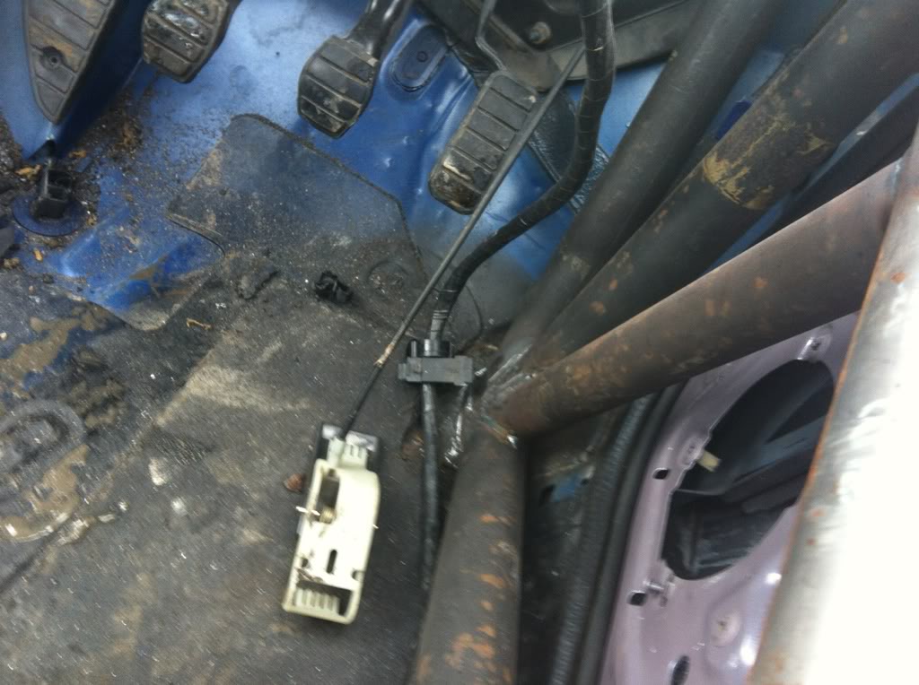

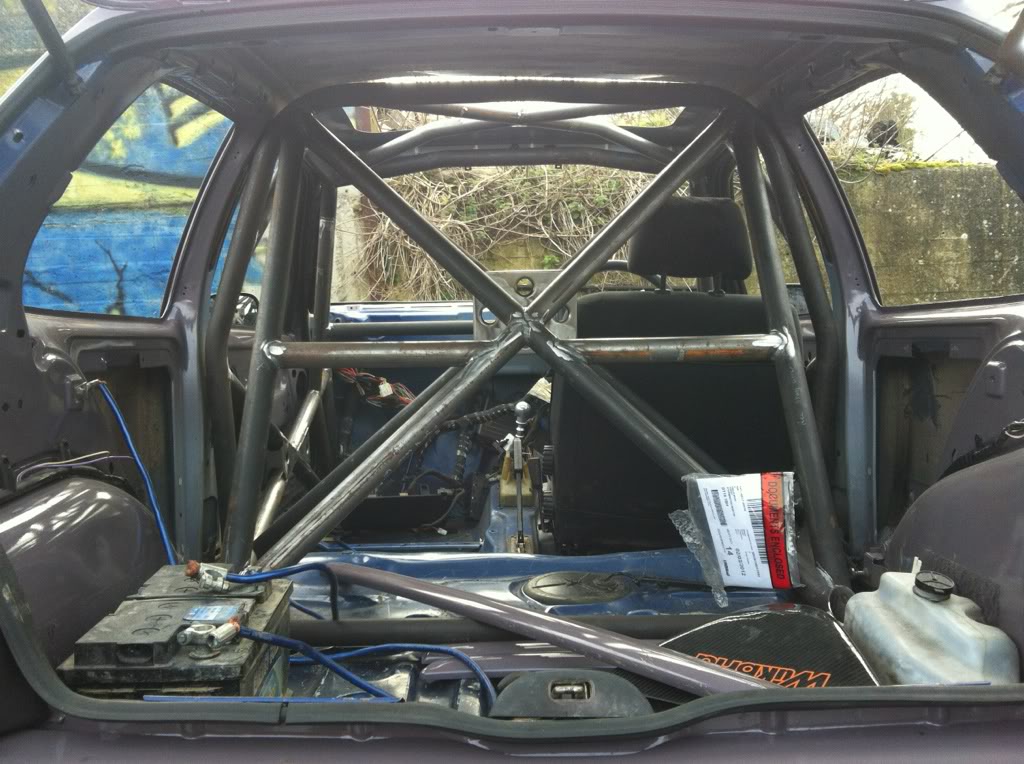

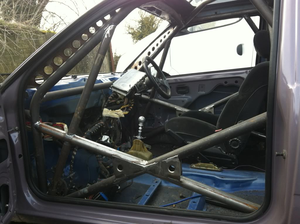

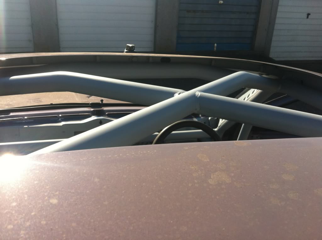

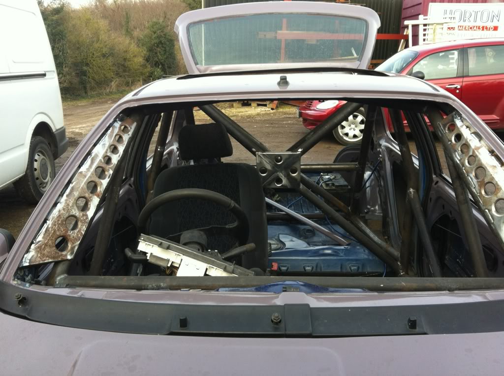

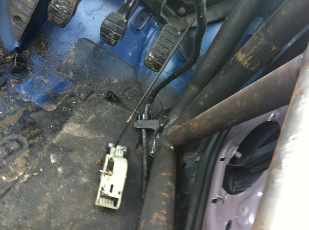

Rear of the cage has been attached to chassis rails

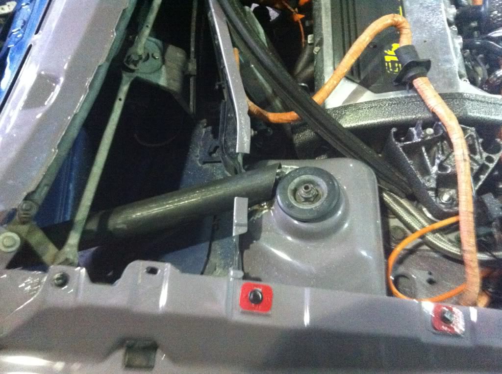

Had the front of cage welded to struts these are to be welded and capped yet

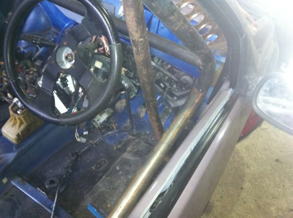

Small error... Lads had tacked the uprights the wrong side of the car lol easily sorted ....don't think I'd like to keep it like this lol
  182/RS2/ Turbo/Mk1
Just add one the other side as well, passenger is just as important as the driver when its going to have 2 seats, different story when there is only a driver.

That is just EPIC mate, really really awesome job I reckon.
TBH its complete overkill for anything I can imagine you doing with the car (unless you are entering the WRC? lol) but who cares when it looks that good!

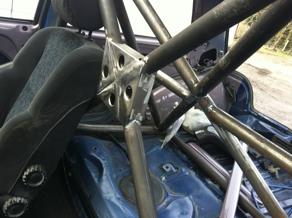

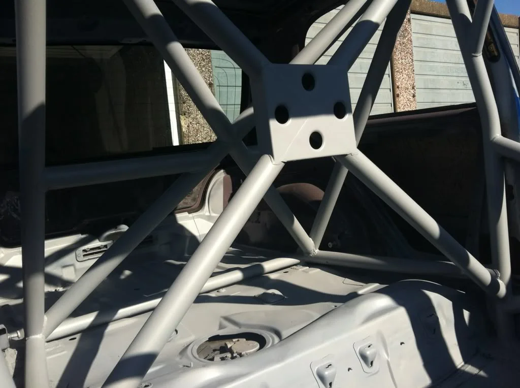

The cage is a custom cages cage and i know a very similar spec cage was fitted to icemans endurance 182 and he said he paid £3250? for supply fit and paint...

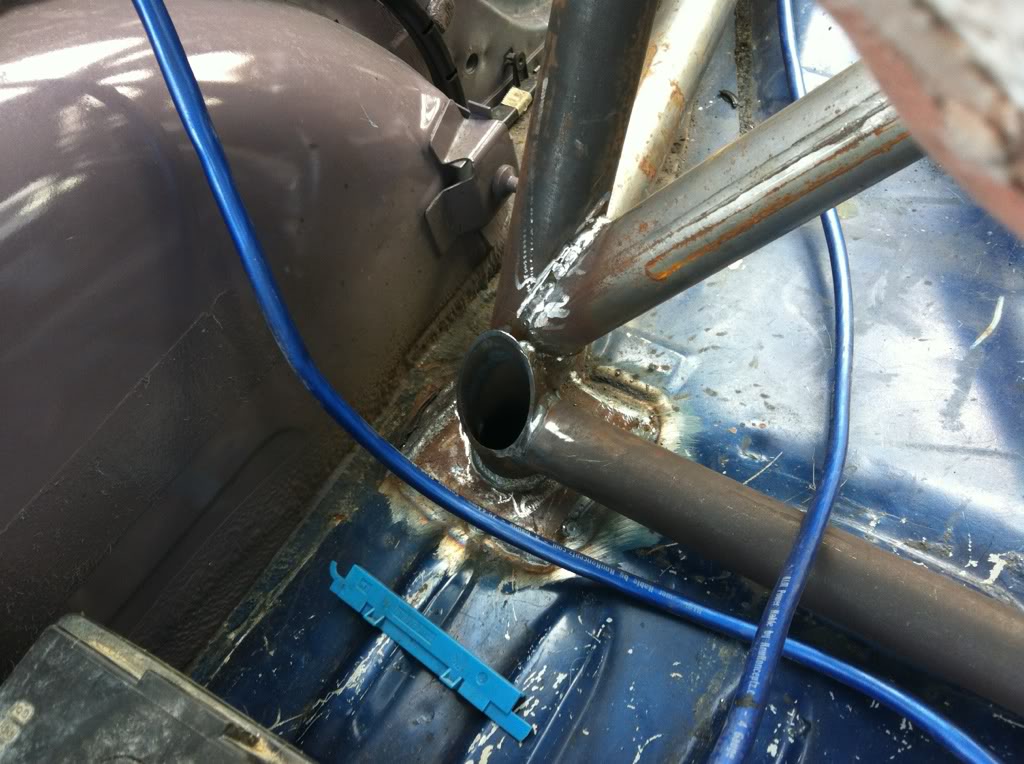

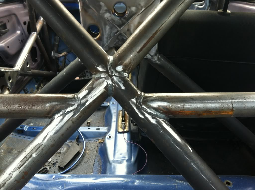

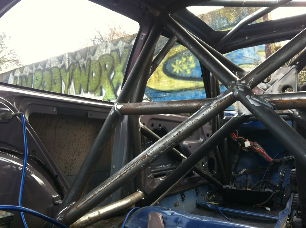

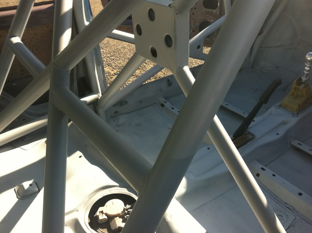

The cage is an 8 point ( i think) it has been welded to the front struts(2) and drivers foot well (2) rear of the foot well (2) and then sunk through the boot floor to the chassis rails ((2)....8points?)) which were also strengthened in the process. The uprights have also been slotted through the Door X to give me a bit more room.
Silent_scone i bought the cage for £450, got it fitted for about the same (£500 i wanted a few bits doing) and the lads that did it are local so cost me £20 to trailer it. (including rental of trailer) Still i think you will agree a hell of a lot less than £3250

RBS are the boys, they had on previously done things for banger racing in the past! But these guys know how to weld and that is what i wanted.. good welds.. good penetration into the cage, i dont want it going anywhere!

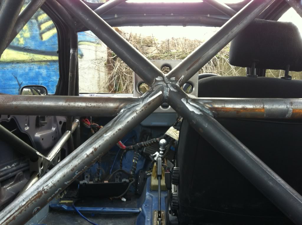

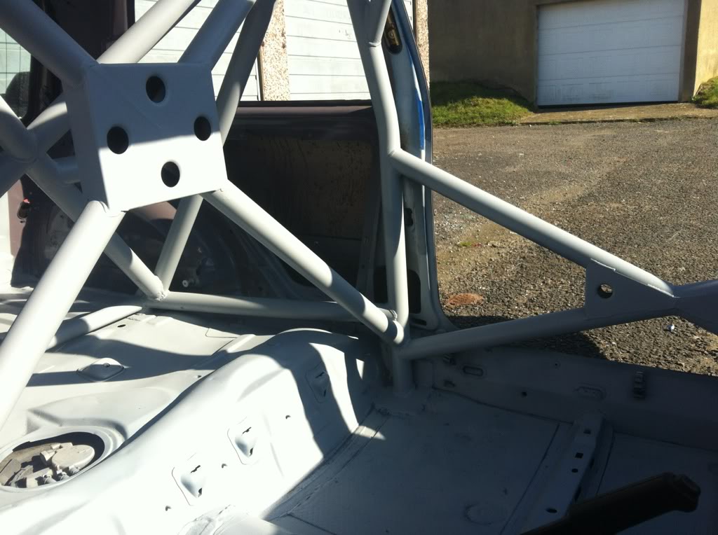

So im assuming i can use the rear part of the cage as a harness bar.. as it dossnt look like the cross in the front hoop is in the way.

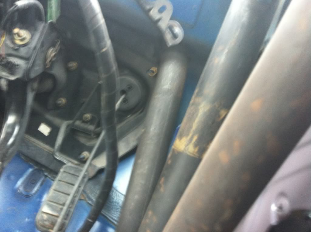

the dash is the next problem with that main bulkhead bar... its unlikly thats going to fit.

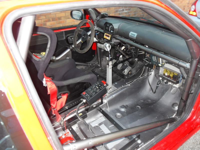

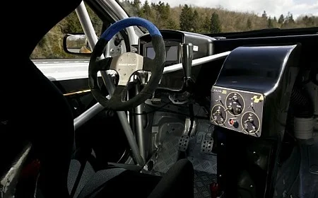

of course i would love somthing like they have on the cup cars.. but i think that is definatly out of my price range.
URL]
or even

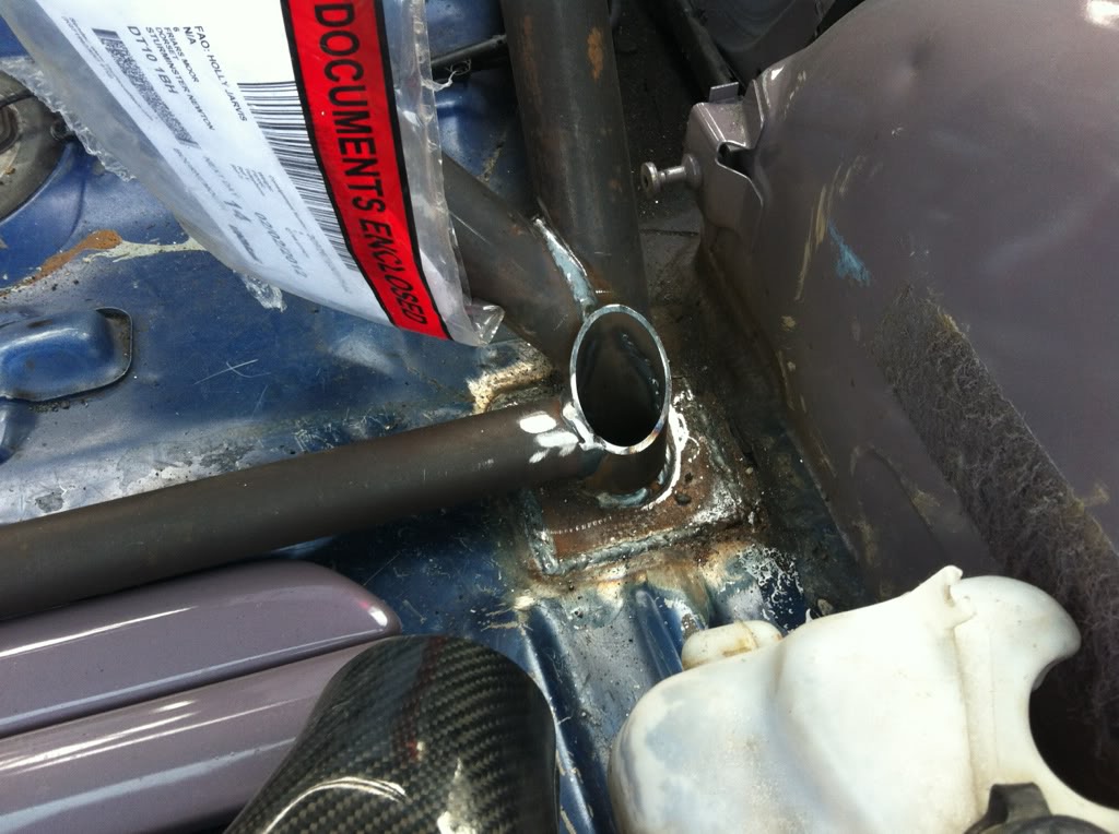

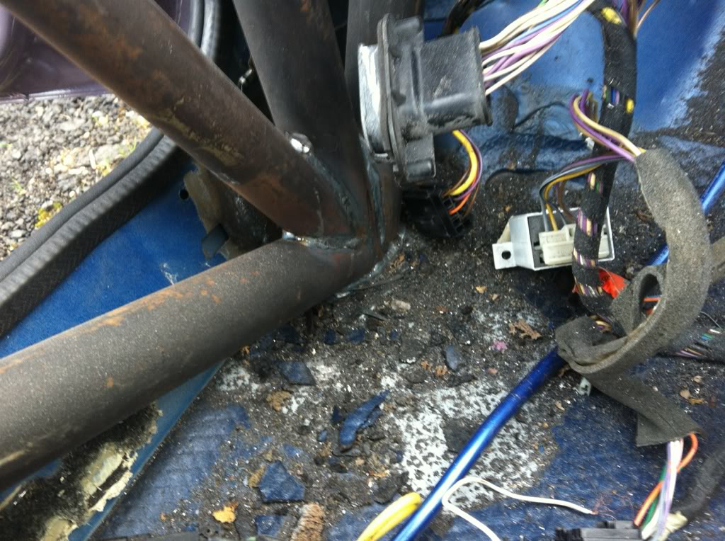

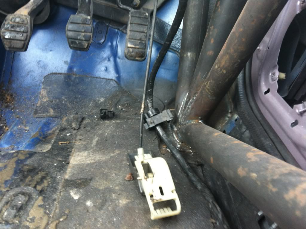

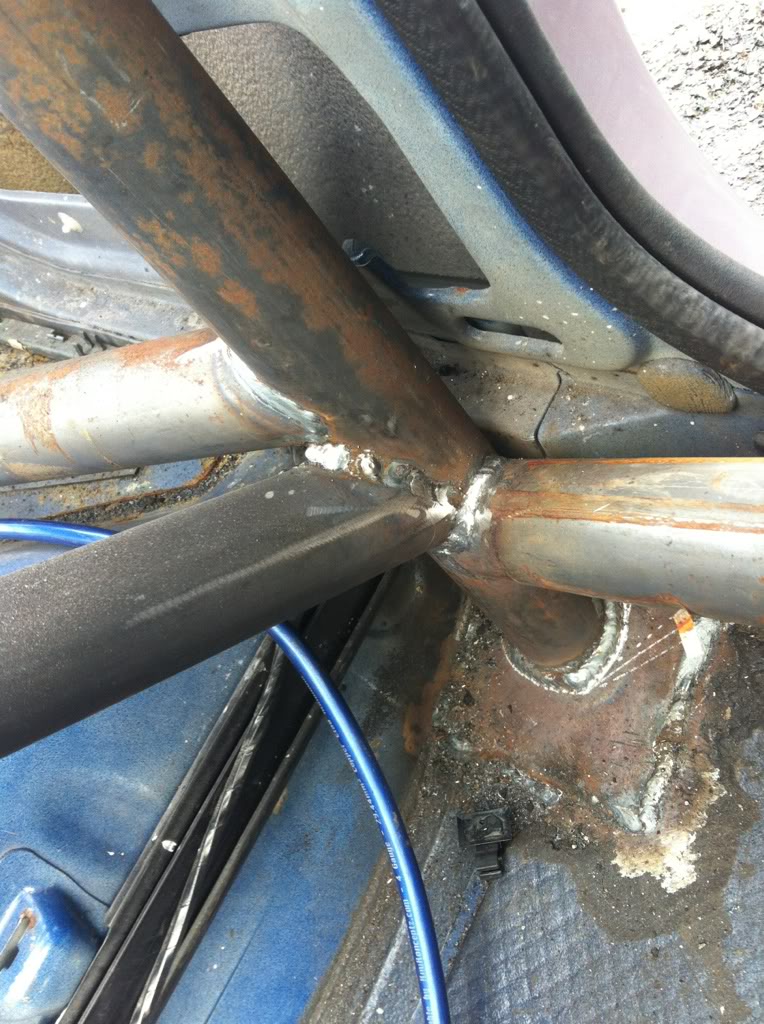

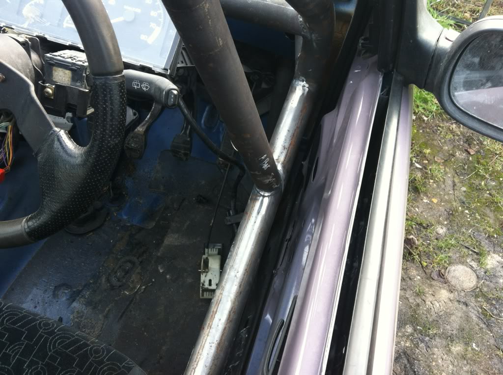

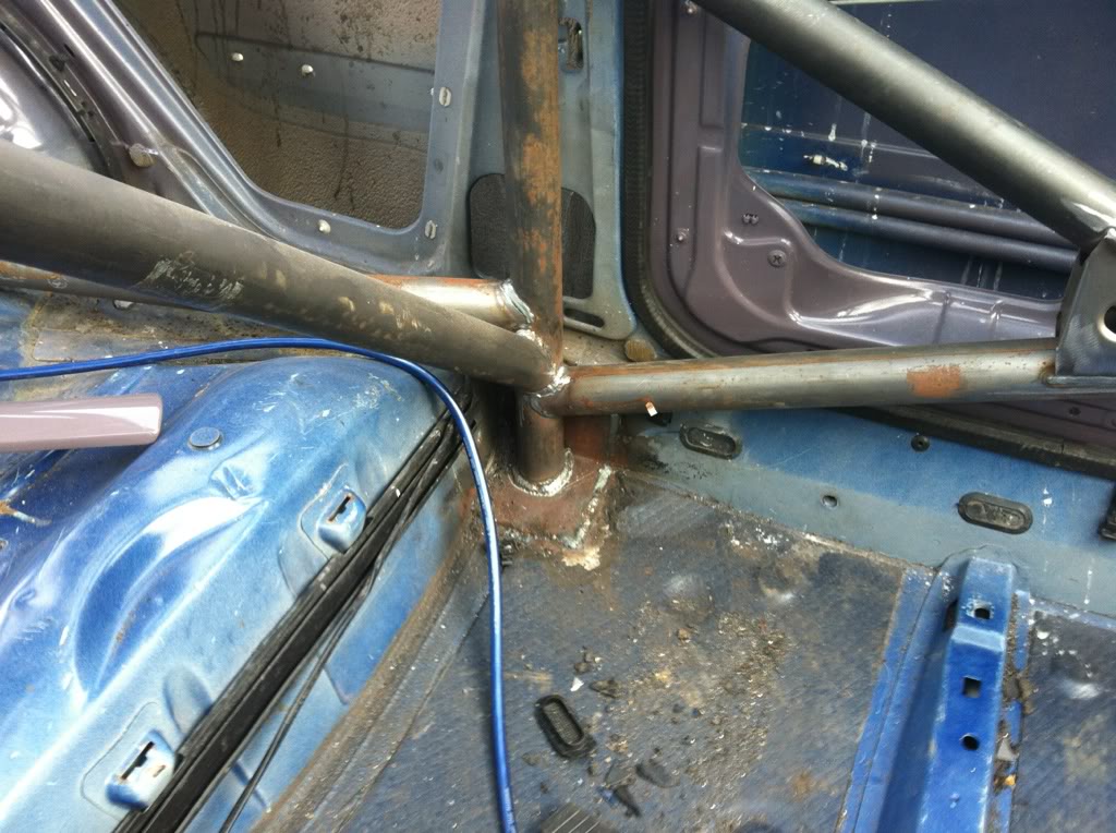

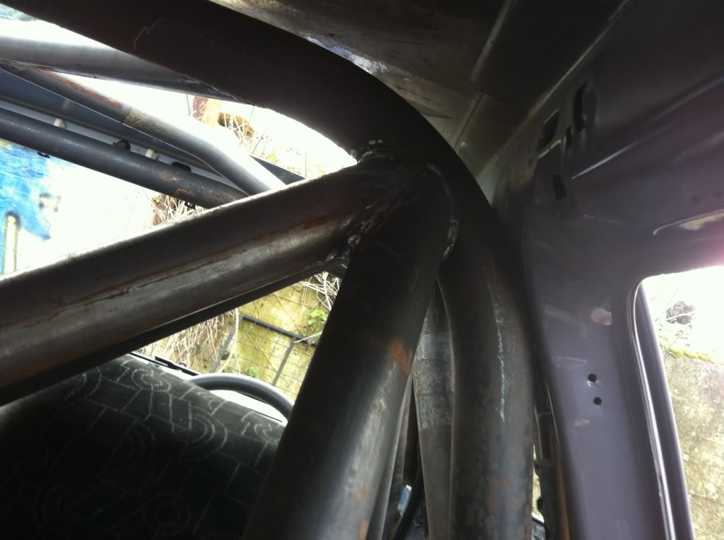

Fantastic project! Cage is awesome! Out of interest though, on the bottom of the hoop on the B-pillar, where the hoop welds to the plate on the floor, is it welded all the way around?
  Arctic Blue FF 182
yes i believe it is, plates were fitted before the cage.
Sorry, I meant the hoop tube welded all the way around onto the plate.

James yes it is said they swore alot doing it! Obviously some areas are harder to do so haven't been done as best they can, cage is only for track days, as I stated totally over the top but at the price I really can't complain lol

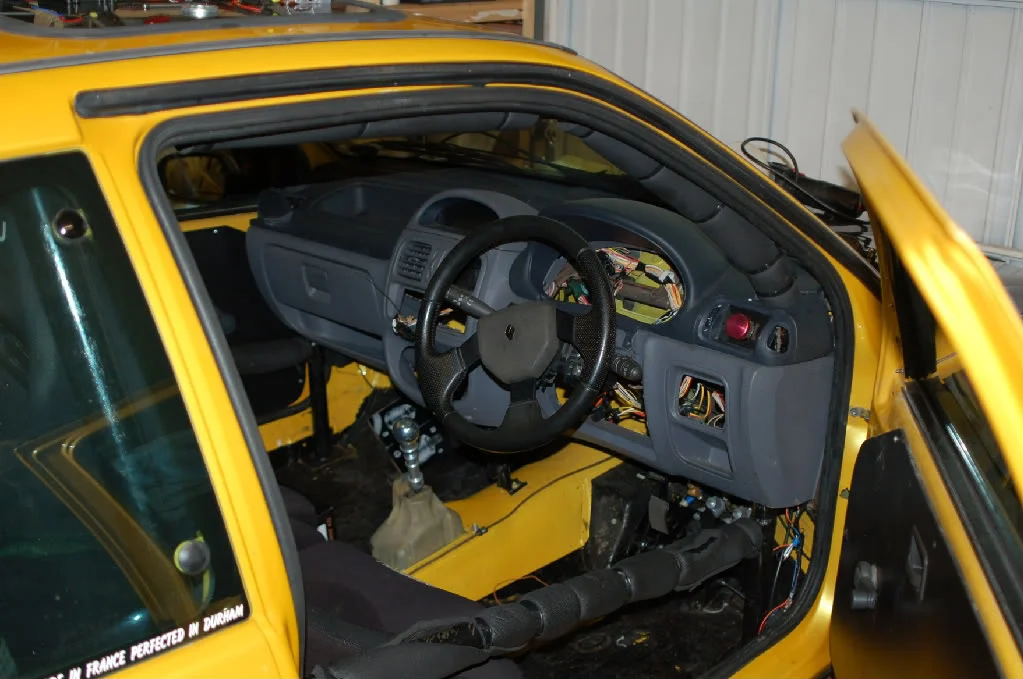

Chip cheers dude thought they were slightly too close to the front hoop X but actually they seem to be ok? Any suggestions about dash?

With the bulkhead bar being there it's going to make refutment of original dash awkward...any ideas?

Can you trip the dash to fit around the bulkhead bar, and then weld tabs onto the cage at the end to mount the dash?

If only going to be a circuit car and not really a road car anymore, no real need to have a dash as such, just make up some brackets for the display screen (dash2 iirc?) and dont bother with the rest is one option.
Or you could try cutting and shutting a later dash into it, like I have in mine (andyrg did the fitting before I bought the shell), as if you are going to be cutting it up anyway why go to that trouble just for a hideous mk1 dash?

Was gonna go dash2 when I go vag, cars been off road ages now just gonna try get her on the road again first

id just like a dash to neaten things up
That mk2 dash looks much better than I thought iit would!
does yours have a bulkhead bar?
  182/RS2/ Turbo/Mk1
Mine doesnt have a dash bar, but it looks like it might well clear your one anyway TBH
Nothing stopping you going dash2 now, or even for the emerald now as well on your current engine (although would need a meggy flywheel as it cant handle renix)

yeah think I will do that route but it's all expense another £1400 and I need windows yet lol
Might try poverty spec dash top see how that works
  182/RS2/ Turbo/Mk1
If doing the dash top, phase 1 mk2 dashtop would go in pretty easy I reckon, and you could easily make some brackets to go onto the dashbar to mount it off too.

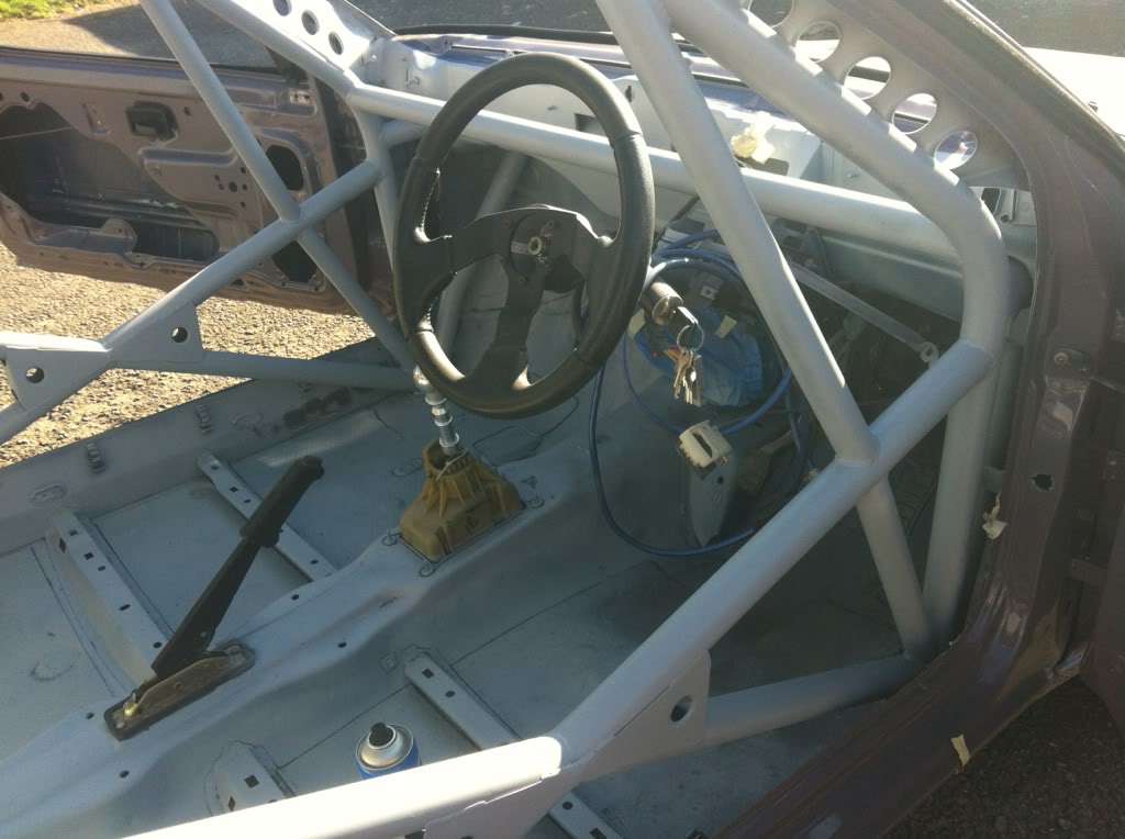

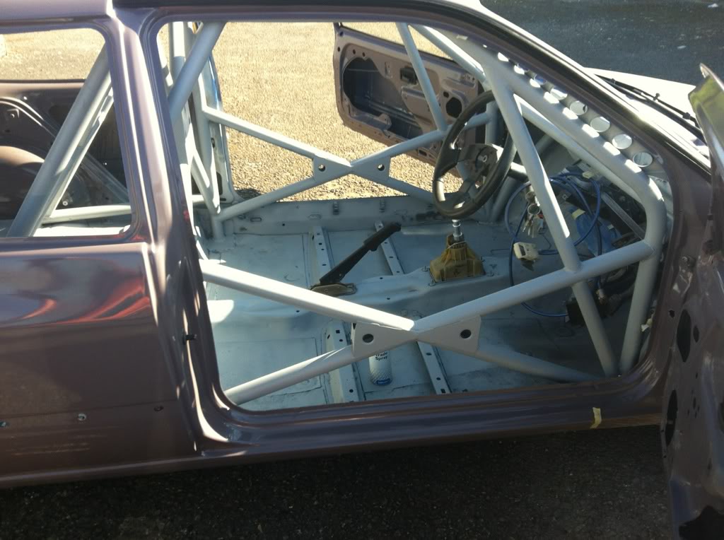

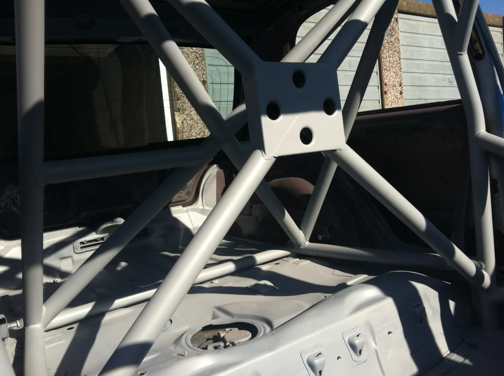

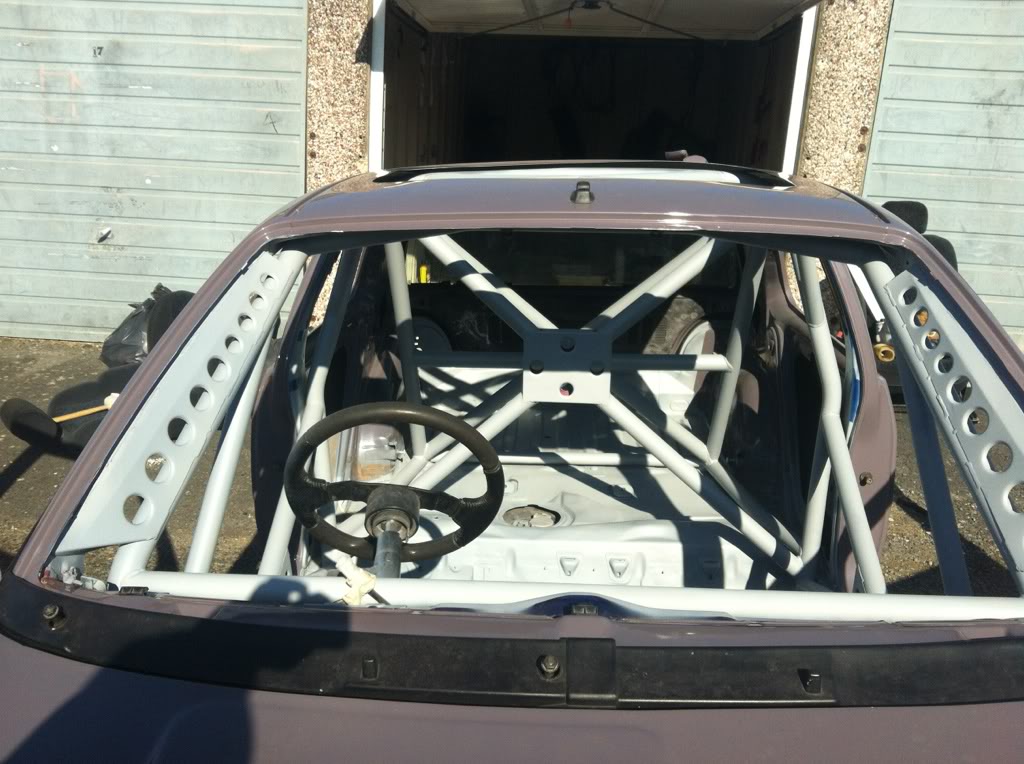

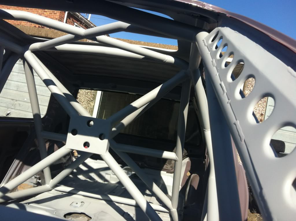

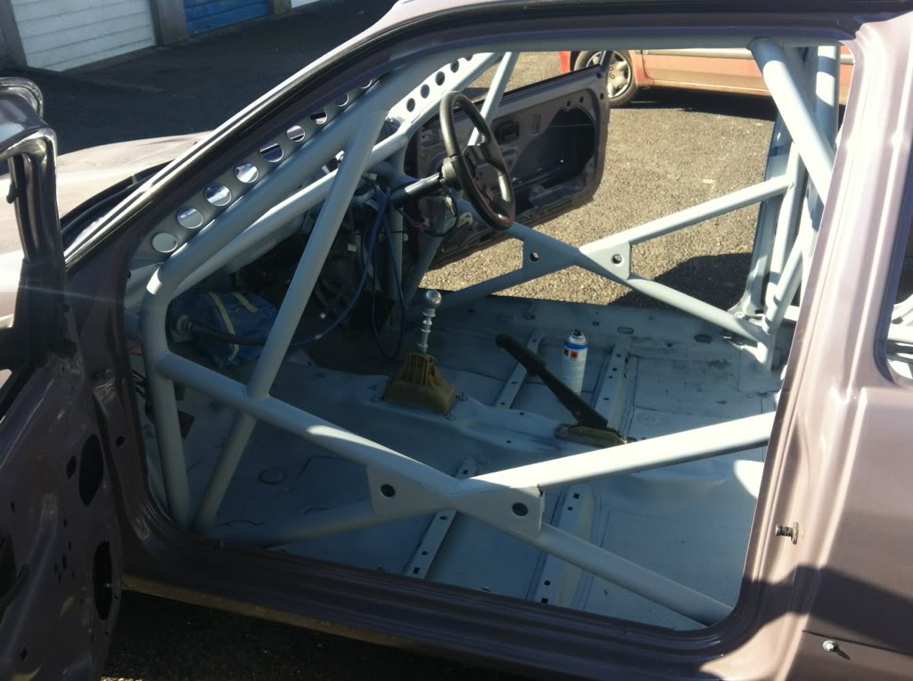

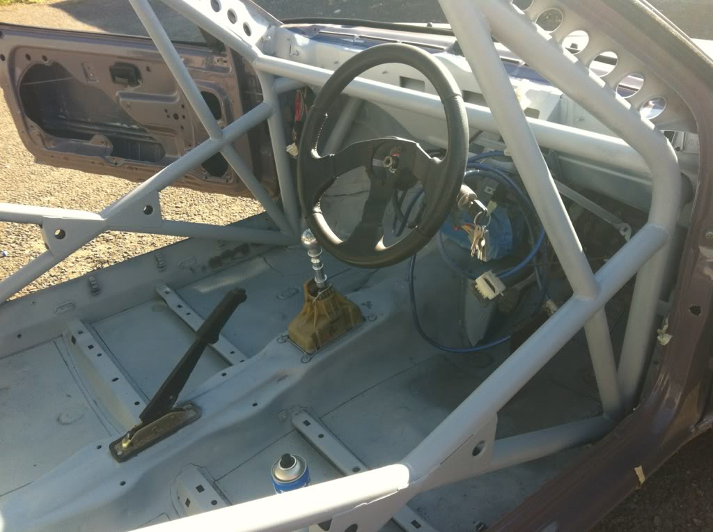

Ok little update not huge,
Got cracking on sanding the interior and cage then a wipe down with thinners. Then primer to stop it rusting:)
