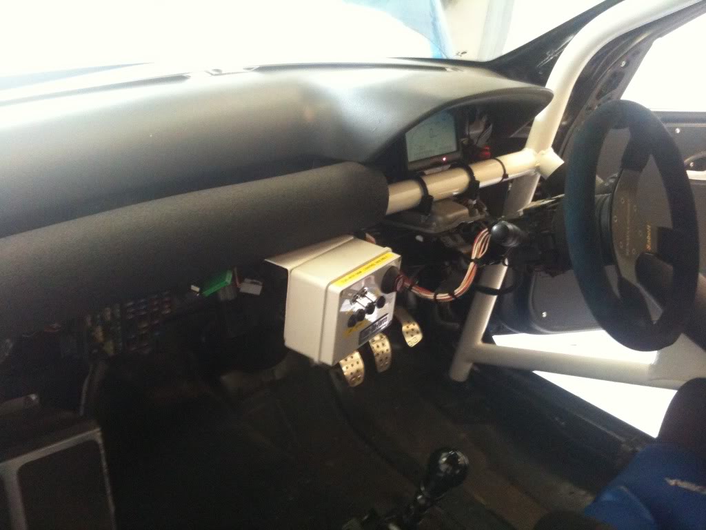

Cheers will look when i get a second! Going to be making a switchbox/centreconsole similar to the TMS E92 race car (below) will also help hide venting and heater matrix, out of fiberglass then get it flocked.

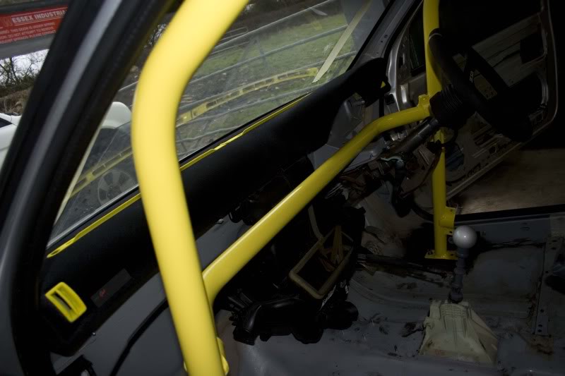

So got another dash in post £30..
Thanks to asdas finest value cornflakes
Used first dash as template
Then used new templates on new dash
Last pic dash has dropped but that will be ammended when I sort out a center panel

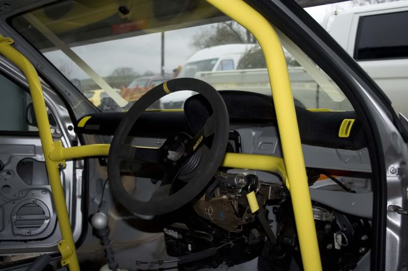

dash fits perfect between the cage!
tell me about it, id like to say i knew it would be like that...however it was sheer fluke!

So started the day early trial fitting new centre panel.
Fits OK needs more adjustment before I remake it out of fiberglass
Even though the dash isn’t fitted yet the dash fit is solid with new panel in!
