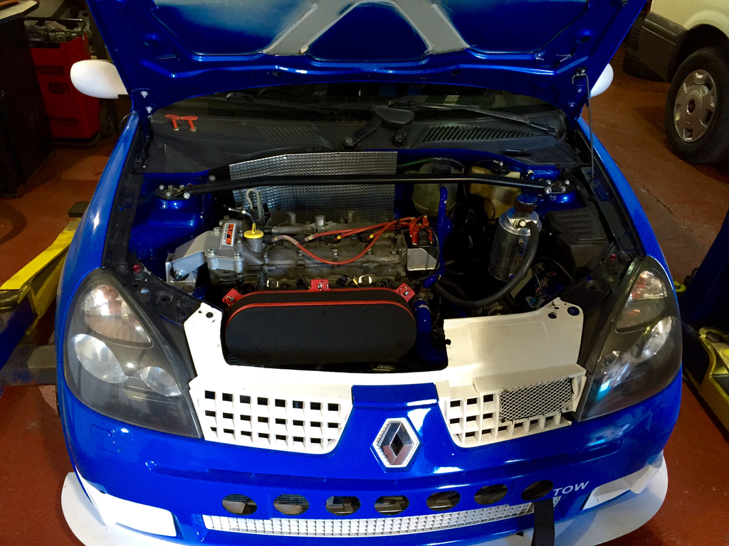

Some longer trumpets might help your torque no end, those Titans look really short. The 423s have a peak torque band from about 4.5-7k RPM so short trumpets won't gain you anything there.
  Renault Clio 172
I'll mention that to the chaps at RS tuning, and see what they say. It should get better with the Map anyway (I think)

A small update.
Cars finished (as if that ever happens) and ready for Cadwell on Thursday.
Tidied engine bay up a bit more, and cut down the front grill to get a bit more air in to the Throttle Bodies (can't see it'll make that much difference, as the bonnet sits in same place!). Also fixed the grill on a bit better, as it's always been a bit loose. I know have to take the bumper off to get it on trailer, so it's only been getting worse.

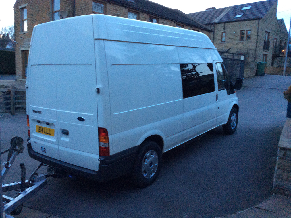

Also tidied the van up a bit. I'll put a picture on later. Unfortunaty I let the wife drive the van to Howarth, and she misjudged a wall and smashed one of the sides! Rest of it is spot on though:)

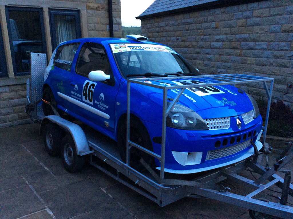

Cars all loaded up for tomorrow.
Also built a wheel rack on the front of the trailer. It's a bit low, so will make it taller next week.
Also, the vans looking nice and clean. Go faster stripes removed and fully T Cut.
Then the other side isn't so good....
Note to self.... Don't let her indoors drive!

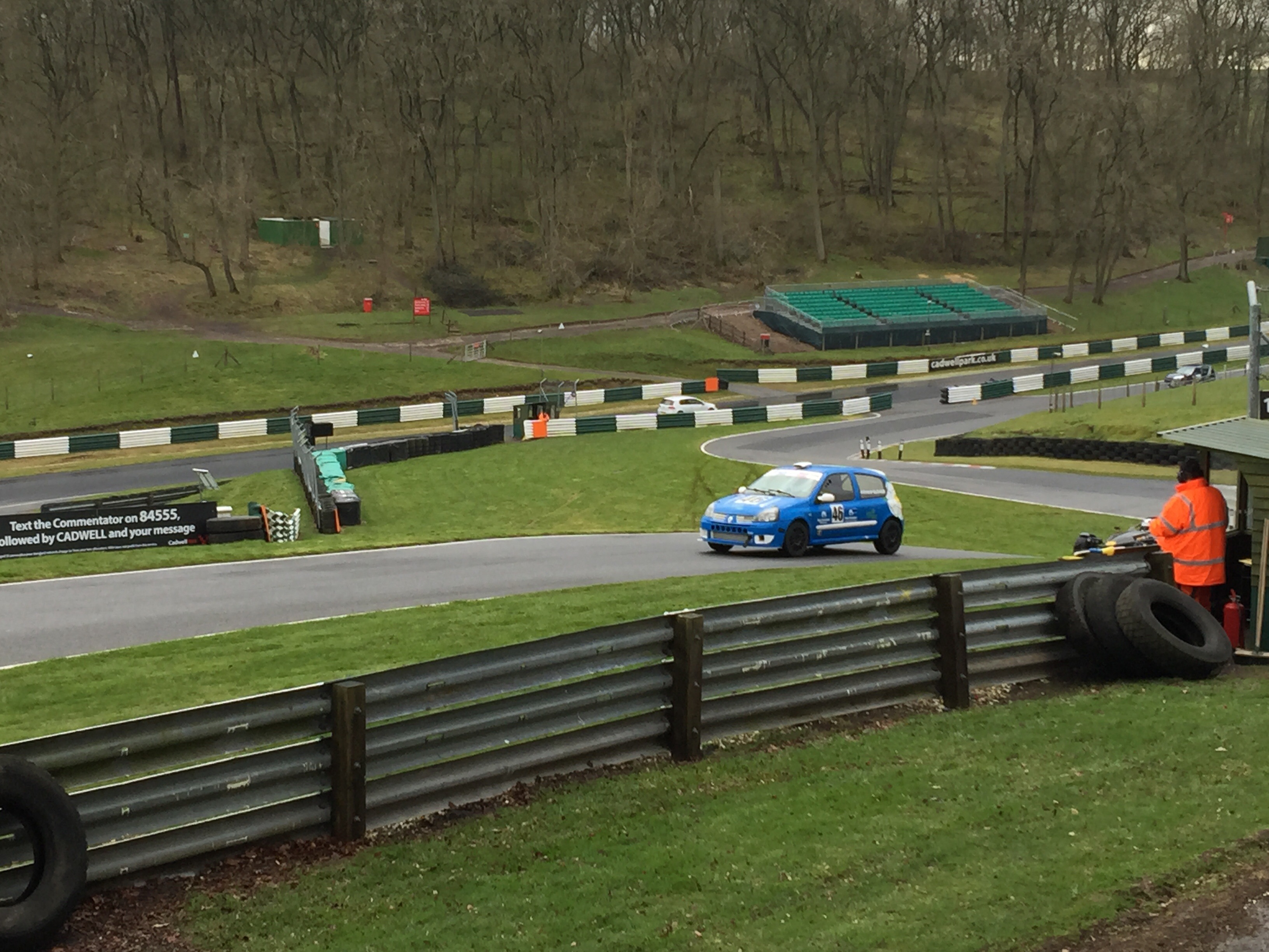

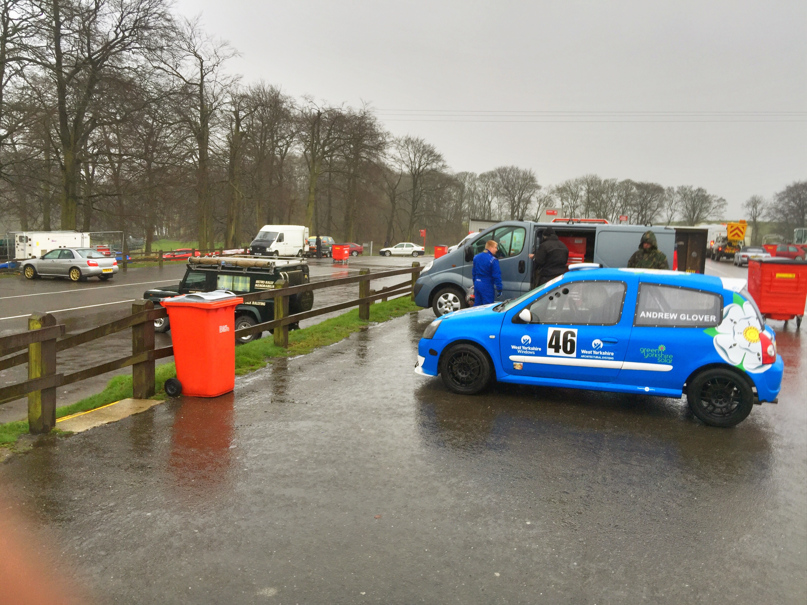

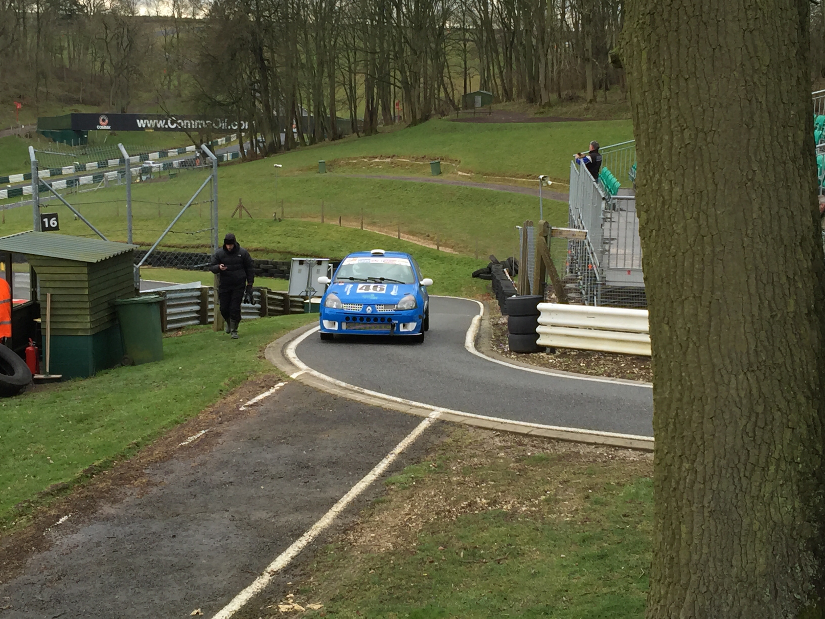

Was an awesome day at Cadwell with @Apg100 amd miraculously dried out in the afternoon even though it was almost torrential rain en route.
Andrew drove really and and has got huge potential and the car drives really well and looks great.
Just a few snaps I took...
