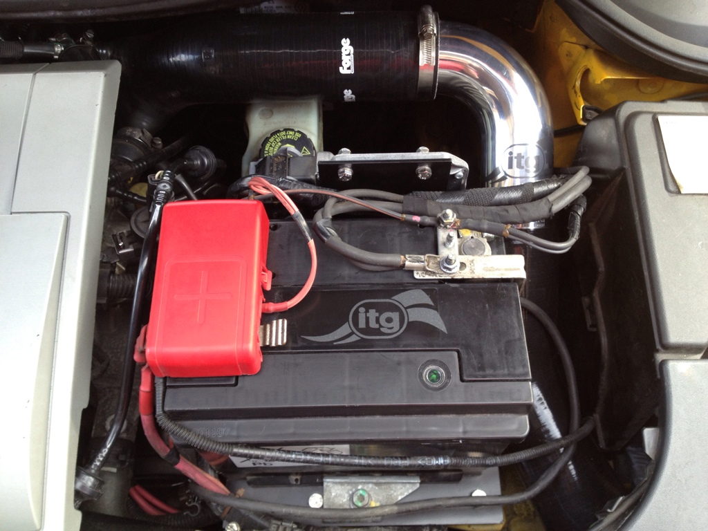

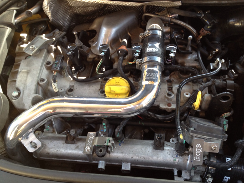

Last September I fitted the ITG induction kit, Forge hardpipes and 630cc injectors.
Unfortunately when up at RS Tuning having it mapped Paul discovered that the turbo was damaged so only made 256bhp when I was hoping for 285bhp+ :dapprove:

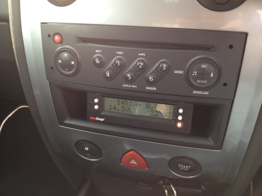

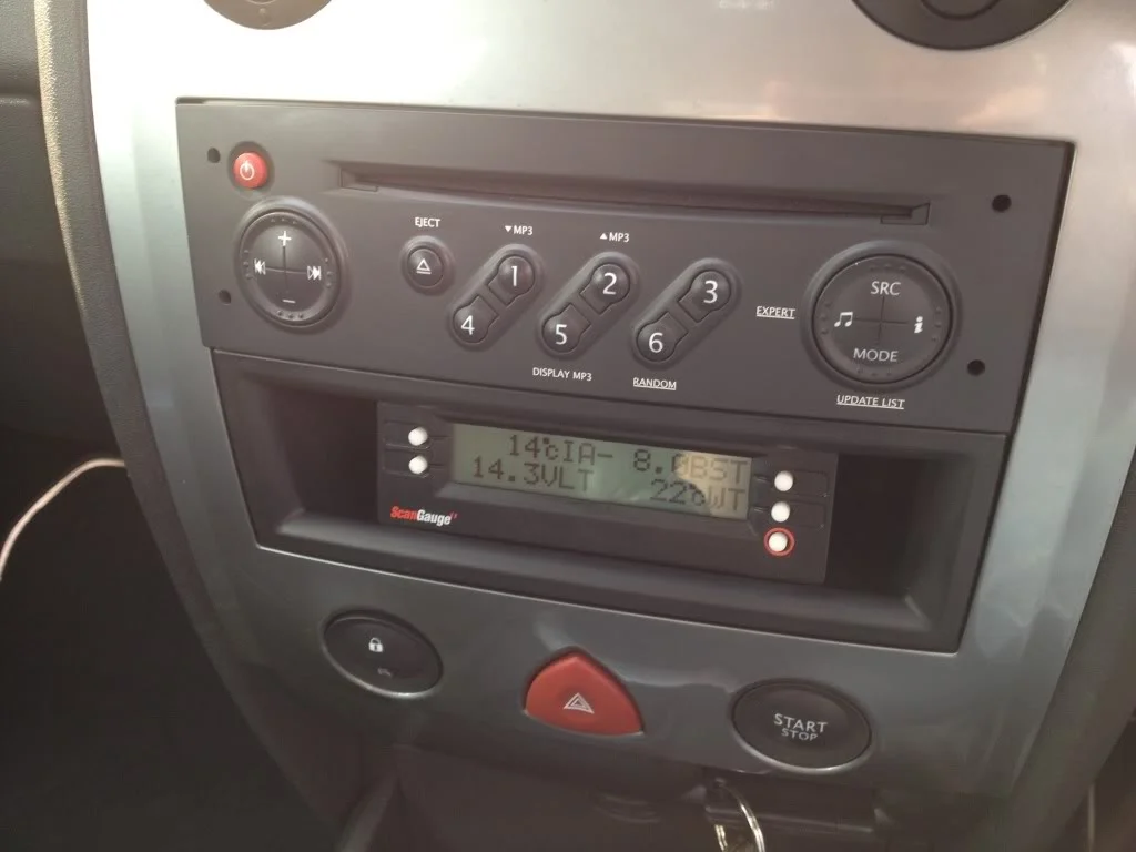

Fitted a Scanguage a few months ago.

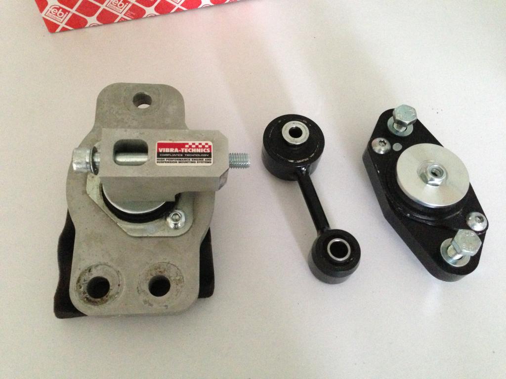

Picked up a set of Vibratechnic engine mounts for £165 on Sunday morning.
Loved them on my 172 so hopefully they'll tighten up the steering and throttle response on my R26 as well.

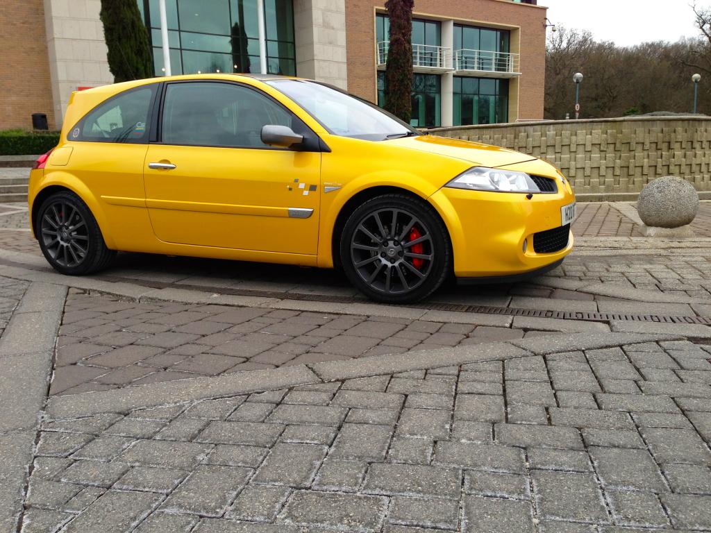

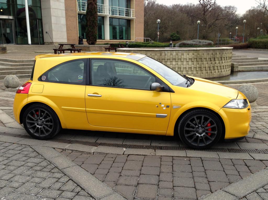

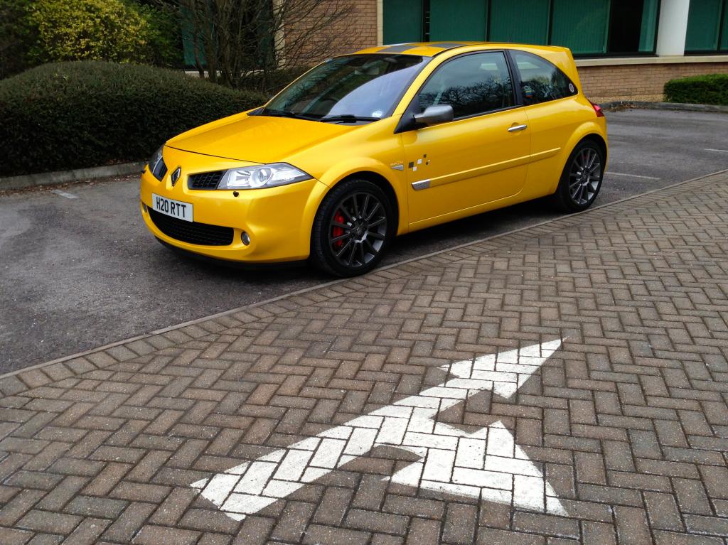

Washed it on Sunday and took a few pics on a business park nearby.

Be careful running those Vibratechnic mounts, I've read a few horror stories about them on meganes....
But the rest of the plans sound excellent!
Top engine mount bolt shearing? I'll keep the rear stabiliser bar.

Yep, I've also seen one that has sheared the top mount / upper timing belt cover.
Do you know if they were using just the engine mount and not the stabiliser bar?

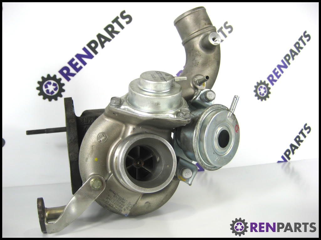

It's just shy of 71k and 5 1/2 years old now so the cambelt is due in 1000 miles. I still haven't fixed the turbo and engine mainly due to a lack of time and availability of the rods and pistons. Trouble is we don't know if my engine will need a rebore so can't order the parts until that is determined and the supplier has never had the rods and both standard and oversized pistons on the shelf at same time.
I'm off to Le Mans next month so plan now is to fit this turbo I've bought of Renparts, get the cambelt done and hopefully take the head off to see what the bores are like. Then I'll send my current damaged turbo off to be hybrid'd and order the rods and pistons I need.
It's not the cheapest way of doing things but as I use my R26 every day it'll minimise time it's off the road. At least it'll be ready for Le Mans and making 280bhp plus instead of the 256bhp or less it is now.

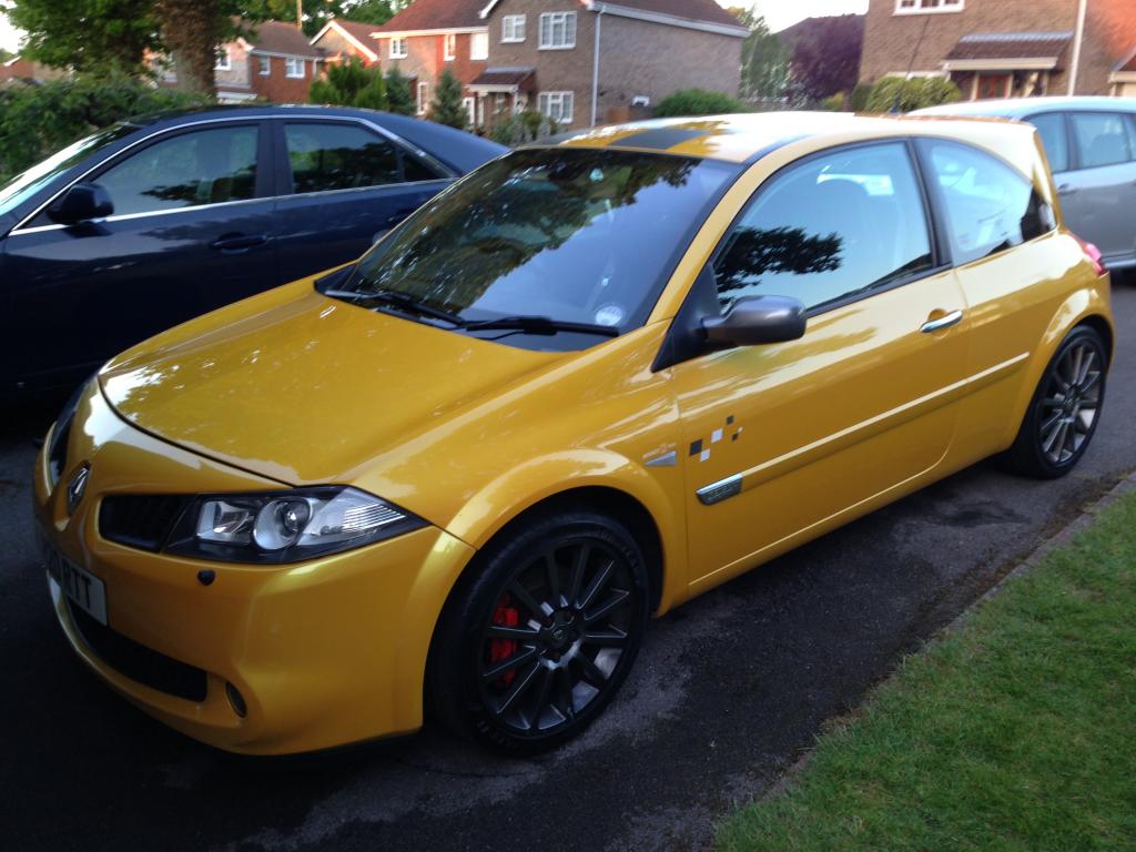

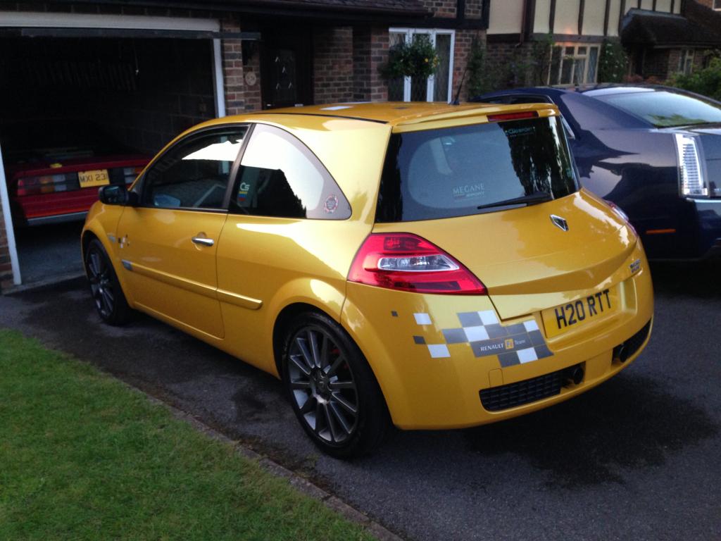

I went round Paul's (Gorms) a couple of weekends ago to get it washed properly for once. There was tons of tar so think he ended up most of a bottle of Tardis neat to clear it :eek:

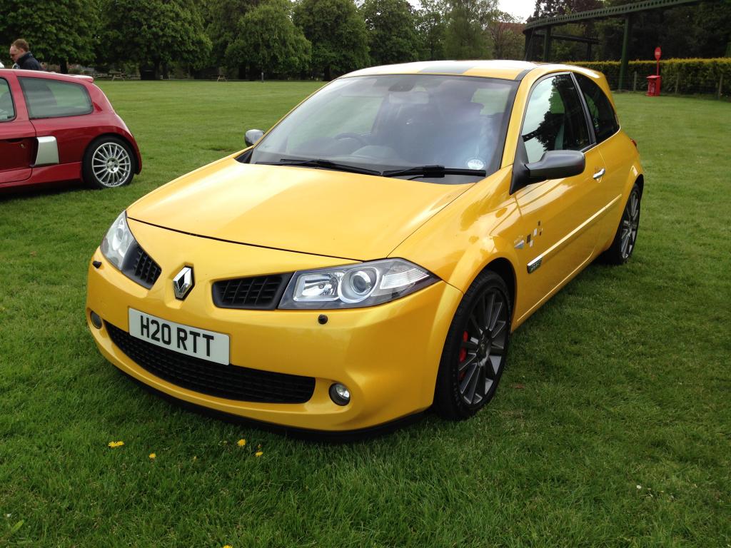

Then as we were off to Beaulieu the next day I borrowed Paul's Werkstat Acrylic kit, used my DA to polish in the Werkstat Prime then a couple of layers of the Jett Trigger sealant by hand.

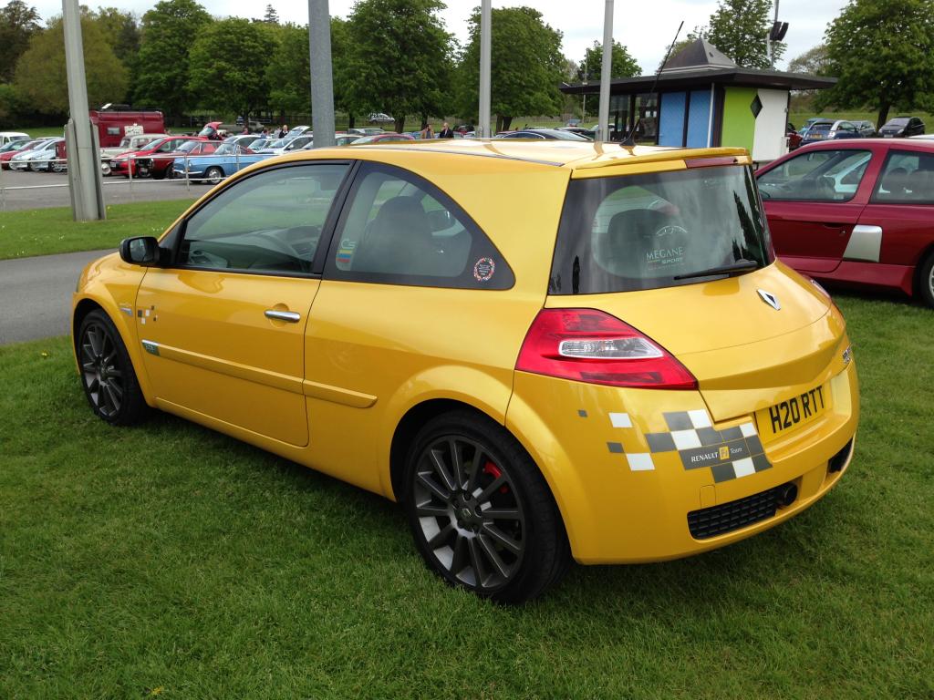

Some photos from Simply French at Beaulieu
I don't think it's ever looked so clean at a meet so thanks for your help Paul :)

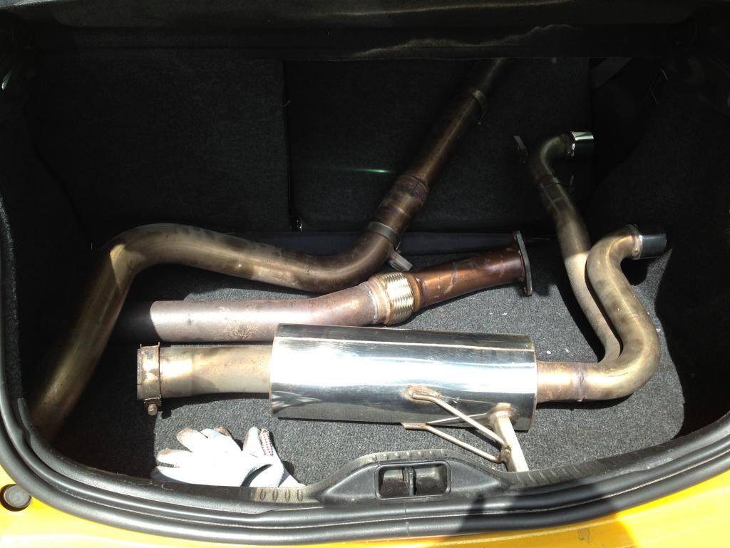

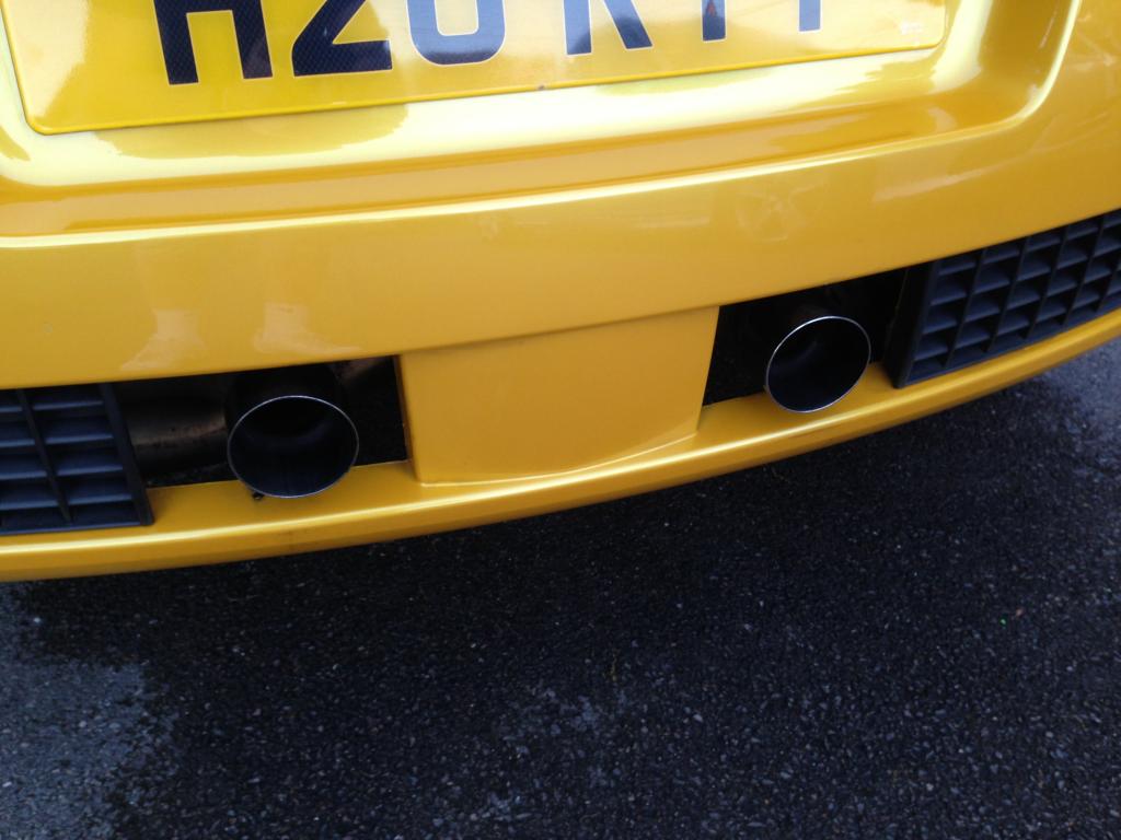

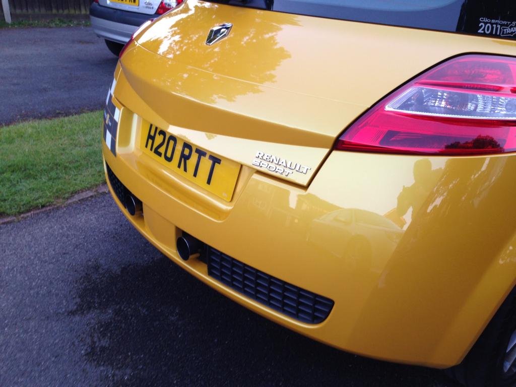

Last week I bought a Ktec 3" exhaust from a Meganesport member in Bracknell and got it fitted on Saturday for £30 at Merityre in Hook.
It looks and sounds much better now. Impressed by the system as it seems well made and the exhaust has nice growl when making progress but as quiet as standard when cruising along.

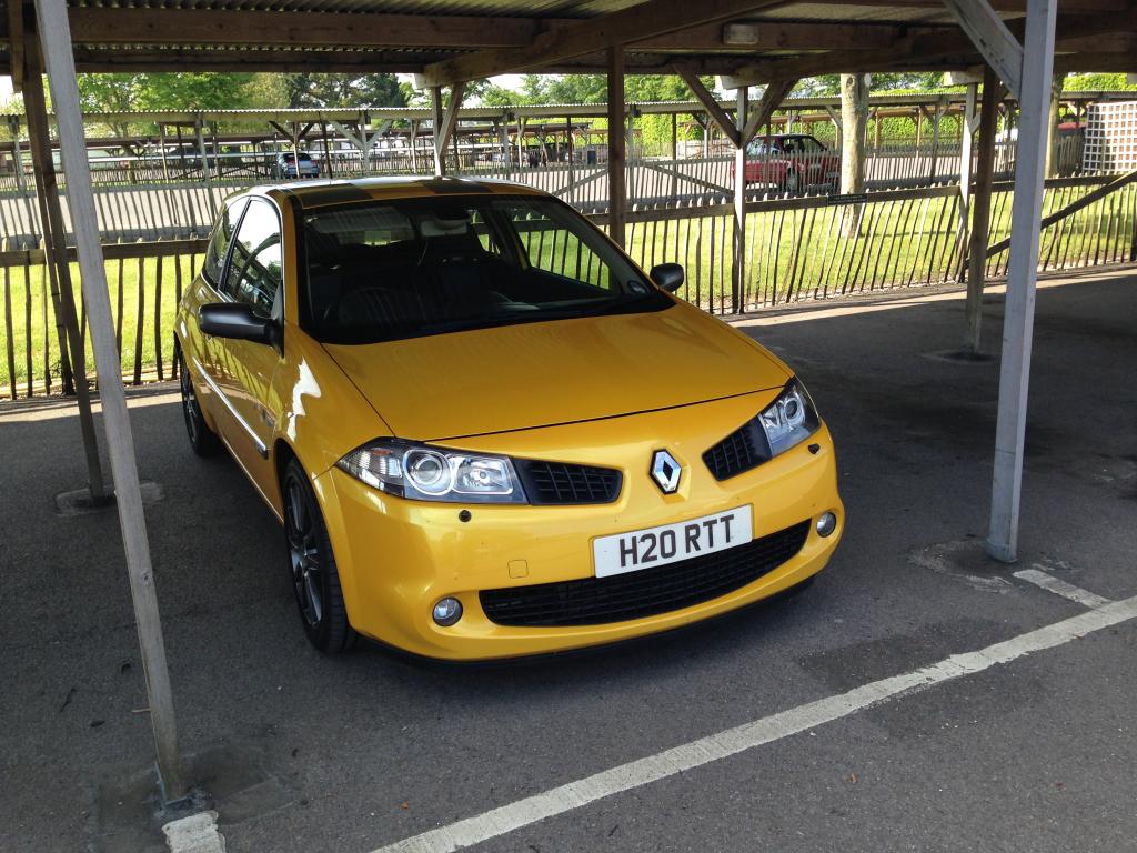

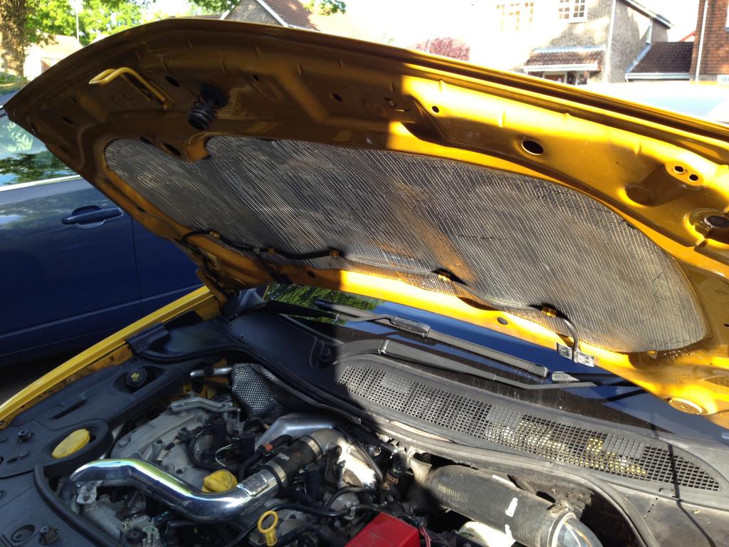

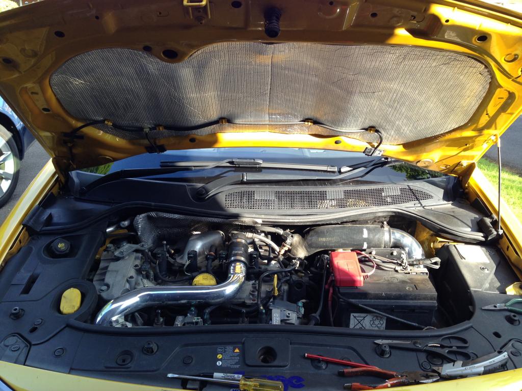

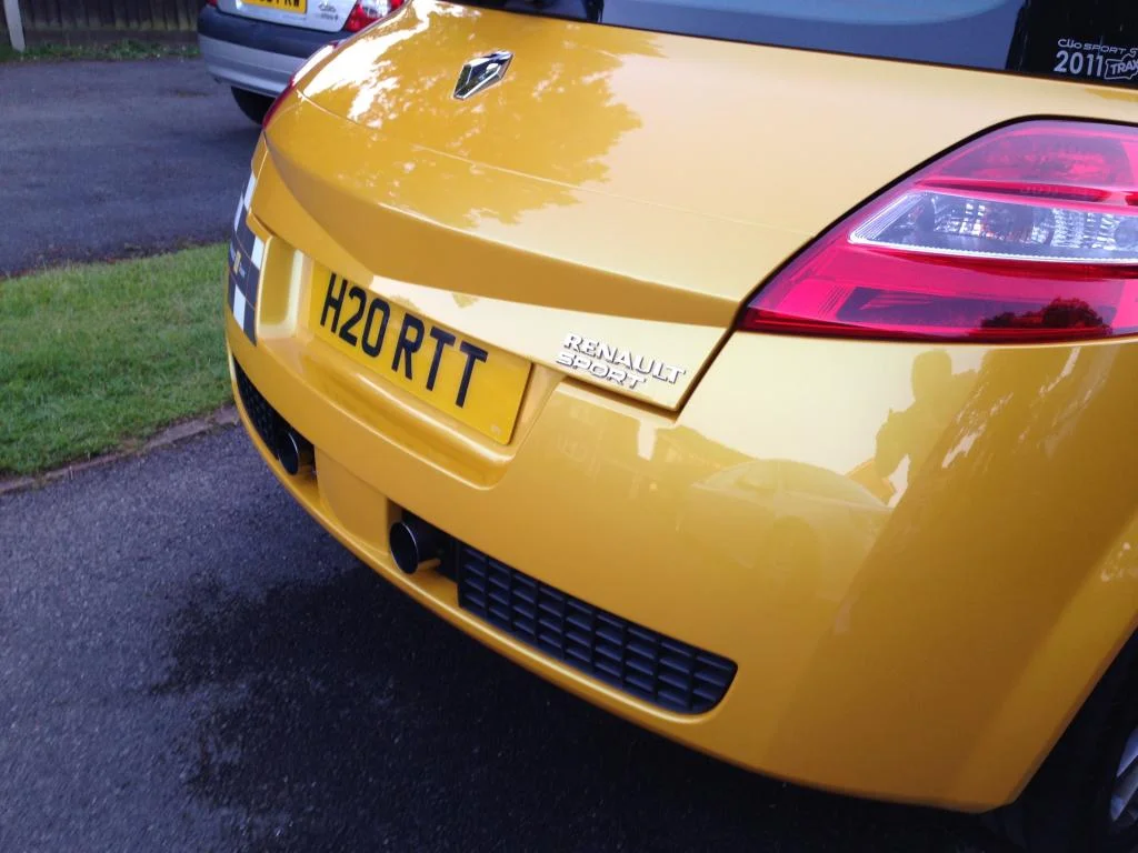

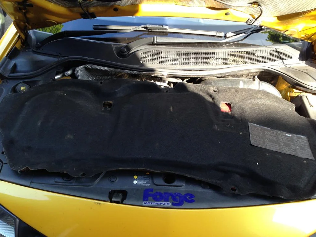

After getting the exhaust fitted and going for a spirited drive I spent Saturday afternoon tidying up the engine bay. The bonnet car was sagging, dirty and a trap for leaves so decided to replace it with aluminium heatshield.
Then on Sunday I gave it a wash and topped up the Werkstat with a couple of layers of Banana Armour as i was off to Goodwood to watch Chris on Monday and I don't want Paul's hard work to go to waste lol.
So that's it up to now.

Also, would be interested to see what you think of the engine mounts mate. I've been warned to leave them and get standards, but curiosity is getting the better of me.
Wanted to fit them since buying the car as they transformed my Clio too!
