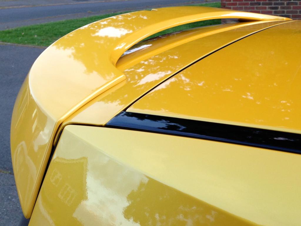

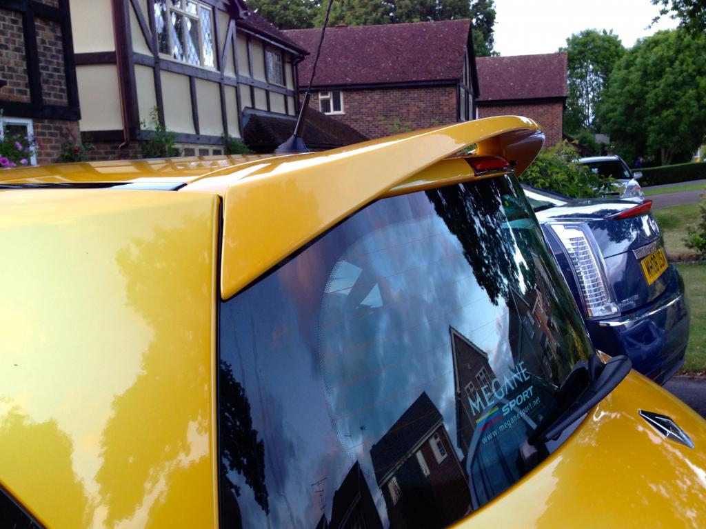

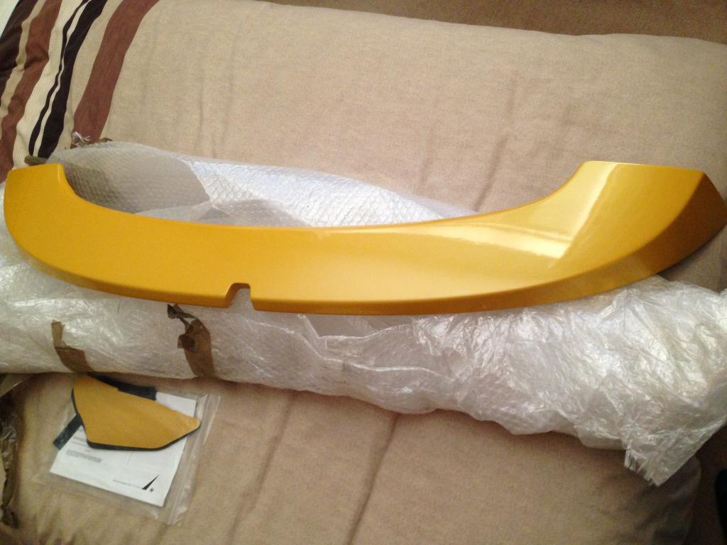

I managed to pick up a brand new liquid yellow R26r spoiler and fitting kit. It's been professionally painted and looks a very good colour match having offered it up to the car.
I've got a few days off this week so hopefully I'll have it fitted by the weekend :)
Now I need some new wheels but can't decide between another set of anthracite R26 alloys or black R26.r alloys. I'm not sure if black wheels would look as good.

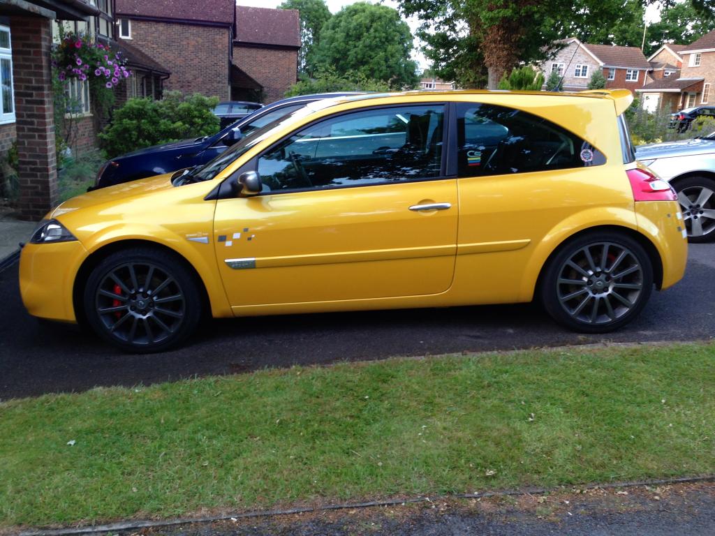

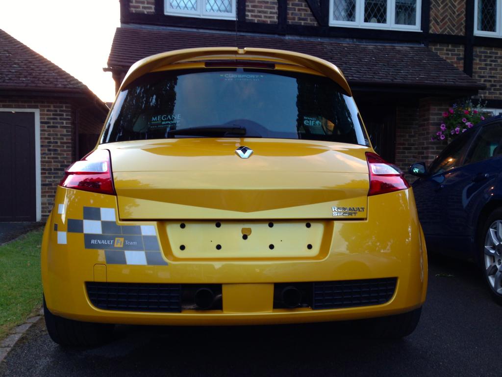

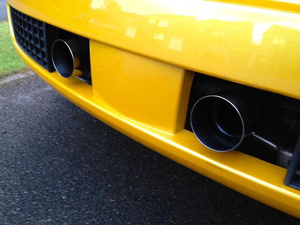

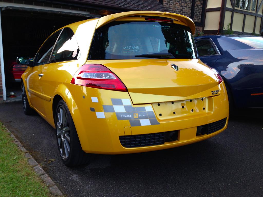

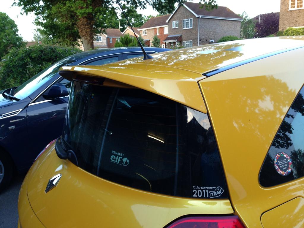

Some better pics of the R26r spoiler and Ktec 3" exhaust.

I really can't decide if I like .R spoilers they look great from the back but I don't know the 3/4 shots make them look weird!
Re: Tim's R26 Banana Boost Bus
I think it's a big improvement on the standard lip spoiler.
Looking great Tim. Think the .R spoilers really suit the back of the Meganes.
Cheers Chris.
Very nice indeed! Keep looking at these on PH..
Buy one! I haven't missed my 172 at all, the R26 is a much better car.

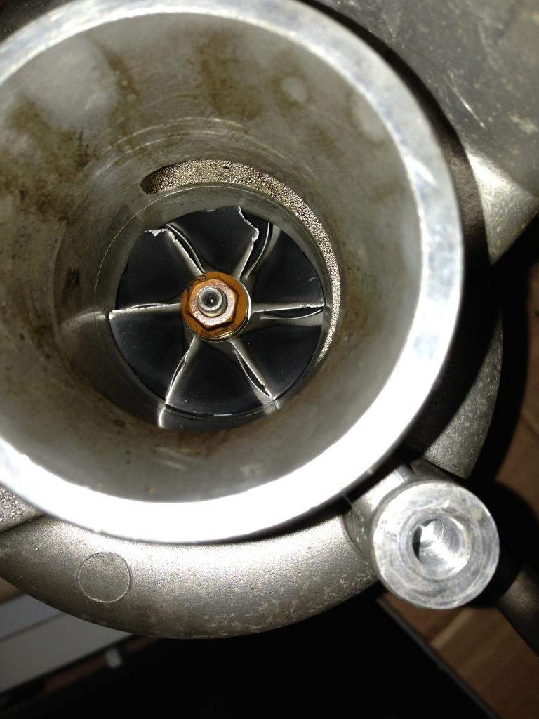

They did the cambelt and water pump service, oil change, fixed my oil leak diagnosed as a leaking sump, and swapped the damaged turbo.

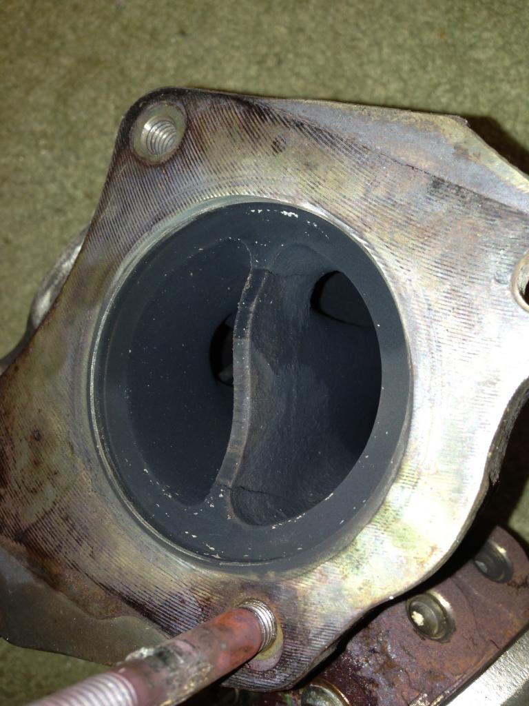

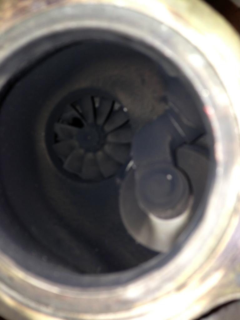

Here are pictures of the damage to the turbo, it's a lot worse than when RS Tuning diagnosed the damage last September. Think I've been very lucky that the bits missing from the compressor wheel didn't cause any damage to the engine.
Two big cracks in the exhaust housing as well.
But at least the turbine wheel looks ok, the black mark isn't a hole.

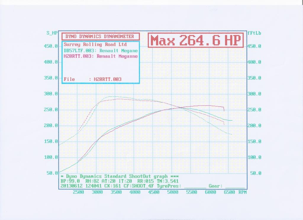

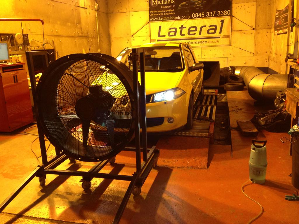

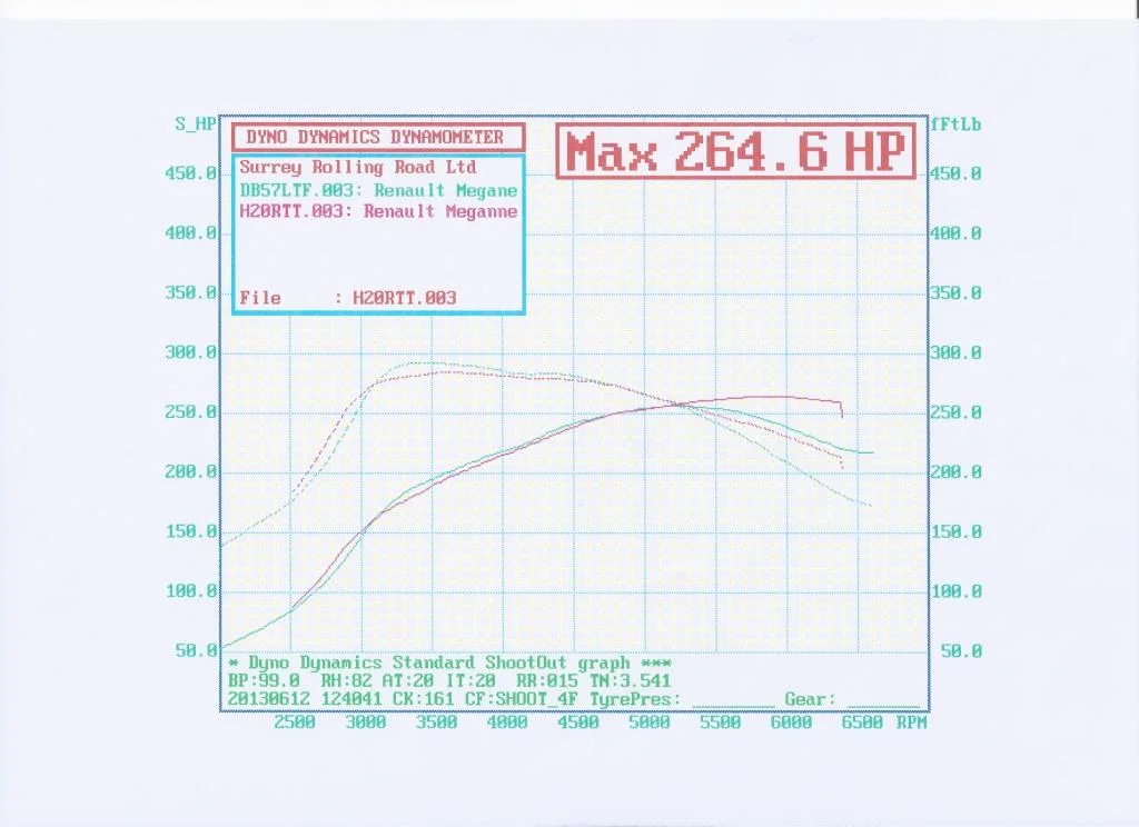

I went home via Surrey Rolling Road as James recommend checking that the AFR's are safe.

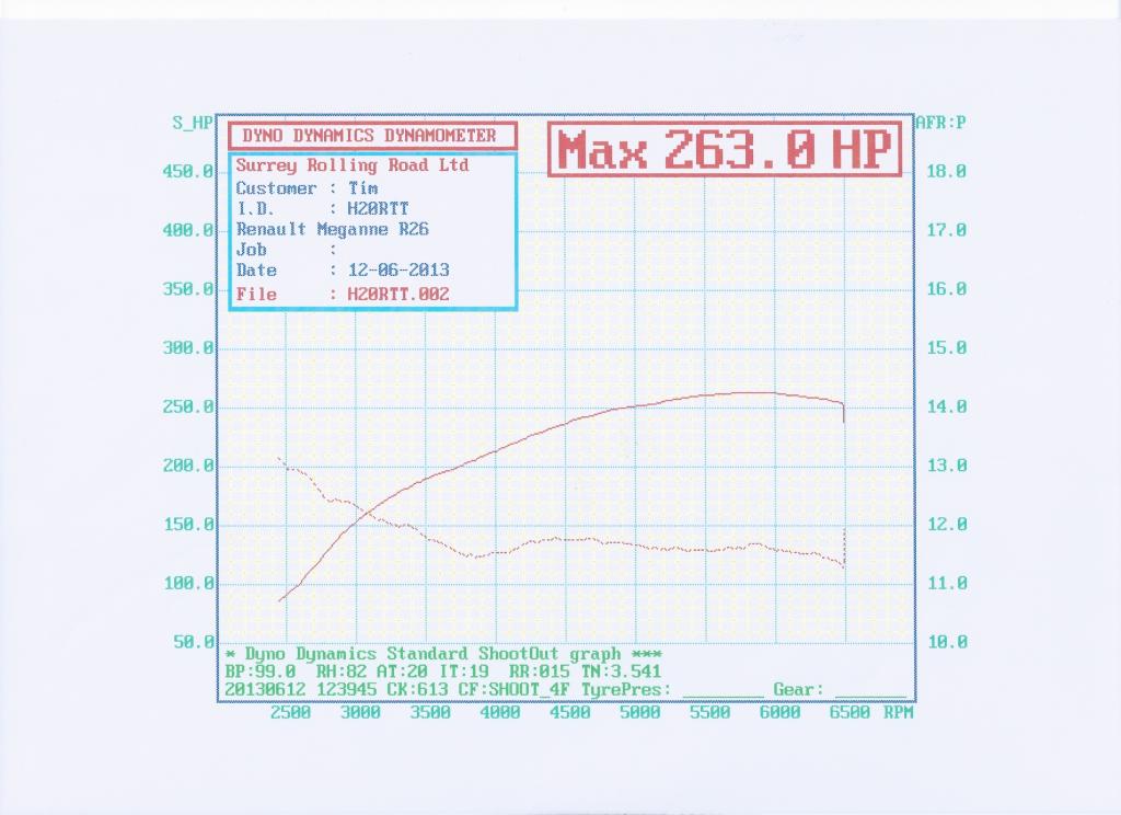

First run was to check the AFR and Charlie said it looked good.
Then two power runs where it made 264.6bhp and 285lbft.
Here's a comparison between it's first power run (green) when it surprised me it was remapped and now (purple).
It's making a lot more power at high rpm now and I think the results are good (but not great) considering it's running a base 630cc injector map. Also Paul at RS Tuning doesn't let non-forged engines make more than 300lbft of torque for safety now so it was always going to be a lot more conservative than my original Stage 2 map which made 333lbft.
I'll have to make a trip up to Leeds soon to see what it can really make :)

What caused the damage on the impeller?
The initial damage was to blade you can see with bent corner, probably caused by something being sucked through the turbo. This has unbalanced the wheel wearing out the bearings and allowing it to move causing more damage.
Looks good now. That turbo is really shafted!
Cheers Sam. Yes, I knew it would be bad but not that bad!

That folded over blade will be the reason it whistled!
