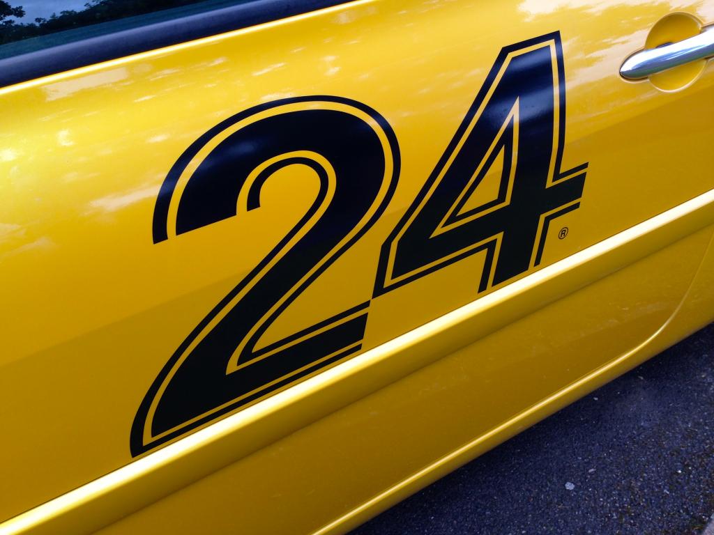

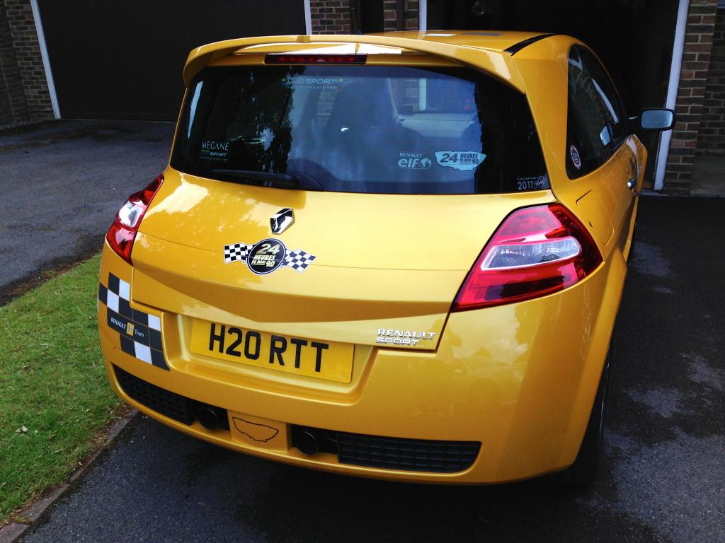

Almost ready for Le Mans now :)

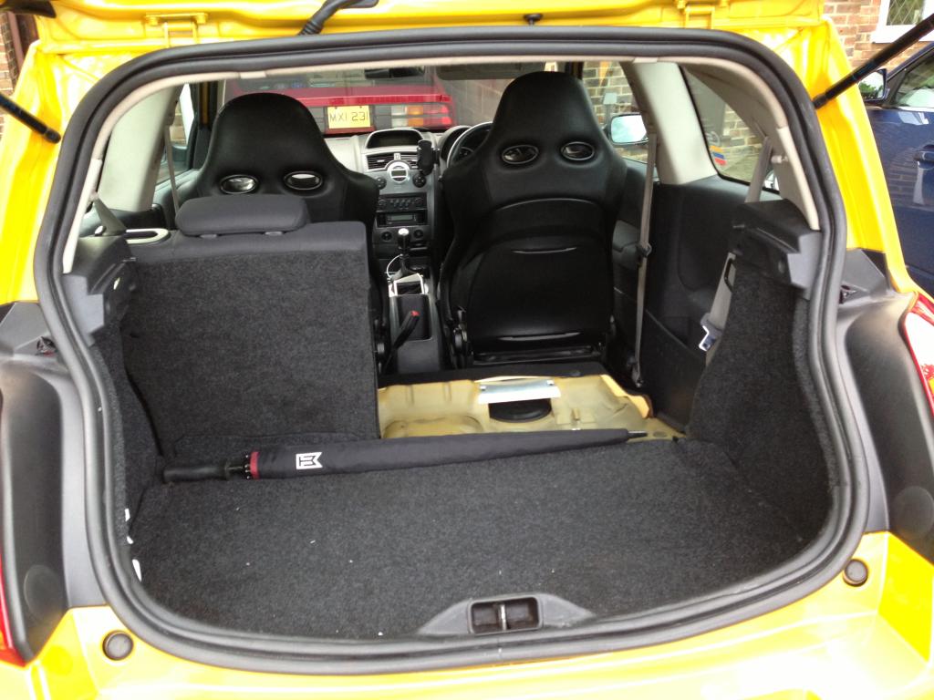

The fridge is going in my car so removed half of the rear seat. I'm only taking Paul (Gorms) but left the other half in as Fletcher needs to be in my car for the ferry and thought he'd prefer not sitting on Paul's lap lol.
Then I washed my car and put on another layer of Banana Armour wax before starting to sticker up for Le Mans.
I'm quite pleased with the stickers, just hoping everything fits in the car now!
Re: Tim's R26 Banana Boost Bus
Ha those stickers look great on that. I'd be tempted to leave them on.

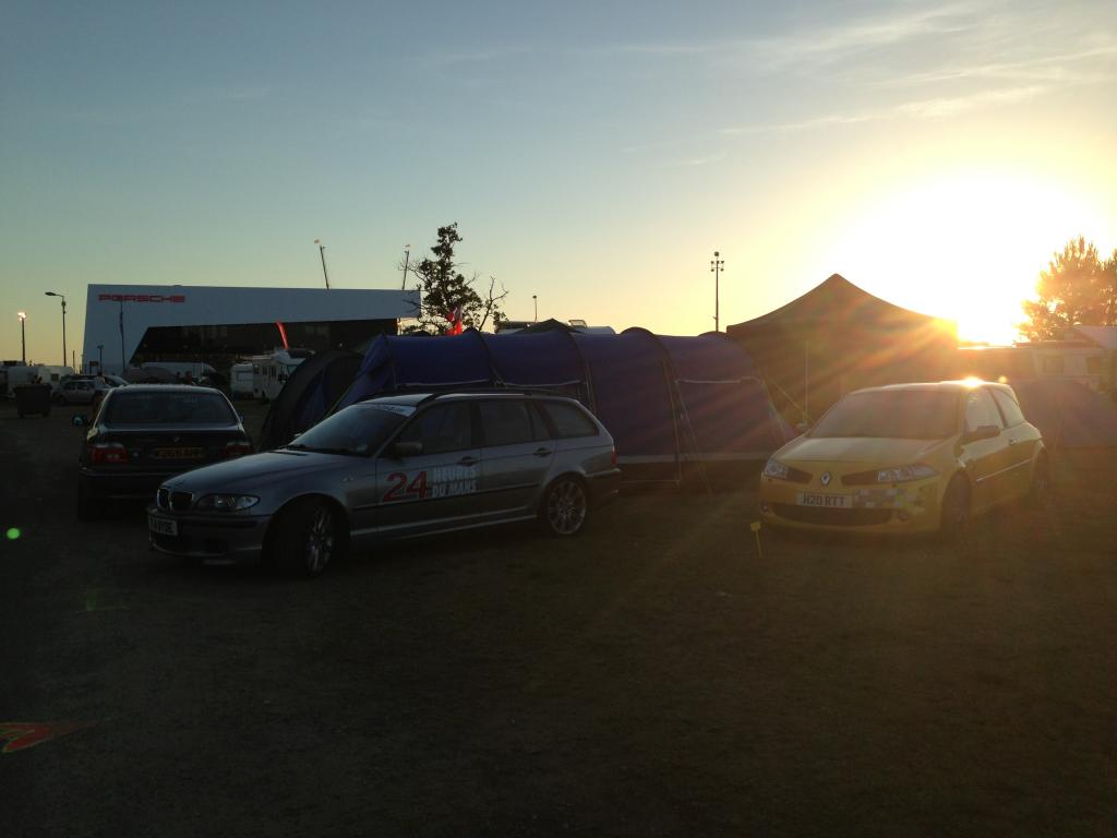

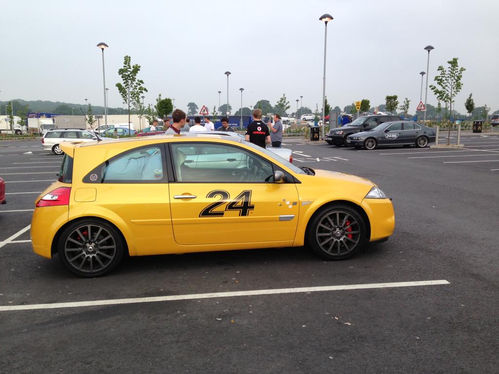

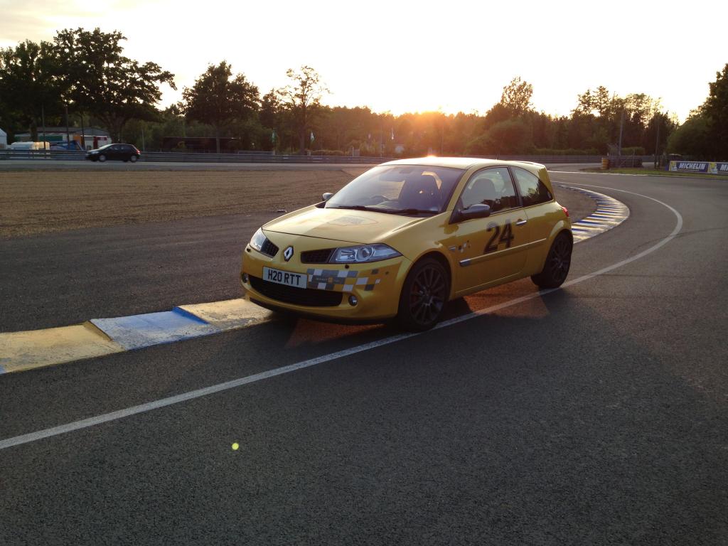

A few pics from Le Mans :)
Loaded up ready to go at Cobham Services
Pistonheads Meet
Mulsanne Straight second chicane

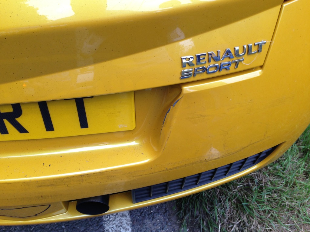

So this is what happened today :dapprove:

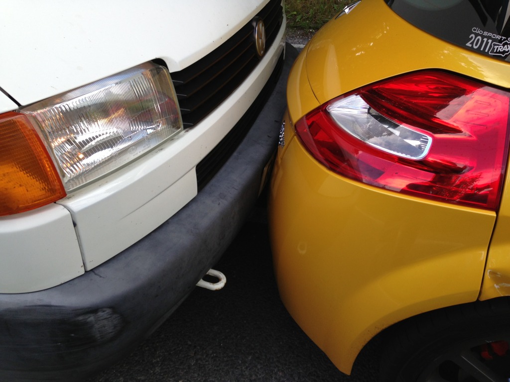

I was in a line of four or five cars going round a blind bend on the approach to a t junction when an idiot in a van got impatient, tried to overtake me hitting my rear quarter in the process. Then as I tried to get him to stop to get his insurance details he shunted me twice. I've reported him to the police for dangerous driving.

You need a new rear bumper anyways! Will get rid of the exhaust burn! Pretty s**t none the less! So now you need front bumper bother wings and rear end respray! Full respray time!
did you get his details in the end? What did he say?

FFS! There is some absolute cnuts on the roads.
True. He didn't even say sorry. Got him on camera saying he shunted me twice.
Phoned 999 and got his details after they told him to. I agree it's looking like that time.

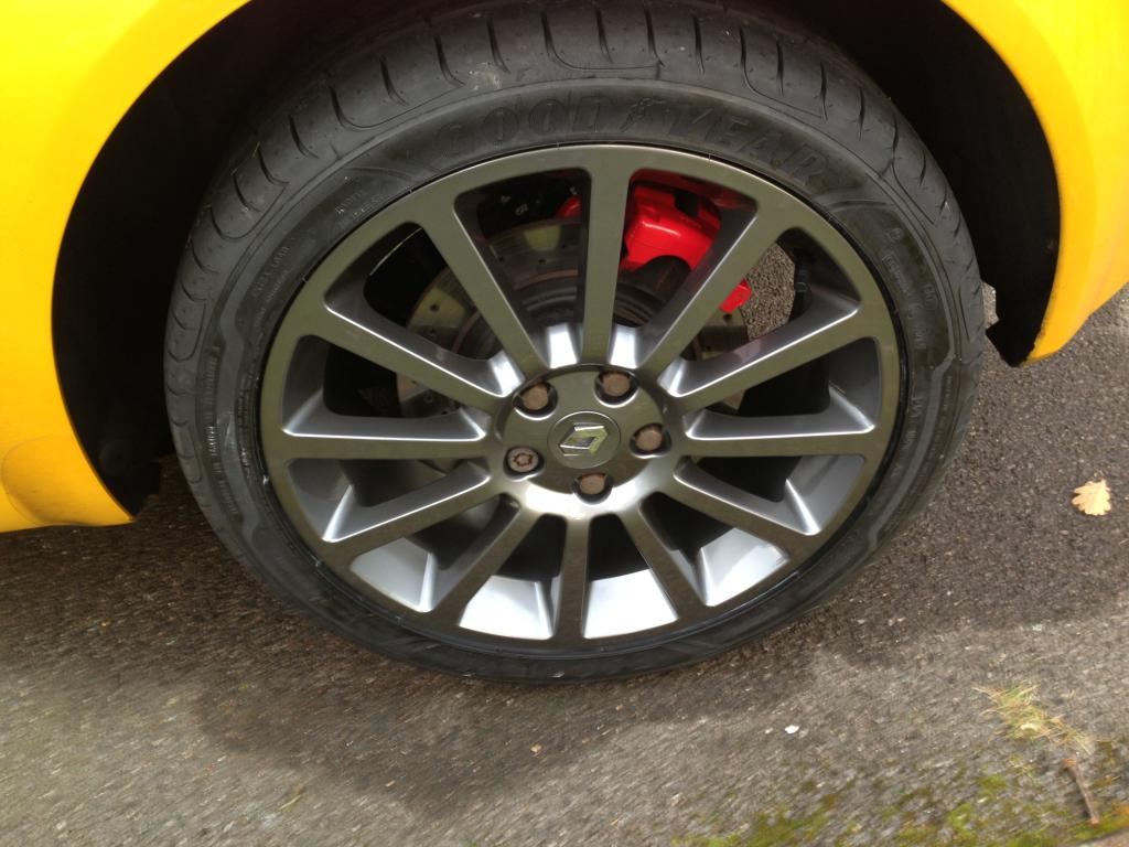

One alloy damaged by the van was annoying me so last December I fitted my spare alloy (which was brand new) and three brand new alloys bought from Adam @ Renault Wolverhampton

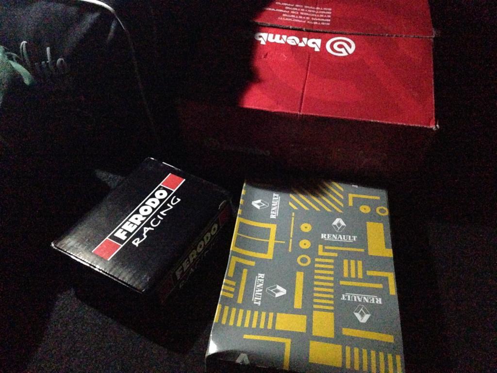

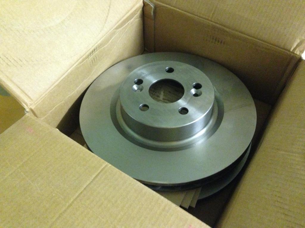

Rear calliper seized a few days later so needed new offside rear calliper, R26 discs and brembo pads as well!
In March the front brakes needed doing. I had been running Tarox F2000 grooved discs but didn't fancy paying £250 for a set so went with Brembo HC discs and DS2500 pads from George @G 172

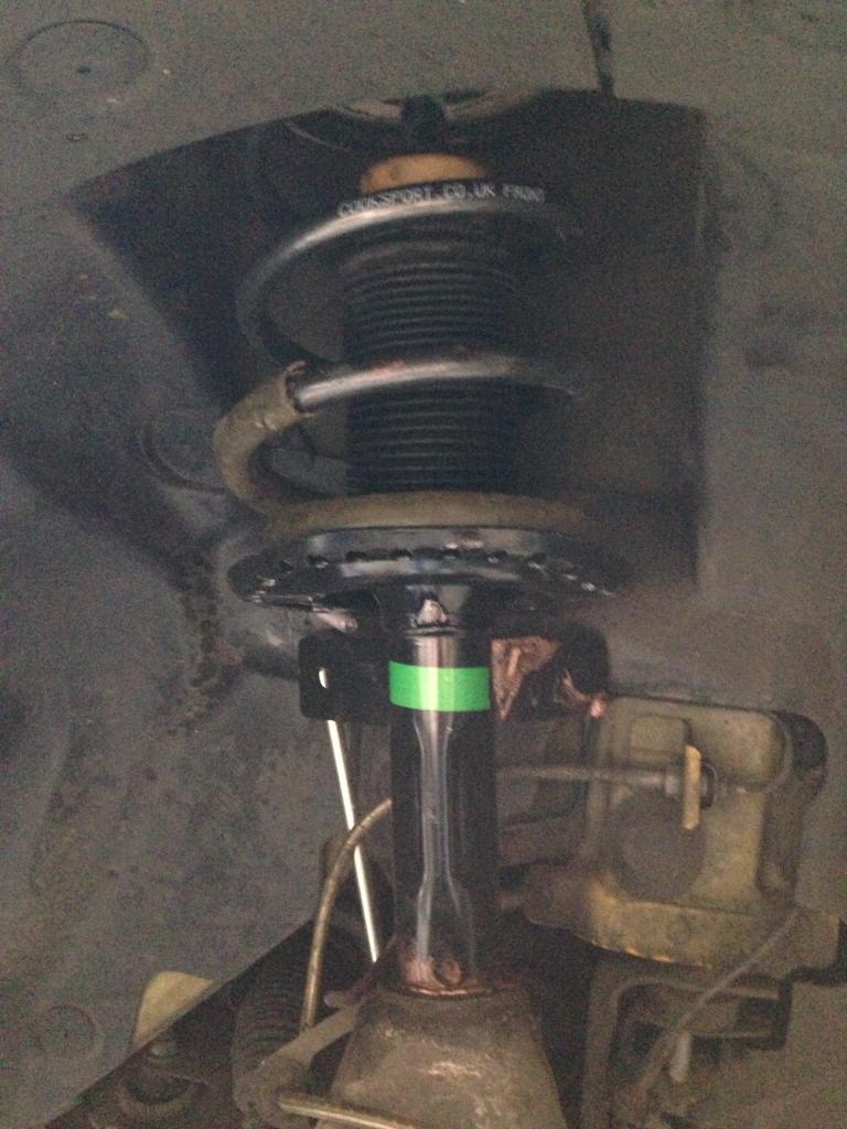

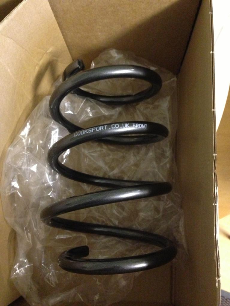

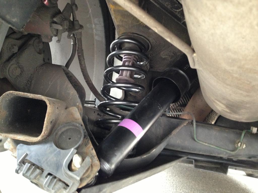

I then decided to do a full suspension refresh in April as it was a bit tired approaching 90k and also I was going on a Nurburgring trip.

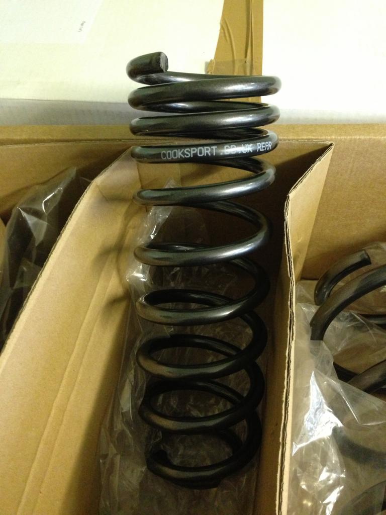

Cooksport springs, R26 dampers, new top mounts, and new drop links were purchased.
Thanks @Gorms for fitting the rear spring and dampers
Thanks @Matt_90 for fitting the front suspension.
I'm pleased with how the car sits on the Cooksports and they really work well with the new R26 suspension.

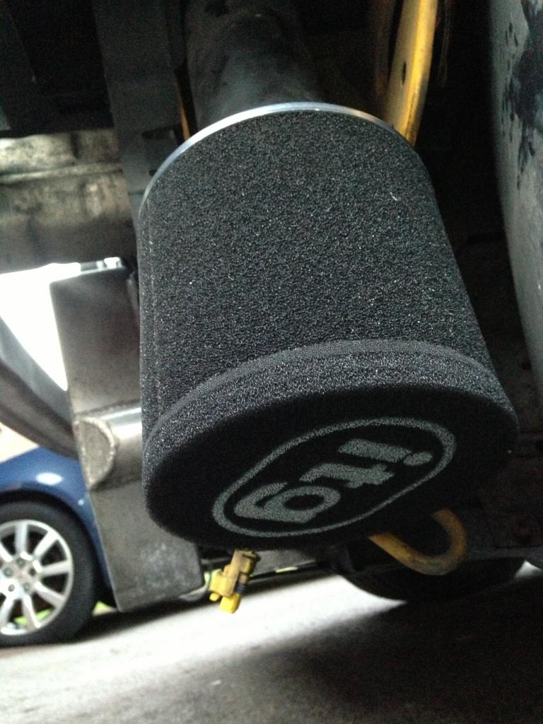

I purchased a new ITG filter rated for more power in June so I can alternate filters. Main reason being for convenience as that it takes a while to clean the filter properly.

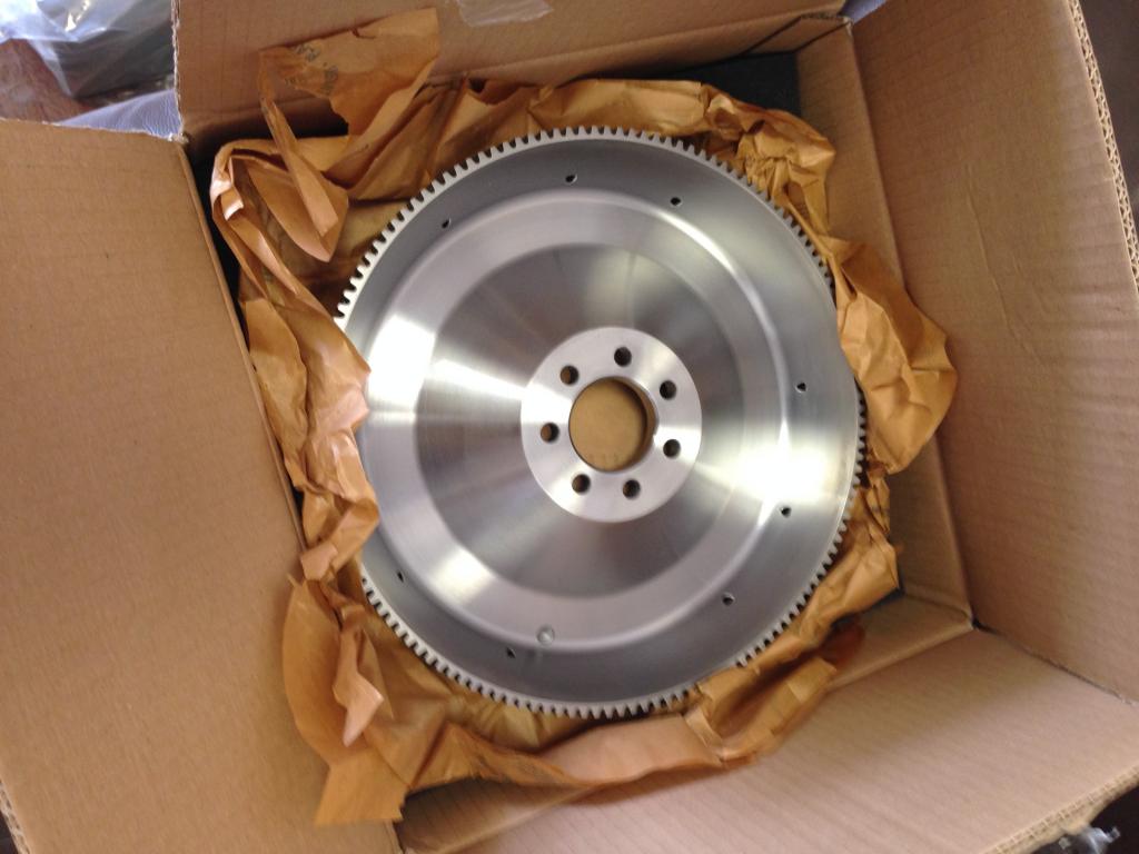

The DMF and R26 clutch is being replaced with RS Tuning SMF and R26r clutch.

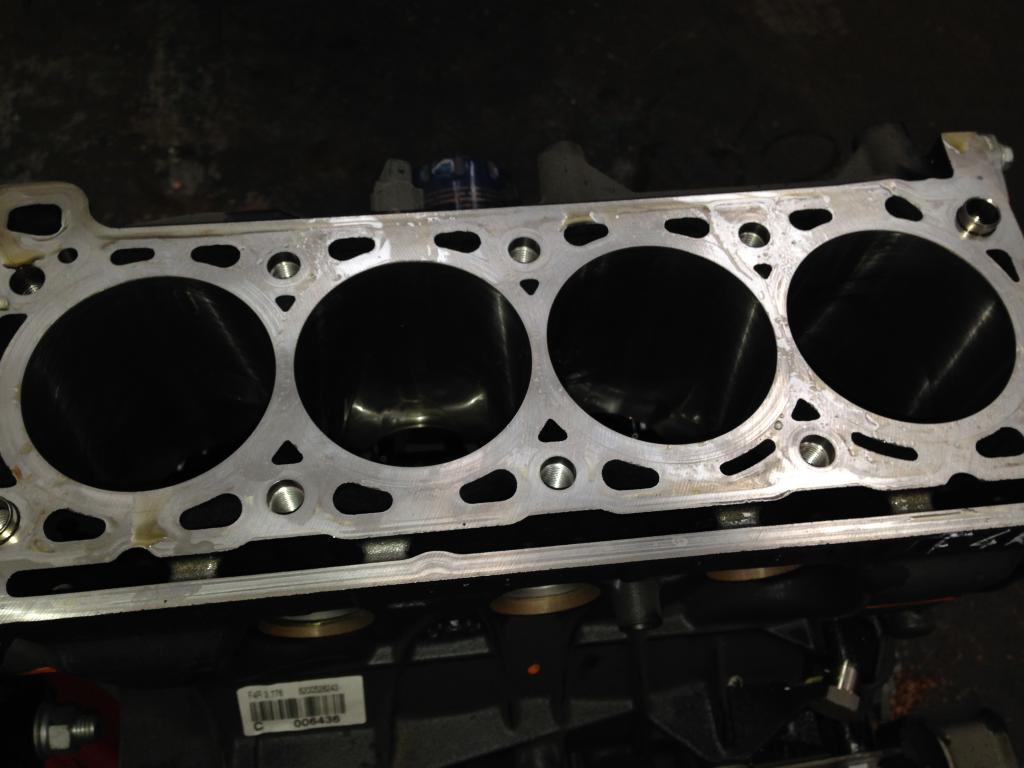

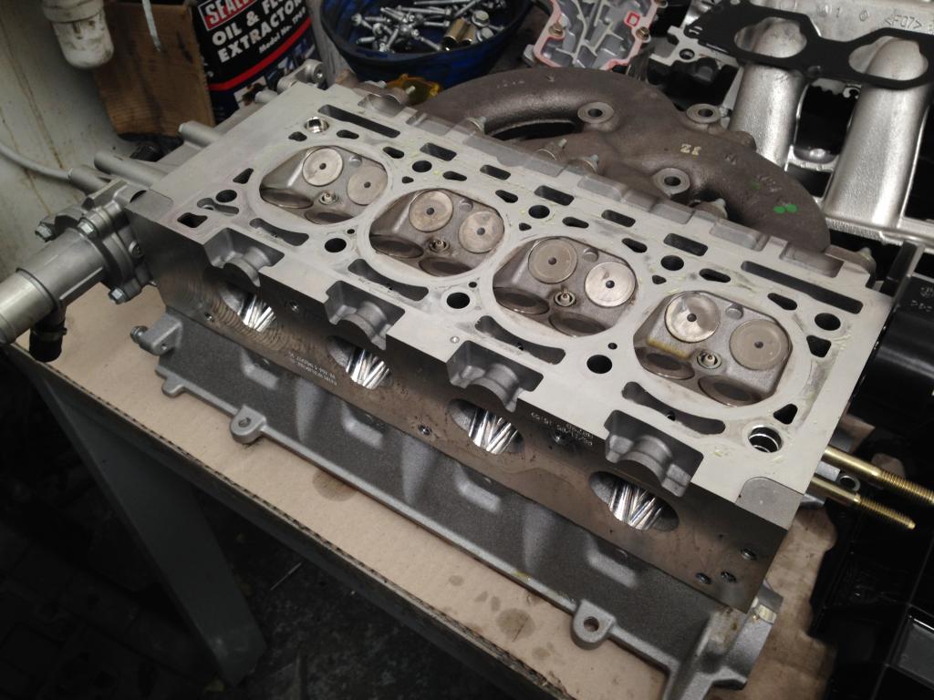

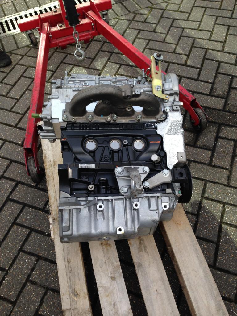

I then decided it was the ideal opportunity to drop the tired engine and replace it with a brand new forged F4Rt engine.
Brand new engine purchased from Fred@BTM. It's never even been run so really pleased with my purchase.
Parts for the forge build purchased from @Andyrg@ ClioTurbo

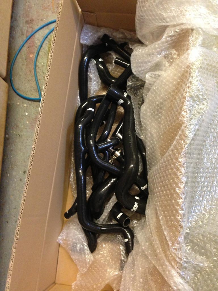

Coolant hoses I purchased June 2013

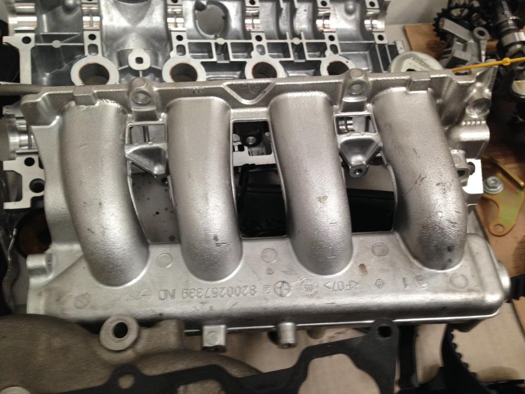

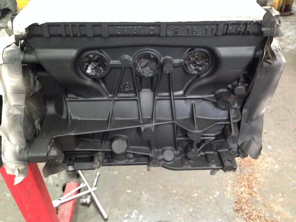

I've sprayed the block black and rocker cover, inlet etc are off being powder coated in 9007 Grey Aluminium by Tadley Powder Coatings.
Agency Transmissions have since diagnosed that it needs new 4th and 5th gears so it's going to be more expensive than I anticipated with rebuild costing £750.
Gearbox is due to be finished by Tuesday so hopefully I'll be able to start running the engine in towards end of next week.
Engine is being built by A Welsh Motors Ltd in Basingstoke which is run by a friend of mine.

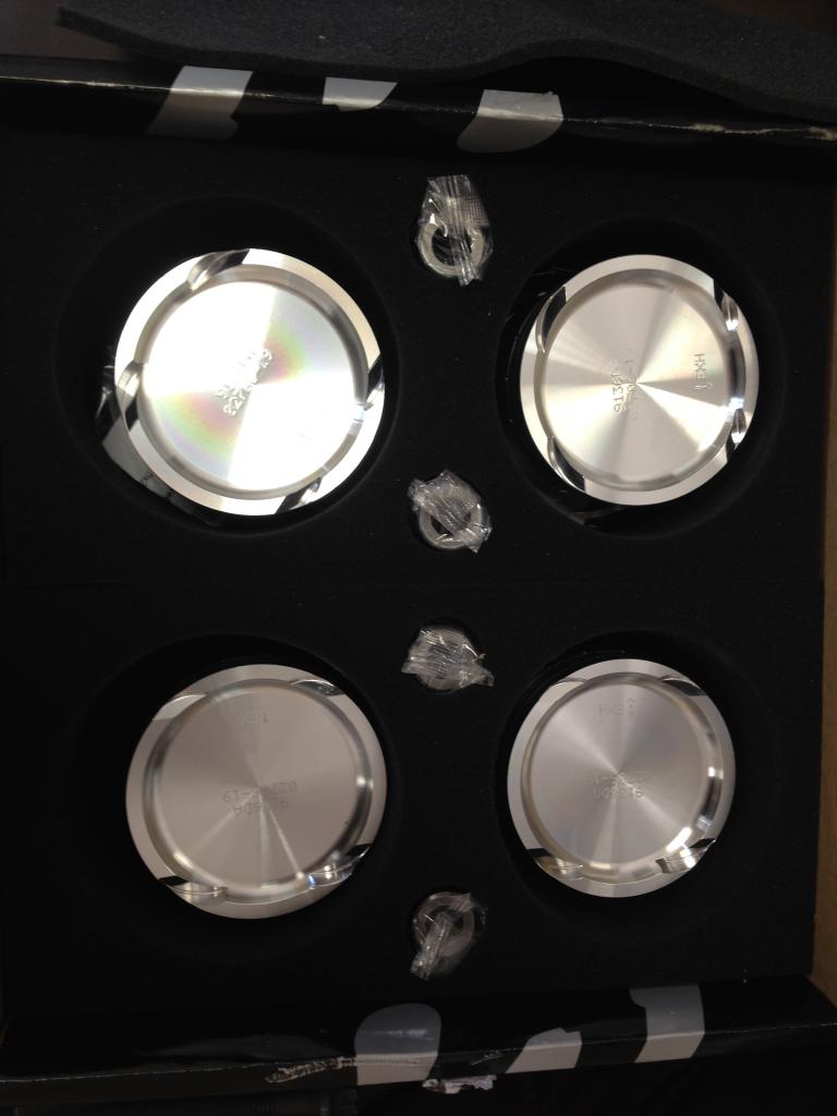

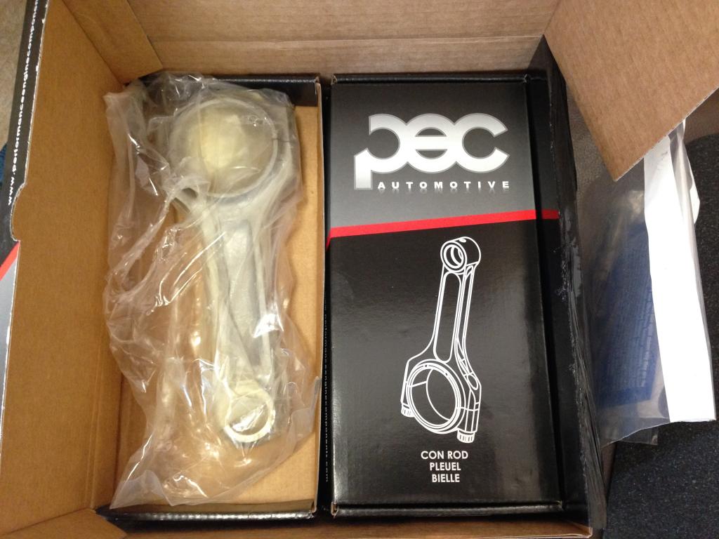

Spec is going to be as follows:
Brand new F4Rt engine
Wossner 82.7mm pistons
PEC rods
ARP bolts
Supetech valves
Clio headgasket for 8.5:1 compression ratio
RS Tuning SMF
R26r clutch
New 630cc injectors (to replace current 630cc injectors)
3" decat (to replace 2.75" decat)
and car already has:
3" Ktec exhaust
Forge hardpipe kit
Forge coolant hoses with Evans Waterless Coolant
Forge intercooler, actuator and recirc valve
ITG induction kit (with uprated filter)
