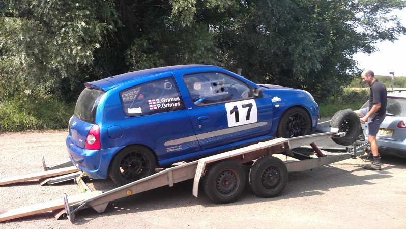

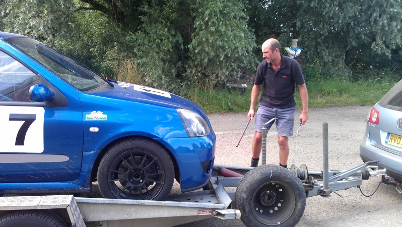

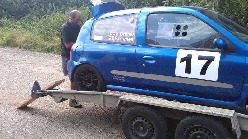

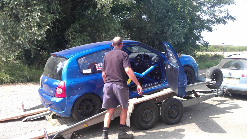

Got in from work at 6pm and just now finished 21:30 getting the Cup sorted and ready for tomorrow (now too dark to do anything) - hate being rushed and think I've bound to have missed something and Sam said she finally couldn't get the time off work too so I'm all alone tomorrow, never been on my own. Have to do all the jobs myself :S. Sam's made me lunch\snack bag to take too :eek:.
Fingers crossed the Cup goes OK and doesn't start messing around or I will strip out every bit of wire and start over......(maybe)!

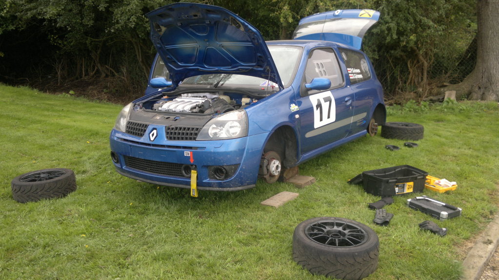

Carried out a post test and pre race day inspection today - couldn't have picked a hotter day for it really....
Had all the brakes apart - plenty of pad meat left, discs ok too and no noise from the 4 bearings too. Will swap out the brake fluid after the race, found my bit of rubber tube, with non return valve, that I bought 20 years ago seems to look ok. Too hot today for that job.
Spanner check revealed no loose bit's, the bits I checked that is.
Got a very slight oil leak from the gearbox, coming from the selector area? Think I've read somewhere that a repair kit can be got for this now.
Finally removed the steering lock, after Mark123 showing me some pictures, took about 10 mins in total and was quite easy after all the fussing around for a few months trying to sort it out.
This is the locking bit I removed.
also removed the bumper brackets that the front wheels catch on, raised the car to miss them, will lower the front a little bit after Mallory.
Tried stick sunstrip on - massive fail, to hot so that's in the bin.
Left the wheels off as going to get the tyres swapped over, left to right, this week.
Trying to get the arches rolled too as want to put some rear spacers on, for no other reason than to bring the rear out to match the front - I'll only use 10 or 15 mm spacers though (20 - 30mm total). May get other benefits from fitting too I suspect.
All in all a productive few hours with no major problems (or any problems) discovered.
