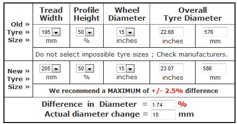

May have to wait fitting my 205's as think I have too much front camber - as even with 25mm spacers there's only a small gap between the strut and 195 tyre. Could be wide enough, not got a spare set of wheels to fit the tyres too and don't want to mess my mate around swapping over etc. I'll have to get the gap measured.
The 205's do look a lot larger in the flesh.
