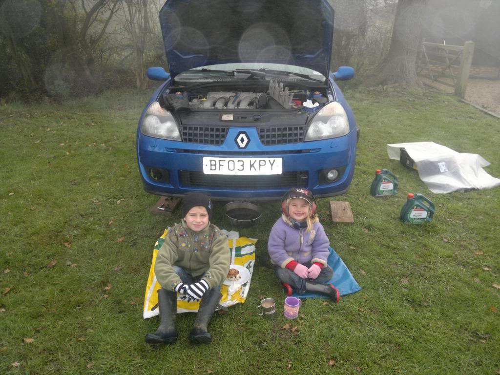

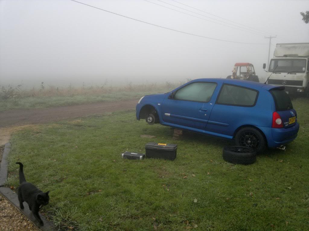

To prepare for the next track day on the 26th Nov again at Bedford, stuck the car again on it's blocks of wood and changed the oil and filter, amazed myself in removing the front pads (how easy are these to remove...) put them back as plenty of meat on them. Taking new ones with me to Bedford so can swap there if need be, I'll be taking a G clamp too. Also removed the canister thing from behind drivers side of bumper, the horns and air flow thing from the passenger side and both the front fogs. Cut two holes in the wheel arch liners then remembered the ducting hadn't arrived........oh well was on a roll...
I also, hopefully, sorted the middle exhaust hanger out but we shall see...........
So after taking Harry to his Saturday football match
Got the Cup on it's blocks of wood
and set the team to work, a short while later refreshments arrived......
Excuse the choice in oil...got a load with the car and I can use old oil, couldn't bare to chuck new stuff in the mix with red diesel and creosote for timber spraying. The cup has been on it since new I was told when I picked it up...
All that's left to do now his load the car, hitch up the trailer and hope there's no fog on Saturday 26th....Oh and Sam to bake a cake......then we're all set. Are you ready Tony?
