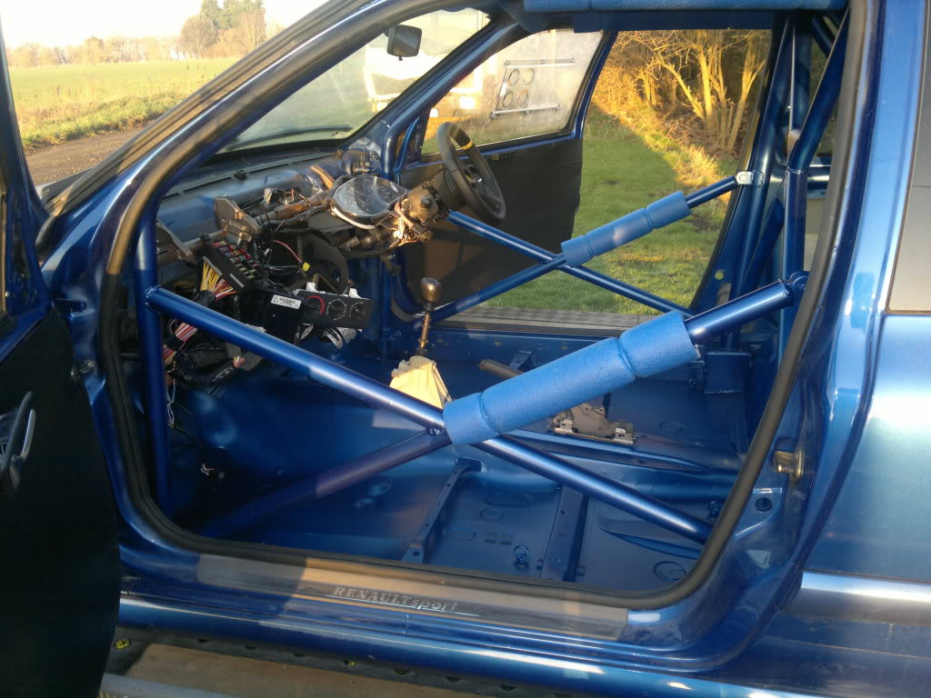

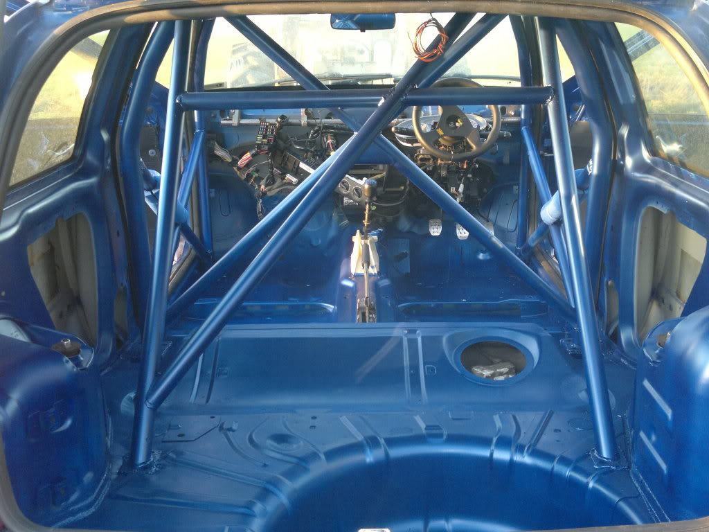

Got the rest of the inside sprayed today, bit of orange peel effect on the drivers floor pan, couldn't wait for the car to heat up totally. Done now and all the lightly sprayed bits gone over again. Looks really nice, didn't take any picks as had to get back.

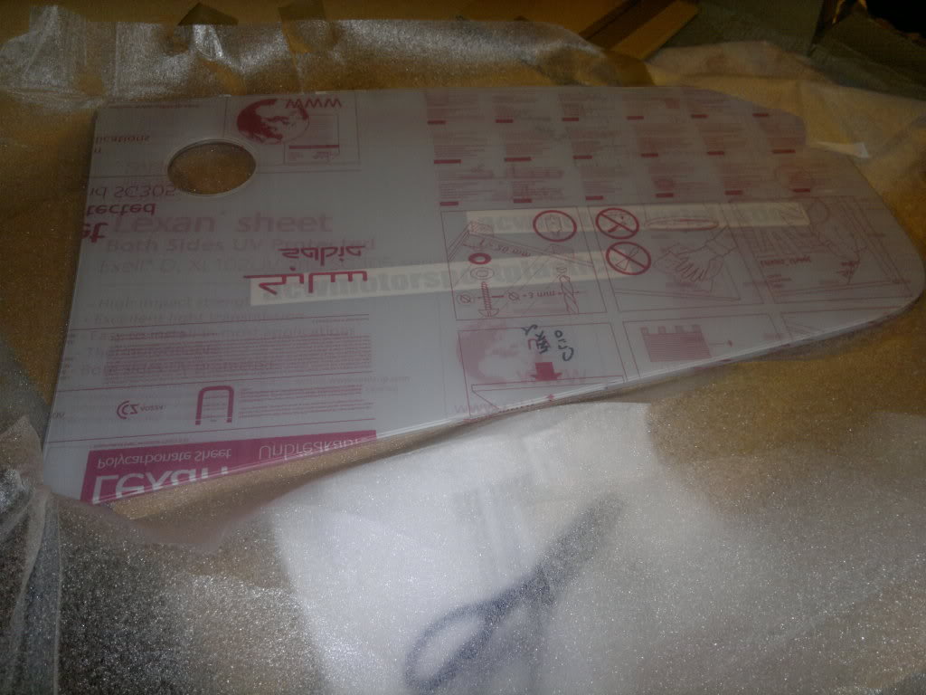

My windows arrived this week too, 4 side windows.
And as a bonus got £180 cash back payment to my CC so that's going towards the rear one. Just waiting for P4p to answer a question first before I get that ordered up.

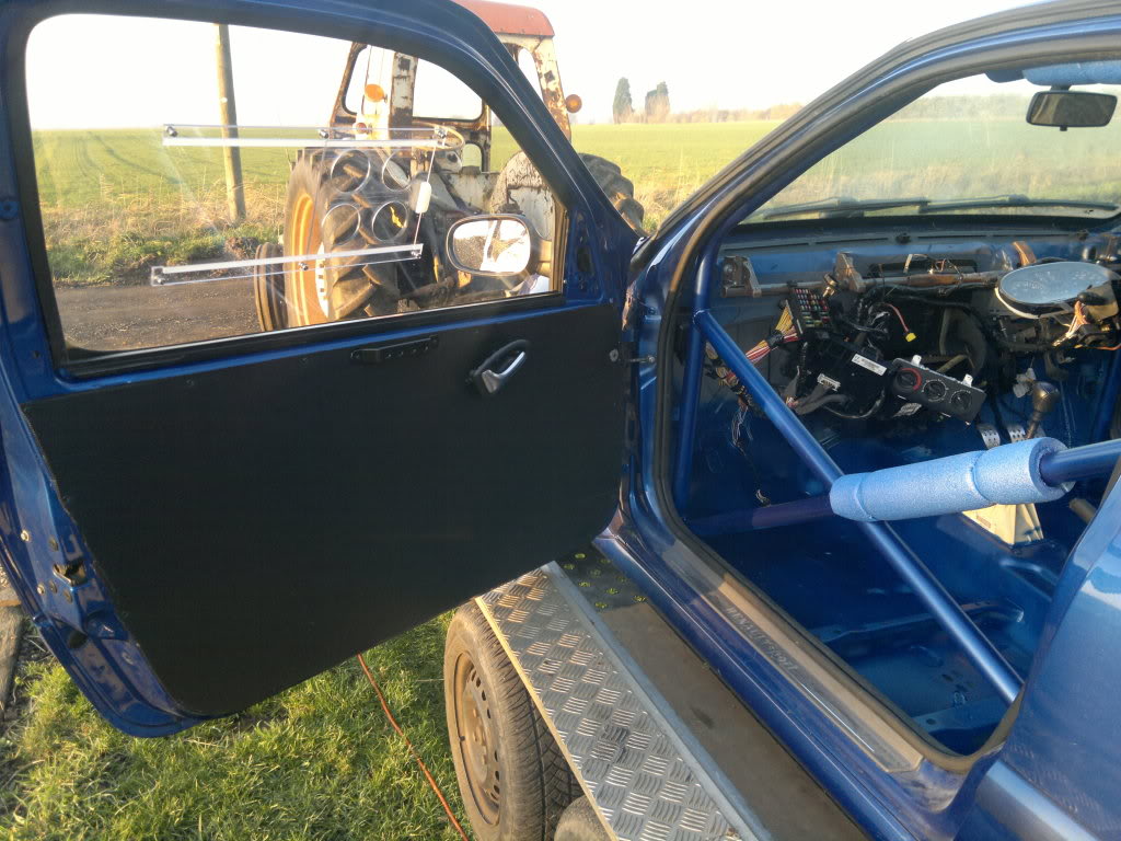

Things take longer than you think....finished of both doors today...messed up the cutting of the passenger door card (by the door lock) will get some black tape and make an edge to cover up the extra cut. Nothing too bad, I just know it's there....
Some pics
Through to the drivers door
Going to cover the boot lid, rear quarters tomorrow and also include the b pillar holes too.
One from the boot to show the finished colour, looks nice in the daylight...
Hmmmm, maybe I should of left it as it was, as took my boots off to start cutting the rear quarter windows out...Doh..didn't want to scratch\mark my new master piece.
The door card material only cost me £15 of eBay too....used 2mm Correx (got 3 2mtr x 1 mtr sheets, plenty) and weighs nothing, thought I'd give it a try and the thin stuff looks ok

Thanks, though at times wish I could send it off to be sorted, working outside exposed to the elements can be a bit tiresome at times. As luck would have it the car started first time after replacing the stripped out interior loom (did wonder). Provided some needed heat at times.
