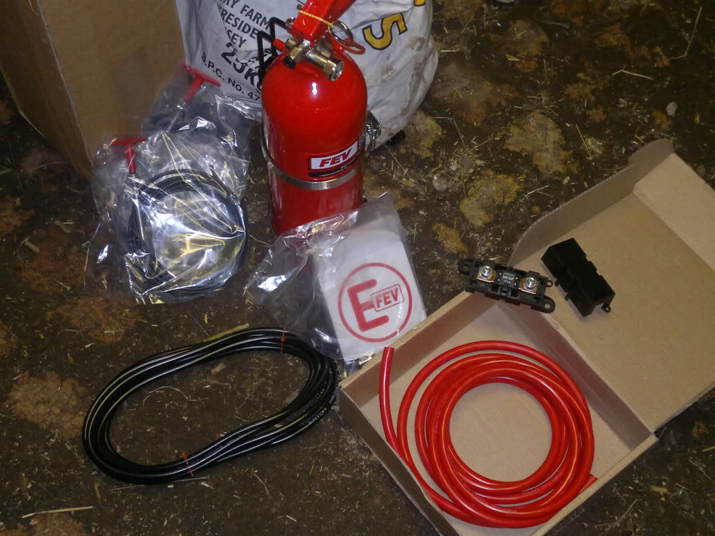

Well, been buying stuff again,
This weeks deliveries included
A fire extinguisher, with one 6 foot and one 12 foot manual release cables
4 meters of +ve battery cable
175 amp mega fuse
and a mega fuse holder....
still got the Extreme Racing 25 battery, battery terminal and connections to sort.

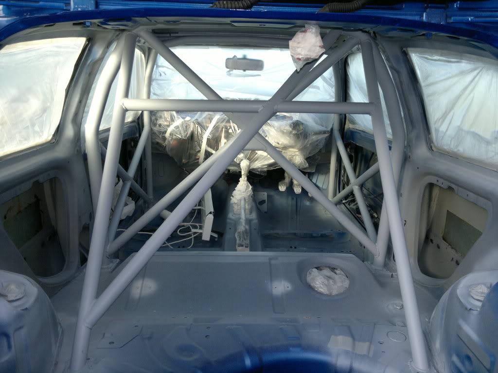

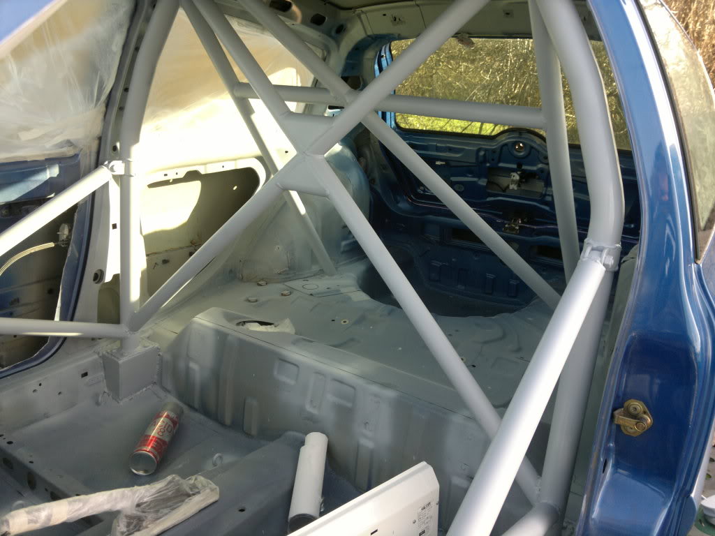

Did a bit of work on the Cup this last weekend (new years eve\day). Bought 3 cans of Upol Acid etch primer, stripped and rubbed down the inside of the Cup, wiped it all down with a degreaser and then sprayed most of it. Now realised I forgot the boot lid as it was up most of the time....
Harry helped with the rubbing down, wanted to help with the spraying until he saw me after..did it with the car outside, me inside the car, doors shut, boot open spray dust every where.
Must say found it easy to spray, no runs or drips even. Though got fed up whilst taping\masking up and will have a bit of dust\ over-spray to clean up I should think. Will be getting 5-6 cans of top coat as the primer is a bit thin on the drivers floor. I'll have 1 or 1 1/2 cans left over for touch up\repair later on down the line.
With 1 can left and just the floor to do....

With the money I saved (250-300) by doing it myself bought 4 Polycarb windows(Tony @ ACW motor sports with 10% discount) which are coming next week, all four for £198 inc sliders and rear pop out vents, didn't go for Margard fronts for an extra £60. Will just buy another set of fronts for £60 should the need arise. Might just buy the rear Screen too later this week from P4P.

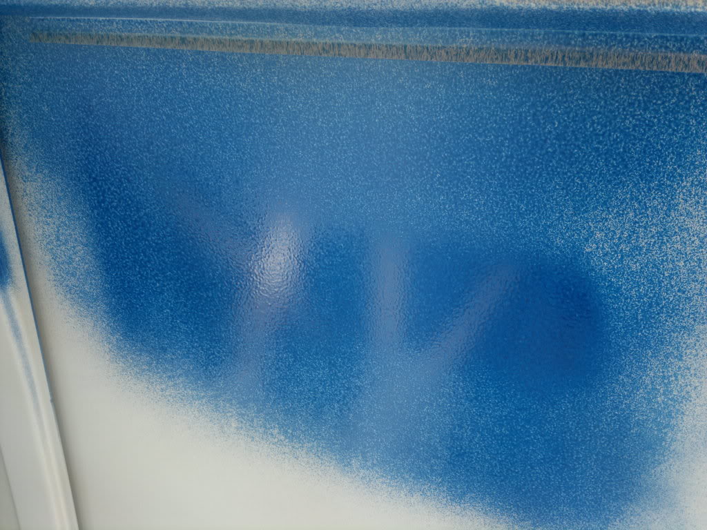

Well, all the best laid plans and all that, nice day out so thought I'd crack on with spraying the inside with the top coat. Got as far as one press of the spray nozzle and this happened......
What's going on here? Used Upol acid 8 etch primer says on the tin no need for undercoat and primer...

Before you ask,I haven't got a clue.

Actually looking at the pictures I had a white heater in the car, bit of moisture on the inside of the roof drying out before I sprayed the primer........might have stumbled on the solution with out knowing wtf I'm doing.
Were the tins cold? I had this with a spray can, at room temp went on fine but after it'd been in the garage at <10C it sprayed like that.
No, but the car was so other way round, same results nevertheless.
Also a call back from Auto-paints, who I bought the paint from said too cold for sure, recommend 20 degrees minimum. Nice blokes, said that I could even swap out their fancy fan spay nozzle for the one of the Upol acid 8 cans to do the cage in, won't get so much over spray\waste (they also said the Upol nozzle is rubbish really). Upol nozzle gives 5 cm circle, the fan spread was nearly 20- 25cm in width I noticed with my quick go earlier. Caught me out a bit as wasn't expecting such a big spread.

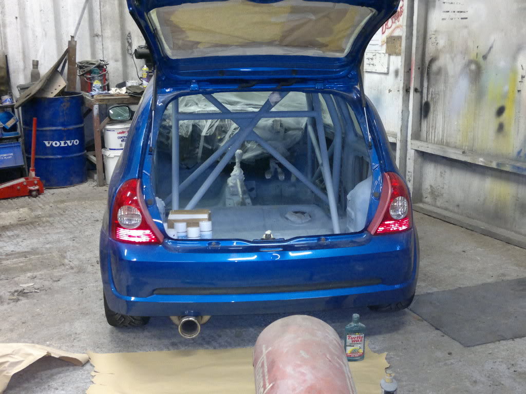

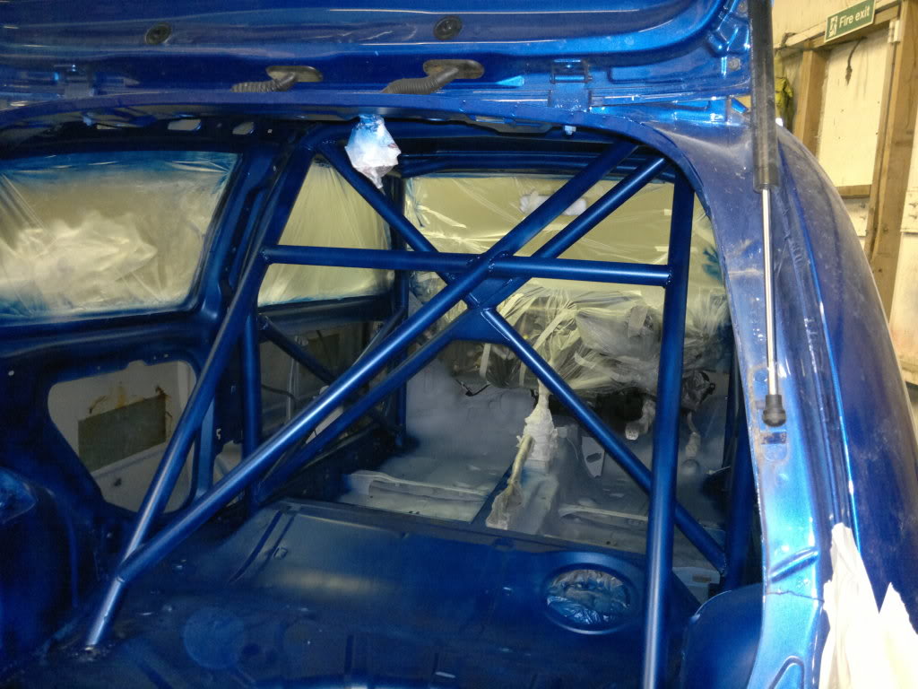

All's not lost though, as I live on a farm estate (in and old workers cottage that the farmer sold off when times were hard...) there are a few unit's, half a mile away, that the farmer rents out to locals and one of them has .... a spray booth......said he'll let me use it tomorrow morn. So the car's off the trailer and parked up in his unit waiting to go in, 30 mins on high and it'll be done!!
He also said the cold metal wouldn't of helped. He won't be around but has given some tips, just going to have to suck it and see me thinks, what's the worst that can happen......it'll look sh1t....hmmmm. Or phucking amazing, time for a poll?

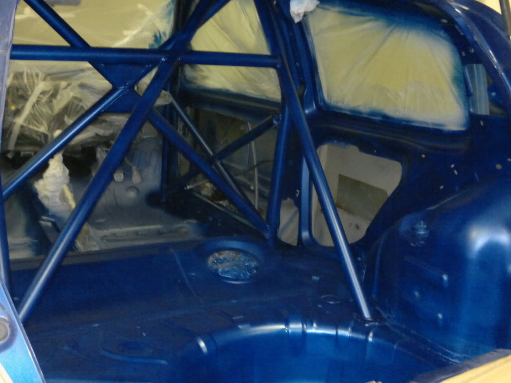

In the end, on my own, couldn't push the car over the ramp\lip to the spray booth so used a space heater to heat things up a bit...

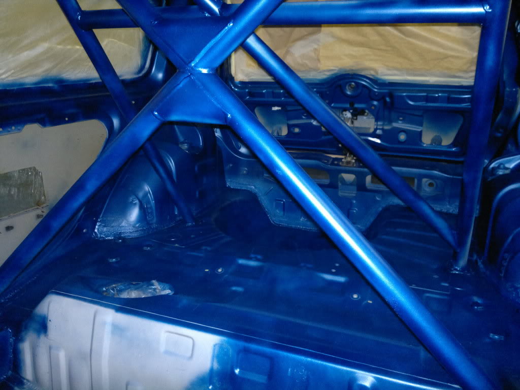

Found out that 6 400ml cans just wasn't enough so ordered some more, the colour looks good though the flash shows up the light sprayed areas and the paint went on fine no orange peel effect, thanks all for all the advice and help.

When I did mine in the old car I ended up using a lot more than I thought I would, its surprising how much you need to do a good job.
