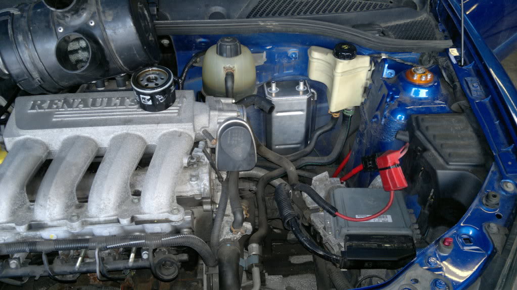

Been messing in the engine bay too...relocated the ECU, took me an age to work out that the top half of the ECU cover just pulls off. Krypton factor...could see some screws but the access holes were all blocked up...no way was I texting for help....! The ECU is now fixed on the upper gearbox mount surround.
Fitted the single wiper stuff, got it parked vertical at the moment, works good though not sure if I should have it parked vertical as it sort of indicates\draws attention straight away...knob or there's something to watch here...not sure which yet. May just park it horizontal and avoid the issue...lol.

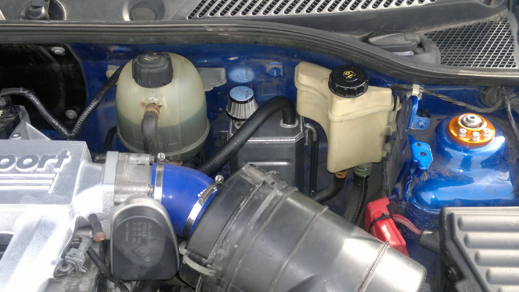

Moved the coolant header tank a bit to the left, then had to take all the scuttle panels, wiper stuff of again, as thought I'd caught a wire whilst drilling the new screw hole. Turns out I had....but just caught the loom tape...sigh of relief there. Put it all back and attached the header tank in its new place. Closed the bonnet....another near fail...5mm clearance to the header tank cap.....a bonnet strengthening rib now sitting over the tank cap.
Moving the header tank made room for the 2ltr catch tank, fitted that, in between the coolant tank and power steering header tank and have just the pipes to connect and a filter\breather to source and fit.

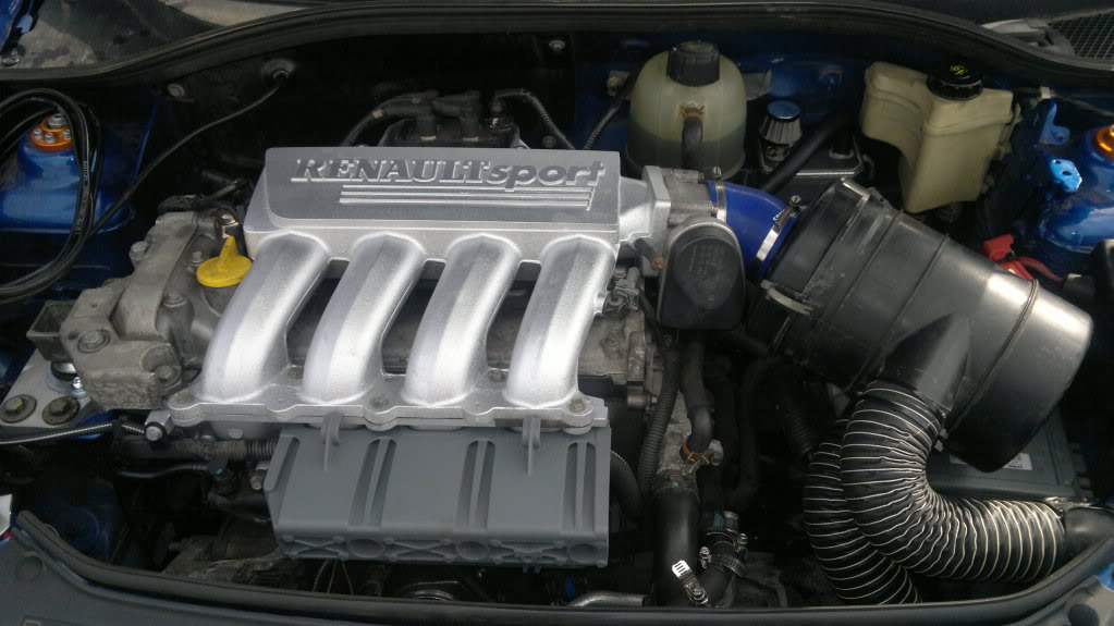

Replaced the standard air box with a MK 1 one (off Cliosport) though omitted to get a pipe so I can mount it end on straight to the TB, any one point me to one or a web site where I can get one? Don't need a bend or the such like. Went to run the air ducting to the new air box and found the ducting I bought wasn't that flexible...sending back and getting some more flexible stuff.

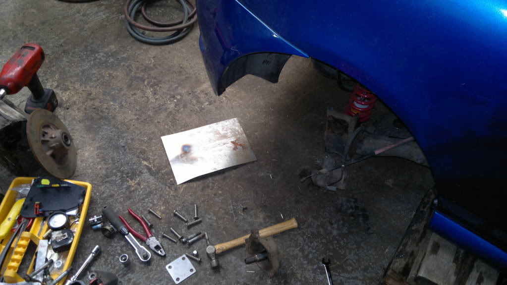

Thought I'd start with fitting my rear (Pure Motorsports) 1 degree camber shims......I'd have been well stuck if I'd attempted to fit them outside my house.
Had to use an oxyacetylene torch on all the 8 screws and nuts as after 10 years of not being touched they would only move a little bit. I wanted to remove the rear suspension but my mate was in there getting the nuts red hot whilst I was holding the A5 size bit of metal sheet against the rear springs.....worked and TBH there was no heat transfer to the rear springs at all... which surprised me to say the least. Other than his help with the torch did the whole job myself and if I need to add a shim or 2 for toe out it'll be an easier job.....Getting it corner weighted in a few weeks and giving the front a bit more camber so when the rear toe is measured I'll know what to add to each side to bring the toe back to where it needs to be.

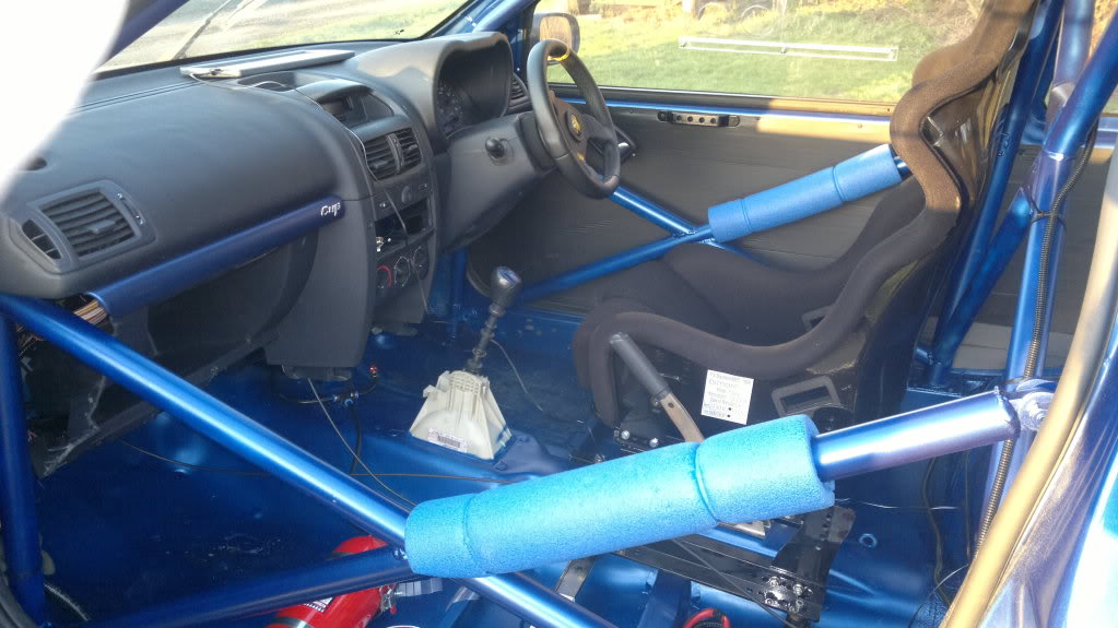

Re-fitt the dash and fit\place the internal eng cut off\fire extinguisher swtiches
P clip cables
Good clean inside
Re fitt seats\ harness

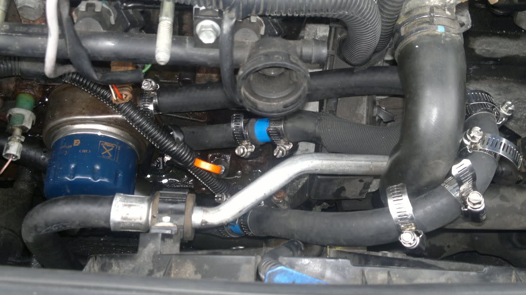

Got the heat exchanger plumbed in, though should have got pipe that held it's diameter when bent 180 degrees. Had to use 4 jubilee clips to stop the water pipe flattening out when it was bent round 180 degrees. Have to see if I can get a better type of pipe.

Got the pipes on the catch tank, though no more jubilee clips of the right size left so that's still to do.

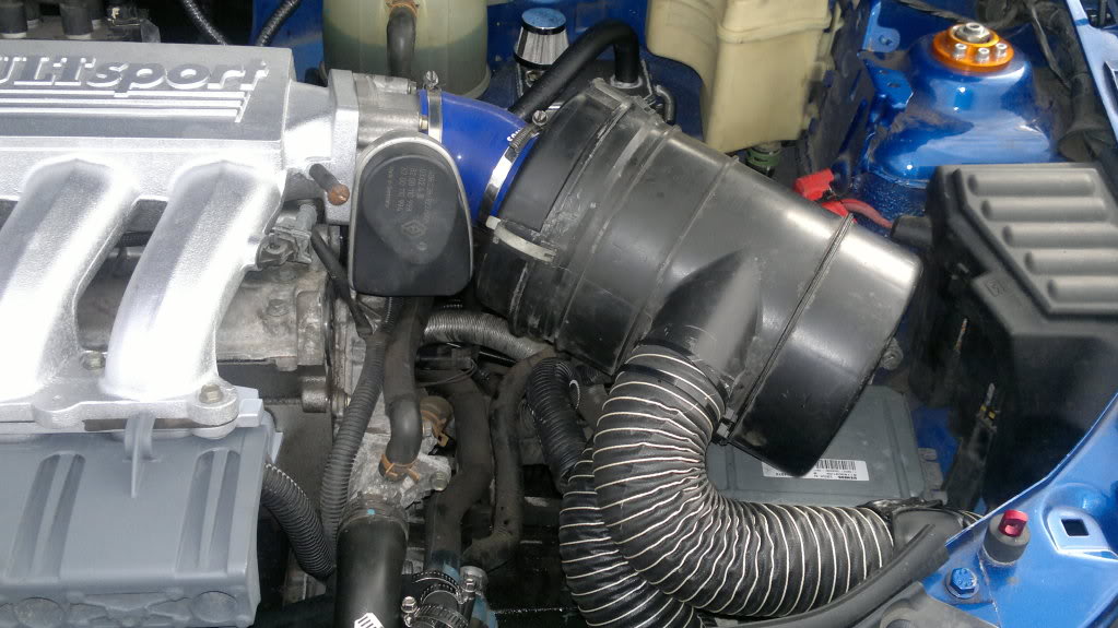

Here's the airbox I fitted last week with the feeds.
How the bay looks now, Dan from 519 gave it a clean whilst he was working on it last week...top job...

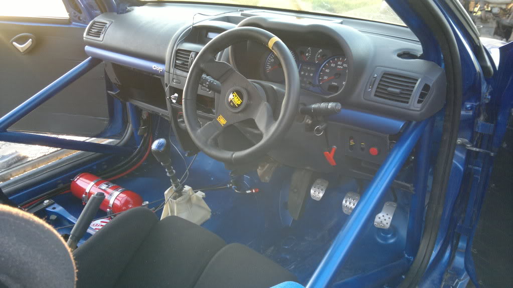

Got the dash back in also sorted the internal engine cut off switch & fire extinguisher nozzles out, one in the bay pointing at the fuel\inlet area and 1 pointing at the drivers foot well\ bulkhead. Routed the release cables, didn't connect them up as couldn't find my P clips (maybe I didn't order\buy any...)
Just have to make two brackets to give each of the nozzle heads a bit of support.

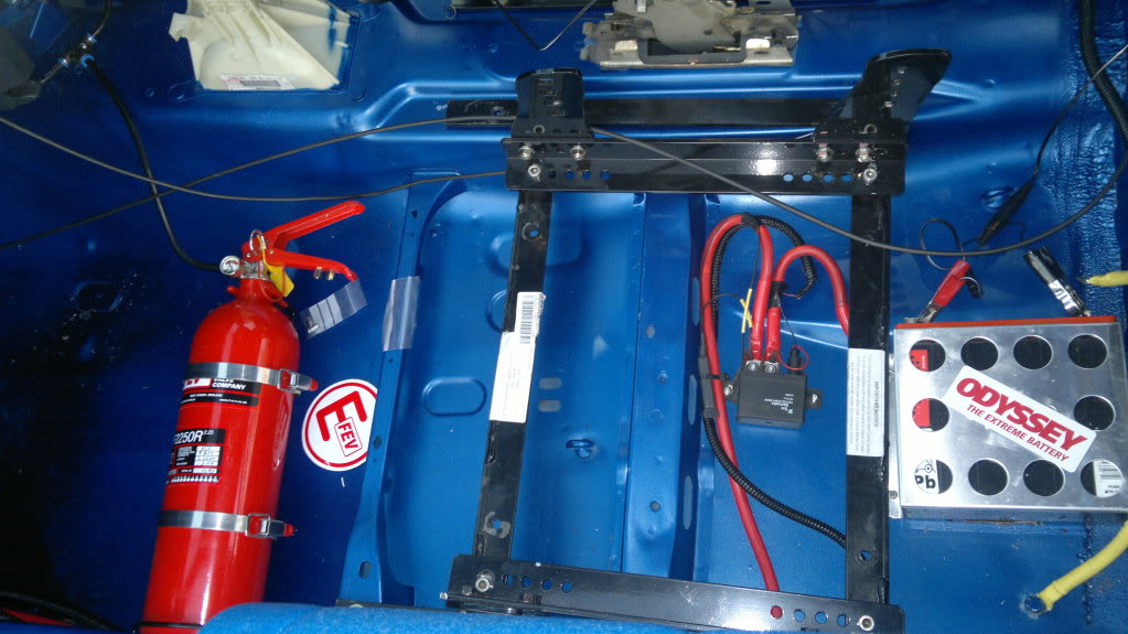

Here's a view of the Fire extinguisher, battery and engine cut off electrics.
All that's left to do is fit the brake ducting, brake pads and seats and I do believe that's job done.....

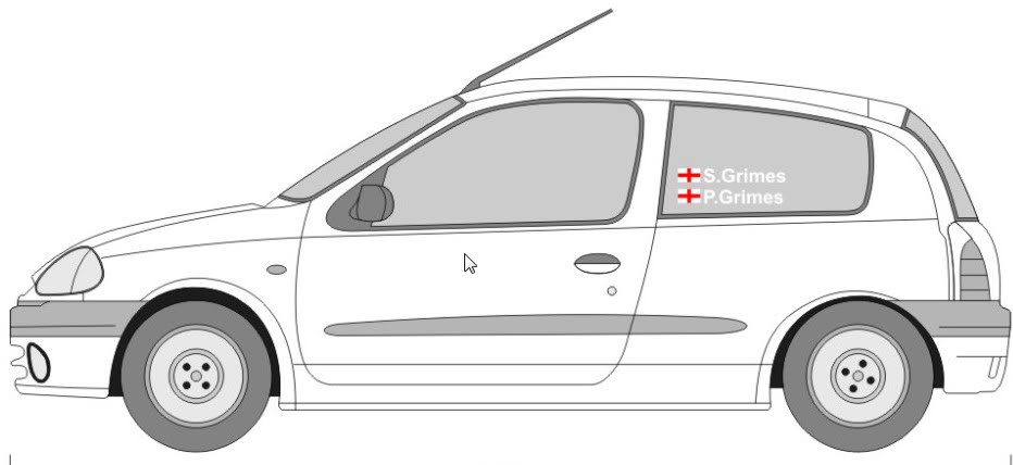

Names for the rear quarter windows......from Ady at n2grafix
Still need a team name
PSG Racing .co.uk
PSHS Racing .co.uk
Or what?
Ideas welcome.....big or small....
Names look great on the car and also I prefer PSG Racing :)
