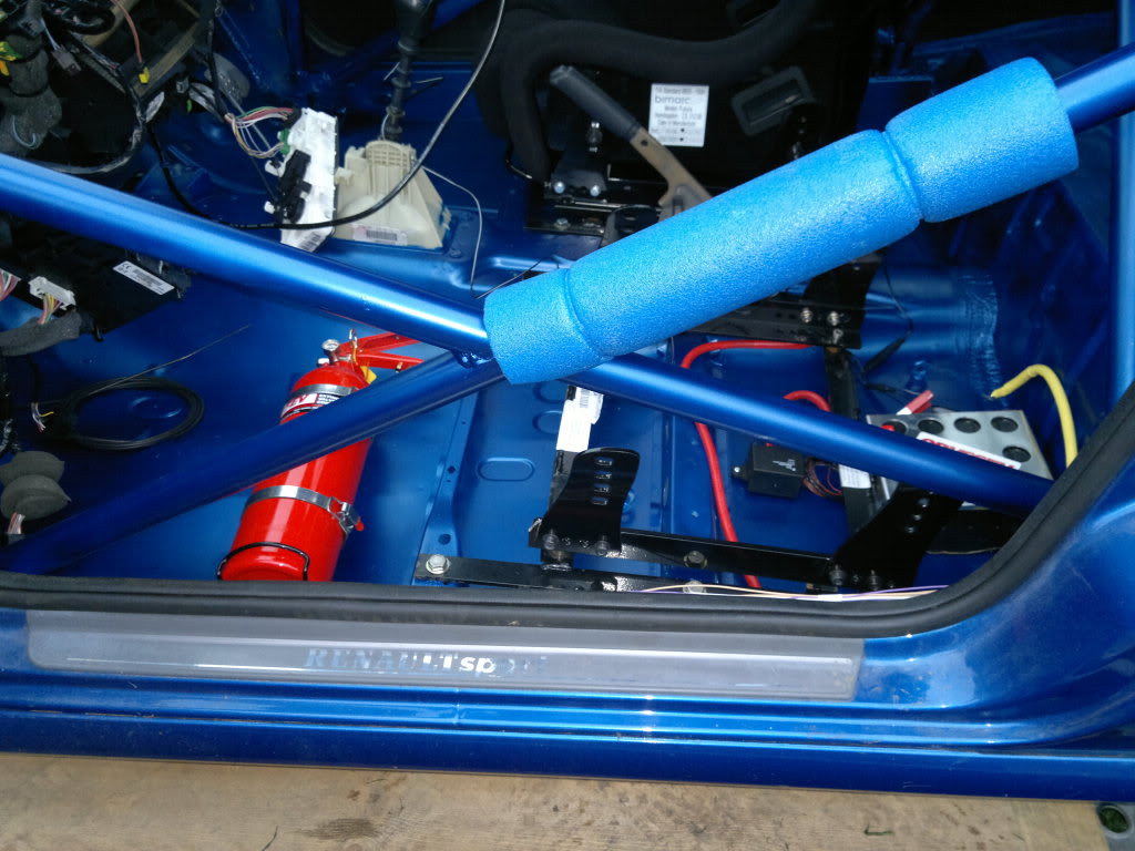

Looking like I'm having to remove the passenger wiper so I can get the extinguisher and eng cut off switch on the scuttle panel there, can get an Citroen AX single wiper mech and motor for £25, any one now how easy these are to fit?
There is a Storm single wiper mech +blade for £73 + £7 delivery from Venom...easier option?
Ours is Citroen AX. Needs some body cutting to fit, nothing too bad. Photos on Burpspeed.com
£25 for the linkage? Thats a rip off, I paid £5 at the scrappy.
Thats handy.

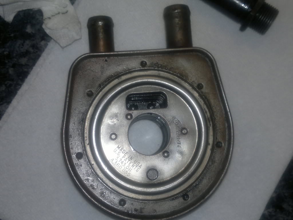

Oooo, what's that do? Is it for cooling of sorts?
Bit late now but the Clio motor fits the citroen linkage prefectly, saves messing with the wiring then.Did have the motor too, all academic now as after adding the cost of AX mech + wiper arm and messing around fitting..... just ordered the storm kit for a tenner from tweeks.

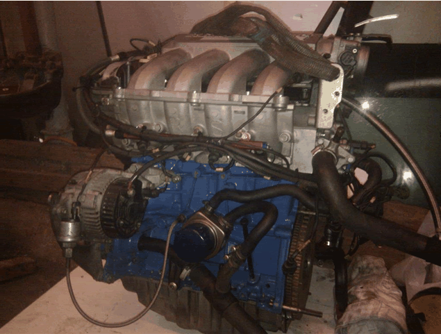

prob not as good as a proper oil cooler setup. We had one for ages but never fitted it. Someone we race with had one split in a race after a bump. This is bettter than nothing, which is what we would probably have
True. Who sells them?
There's a link in post 177 eBay .

Those heat exchangers are used on 106 gti's too - they're awesome
They aren't as good at cooling as an oil cooler - but most people don't really need an oil cooler. These will do the job 99% of the time - but also they help heat the oil up quicker due to running hot water through them - protects the engine. Wouldn't mind one on mine!
It's a good space saving, hassle free option.
