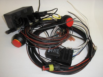

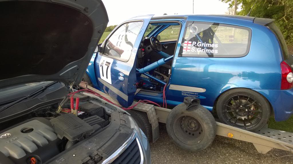

The cutoff module has started to play up, neither of the cut off switches will cut the engine but if either or both are activated the car wont start.
Have to start the car with a starter pack to the starter cable terminated in the engine bay. Did a quick volts check with Dan on Saturday and with the engine running there's volt's to the engine side of the cut off module and no volts present from the battery to the cut off module. So no charge reaching battery either, everything else appears fine alternator\ 15 volts on the gauge with engine running. May be a symptom of a real flat battery\dead battery.
Sent email to Simtek on Saturday and about to call them this afternoon. Hopefully just a case of a swap over of the cutoff module and all's fine.

My fire extinguisher T pull needs regular attention, but for the cost against an electric firing unit I'll put up with it. Sort of thinking this way for the engine cut off now....Got a few things to try to sort out my cut off issues, however, from the detailed reply from Simtek I don't think it'll be a 5 minute job.

I guess you have the B200 (Black box) Master relay unit? Its trigger circuit is very simple.
The relay's trigger circuit is supplied with battery positive and grounded (Negatively triggered) through the switches. The grounded trigger wire to the battery cut relay's trigger circuit also provides the ground / negative trigger for the ignition cut relay.
Not sure what you fault is, not sure how you have it wired.
If you go to our web site there are wiring diagrams you can down load and print in PDF format to help you search for the fault.
You need to Check the following, working back from the relay unit to the switches until you find the fault.
1 - With one or more of the master switches in the OFF position no battery voltage should be supplied to any components on the car other than the battery cut relay circuits itself.
2 - When operating the switches from the OFF position to the ON position you should be able to hear an audible clunk from the battery cut relay.
3 - If you can hear the mechanical operation of the battery cut relay check that there is no battery voltage on the out put terminal of the relay when the switches are OFF and there is battery voltage when the relay is ON.
NOTE If the relays function is correct then we need a different set of tests and you will need to get back to me. If not then move on.
4 - If there is an audible clunk but no power then the relay might have failed. If no audible clunk then move on.
5 - At the 2 way connector to the battery cut relay unit you need to test for battery voltage at one of the pins (Usually pin 2).
NOTE This pin is connected to a short loop of wire from the battery feed to the relay's power stud for the switched circuit to the two way connector. This is the relay's trigger circuit positive feed. If there isn't the loop is at fault. if there is move on.
6 - At the first Off/On switch with the switch off, testing at the wire coming in from the battery relays connector, two way connector pin 1 you have battery voltage, If not the connections or wire between the first switch and battery cut relay are faulty. If there is see note.
NOTE If you have you should be able to ground this wire using a power probe or just a piece of spare wire, one end to the connection and the other to battery negative, the master cut relay should clunk in.
7 - If the above works move on to the other terminal with the switch ON and repeat the process. If this doesn't work the switch is faulty. If it does move on.
8 - Move to the next switch and repeat step 6 and 7. This will help you work out were the circuit has gone faulty.
Please get back to me with your results

Started at the battery, to look at the cutoff fault on Saturday, appears the race battery is dead as a dead thing. After 5 hours charging no volts across it. I had to test the Passat battery to make sure I was using the multi meter right. Once confirmed, hooked the Passatt up to the Cup.
Cut off worked as it always had - so problem solved.
