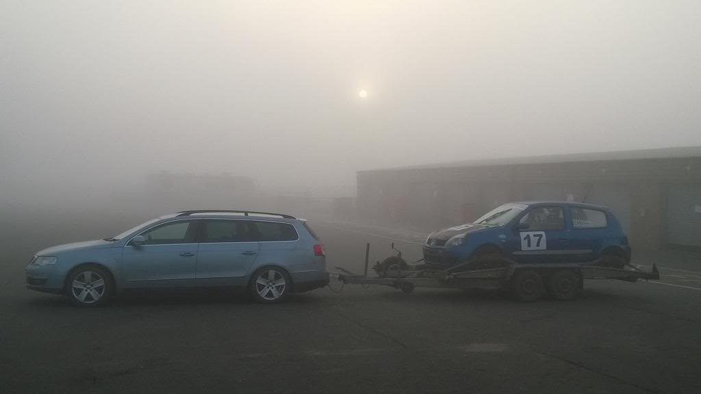

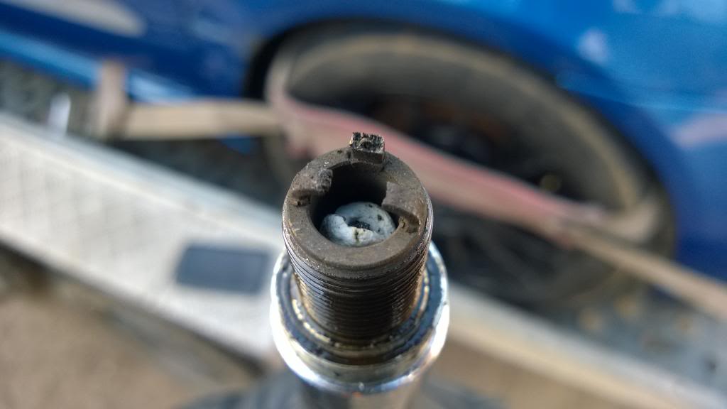

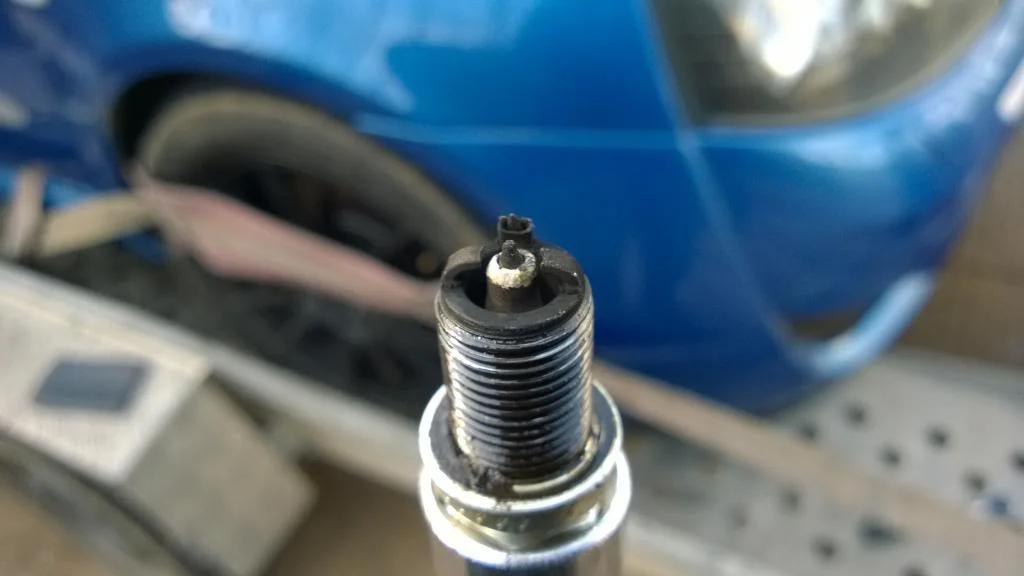

Unfortunately an early bath for #17. Homeward bound after 7 laps and won't make it out on Saturday

I wouldn't have thought a leak down test would show something that would destroy your plugs like that. Do you have a hunch?
I'd have thought it would most likely be det or over heated plugs. Most likely caused by a faulty sensor throwing the fueling/ignition out.

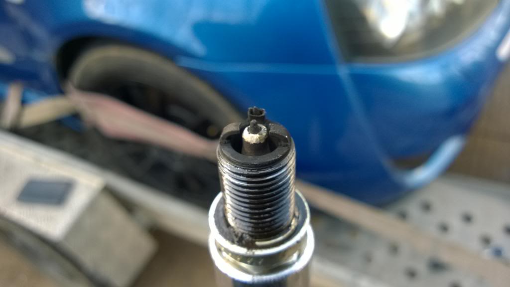

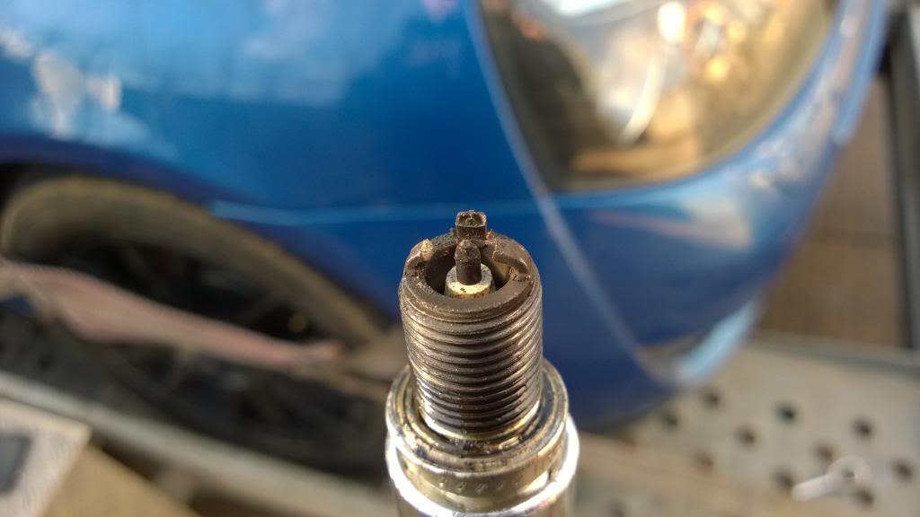

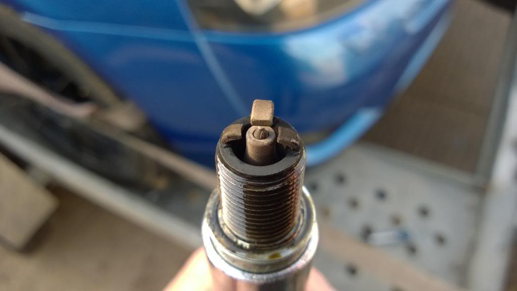

You got any pictures of the f**ked plug pete?
Speaking with Dan yesterday - that's the answer I got Ignition to far advanced at certain points of the throttle. May be my over generalization (on my part) but that's the main problem.

Yeah normally if plugs are dieing its just poor mapping causing det, epsecially on such a basic spec of engine where its unlikely to be an underlying problem with the specification, normally that sort of thing is caused by the map being either too lean or too advanced, or a combination of both, sometimes things other than the map can cause leaness (dodgy wiring on injector, faulty injector, low fuel pressure etc)
In extreme cases it can also be caused by map due to r****d (I dont mean the person putting the bad values in the map) as if you have far too little timing although it wont cause det the way that advance will it can cause greatly elevated EGT's and that can then lead to plug and/or piston failures.
Id be wanting the head off that to look at the pistons, or at the very least get a decent bore scope down it, as the pistons have been exposed to the same conditions that the plugs have.

Well, they've certainly been feeling the heat that's for sure!! What plugs are they as well??

Are they the correct plugs? They are similar to Bosch super 4's, a plug that I don't recommend, the first thing a replaced when I purchased my Cup.
