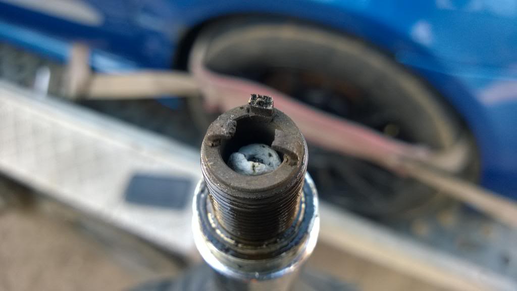

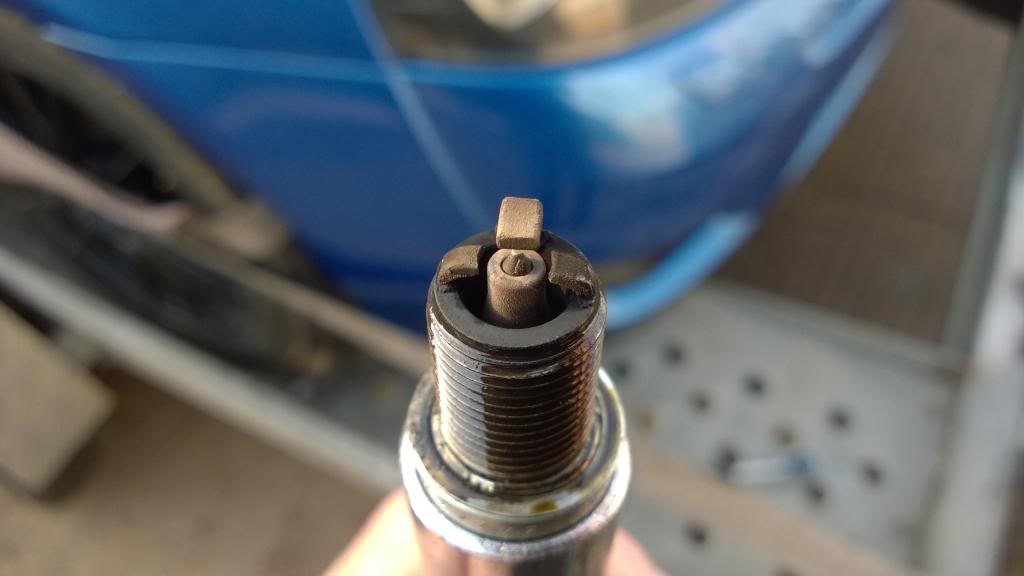

Wow, it really has done a number on those plugs!
Is it oil on the thread of the 4th one?
Or is that just a trick of the light?
The others just look terrible TBH, I cant believe it managed to eat them that badly in so few miles.
Were they checked after mapping? (ie do you know if the damage occurred during mapping or when used on the track?)
Am going to be very surprised if its managed to do that to the plugs (the ones with the missing electrode have probably seen 800+ degrees sustained electrode temp, and on a 197 plug thats quite hard as they have minimal insulation so a lot of chance to conduct heat away into the head) and then not done any damage to the pistons but looking at the fact there isnt any visible aluminium deposit on this one:
You may just be the luckiest person alive and have gotten away with it despite what conditions were clearly like in the combustion chamber!

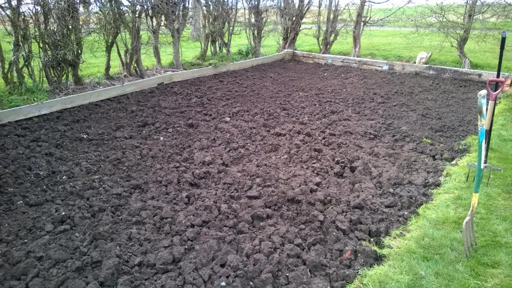

Finally got rid of Harry and Scarlett's play area - 8m x 5m weed membrane, play barked with climbing frame, both too old for the frame and never used it. Sold the frame a while ago and been moving the 50 barrow loads of play bark over the last few weekends.
Today was the final push - dig over, grade and level ready for grass seed.
Started the dig over - hard going after 7 years being a play area.
30 mins later - fist dig over complete
1st grade complete and part way through 2nd grading
3rd grade and flattened all ready for grass seed.
All by hand and done in 5-6 hours and I'm all done in too!
Interesting plug, never heard of them before. Well Pete, hopefully its all good. Was there much engine damage?
None that I've seen
Oil on all the threads on #'s 1,3 & 4 . #2 had oil just on the top half of the threads.
I never took the plugs out when I had the car back so I wouldn't know their condition, post Silverstone race Nov 2013 to pre Snetterton March 2014.
