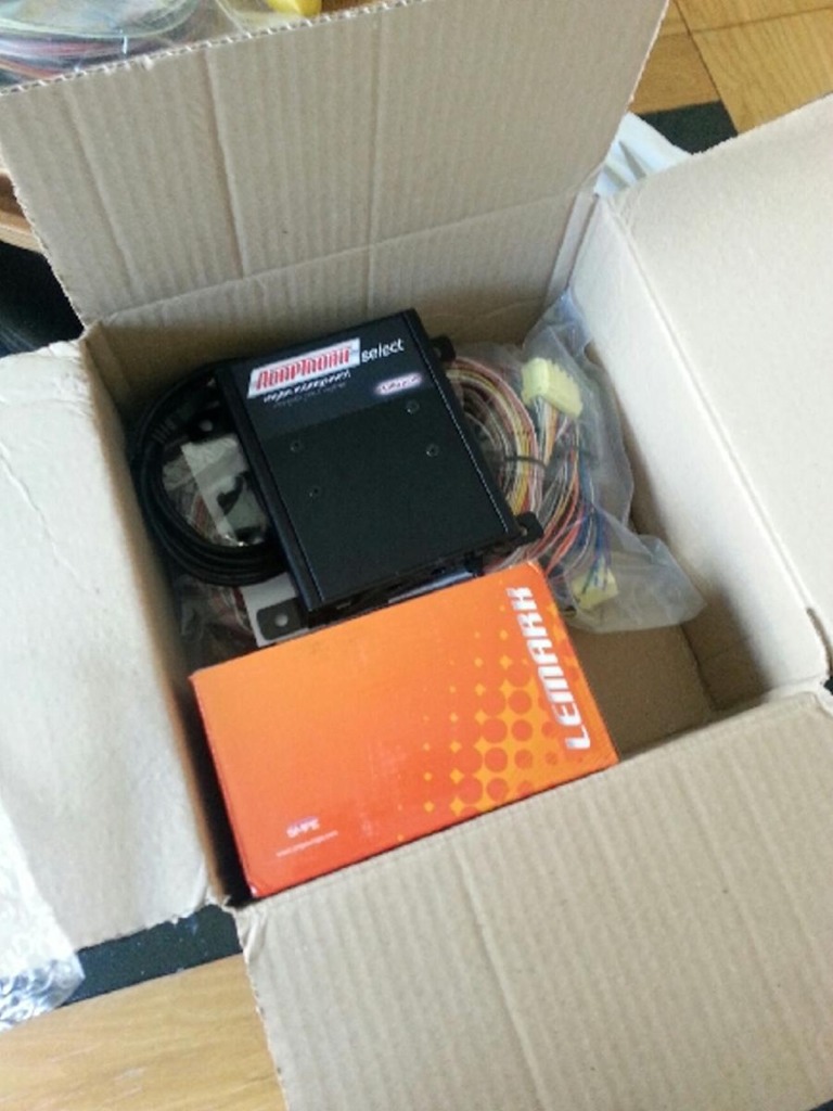

We do the adaptronic just a little cheaper hey tom![]()
Mapped by us up north where all the good turbo cars are made![]()

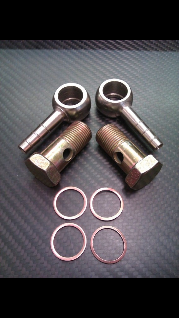

Take the feed from the thermostat housing, its plenty adequate and far easier to route.
I wouldn't do this as you don't get the syphon effect when the engine is off. This is when you want the coolant to work as the oil will cool it when the engine is on.
Best place for me is from the heater matrix. If you have forge or samco hoses it is very easy as you take it from the bypass loop just before the heater matrix. If you have standard hoses then you'll need to tee in just before it.
Myth busted, my turbo makes all sorts of slurping coolant noises when the engines shut off after a run, and you can witness coolant flowing back into the header tank as it should.
What you're seeing is expansion and air pushing coolant around not syphoning as you can syphon with an air gap at the top of the header tank. Laws of physics unfortuately.
Ive done all mine this way with out issue.
But then again I dont just turn the car off

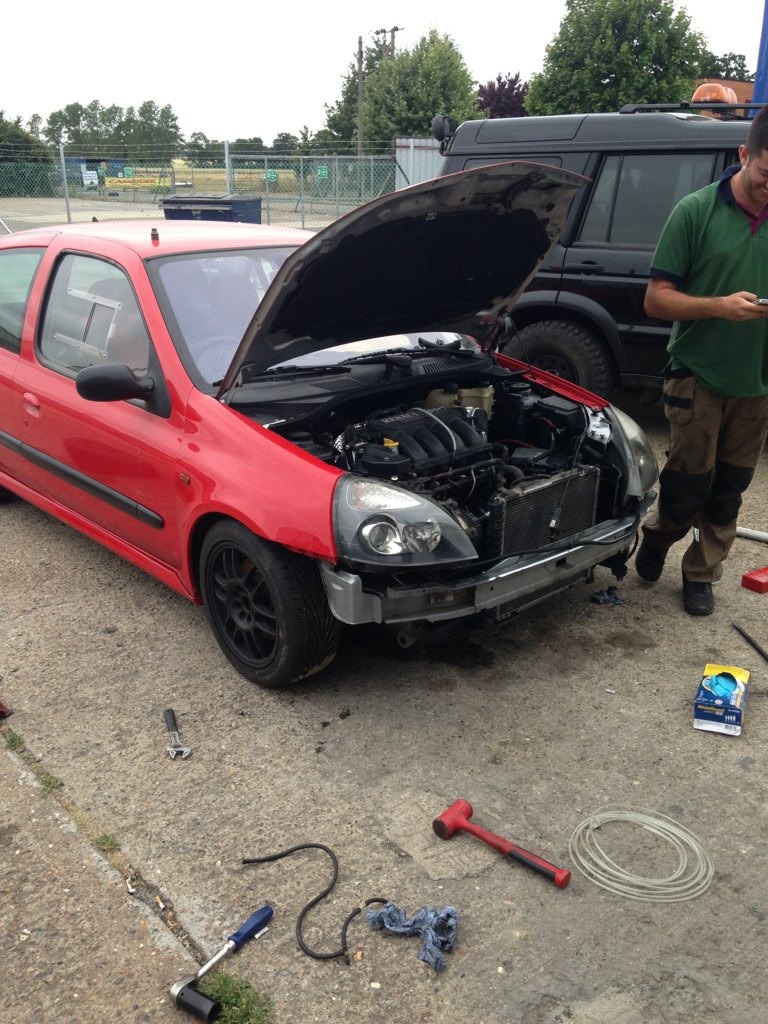

This car is really pushing my patience... Await breaking thread!!!
Had the car running lovely, then told i need water cooling... Ive bought the banjos and fitted them but ive had the turbo in and off so many bloody times, trying too sort the return as ive turnt the core slightly for clearance of the banjos, cant access the 4 bolts, cant get the jubilees on return pipe, return sitting on down pipe ect!!!! Really trying me at the moment...
Rant over lol, just had one if them days and then this adding too it!! My returns into my block, but the angle of my core send return towards downpipe before coming back too block. Core has too be were it is too allow the water banjos too fit... May have too re think return as im just using braided hose all the way. Any ideas??
