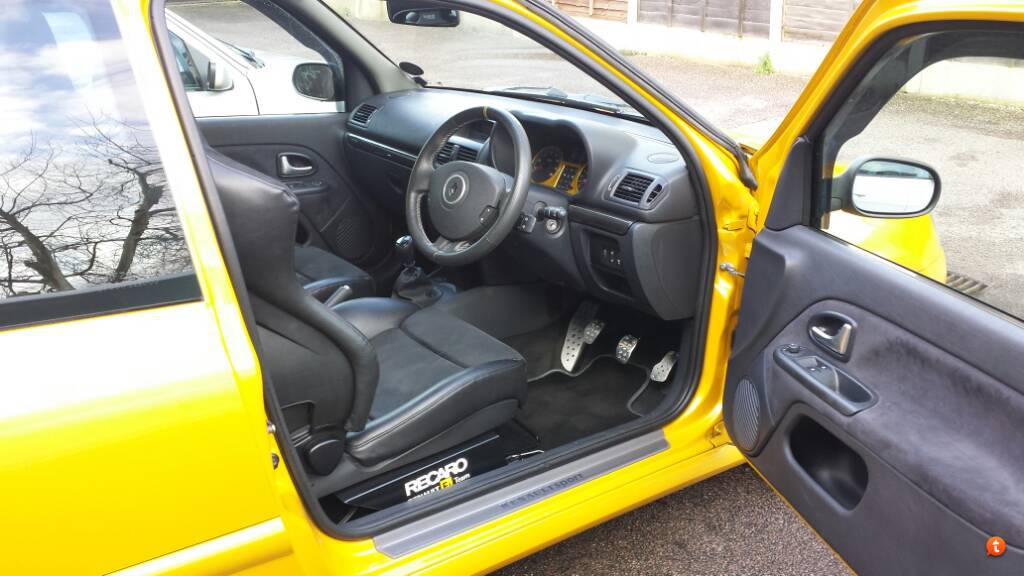

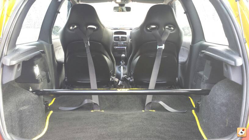

Also have got some sabelt 3point harnesses and have stripped the rear but made a black carpet with yellow edging and tried to keep it looking tidy.... and sort of like the meganeR26R look ;)

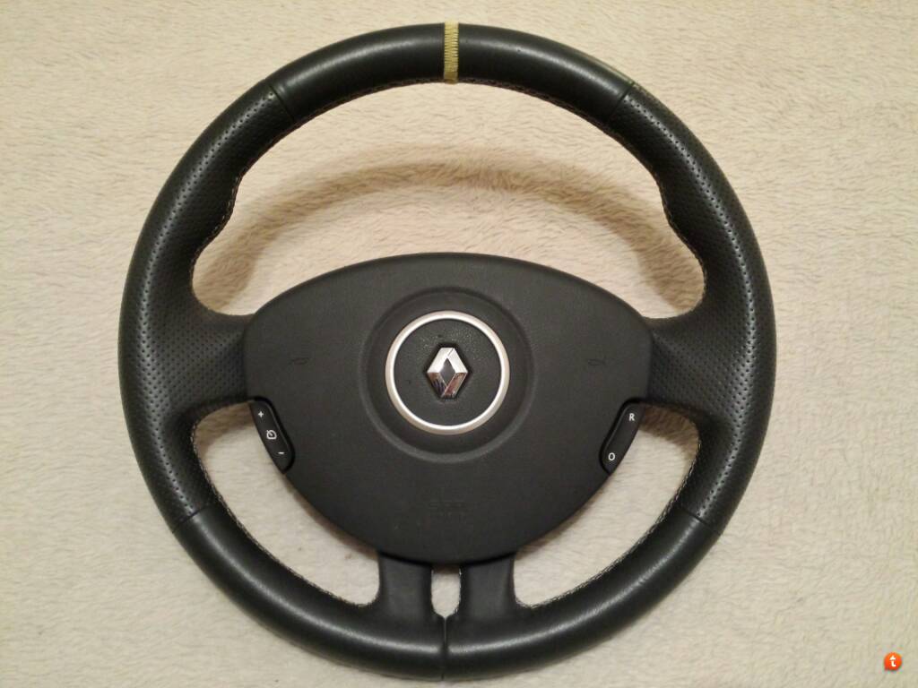

Recently purchased these.

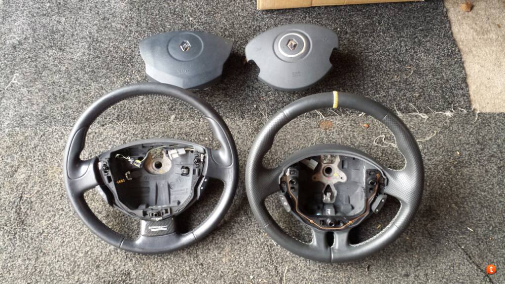

Rs200 wheel in really perfect condition no rips or melting.
And Carbon Diamonds
  LY Clio 182 Cup FF

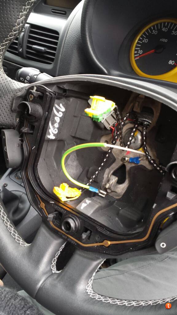

Got the wheel fitted.
Old wheel vs 200 wheel

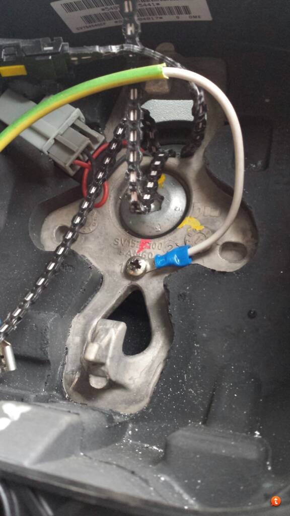

Bolted on with a 1.5mm spacer
Made the air bag earth
Connected the horn
Conneted the C/C and made a cut out to sit the plug in the side of the wheel
Finished
Feels perfect and everything works. Indicators self cancell. Horn works on both sides. C/C works and all buttons. No air bag warning lights. Very happy :)

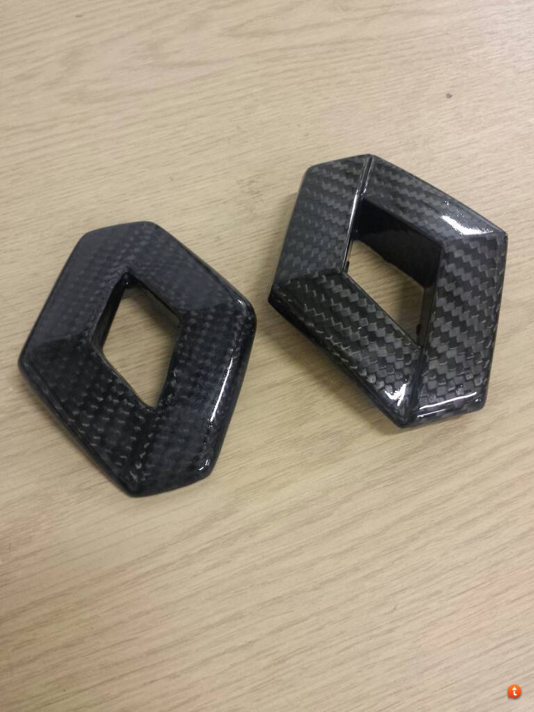

  LY Clio 182 Cup FF

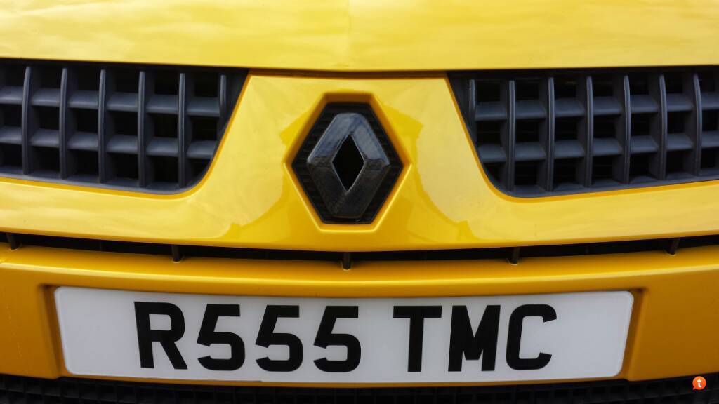

Carbon badges fitted
Front
Rear

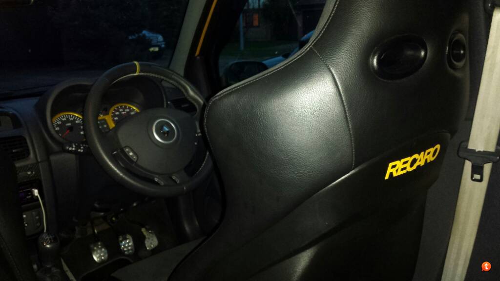

Also have put these recaro stickers on and not a 100% on them yet :)

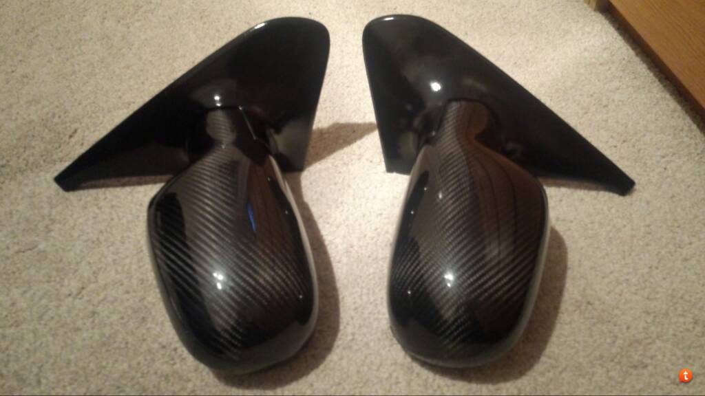

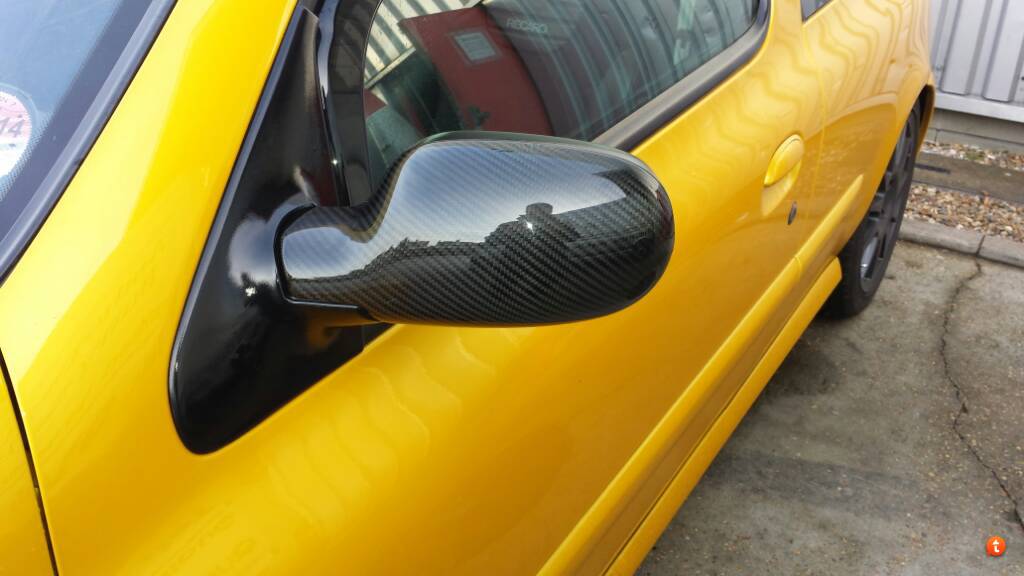

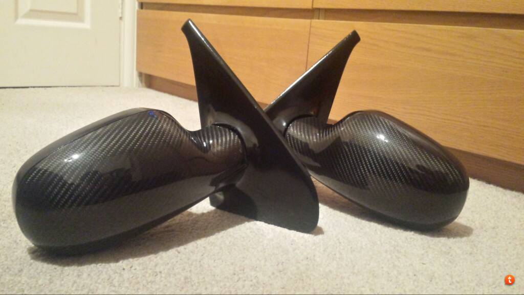

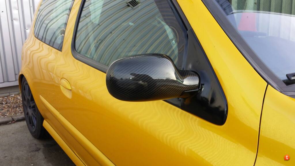

Have now taken the carbon mirrors off and the badges and gone back to oem :)

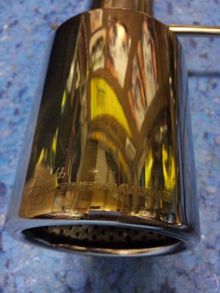

Also bought a new exhaust the Ktec Ultra Supersport exhaust.....
Very happy with the condition... Now for the fitting...
Love the way it sits and the sound.... my nicer then my milltek with the centre resonator.

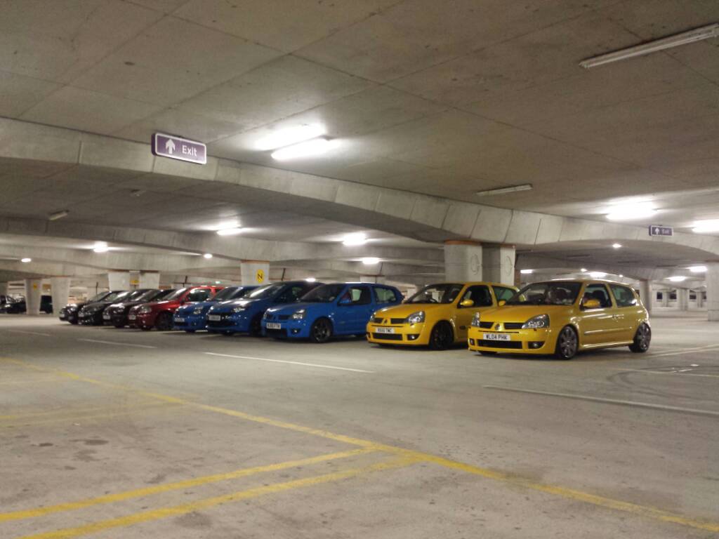

Also a couple of pics from meeting some mates up lakeside...
-J-
  RS2'ed 172 Cup
Looking good, was that the Renault UK meet (Facebook club not the real RUK) good turn out?
  LY Clio 182 Cup FF
Yeah it was man.... was a very good turn out... like x3 that amount but only got this picture after most had gone home.
