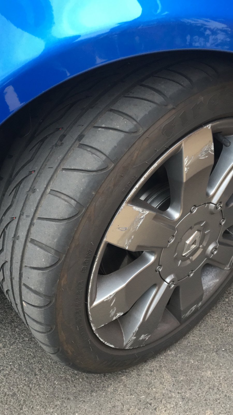

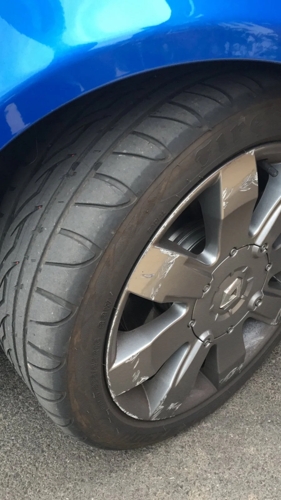

My tyres are firestone 205/45/16

Decent tyres, maybe the ps3 as a compromise or go for the ad08r's or a spare set of 15's with more track based tyres on allready.
Being your first a decent set of road tyres would be best. See how you get on, enjoy it etc.
Ahahaha Well hence why I'm asking for an alternative tyre, I've been recommended ad08's.. I was just going to change the fronts mind
I would say that wasn't a good idea unless you really like oversteer i.e. plenty of front end grip and a lot less on the rear
4No AD08's would be a good choice
As for pressures a good starting point is to set the tyres to their cold pressures when hot and take it from there
Budget worn tyres & budget discs and pads, will equal no fun as they'll burn in the dry and be dangerous in the wet.
Get yourself a set of track orientated Road tyres, Nankang, Ferdral, Toyo etc... I get all mine from ebay part worn, just make sure they're not to old (7+ years), lol.
