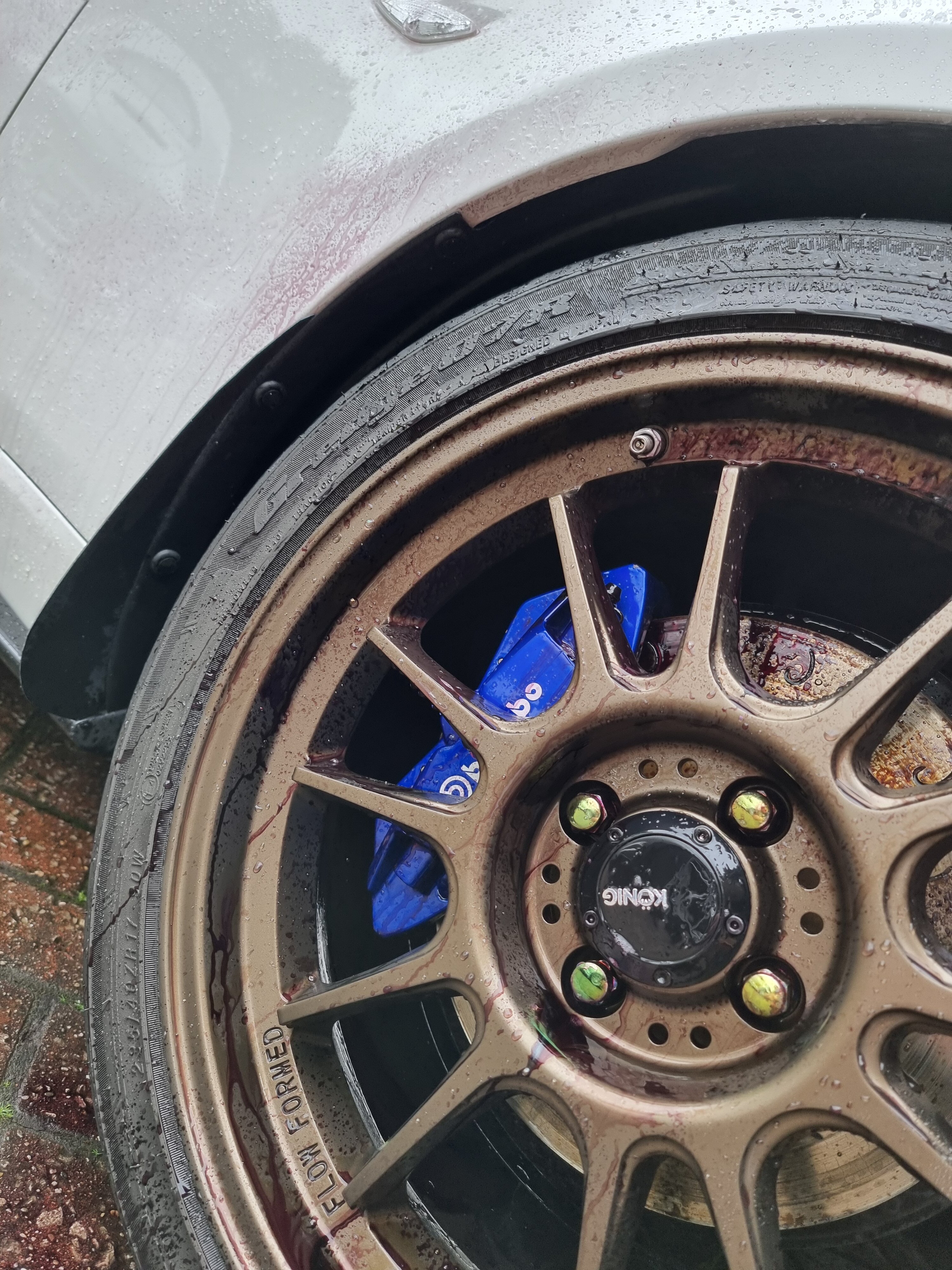

Dust isn't too bad but the rpx pads seem to be absolutely nuts. Any condensation or puddle water on them when they're dusty and the rust cakes onto the wheel! Never known any pad to do it

Yeah done all that and I jetwash them off after a td. Rpx are the only pad that seem to do this. But a lot is down to the wheel design too I guess. The hub section has a massive dished part that collects water that runs out of the lugs and that's where it seems to stick
