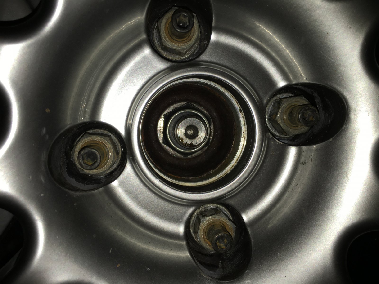

Well shaft changed! - no sign of any issue on the bearings to the box end, but the CV joint did feel a little loose compared to the new one (as you would expect).... Initial spin round the block and all seems silent, but it will need track to determine if it's fixed or not! Must get something planned as the next outing is the CSOC Performance French night, with a magazine photo shoot I'm told, but that's not until the 29th August 🙈!!
Forgot to take photos of the change over - but here's one of a shiny hub nut and spindle :laughing:

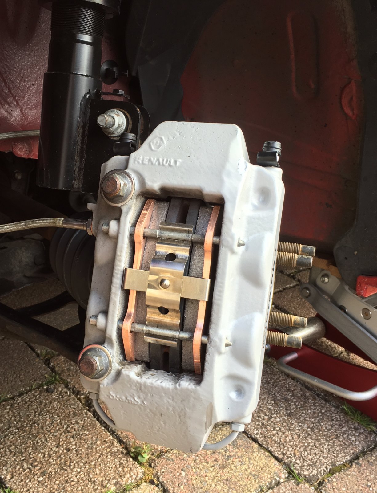

So, not being a 100% happy with the DS 1.11s, I've switched back to RC8's. The main reason for the change was the lack of initial bite, even though they did seem to perform throughout the day and certainly last longer than the RC6s. I'm hoping the change back to the RC8's will give me the best of both...... Well I suppose we shall soon see 🙈
Biggest pain in the ass was the marks on the callipers from the grey 1.2s (balance weights)! you don't see anything when the wheels are on, but that was enough to sell them and order up some pro race 3s in silver as a change..... Although these are taking until the end of August to arrive, but no real issue as they will be wrapped in rain sport 3s for wet use and I'm hoping that we will see some dry track time!

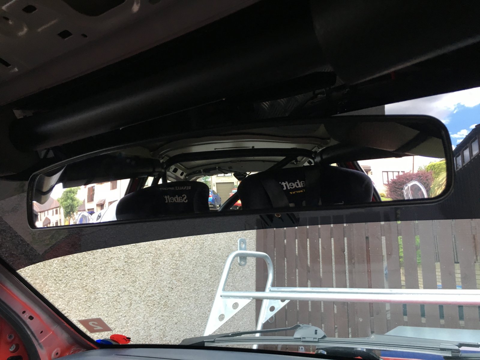

This time a cheap modification which I'm hoping makes a big difference! After getting the HANS device it's very hard to turn your head and look down pit lane, so thought I'd try one of the wide angle mirrors......
I got the one that clips over the existing mirror, but I'm wishing I got the one that loops over the roll cage bar!
Let's hope it makes a difference but at a quick glance I can see out both side windows & the rear quarters so it should be a little easier
I got the one that goes over the roll cage for my Nurburgring trip and it help loads.
I can sit in the drivers seat and see behind me and see out passenger rear quarter and passenger door window, giving virtually no blind spot. :up:

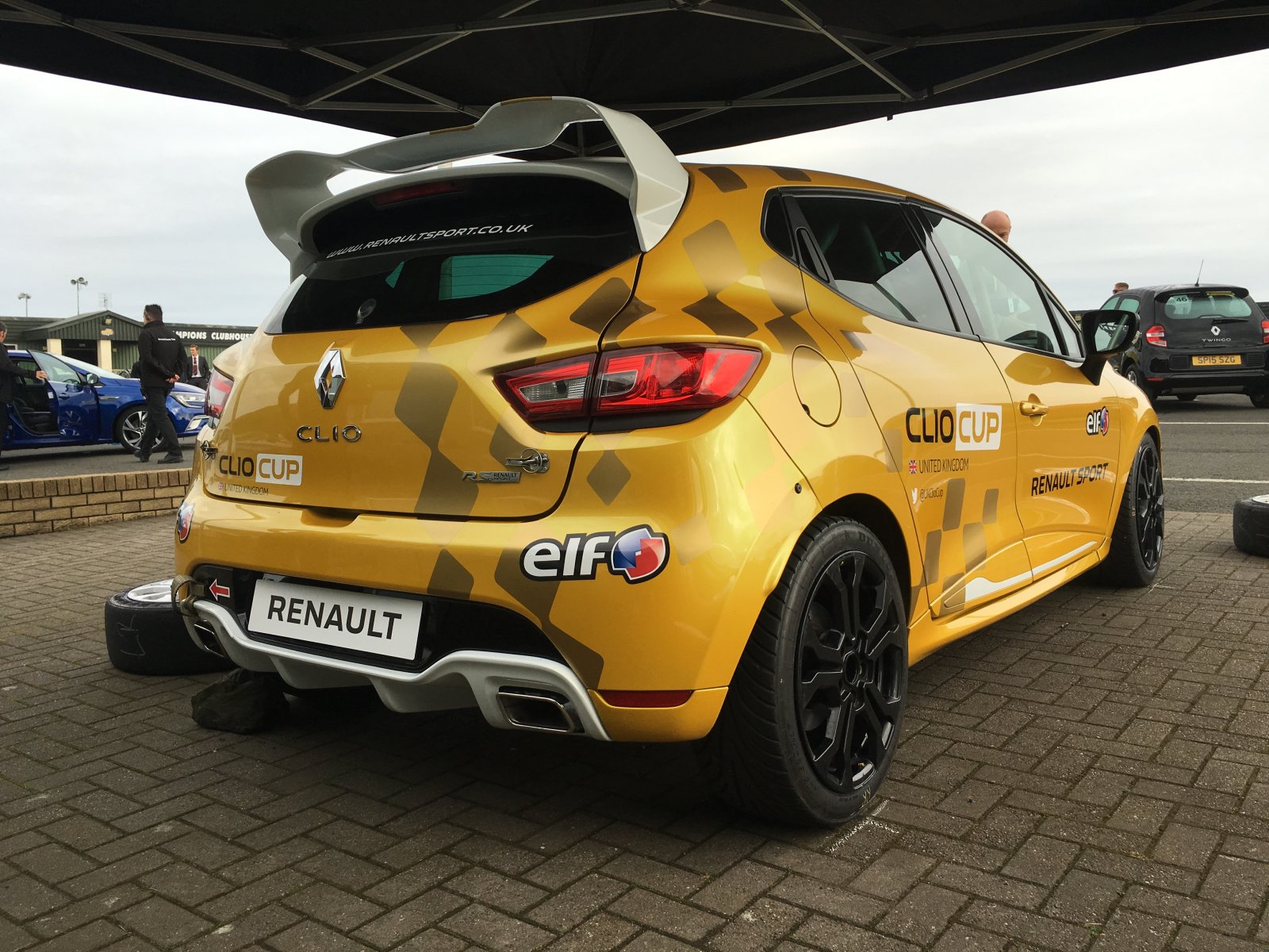

Well a different day at KNOCKHILL today!
We were meant to be on track this weekend but Renault booked the track for their driving experience day and we have been pushed to end of September! Typical as the weather today was perfect for once!!,
They brought an army of cars and had 7 or 8 Megane GT sports for a half hour on track slot, 2 slots booked and an hour of fun in someone else's car!! Can't wait for a shot of the Megane RS as the GT was actually great fun even with the the rear wheel steer..... Also it gave us a little practice for Monday nights Performance French Magazine night :smile:
Most exciting car of the day was this though!
If your name was pulled out the hat you got three or four passenger laps! Guess I'll just have to make do with Monday coming! Sounded great going round though :up:

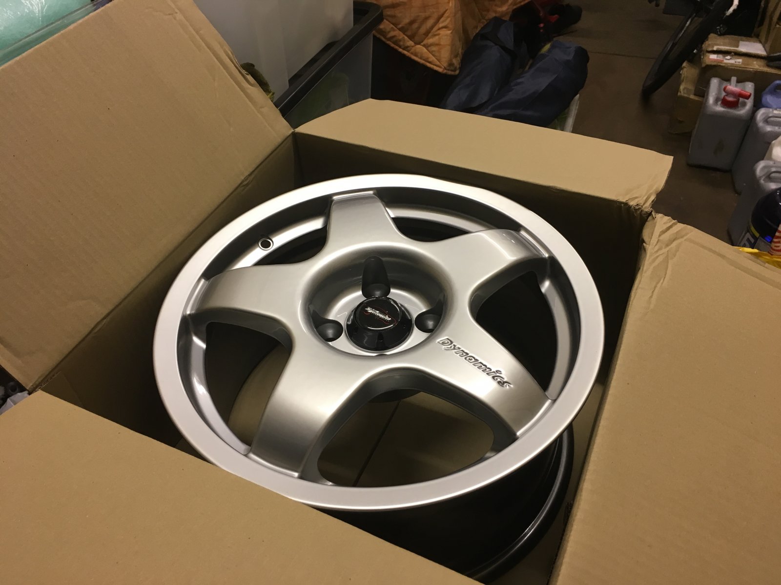

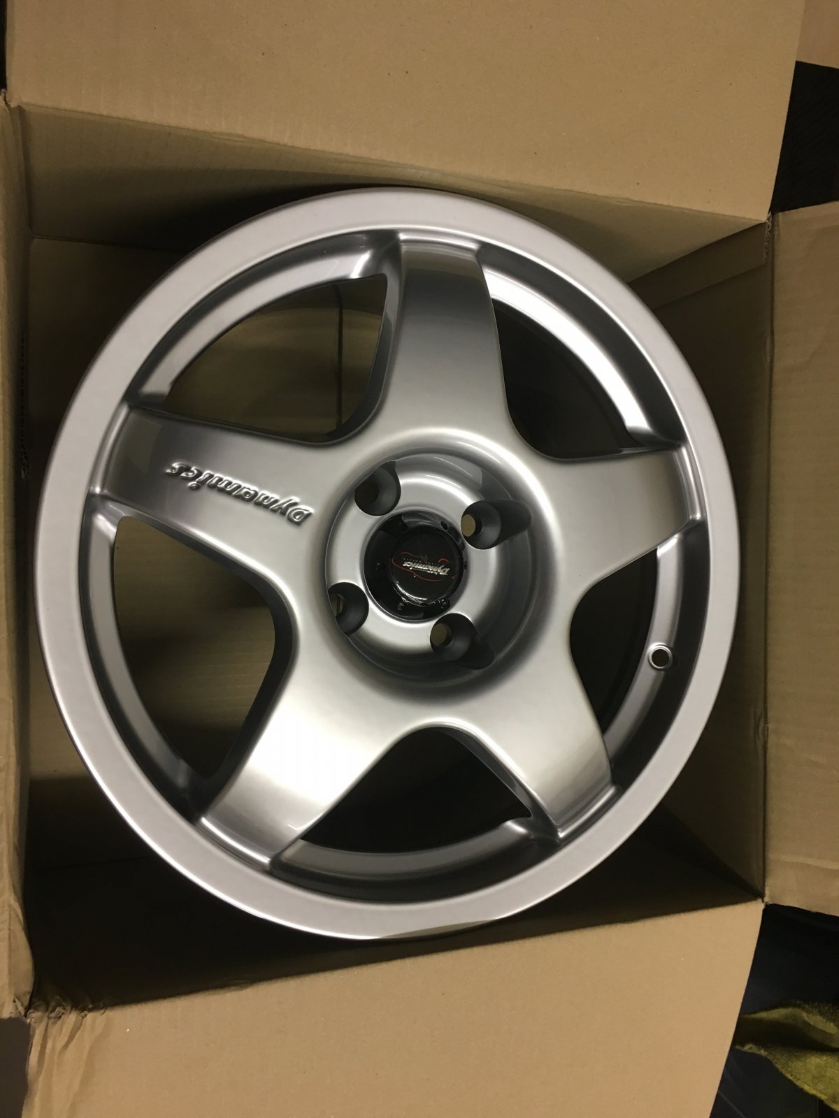

Only other bit of excitement today was the arrival of the new wet wheels, iv had the rain sport 3s for a month waiting on these arriving, but in true TD style these are 4 weeks late (my fault seemingly for wanting silver as they carry black n white in stock !!). To be fair it's meant to be dry tomorrow night, so no rush and I'll maybe wait until spring to get them fitted up! although it will need a trial fit to confirm they clear the Brembos, and I do want to see how the car sits on them
Opinions will vary but I have 2 sets of 1.2s (had 3 so sold the charcoal ones) so I needed a change !!

wheels look great, got em on the car yet?
Cheers Andy. No Not yet. Trial fitted and massive clearance so perfect. Was worried as they came in 38 off set and not 35mm as ordered, which was the reason for selling the grey 1.2s (every mm counts with the Brembo conversion) but really happy.
They won't be going on until next year, car is tucked away for winter now and won't be out until box is replaced, so currently saving the pennies and looking at diff options 🙈!
